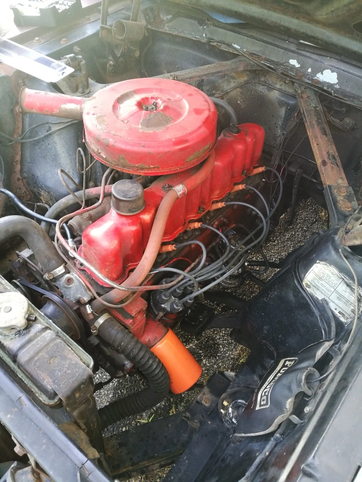

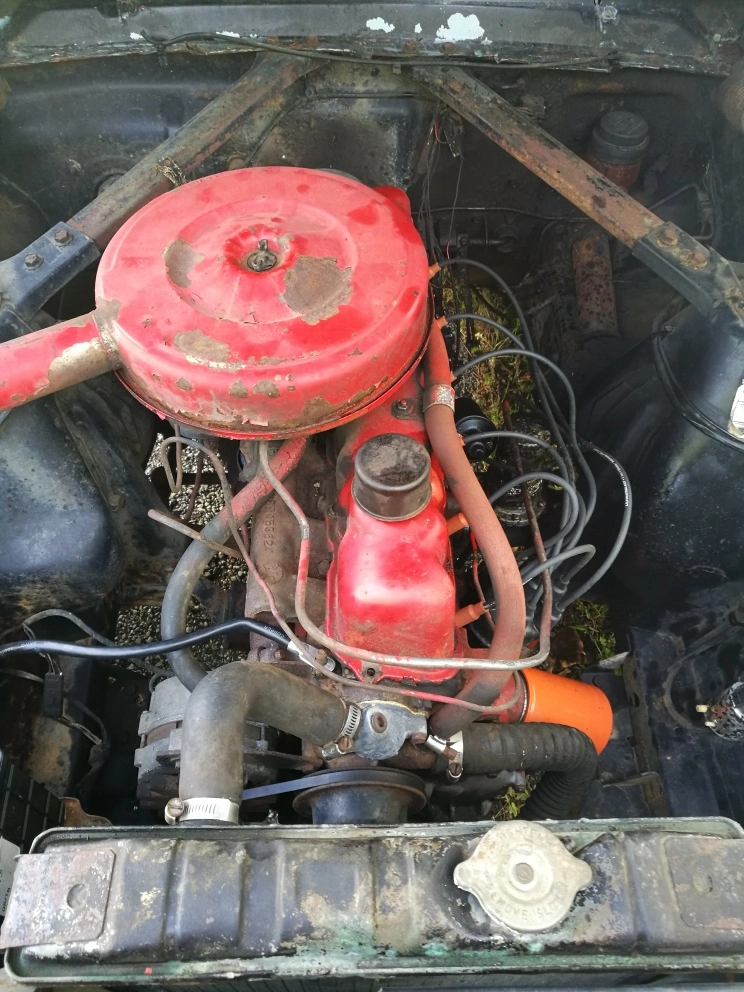

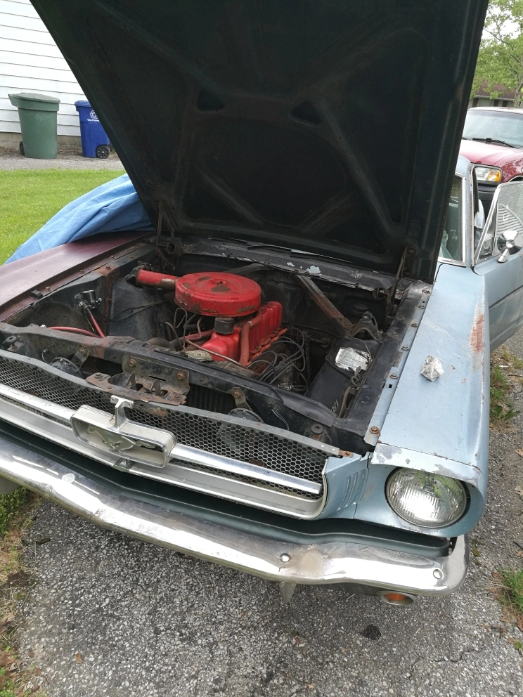

Thanks for reading, I plan on perusing these forums more as it will probably answer my questions in advance. There's more type but I'll hold off as this is plenty. I'm looking forward to getting my education. In case you were wondering, I'm a pilot and have some basic experience working knowledge of engines with working on the smaller planes I used to fly. Drive trains and transmissions are Greek to me though, airplanes don't have those. Here are a few pics, more to come.
