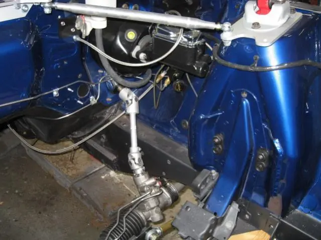

Where did you mount yours? I was thinking under the hood over by the master cylinder. I have seen people mount them under the car or near the rear end. I even saw some guy mount his so the the knob protruded into the passenger area by the driver seat so that he could adjust it while driving. I won't be mounting mine like that. I want as few holes as possible in my car.
Yes it is the same one. It is made by Wilwood and Ford just put their name on it. I mounted mine under the Master Cylinder and made up a bracket out of aluminum stock and bolted it to the fender apron. Here is a pic.

Thanks for the picture.
I may mount mine close to the same way. I'll have to wait until my backordered master cylinder arrives, so I can see how everything fits together. It should be here this week.
