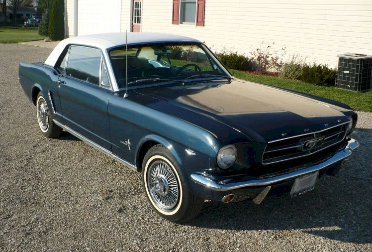

Do you think you'll go back with the Caspian blue? Here's one for inspiration.....
Thanks for the words of encouragement and checking out my YouTube channel!
I'm a sucker for cars that are "too far gone". That picture is actually what mine would have looked like originally. It was Caspian Blue with white vinyl top. I'll be repainting it Caspian blue but will be going back with a painted roof. Maybe some minor updates like better brakes and suspension, but keeping it fairly original.

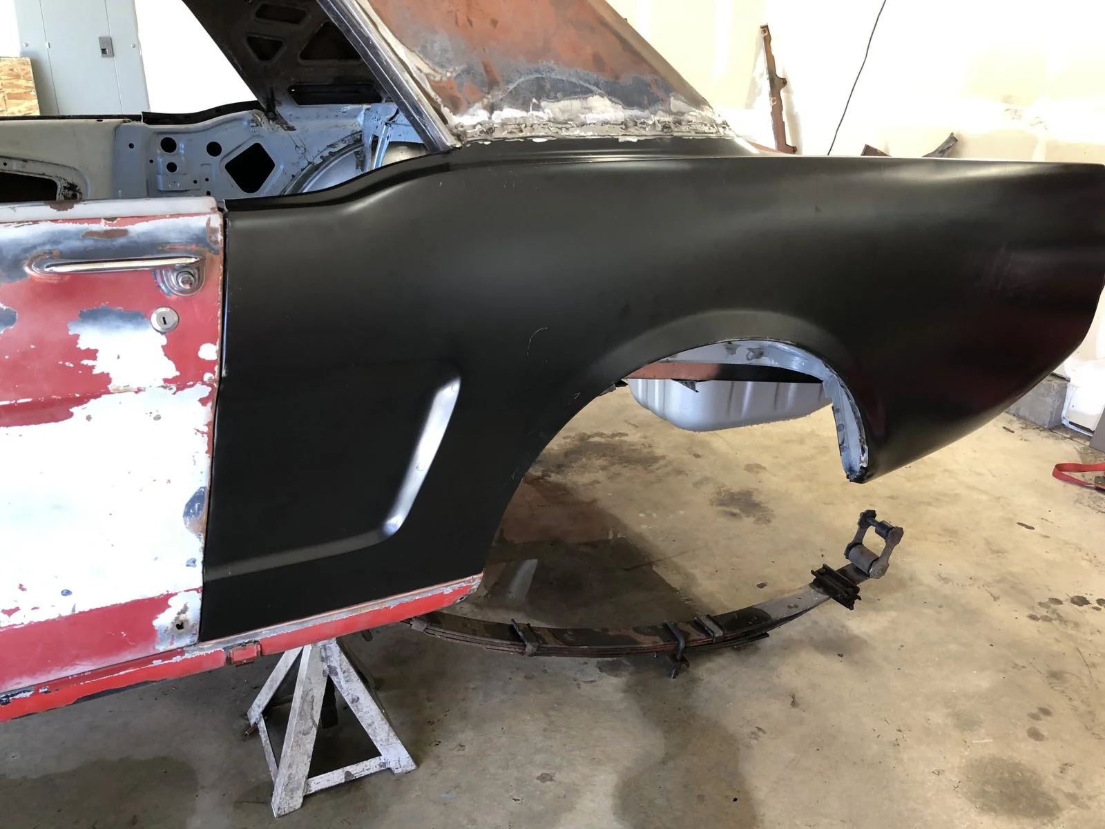

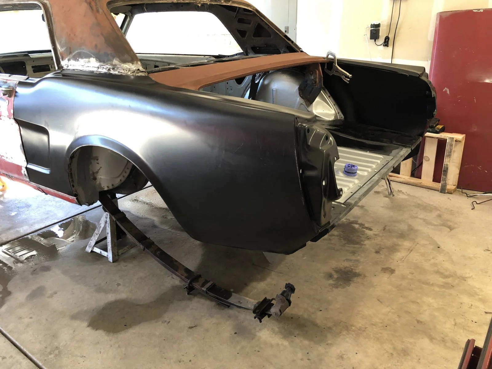

Wow serious chopping on those quarters. i usually find that the quarter is too tall by the rocker resulting in a half inch bottom door gap. So after shrinking it there everywhere else fit lots better too. It will also pull the back back up and forward. Those new pieces are never that accurate.
