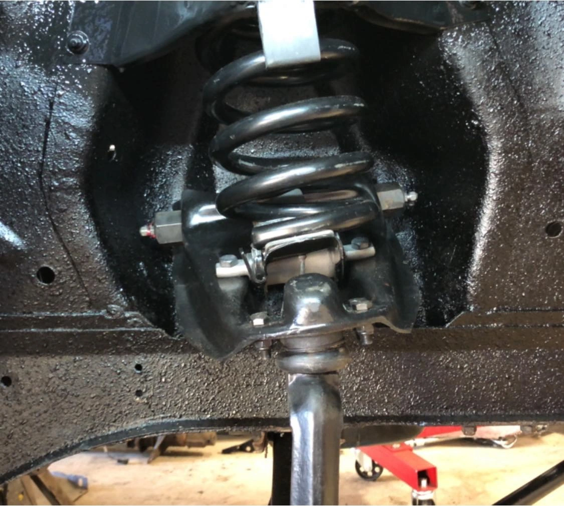

Shelby drop done, new control arms, new springs, new perches installed.
Never ever skimp on suspension.
Hoping to get it back on its feet soon!

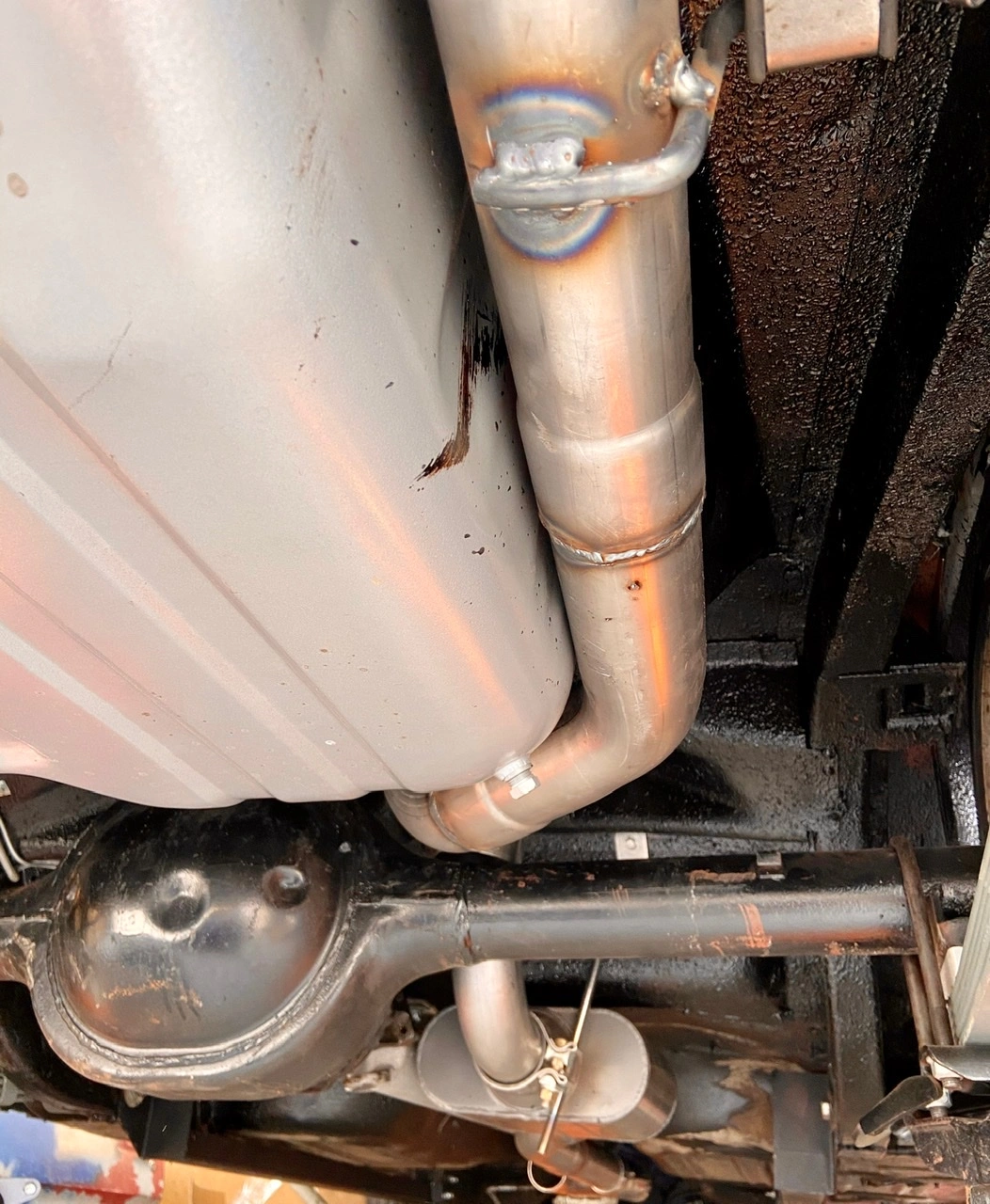

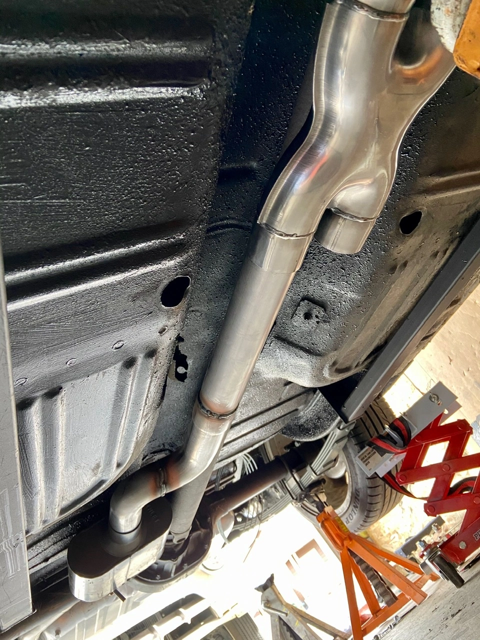

I find X-pipes a little raspy myself. I plan to run true separate dual exhaust myself....but with a v6 an H-pipe or X-pipe does nothing for power, so I can get away with that...not true with a v8(at least not without crazy crossover longtube headers like the old Ford GT40 had anyway) that tailpipe does look a little close to the gas tank though? You have enough room at that clamp to clock it downward to gain a touch of clearance?
Wicked,
I agree they’re a little raspier than an H-pipe, but personally like the sound. The exhaust pipe is rotated down slightly, so when it‘s clocked appropriately there’s more than an inch of clearance between the tank and the pipe. I also plan to build a small heat shield right at the corner of the tank (on both sides).
