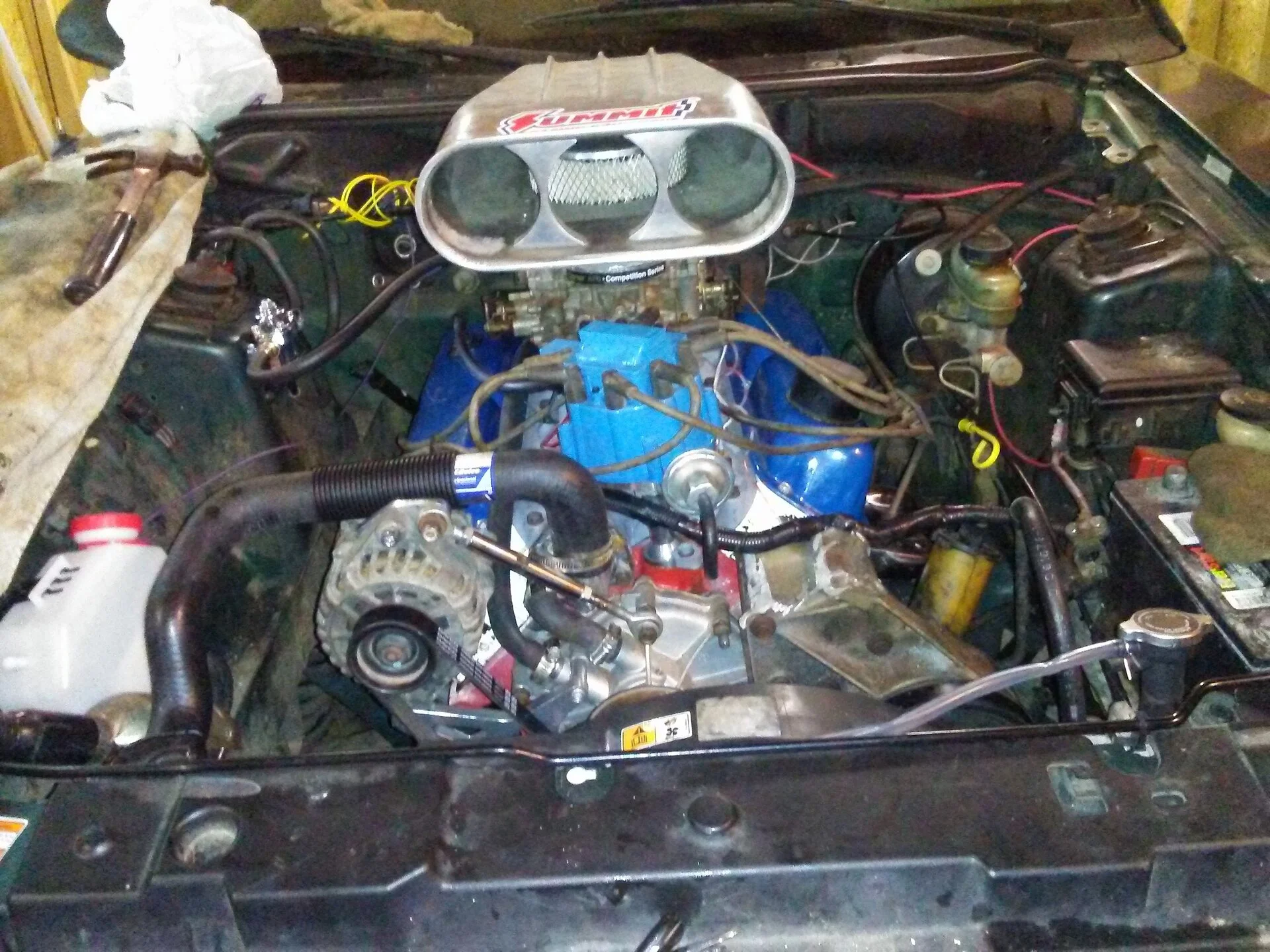

My car started doing this after taking off a cheap electric fuel pump and reconnecting the old one. Last night it would run ok until high rpm’s, but this morning it would hardly even get out the driveway. I’ve tuned the carb multiple times. I’ve replaced spark plugs, I’ve done just about everything and it seems to just get worse. Any help will be appreciated.

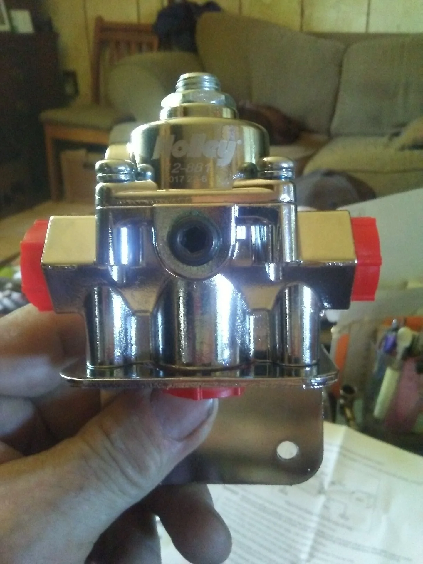

Does your car require a return? If so you must hook one up or it will never run right. You'll be flooding your carb with fuel. I'm running stock in tank pump. Because of my return my pump runs constantly but only regulated amount of fuel goes to carb.
I find it easier to go from new school motor to old school car than it is to go other way. I'm playing hell but those 450 HP, before I add NOS, will be a wild ride in itself when I get it right.
