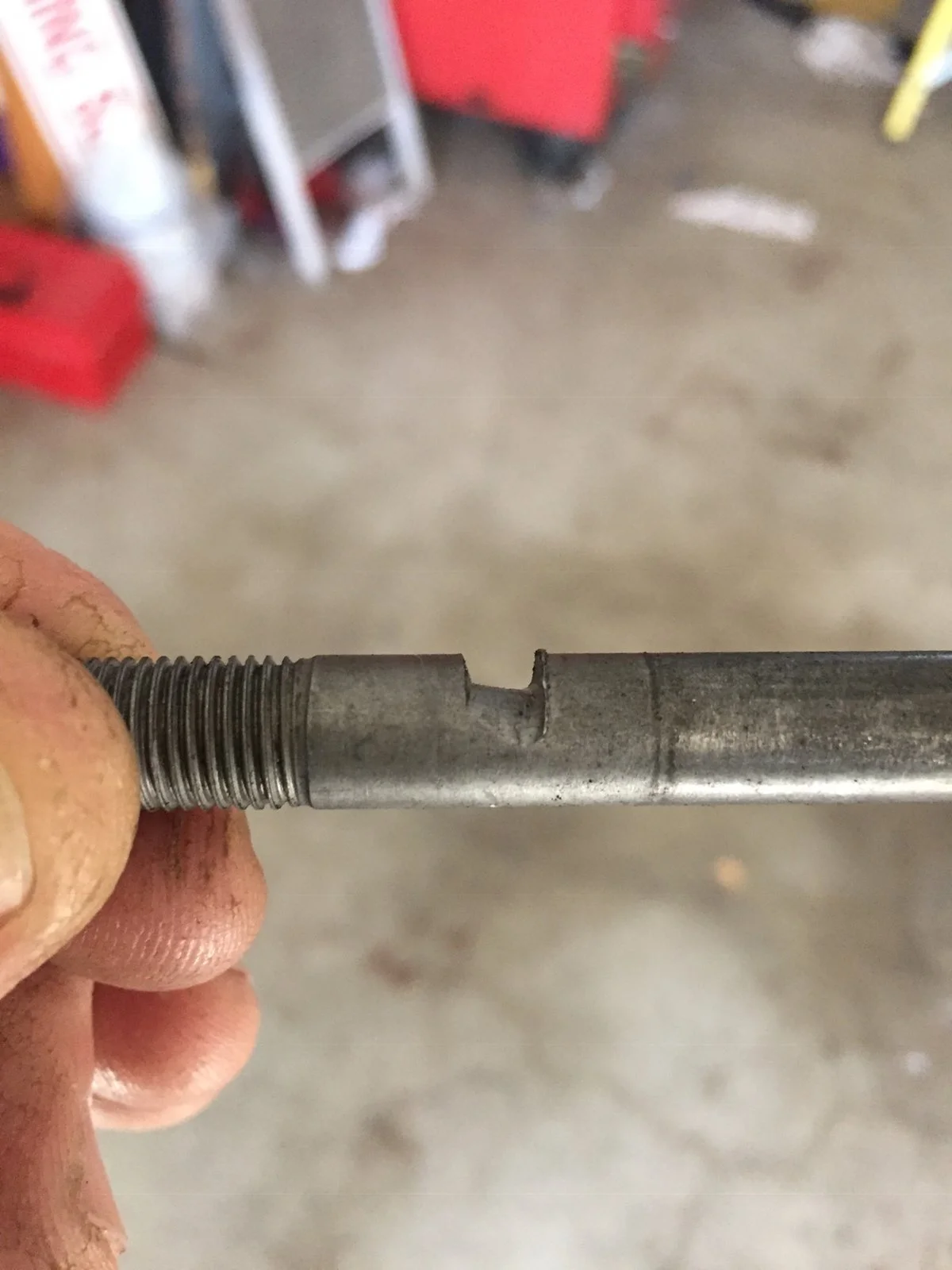

I did pull the heads off on the weekend and brought them to the machine shop. They found 8 rocker studs damaged. This motor has all full roller rockers and no guiset plates. So good chance rockers eventually dug into the studs. Most of the rockers had some damage to the roller tips that were burned or scored. I removed all lifters and the all still look great and so do the cam lobes. So it looks like I lucked out on the cam. Rebuilding heads now with new seats, valves and new springs and 16 new roller rockers with just rollers on the tips. Will post once heads are back in on motor for results.
Got heads back from machine shop. Replace 8 rocker studs. Some were starting to notch (see pic)and some were badly notched. Replace damage studs and repaired valve stems that were mushroomed at the top and replaced all springs. Going to install heads this weekend and retest.
