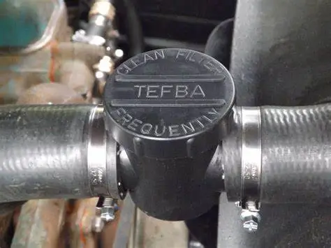

Get a tefba radiator filter to protect that new radiator, old blocks scale off rust, lots of rust.
Worth the 75$ IMO
