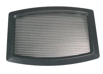

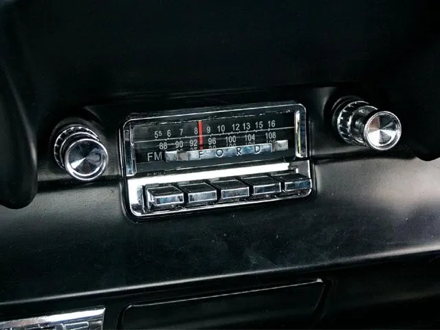

Well, you'll get a lot of conflicting opinion here, so stand by, but I've worked on a number of these, a visual duplicate of the 66 AM/FM, never had a failure. Best hookup is with a 4x10 dual voice coil front, and 6x9 dual voice coil rear (under a repro rear speaker grille) with both left channels routed to the front, and both right channels to the rear. Remote CD changer in the trunk.
They're around, I know Glazier Nolan stocks them.
The speaker setup I suggested is "old school". Back in the day most radios were single-speaker, and if there was a rear speaker, or in rare cases a rear speaker reverb, you'd get excellent sound for the time. Then stereo came along, and speakers were placed left/right. Of course, doors, or kick panels are closer together than the dash and package tray, so with the earlier style layout you actually get better separation. It also doesn't hurt that the completed installation looks completely factory, and doesn't require sawing any holes in your car.

My brother put one of those Custom Autosound USA6 radios in his fastback.
It's nice to look at, but it doesn't work, it was BARELY used. I've heard a lot of similar complaints about the lifespan of CAS radios, I won't be going that route if I decide to drop my DIN radio
HI,
I can offer you a great deal on a Custom AutoSound hidden radio with CD changer, complete w/OEM instructions etc. PM, if interested.
I will now offer, you can have your OEM radio upgraded to include front and rear Fader and side to side Balance abilities. Also, you'll have full FM capability with 140Ws. Thrown in there, is a MP3 port. but, it sounds like you may not be interested in that part. Doing this upgrade, you get to keep your OEM looking radio.
I hear this a lot on the internet, but the Mustang shop near here has had very little trouble with Custom Autosound radios. Doesn't mean there isn't something better, though.

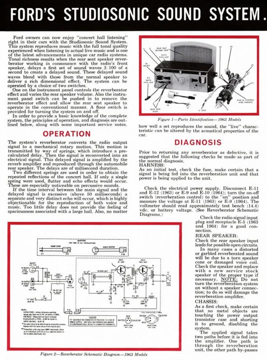

That old school reverb stystem is pretty cool.
I have heard some people speak badly of those units too. What other retro style units are there? Also, I still don't see how the display on that one works.
As I recall from those days, these were an integration to the radio system, not something with a display. It was more acoustical in nature with a stadium concert sound dimension.
Thats kinda what I thought it was. It was a neat idea. I guess thats what the Mach 460 or Mach 500 stereo system was back then.
