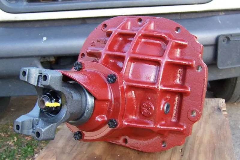

Bigger bearing would be the benefit.
Doesn't the 67 use the bump stop style?

Thanks for the reply. Yes the picture you posted is the stock pinion support. But I have read the original pinion support was prone to failure?
