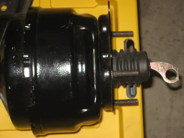

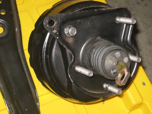

Here's what the Bendix with spacer looks like:
