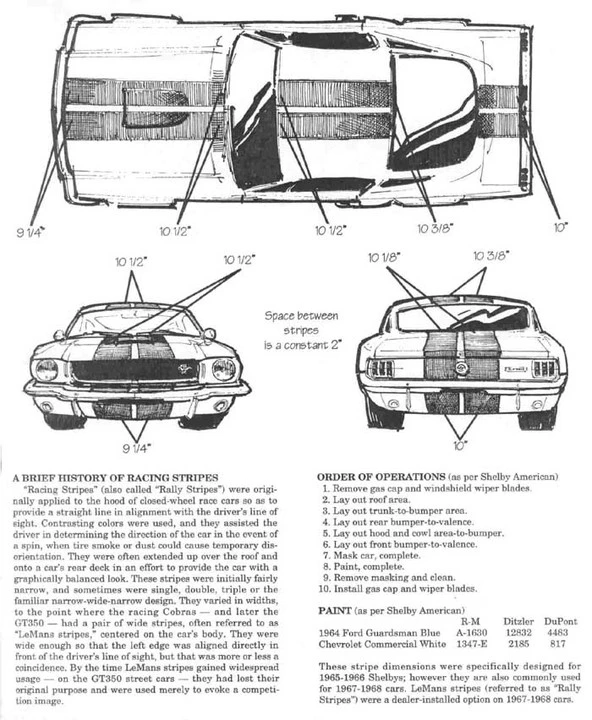

I got my 67 in the shop for paint, and was going with the two stripes front and back. Does anyone know the sizing of these stripes? I'm thinking 10" with a 4" space and 10"
10x4x10??? Anyone have a clue?
Be very careful. If you paint them straight, they'll look crooked.
Cool, I seen this posted when I did a search. I'll drop the diagram off at the shop before tjhey lay down the paint.
