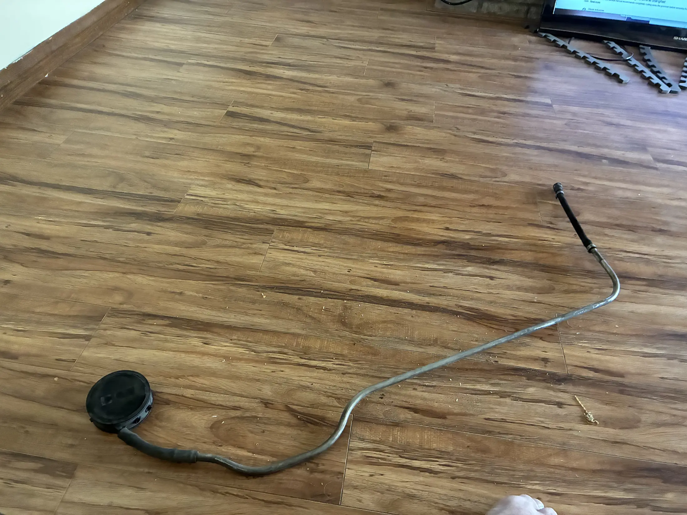

I'm replacing the fuel tank, and I think one of the burglars stepped on and broke this. Apparently part of smog system, and has a manifold, two of the nipples for which have broken off.
Can anyone tell me what it's called so that I can order it?

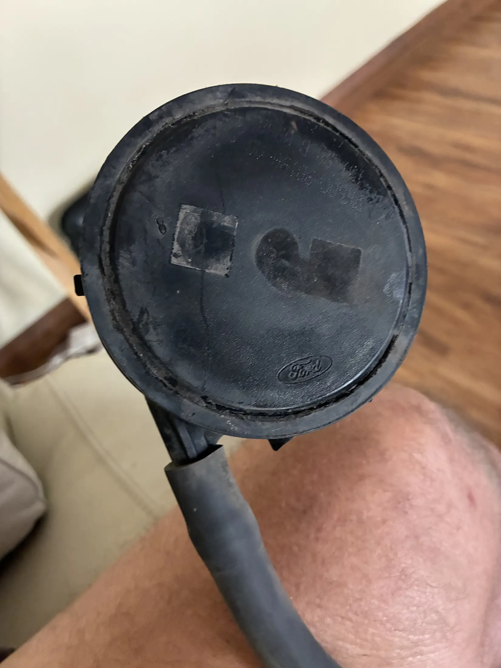

there is some readable text on it, but most isn't readable:

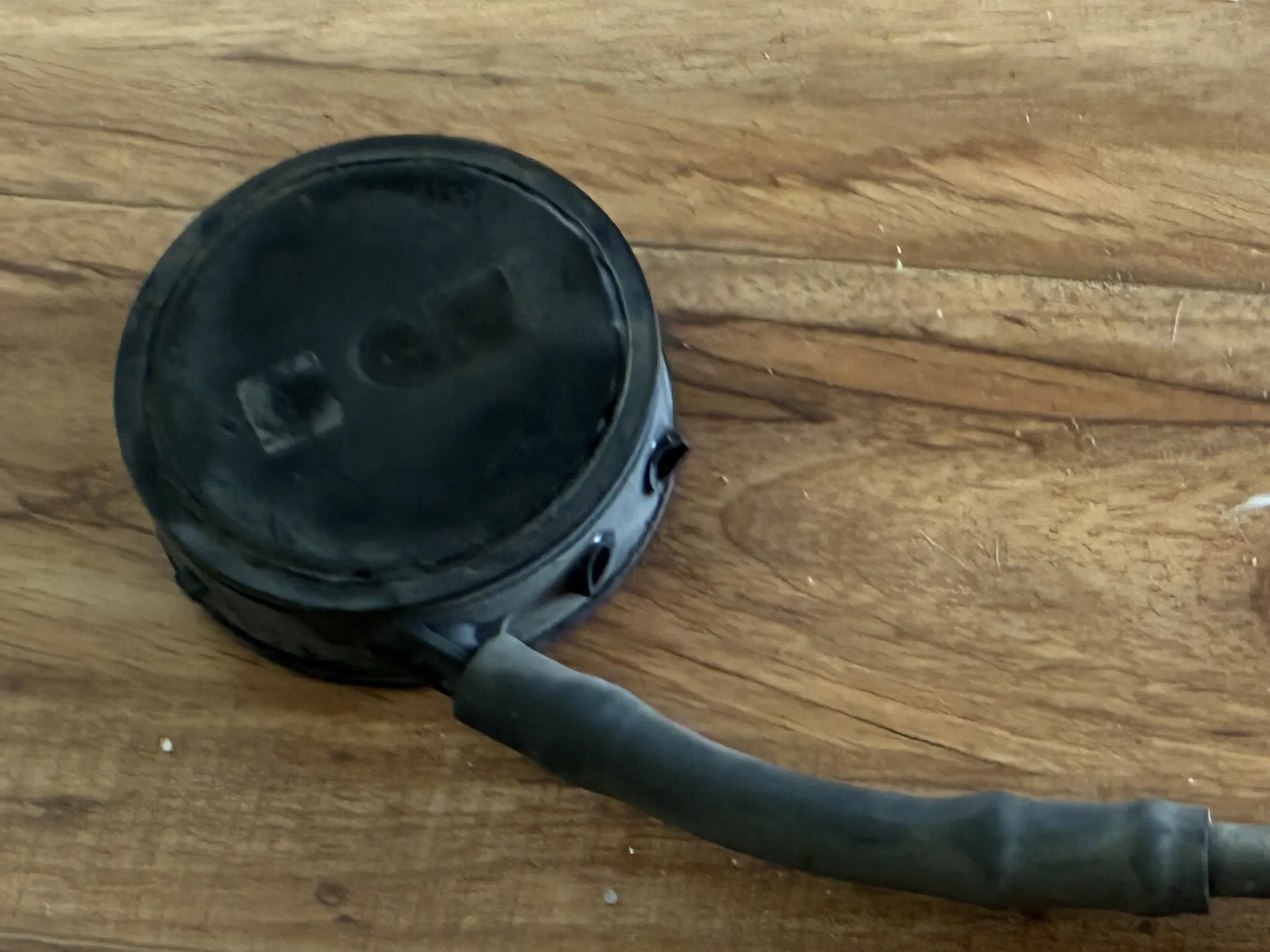

But looking at the part, mine has three nozzles (two of which were broken off), while this seems to have two.
Mine:

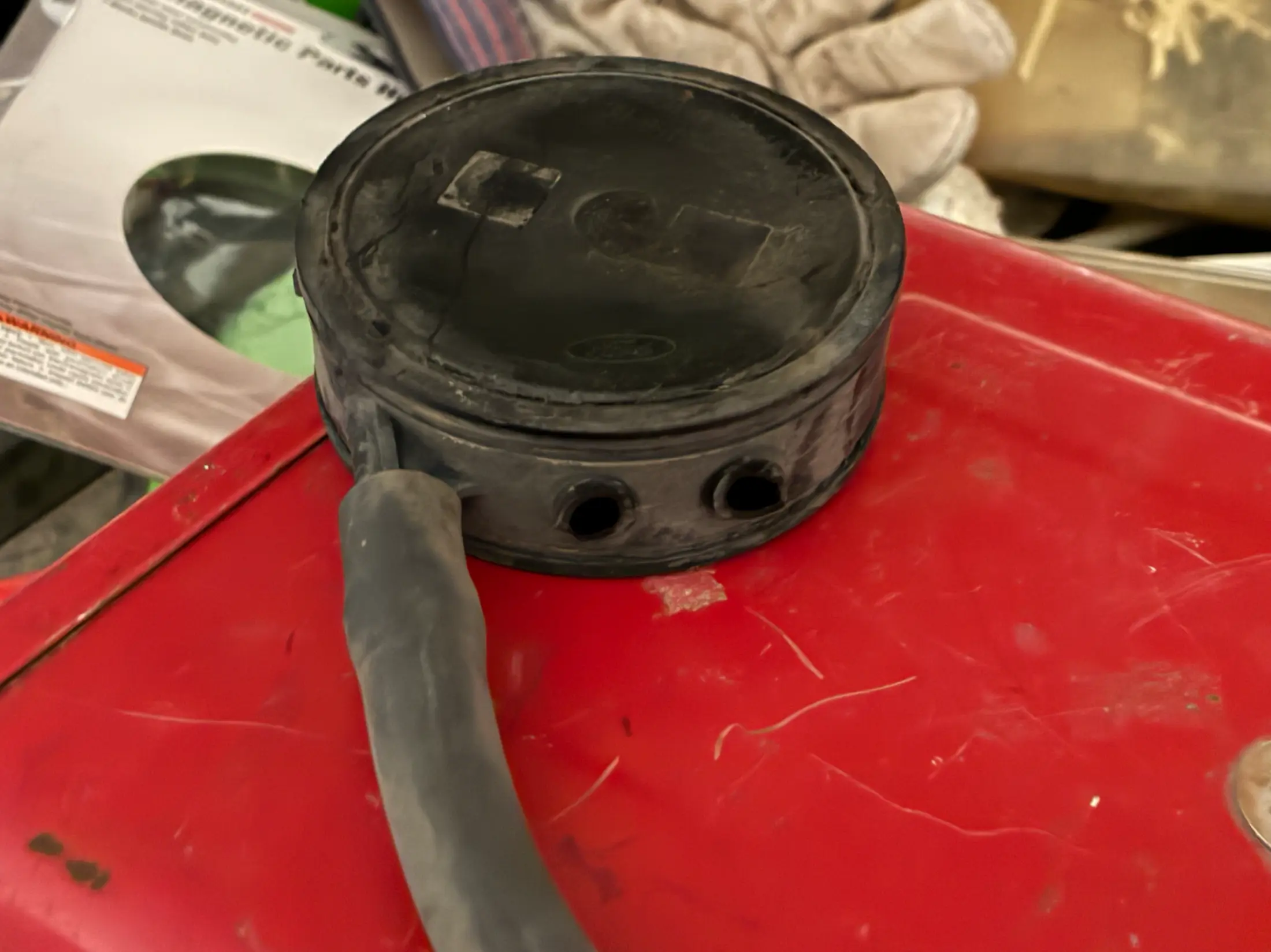

the linked one:
also, the linked one seems to have a mount point protruding from the plane with the nozzles.
Looks like thats a lovely 98 only part and not in repro. Find one from a junk yard car. 1998 has a standalone tank and odd ball voltage regulated return style fuel setup. Reading (with AI help) you can modify a 2 port one to vent tank properly, but it'll potentially make the tank itself a pita to fill.
Or take this and epoxy or insert brass nipples into the broke area to reconnect the vac lines.
