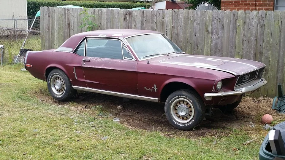

I have a 68 mustang GT. With a 302. J code. It's been a slow process getting her back on the road!
G"Day Bryceson, just wonder and i'm sorry if this sounds like a stupid but how can i identify that it is a 68 GT besides the "J" code and the gt stickers on the side? Just wondering because i have purchased the same vehicle also... I've done a search etc all over the net and have found nothing that will help me with the identification... So any help would be greatly appreciated...
Cheers Bounta
