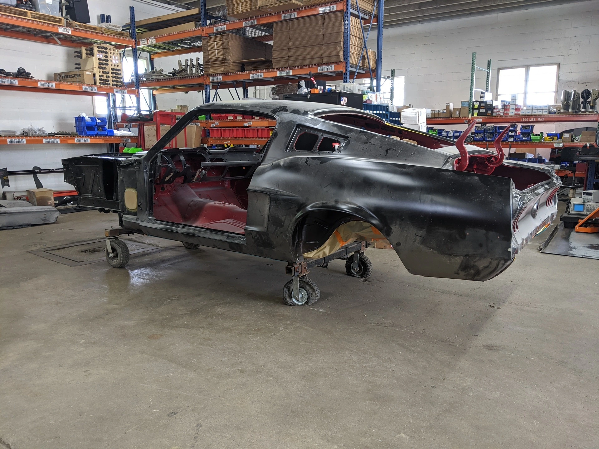

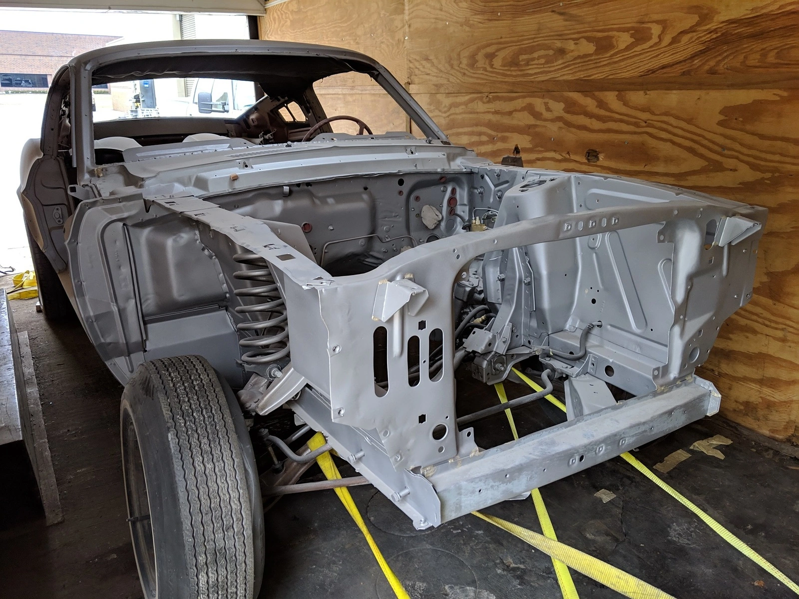

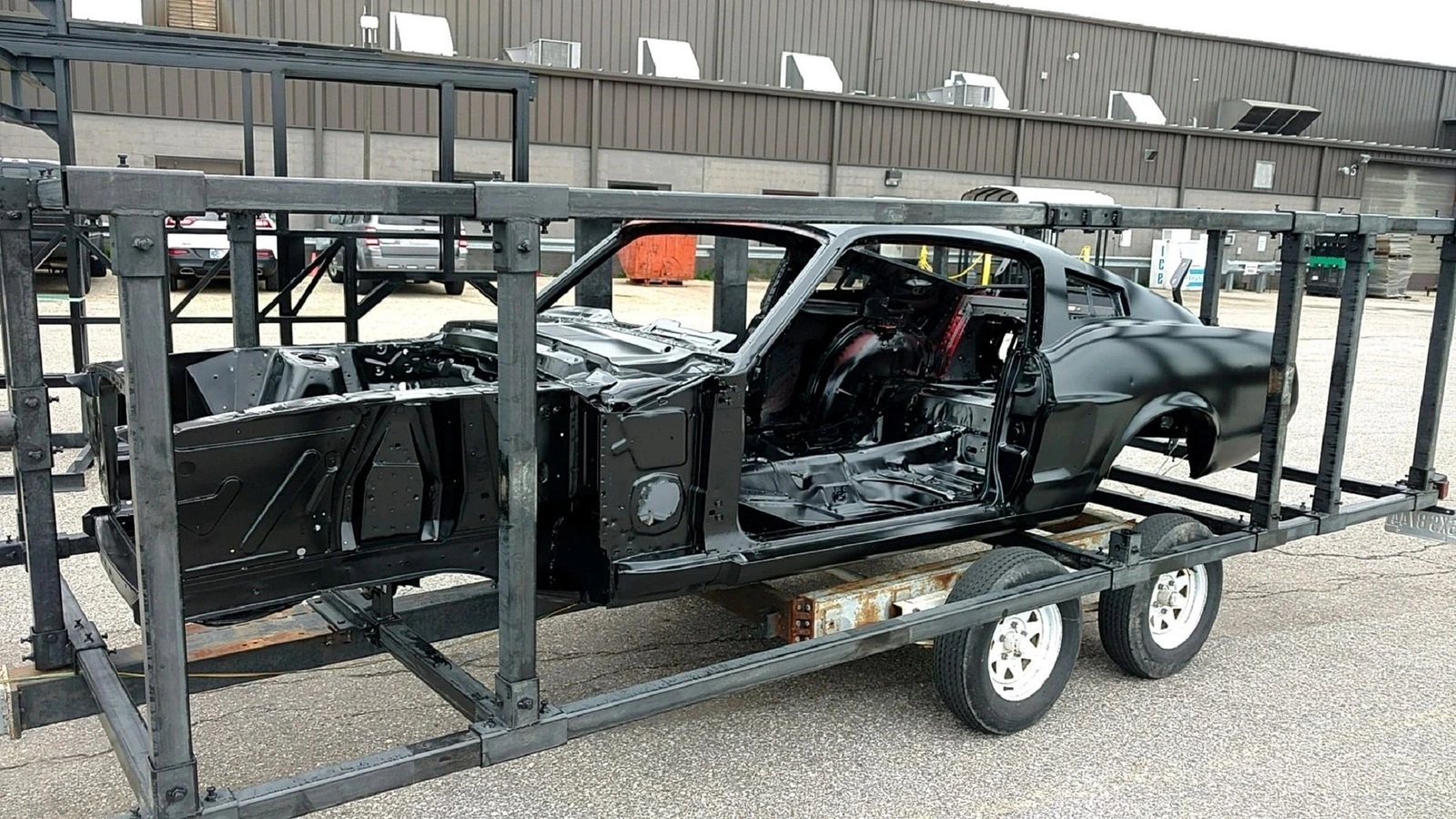

A little back story

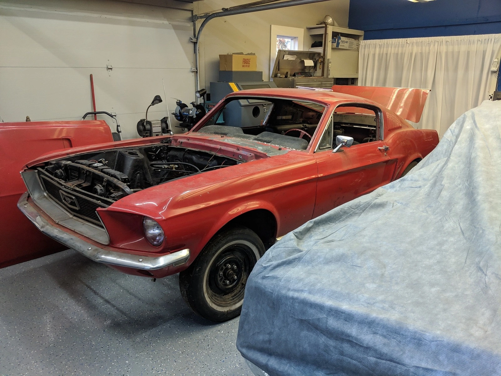

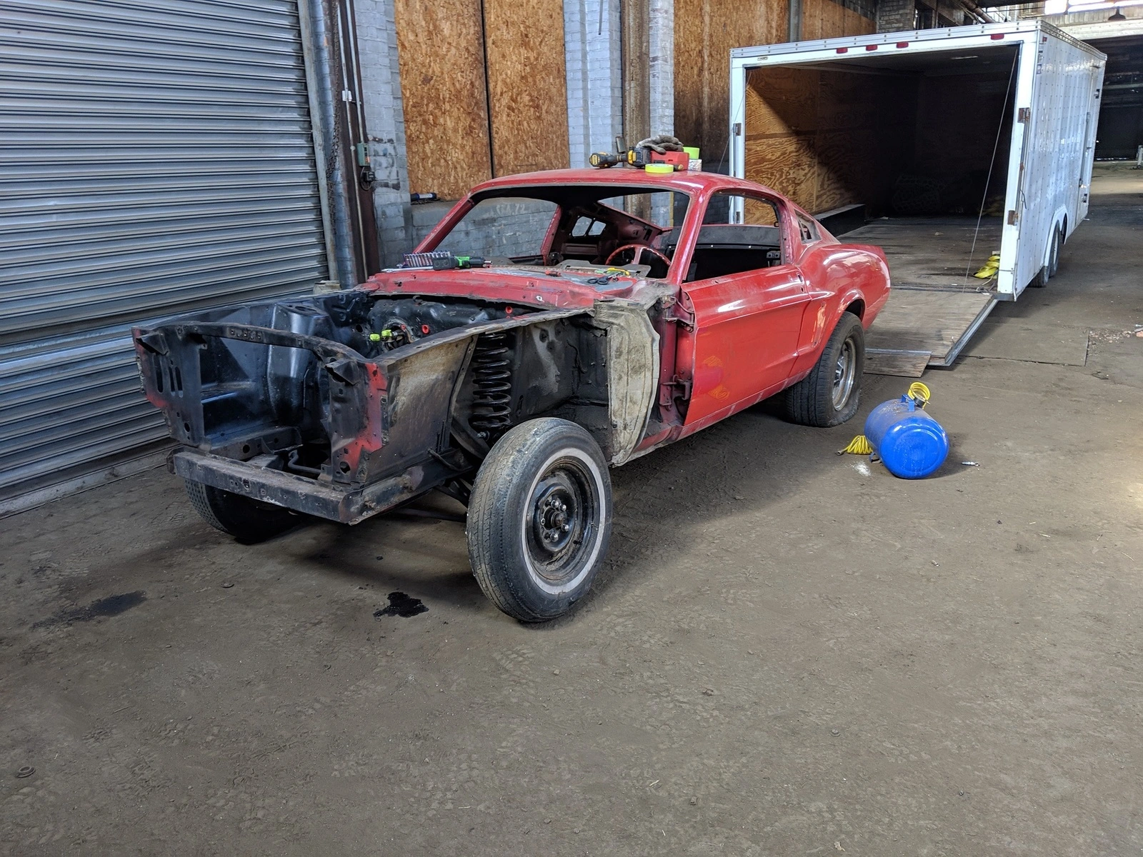

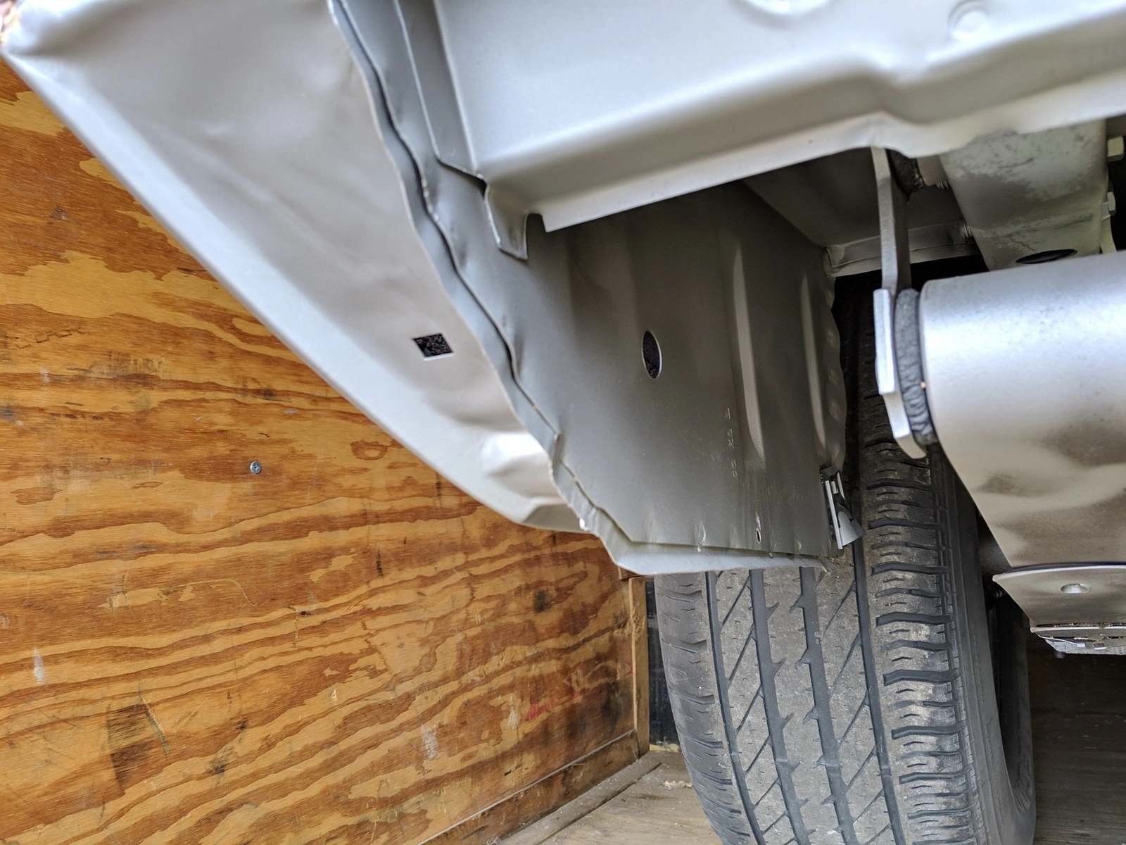

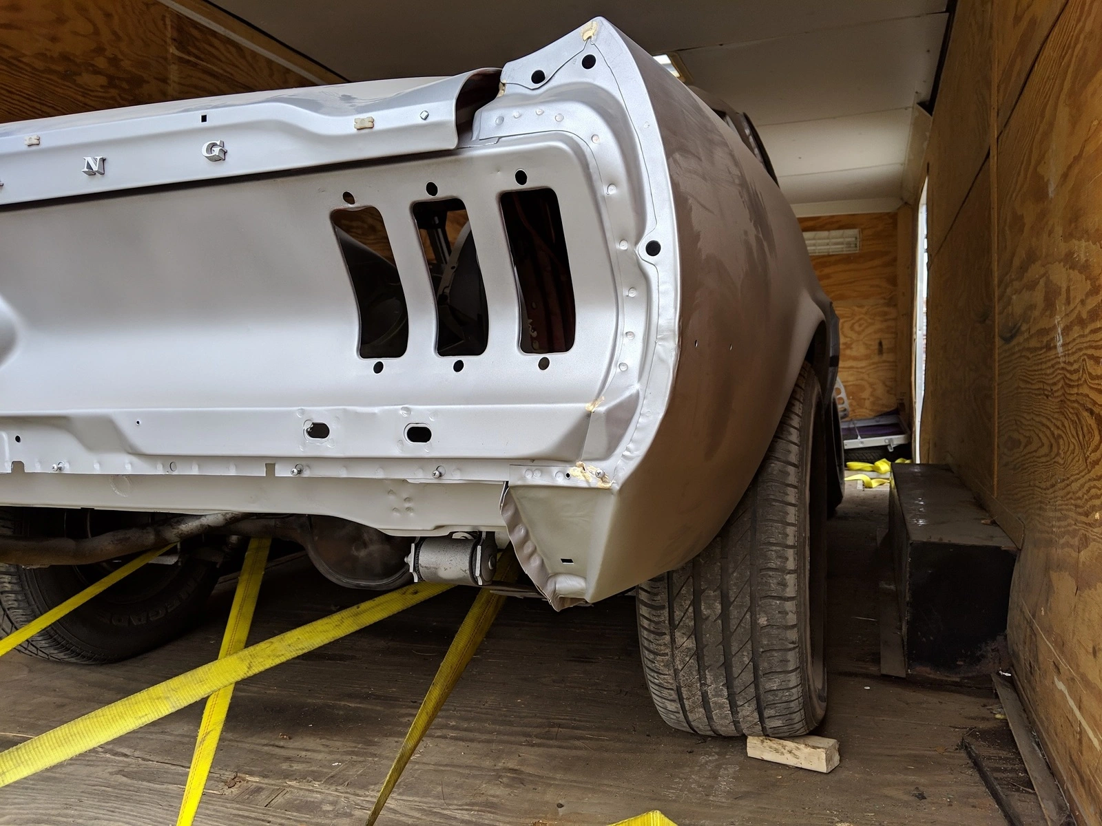

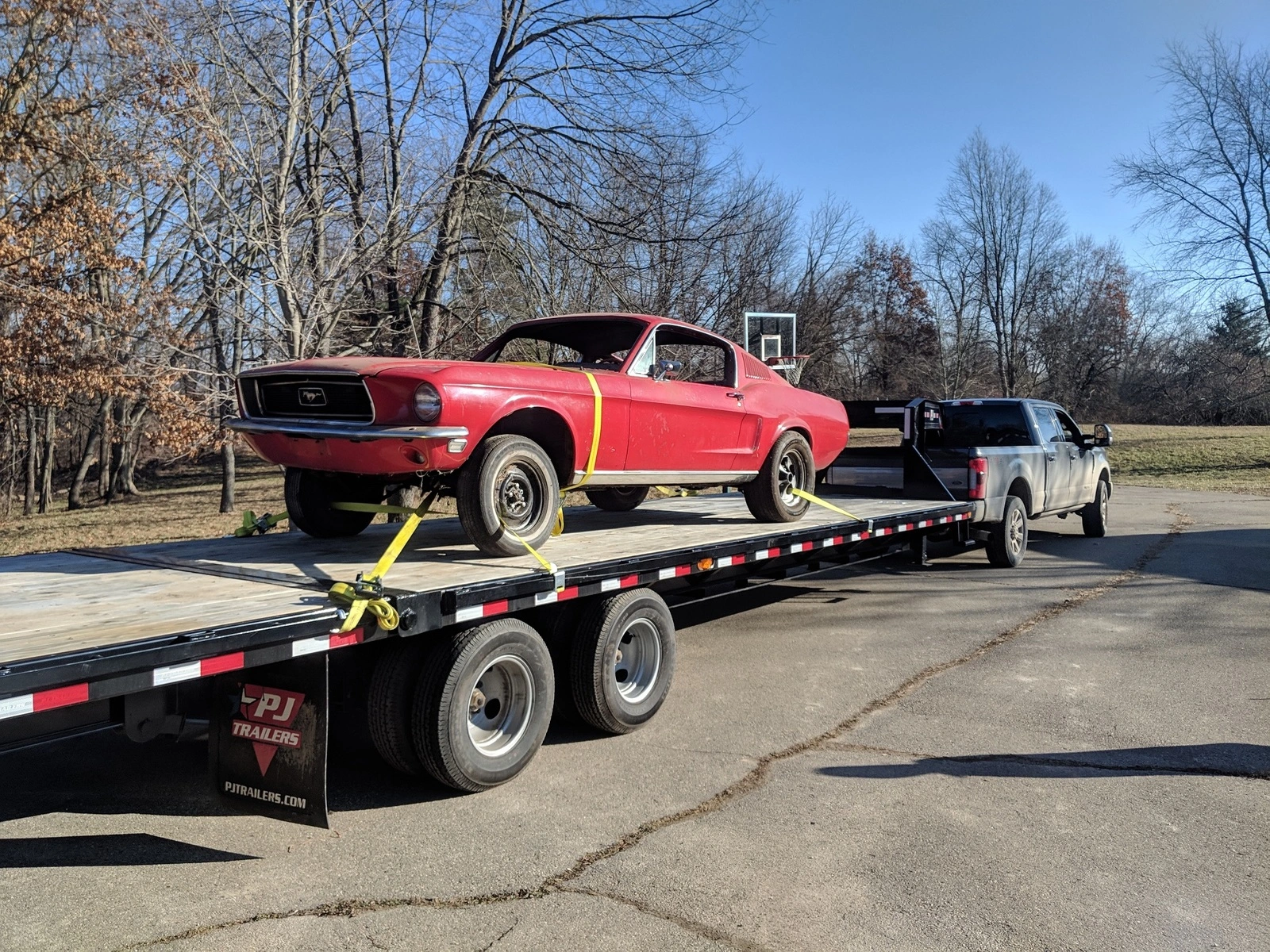

I bought the car when I was 19 from a friend I went to school with. The car was super nice & complete. He had rebuilt the engine, and didn't get around to putting it back together. I had bought it from him as a basketcase. The car has sat until I was able to afford to build it how I wanted. It is a 1968 Fastback J-Code with Factory A/C, Red/Red, & auto. My good friend and I who has experience with these cars & racing has decided to help with the project.
I recently build a pretty unique race car all on my own, and want to build an ultimate street/road race vehicle out of my beloved mustang. The race car I built is a 1977 Rolls Royce with a Viper drivetrain that competes in the 24 Hours of LeMons. www.instagram.com/rollsroycedoesntcare

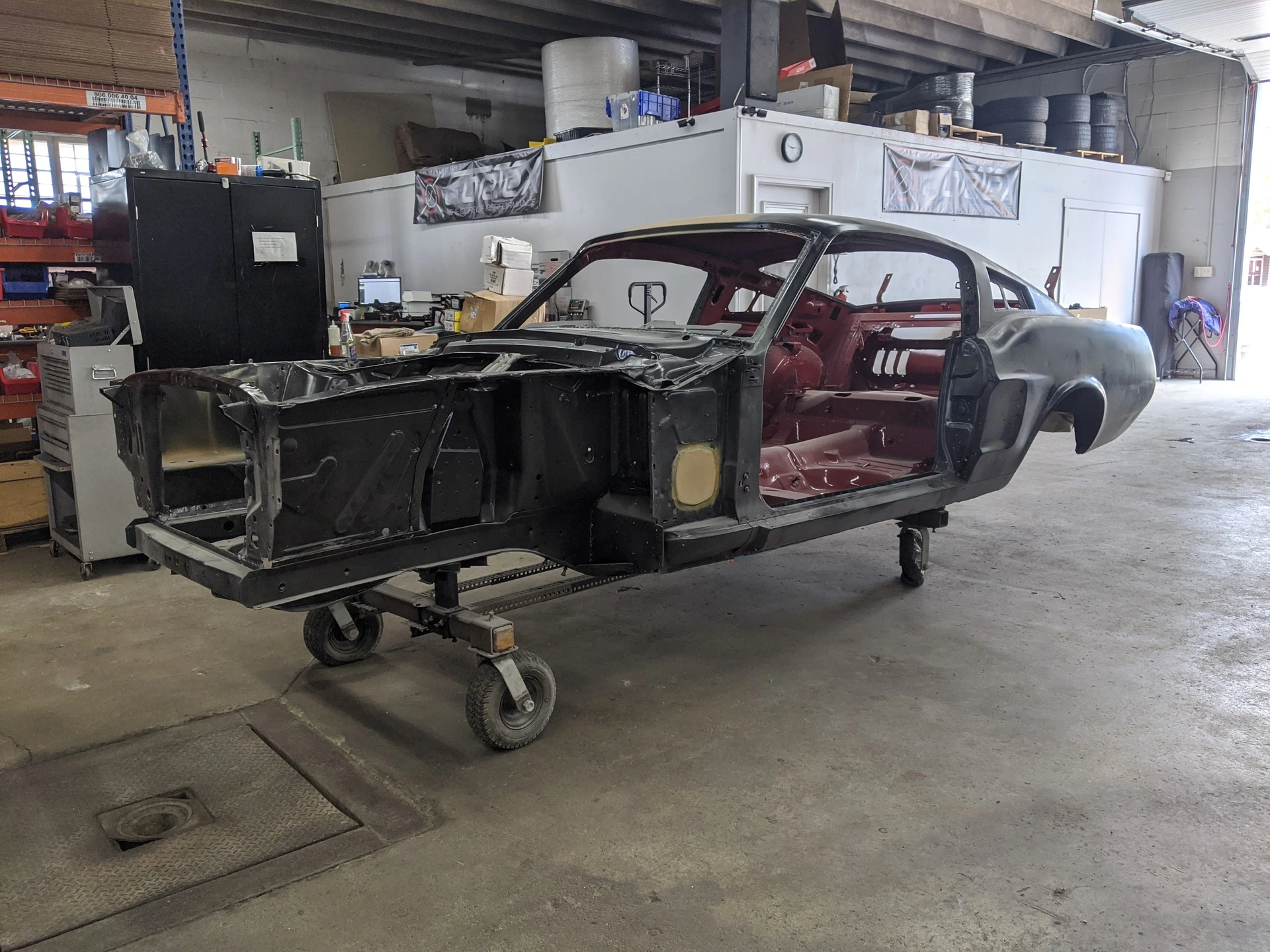

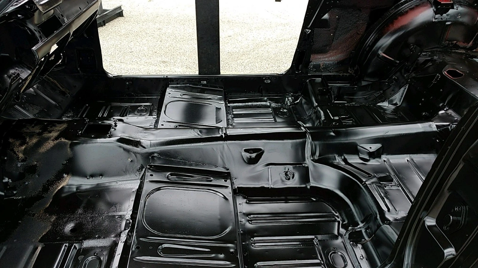

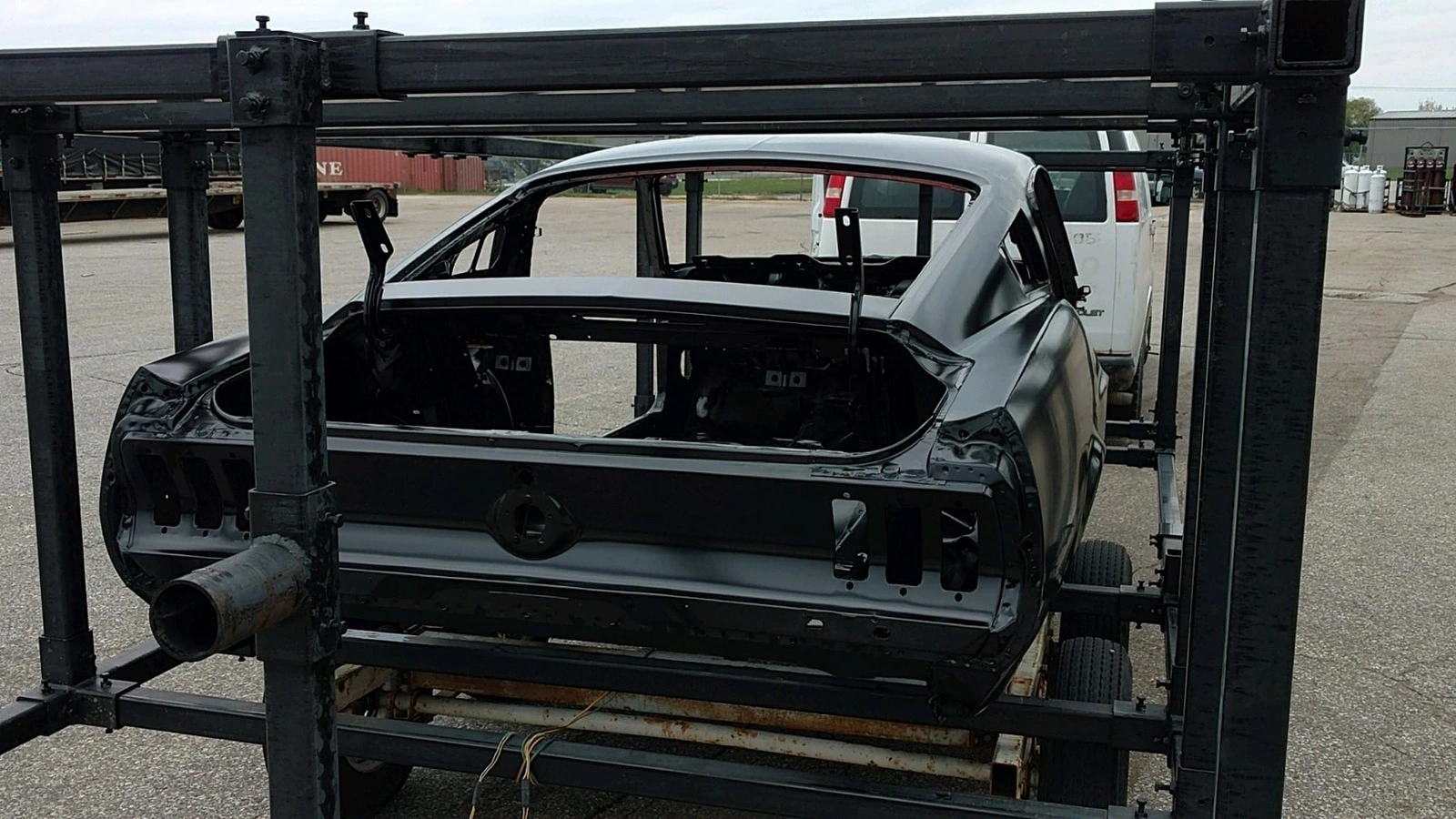

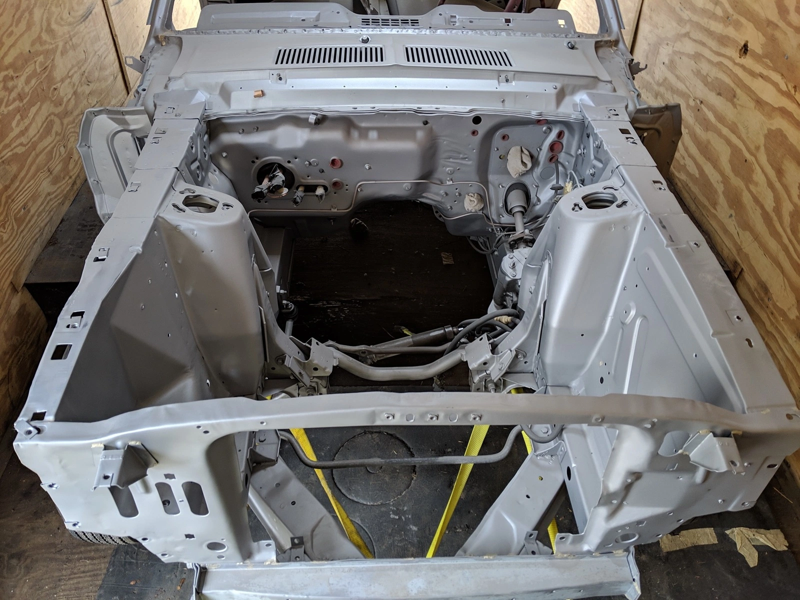

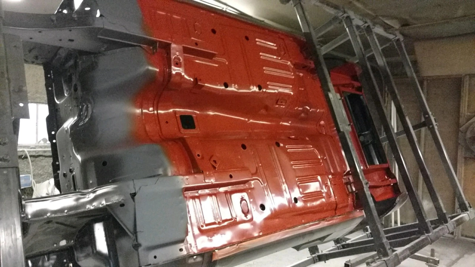

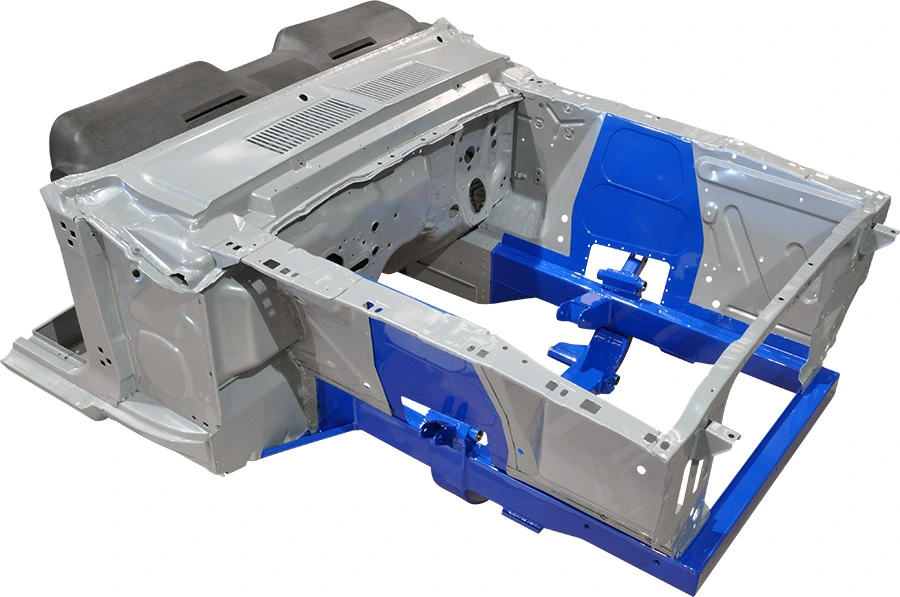

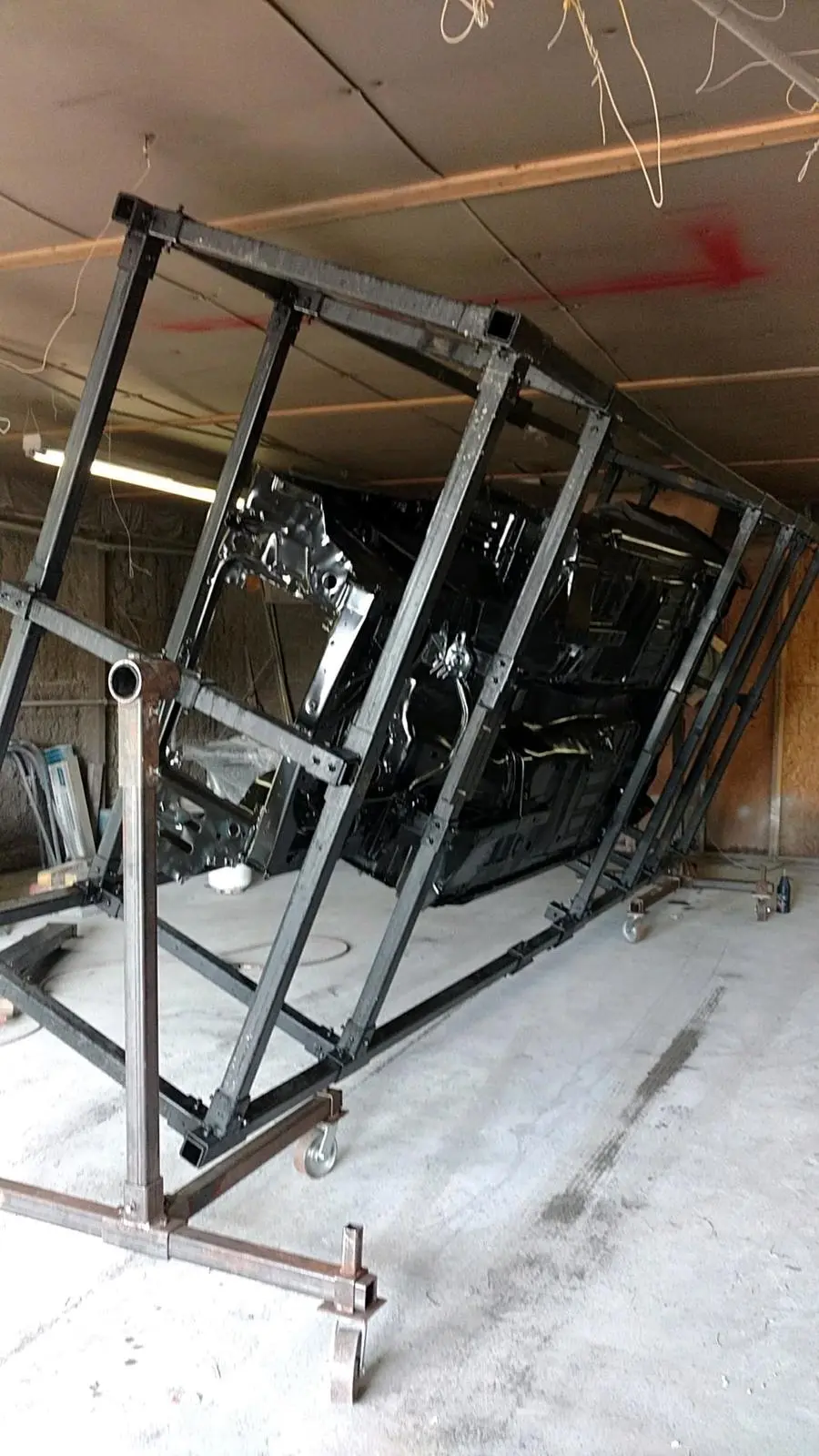

First thing was disassembling, then had it sandblasted, dipped, and ecoated. We mounted it on a Rotisserie. We painted the bottom and interior in factory colors.
Now we are trying to figure out what components to go with and what the best way to swap the drive train is.

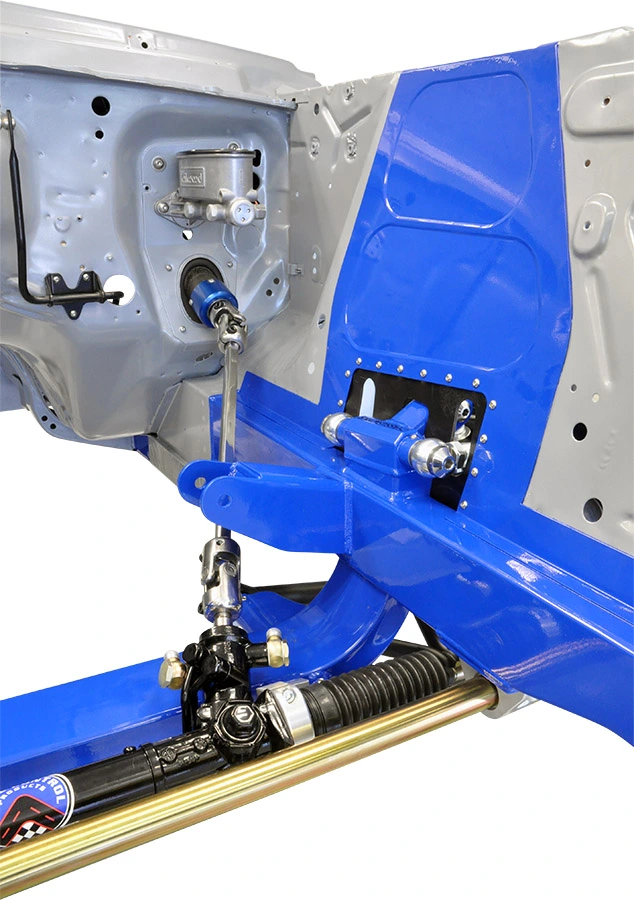

3. What quick ratio manual steering options are available (if any) I know TCP offers a power steering pump conversion for the coyote, but a manual/EPAS setup would be really awesome for track performance and being able to dial in assist for street driving.

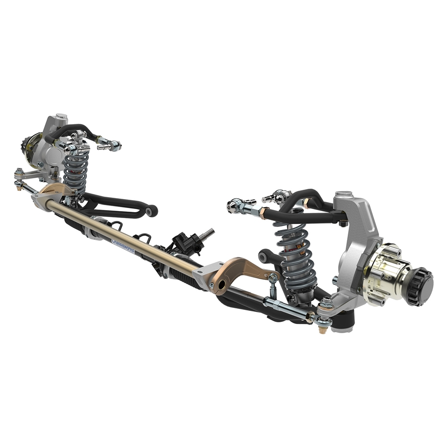

If you want the BEST shock tower delete front suspension...you want Griggs...possibly Detroit Speed....rear end, probably Griggs again....but if you are talking removing shock towers...you are already doing major surgery....I wouldn't worry about more. I did see one guy with a Coyote engine that retained towers...notched towers and a mcphereson strut front end, but still...I am willing to bet with a little work you could retain full shock towers, your manifold angle is much more favorable at 90 degrees than mine was at 60 and the Coyote isnt very much wider than the Cyclone....also helps that you have the 67 towers rather than the 66 ones.
As far as steering...for quick ratio, you are best off just using a manual rack with 18:1 or less ratio with an under dash EPAS unit....a lot of people are using Toyota or Nissan under dash units now...if you retained the shock towers, went front sump, you could use a 16:1 box and a shelby quick steer arm and come out with very quick steering EPAS indeed
P.S. If you want to spend a lot(even more than Griggs)...you are best off with schwartz:
P.S.S. That is one monster rotisserie/body alignment jig

Well, Griggs used to be the best as of a few years ago(or so the popular opinion went anyway). As far as manual racks go....you can find them in various ratios, but before you can decide on a rack you need to find what suspension you are going with...the TCP stuff for instance is rear-steer, made for keeping shock towers...and while keeping shock towers has certain advantages...one of the disadvantages is that the steering geometry dictates a higher engine mounting than front steer...especially if you are using rack and pinion instead of a steering box and drag link. In the end, people tend to have the best steering results with a stock steering box over rack and pinion, at least short of one of the high dollar suspensions like Griggs, I don't know the details on those as far as steering capabilities. If you dont like Schwartz, there is also always Roadster Shop:
Looking at it, the control arms are likely to give good negative camber gain...far better than the Mustang II style suspensions...maybe even better than a modified stock setup...but you will certainly have to cut the car extensively to install something like that....same for any high dollar suspension...this is why most people go with SoT or a similar type setup...I wouldn't cut the car you have up at all, the Voodoo engine is awesome...but that mustang is too nice to do anything ut restore...there are plenty of fastback shells much more suited to this type of build

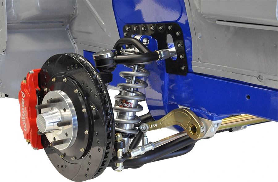

That Roadster shop stuff looks really really cool! There are 2 frame variants and one doesn't cut up the car all that much. Definately going to look into it!

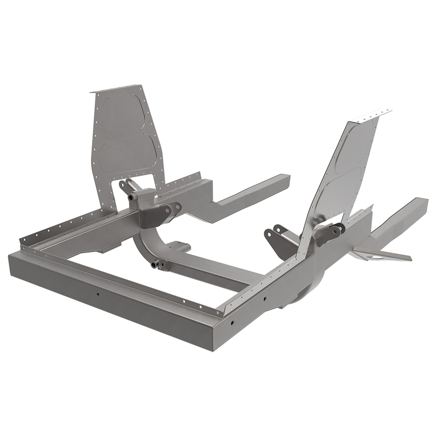

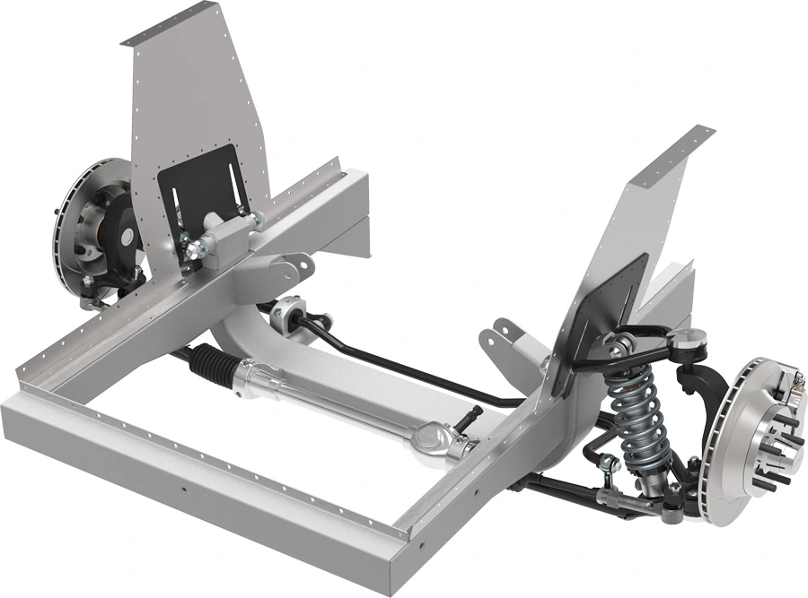

This is the TCP setup I was looking at. You cut the old frame rail out and add in their whole new section. It looks pretty slick and OEM looking.
After doing some research, it seems that without cutting up the rear floor a "bolt in" style 4 link can't get the arms in the proper position to get the anti-squat numbers in the right area. It seems a Torque Arm setup gets you close to a 50/50 without having to cut into the rear floor.
Also, it seems a chassis mounted watts link is the way to go for rear axle centering as well. Offers a way to adjust the pivot point up/down for roll center adjustment, and it keeps the roll center as a fixed part of the chassis instead of having the roll center move around like a panhard bar or having a watts link pivot point mounted to the axle housing.

One thing to note: you can always de-power a power steering rack if you can't find a manual rack with a good enough ratio...it takes some dissasembly and modification, but its easy enough to do(depowered correctly, not just looping the lines)

I didn't know that was possible reliably. Did some research and think this is what I'll do. Super happy!
Are you familiar with what's needed to de-power it correctly?
Ah! Perfect!
Only vaguely, read through it a few times but never actually did it on any cars, its pretty simple though, dissasemble and cut a "seal"(for lack of a better word) internally which stops any fluid causing resistance, then grease and reassemble, fairly common Miata mod:

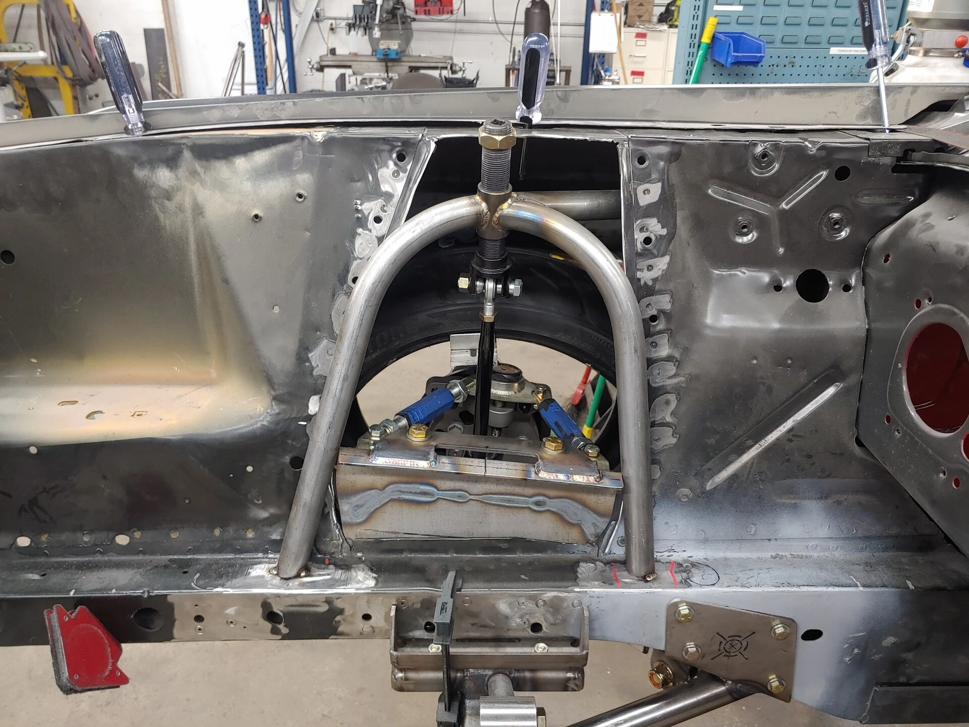

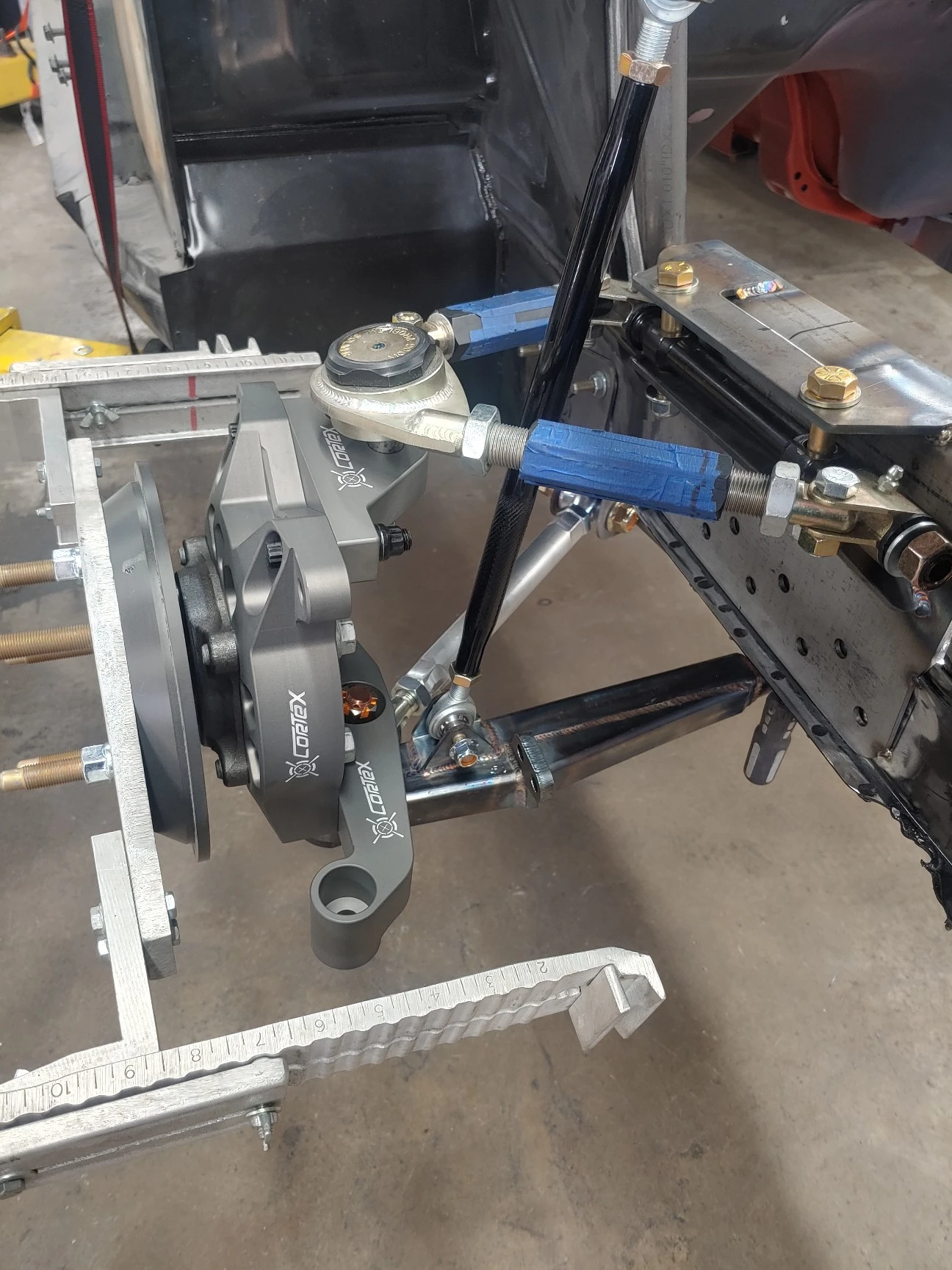

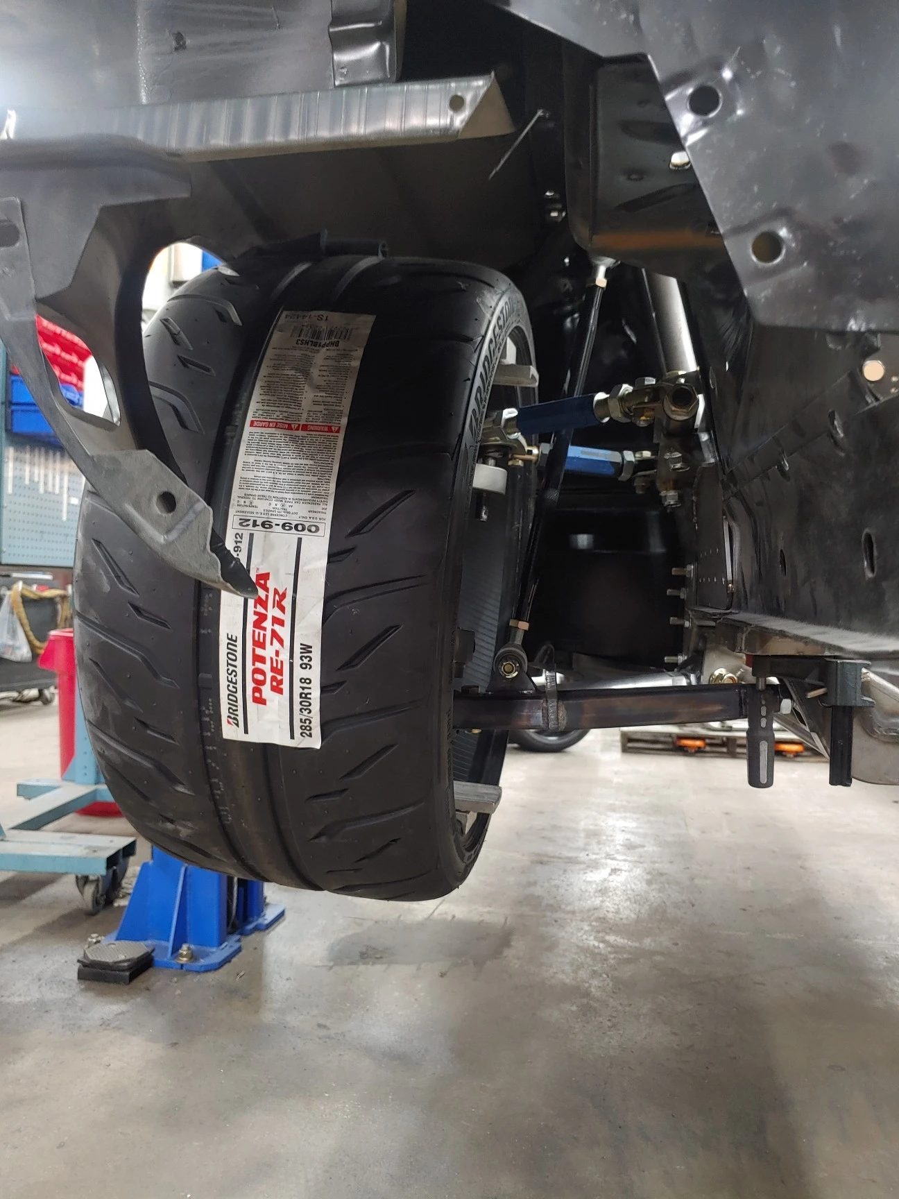

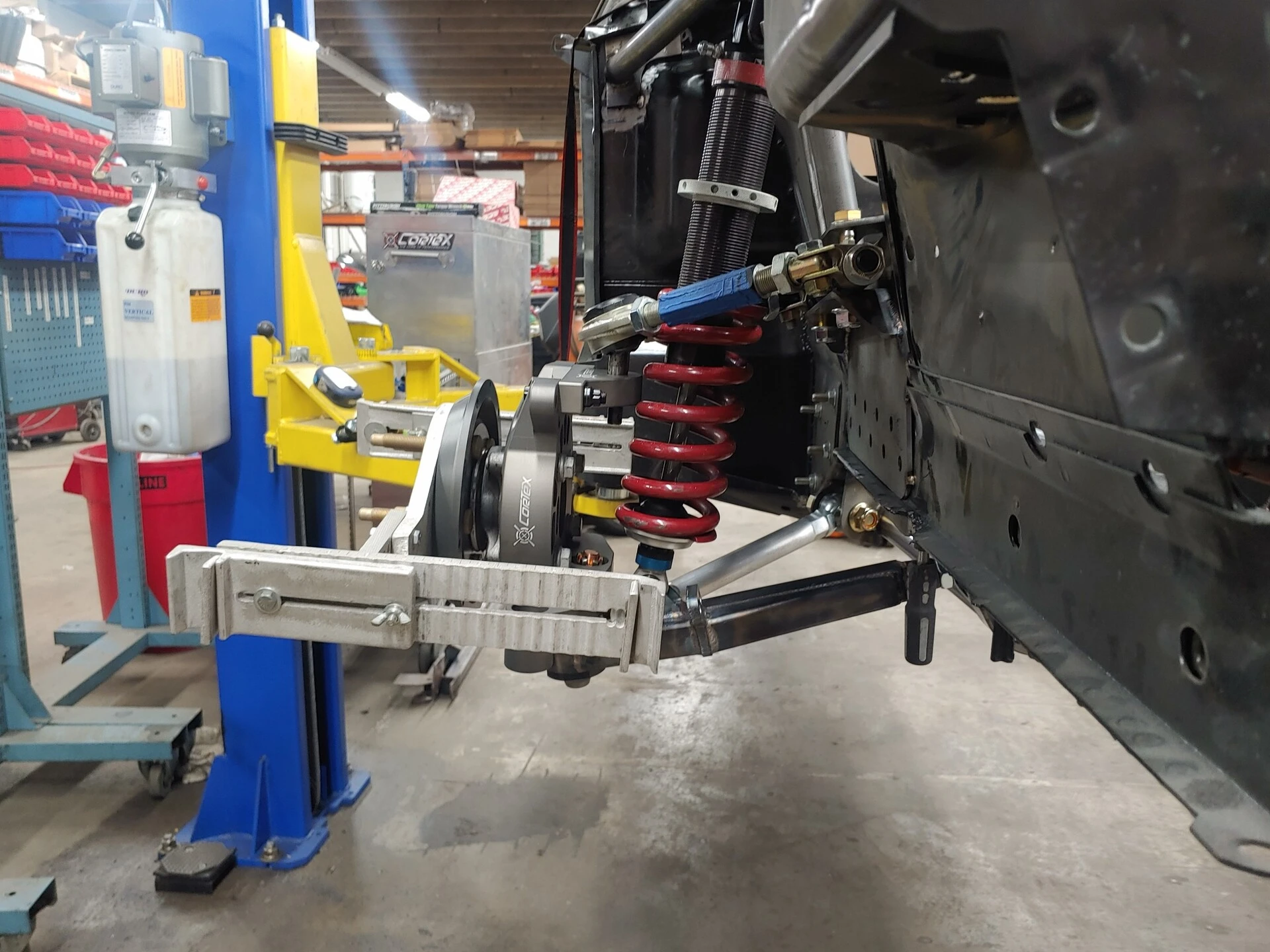

I have been spending hours every day and talking to different companies and have made some pretty good progress.
One of the biggest things I came up with, is how many companies lack in the engineering department & don't necessarily engineer their parts to work optimally and just focus on having them fit a certain way and look nice.
Most of companies I talk to either said they couldn't give me suspension geometry (things like antisquat, roll center, etc) because they either didn't know what they were, or simply stated they don't give them to customers so they don't get bashed. I mean, that's a big red flag for me....like buying an engine and not being told how much horsepower it has....or a transmission and not knowing what the gear ratio's are...catch my drift?
I am not kidding when I said I talked to every company out there, but I did and it took a while. I don't want to talk about the negative aspects of what I didn't like about most of them so I will focus my discussion on the company I like.
Cortex Racing was the one company that blew me away, and left me really impressed. We spoke on the phone for two hours, and they took the time to answer all my questions with genuine interest. For everyone looking for a top quality product, I would look no further. I am a little different than most, where I enjoy the engineering and setup of the cars. Spending a day at the track and tweaking things like Roll Center, Anti Squat, Spring rates, etc is something I enjoy doing and wanted to make sure I had the ability to do these things.
Also, I don't know if anyone has looked at their cambered rear axle setup. It is one of the coolest things!

Never heard of Cortex...looks like they make some nice stuff...even if the spindles alone cost more than my entire car when I bought it(though the thing was in pretty sad shape then). Why the DCT trans though? Not a fan of a manual trans? If you are going full performance I would seriously reconsider your base car since there is major surgery involved in significant chassis stiffening, by the time you add as much bracing as you truly want...you are going to regret cutting a car as nice as that.....mine was a rusty old T-Code coupe destined for the scrapyard....you have a J-code fastback in beautiful shape.

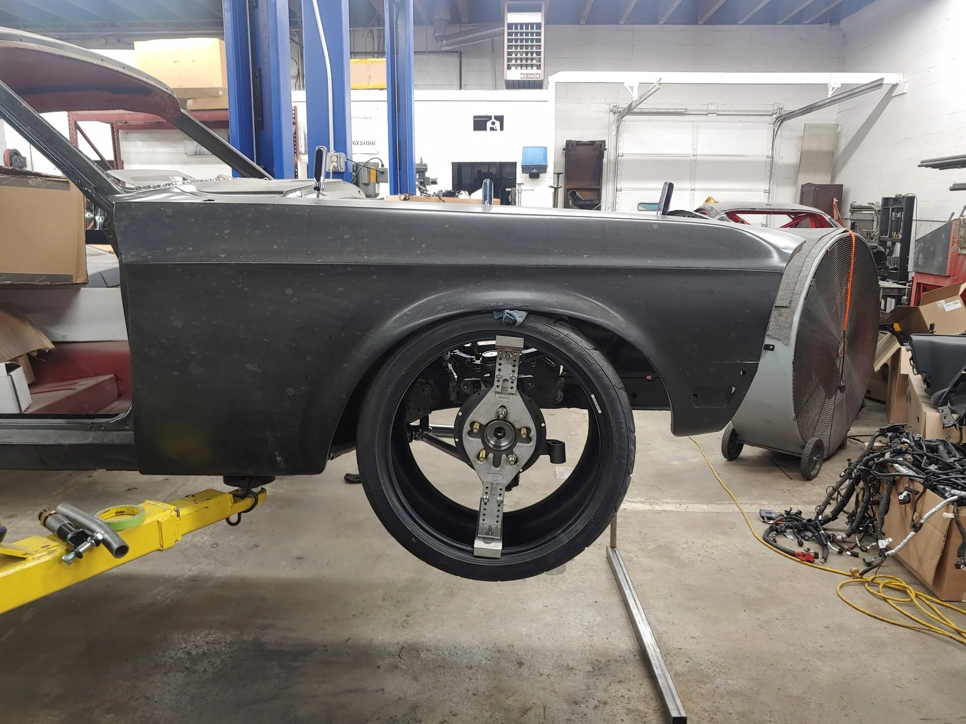

UPDATE:

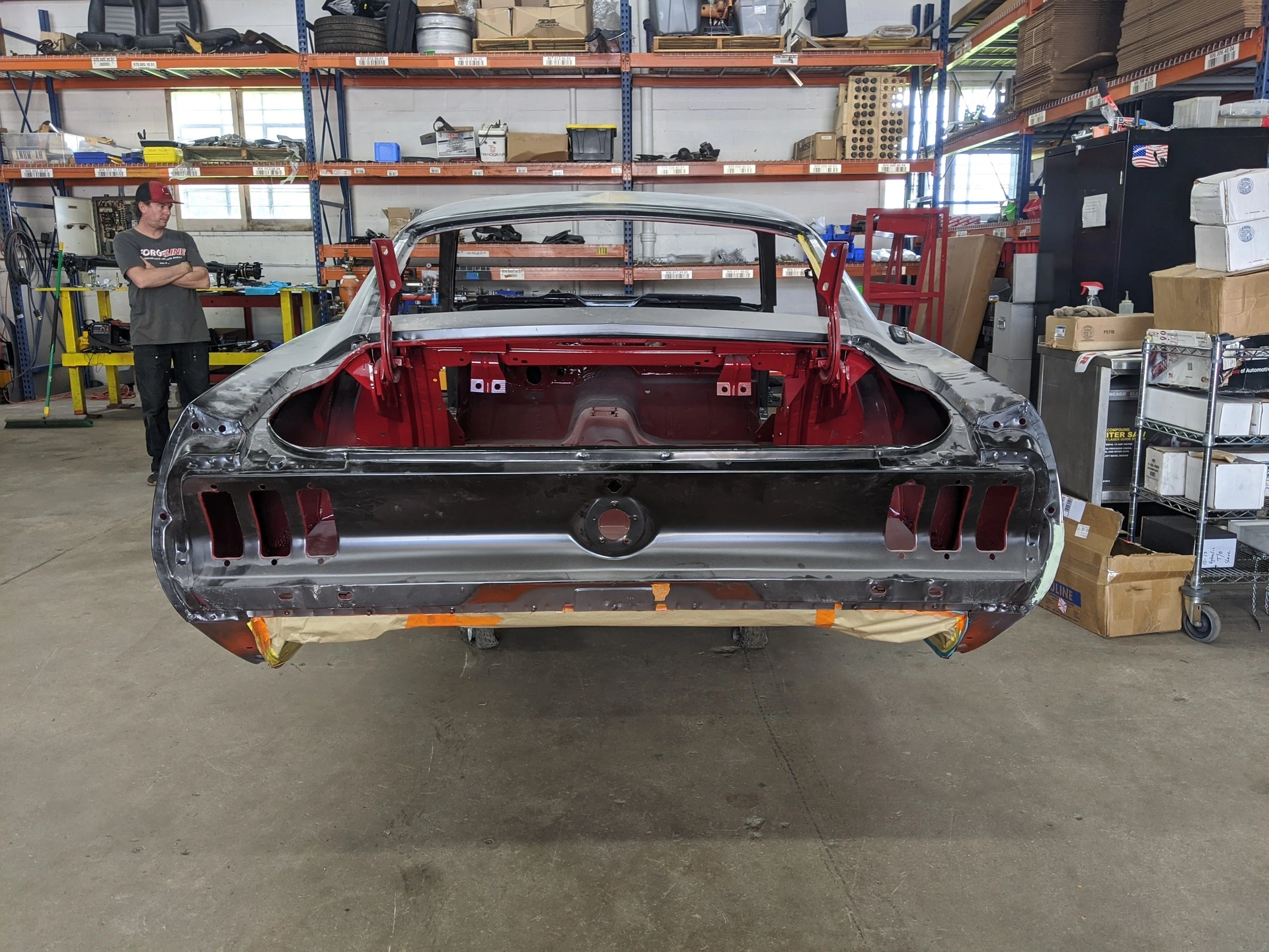

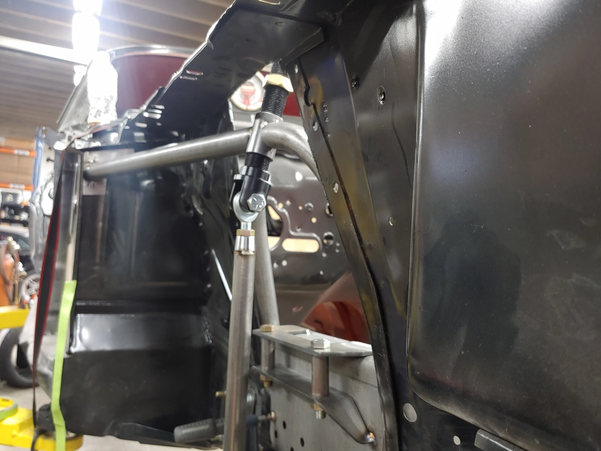

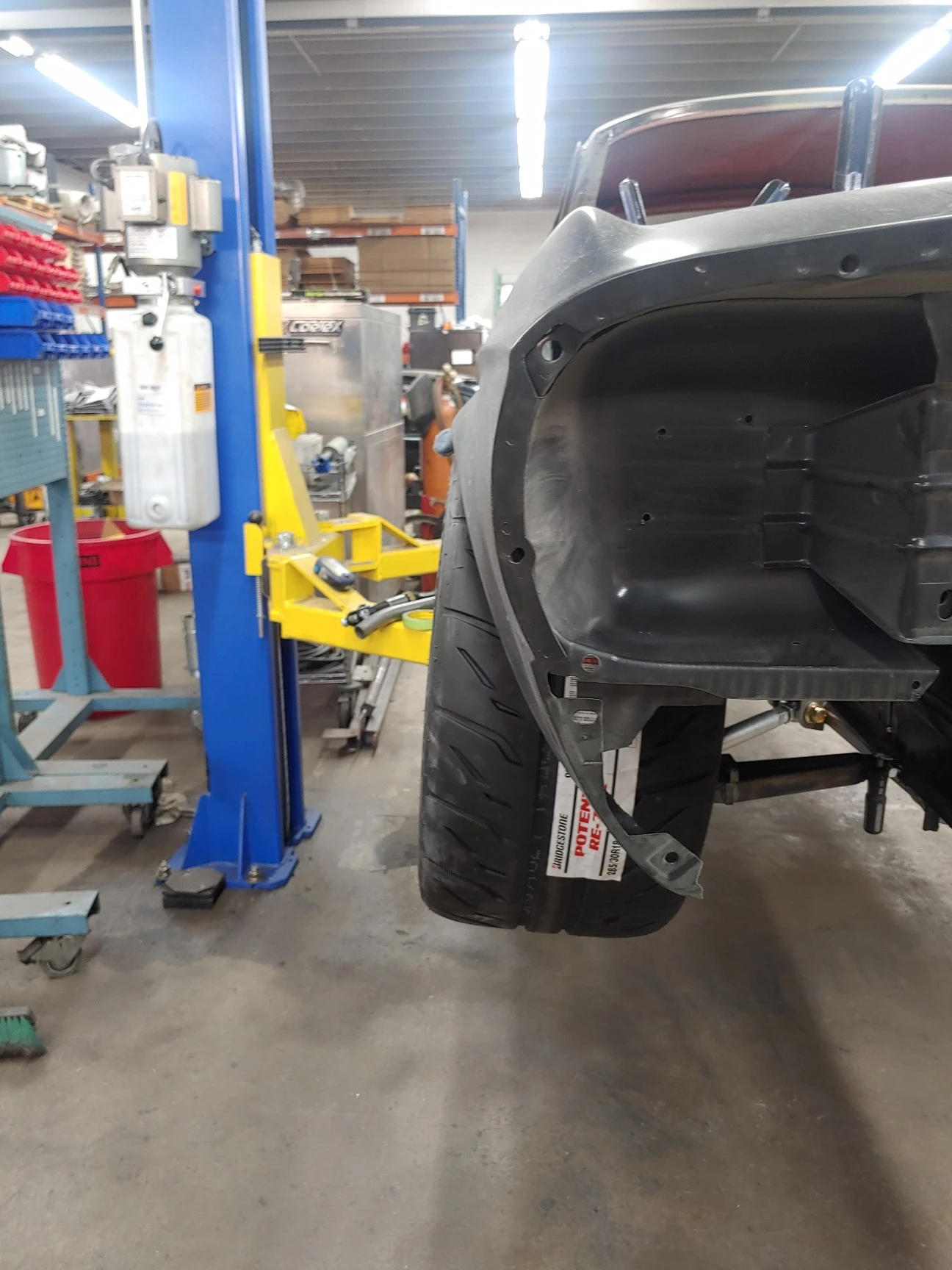

It's been a while since things have been updated but I'll do my best to let everyone know where the project is at.
Car was dropped off at Cortex Racing and has been getting the suspension/chassis work done. A front double A-arm and a rear cambered 9" with torque arm.
I have been struggling to come up with an engine choice I like to match with a dual clutch transmission.
Was looking at the GT350r engine, but they have NVH issues and decided to steer clear
Looking at 9.5 Deck windsor engines, but they can't be made reliable to get ~750rwhp on pump gas
Looking at 8.2 347 (3.250/4.125) windsor engines with turbo's, but don't like the added complication of turbo's
Looking at 500+ inch N/A 429/460 based engines, but it just didn't feel right

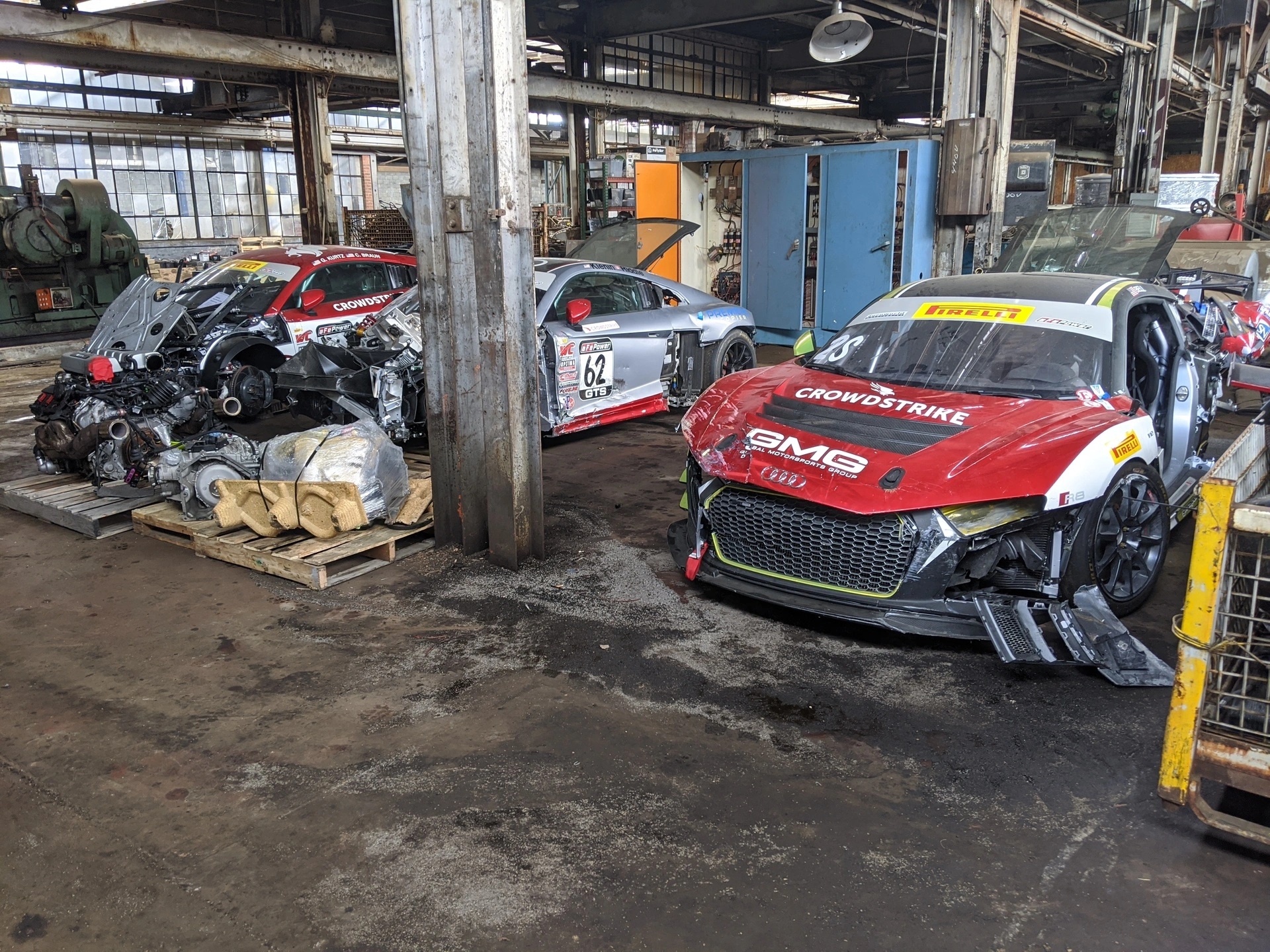

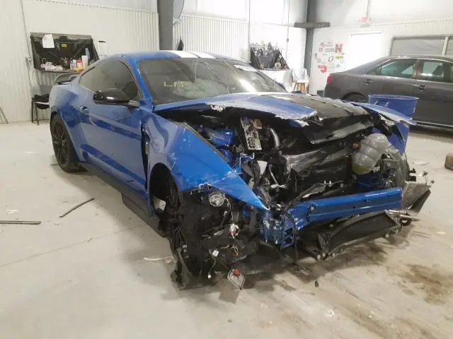

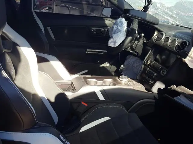

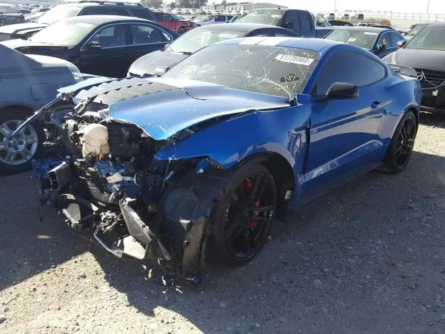

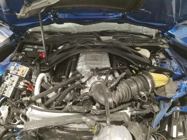

I finally think I got it....today there was a salvage auction and I purchased a 2020 Shelby GT500 with 335 miles on it.
It was expensive, but in the end I think it will be cheaper after I sell off all the unused parts. I get the paddle shift trans I wanted, ~750 rwhp, OEM reliability, pump gas, and be able to drive the thing.
Now another hard part starts with trying to figure out how to go through all the wiring, and figuring out what systems & fabrication I need to do so I can have the factory OEM electronics work in the 68 chassis. Yikes!

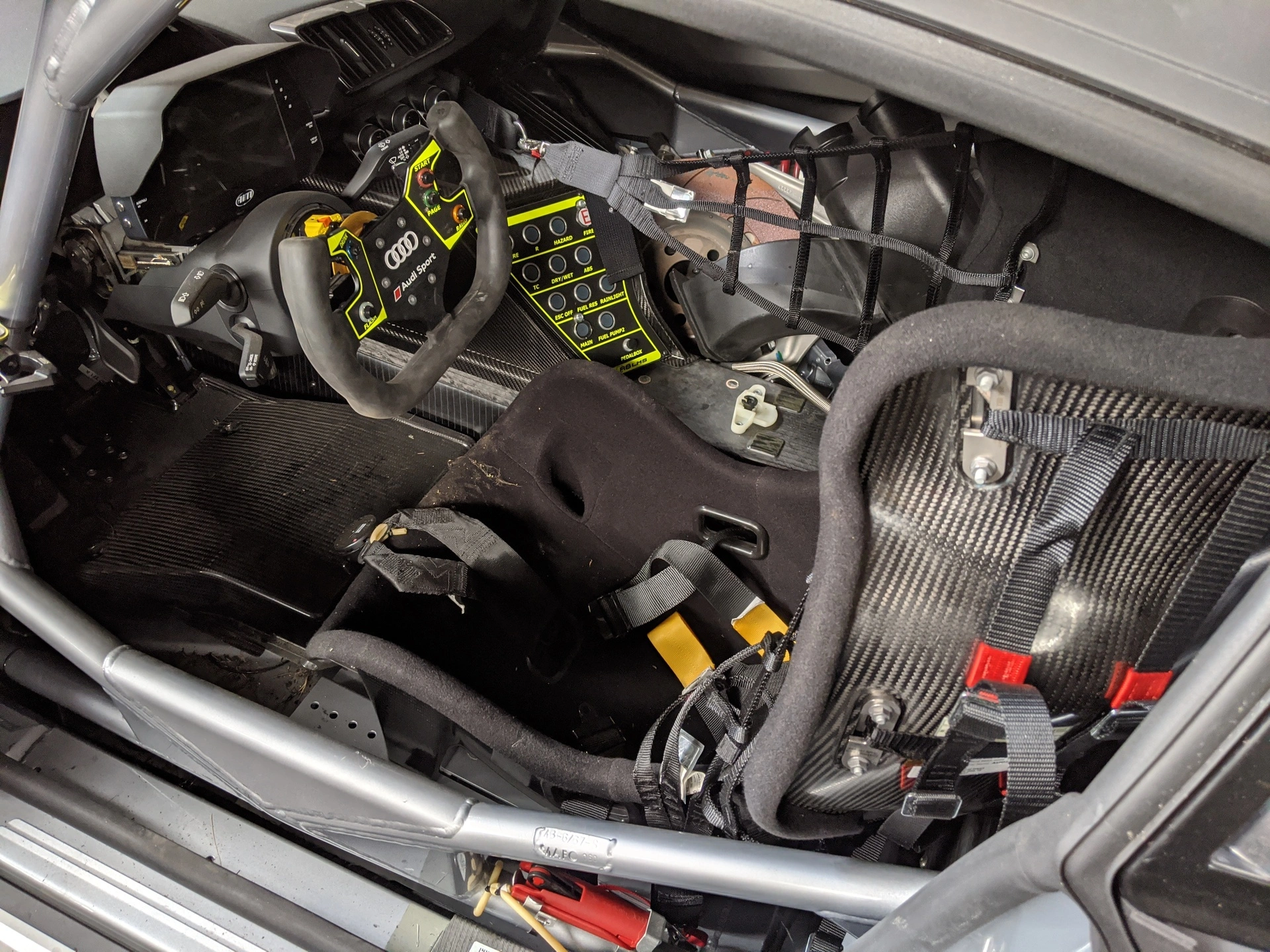

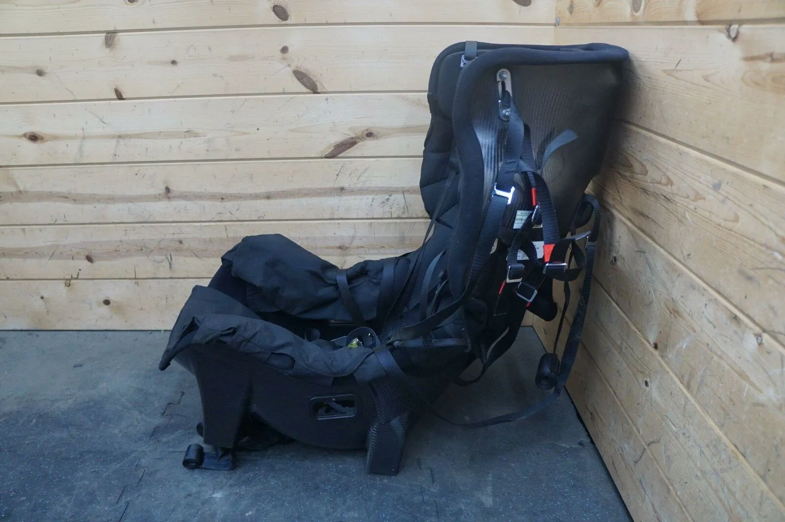

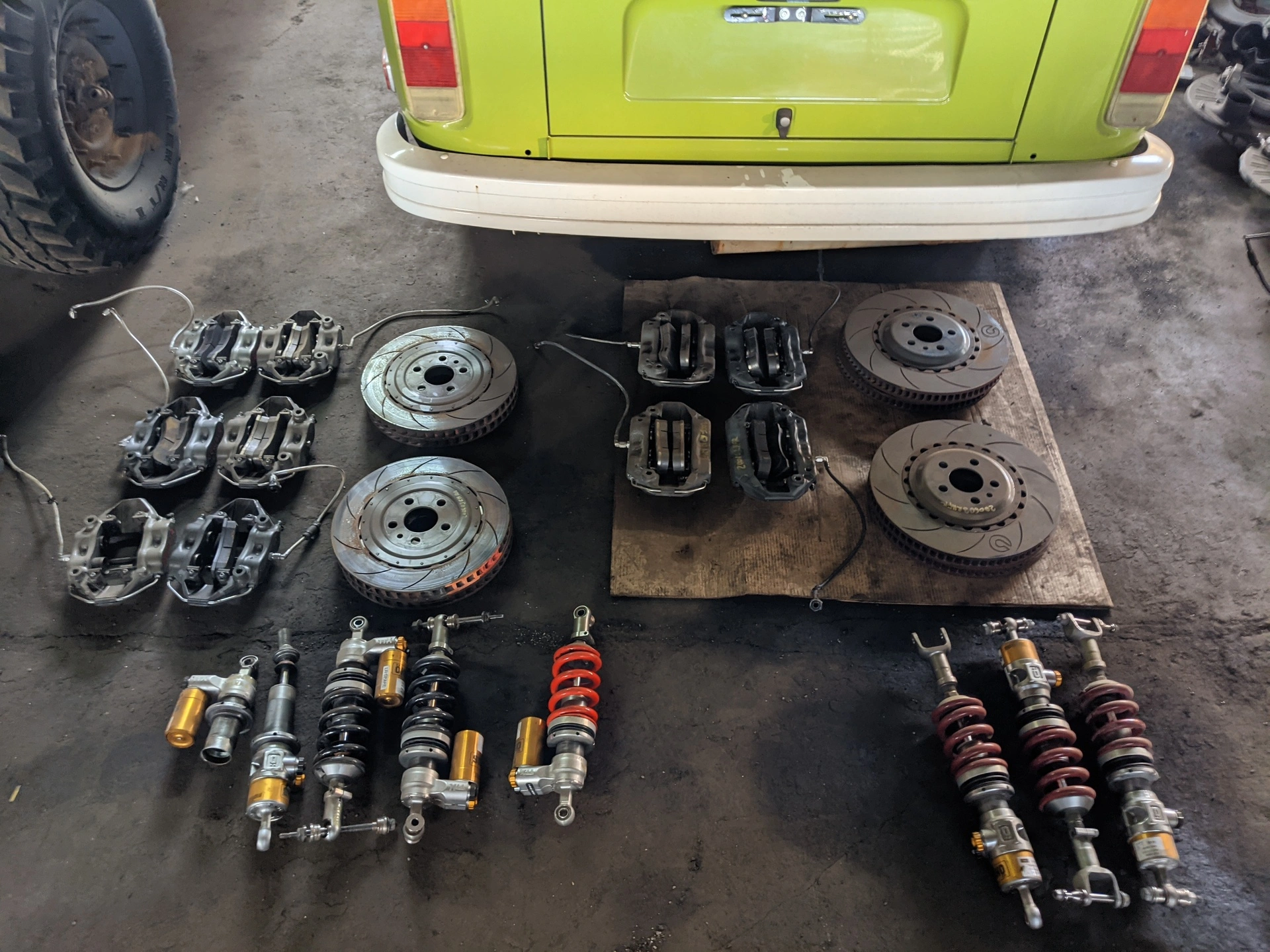

Car is getting Brembo brakes off a 2018 Audi R8 LMS GT4 car
Carbon 1 piece buckets out of the same 2018 Audi R8 LMS GT4 car with a rear seat delete and roll bar
Going to run a squared 285/35/19 RE-71R tire on all 4 corners (mini tub the rear, and we may be able to get by with fender rolling on front)

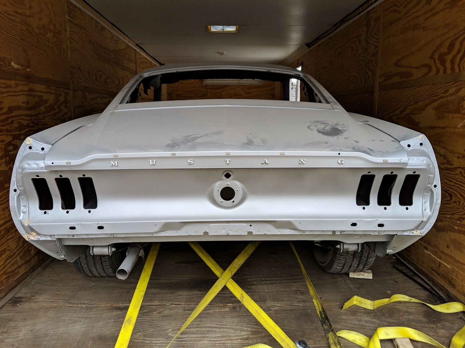

What method did you use to strip off the old paint??

1. What company offers the best front suspension setup with shock tower delete and a coyote engine?
2. What company offers the best rear suspension setup for aggressive road racing? The options I have seen so far but don't fully love are:
-TCP rear 4 link
-TCP rear torque arm
-Street or track 3 link with watts link
Next step for the car is ordering all of the suspension & getting them installed.
Any info would be great! Thanks!
What method did you use to strip off the old paint? Looks great
And what part of the country in just in case you are close I may want to use your guys.
Any updates? Particularly interested in what you thought of the Roadster Shop SPEC chassis since that is the primary thing I'm looking at for my 1968 fastback coyote build. When I look at the cost of front and rear suspension kits the Roadster Shop SPEC chassis looks like a pretty good value
I also live in a condo without a private garage space so I'm looking at having to pay for all my labor. A bolt on chassis is probably going to be cheaper for me overall than doing separate solutions for the front and rear suspension
I love their concept. However I am not a fan of the SPEC chassis on a unibody frame because it hangs low (visable from side of car under rocker panel) and that is a hard no for me.
I like the idea of the chassis that gives you the flat floor where you have to cut out the original, and I like the idea on a car that originally came with a frame so it's not going to hang down super low.

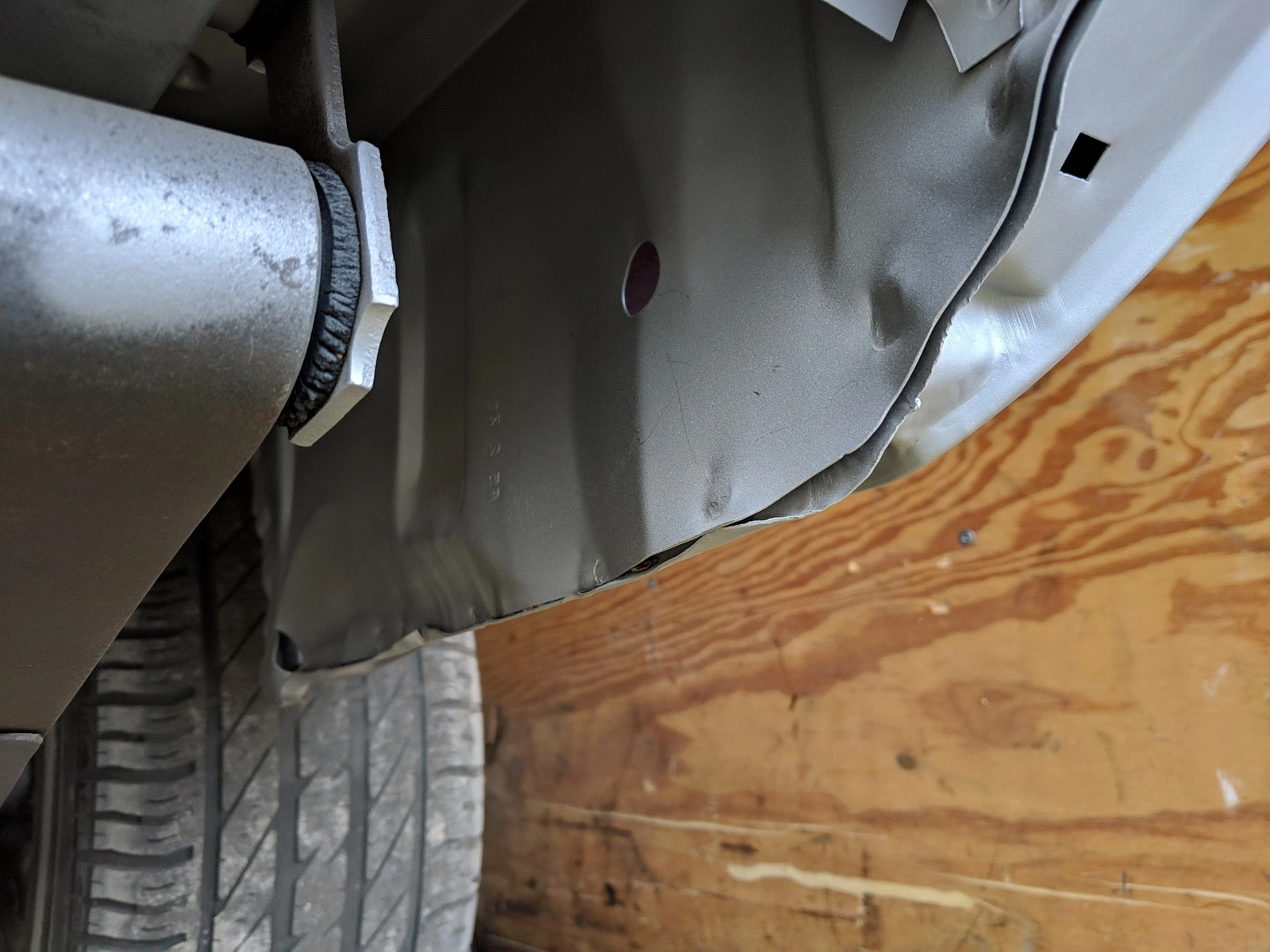

Interesting I haven't seen one in person but I haven't noticed a visible "hang down" in photos
Both of these have the SPEC and I don't see much in the galleries
Maybe this image shows something
I'm the other way around though. If I spend 25K on a SPEC chassis (inclusive of brakes and all the extras) I think I'm going to like to catch a glimpse of it (in fact I'd be tempted to powdercoat it ford blue or another color to help it stand out against the underbody if they offered options other than black). Different strokes I guess. I love your build.
Right now I'm trying to get a line on how much more the full frame RS chassis will cost me to install over the SPEC (which by all accounts is only a few hours of labor)
