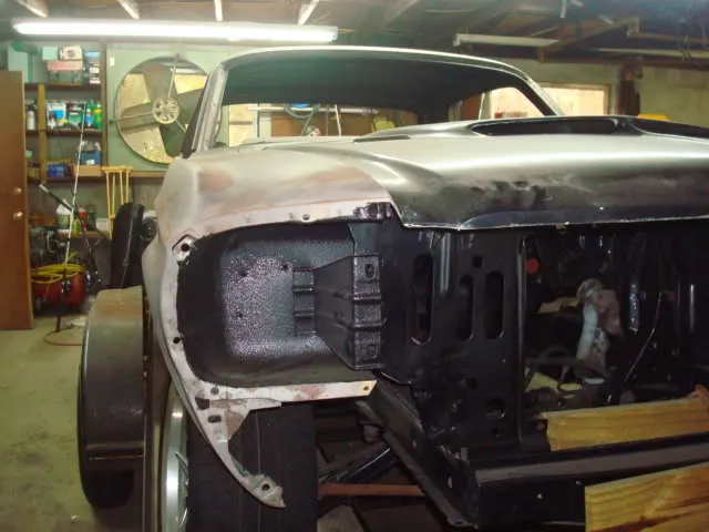

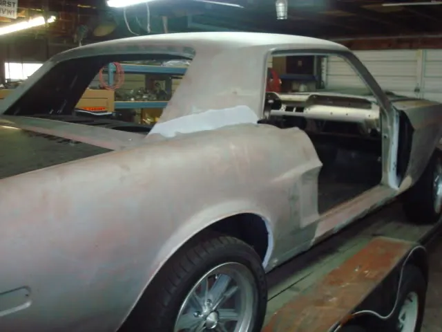

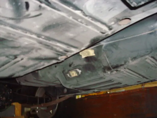

Thank you for your input, i just figured i would post some pictures of exactly where we are at so u can get an idea of the project...

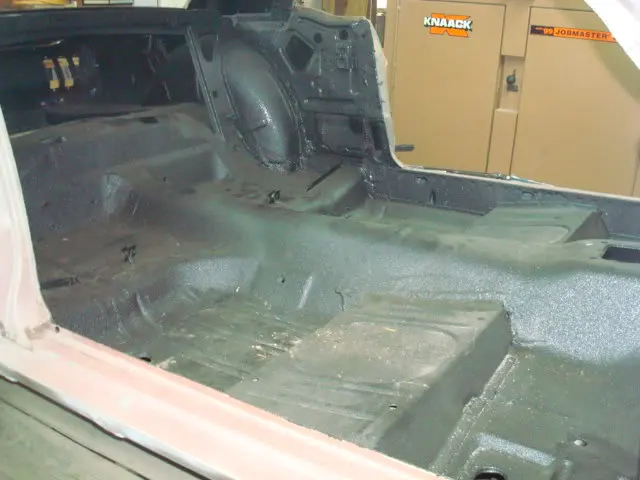

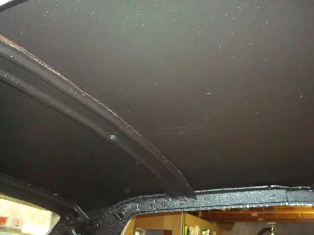

Interior line-x 1
Interior line-x 2

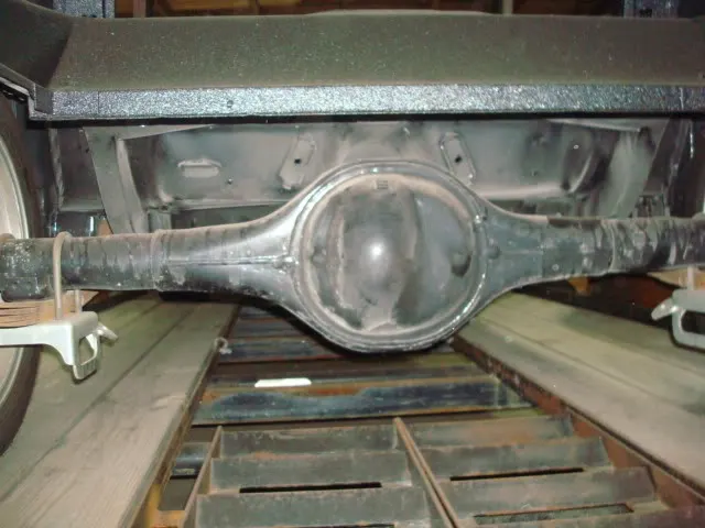

9" lincoln versailles rear end powdercoated (not the leafs we are going to use)

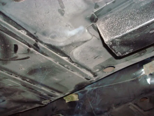

undercarriage 1 painted
undercarriage 2 painted

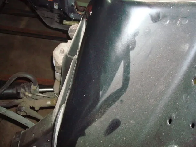

passenger side in front of rear wheel well
passenger side behind rear wheel well
Driver side in front of rear wheel well
driver side behind rear wheel well

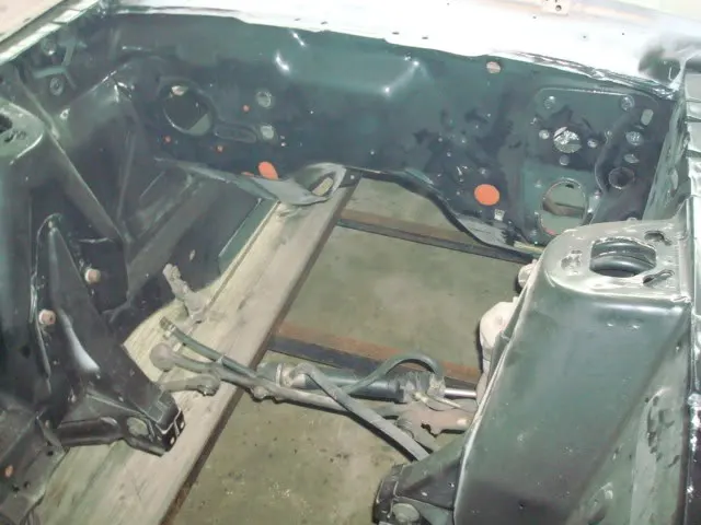

engine bay painted
thats what the color looks like when its cleaned just put that to show that the paint is not old or anything
this is just a quick coverage of the car
It looks like you have a nice platform to start with. It looks like the rust wasn't bad.

No there was pretty much no other body problems with the car except whats in the pics, frame was clean along with the floorpans. As for the color since its both my fathers and my car... its like an argument waiting to happen, we both are kind of partial to candy apple, but i would prefer dark cherry, and as for the drivetrain thats all up to him... we have a lincoln versailles 9" rear right now, and a 289 bored over to a 302 that we are going to have redone, everything else is in the wind.
