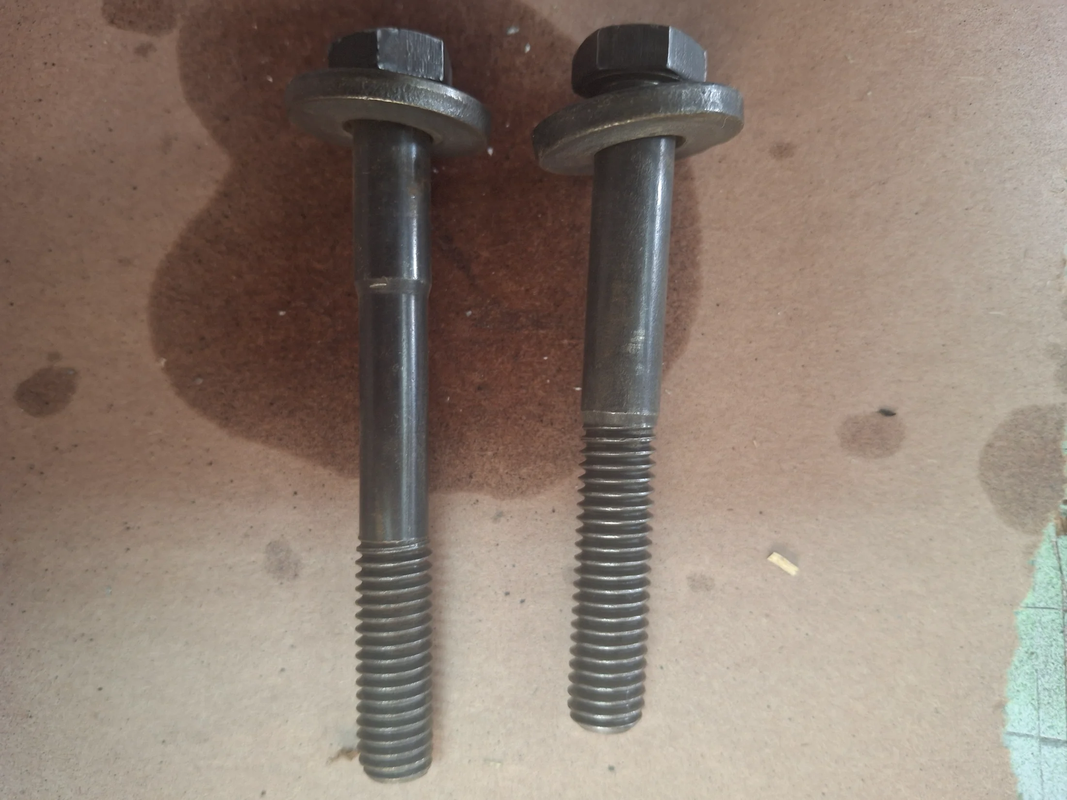

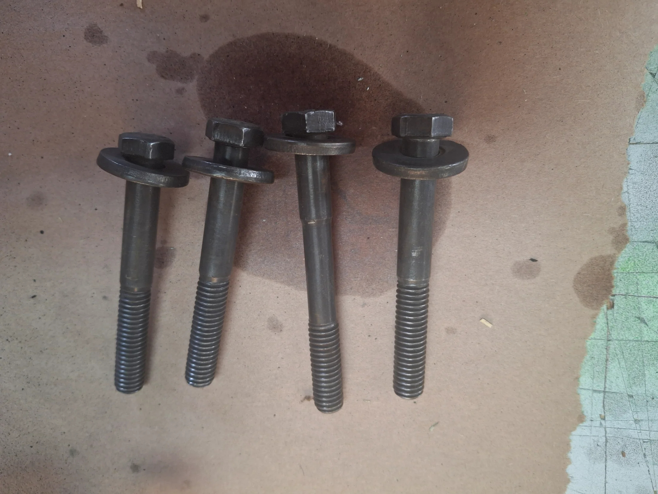

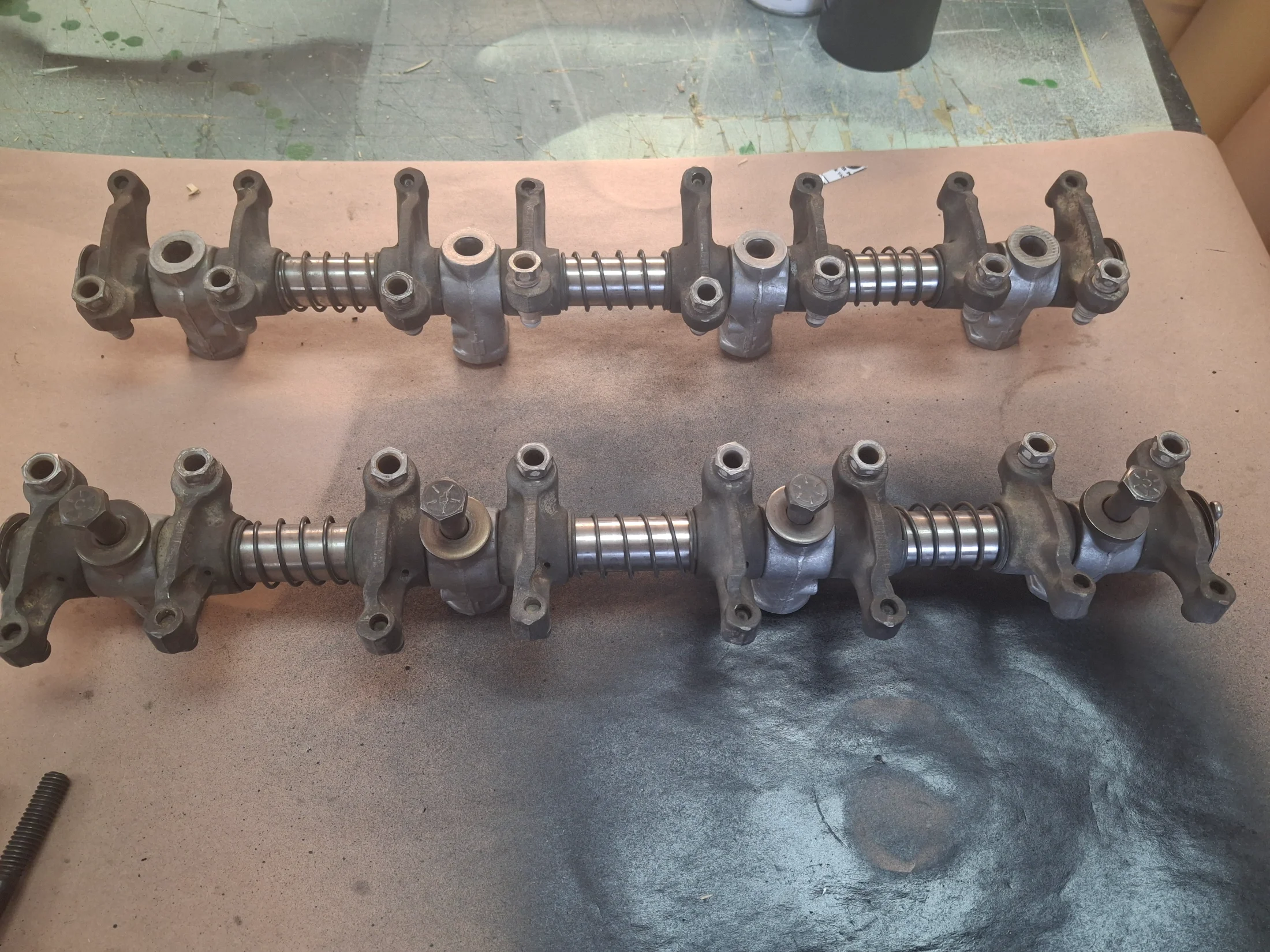

These were brand new ford adjustable rockers ,they now have about 1,000. Miles on them and still look new . The shafts have to be turned a certain direction for oiling so I will take them apart and clean them and make sure the oil holes point the right direction . 4 bolts hold them down but one bolt is different than the others ,it is the bolt that goes into the oil passage in the head ,this one has to go there for propper oiling of the rockers and shafts .

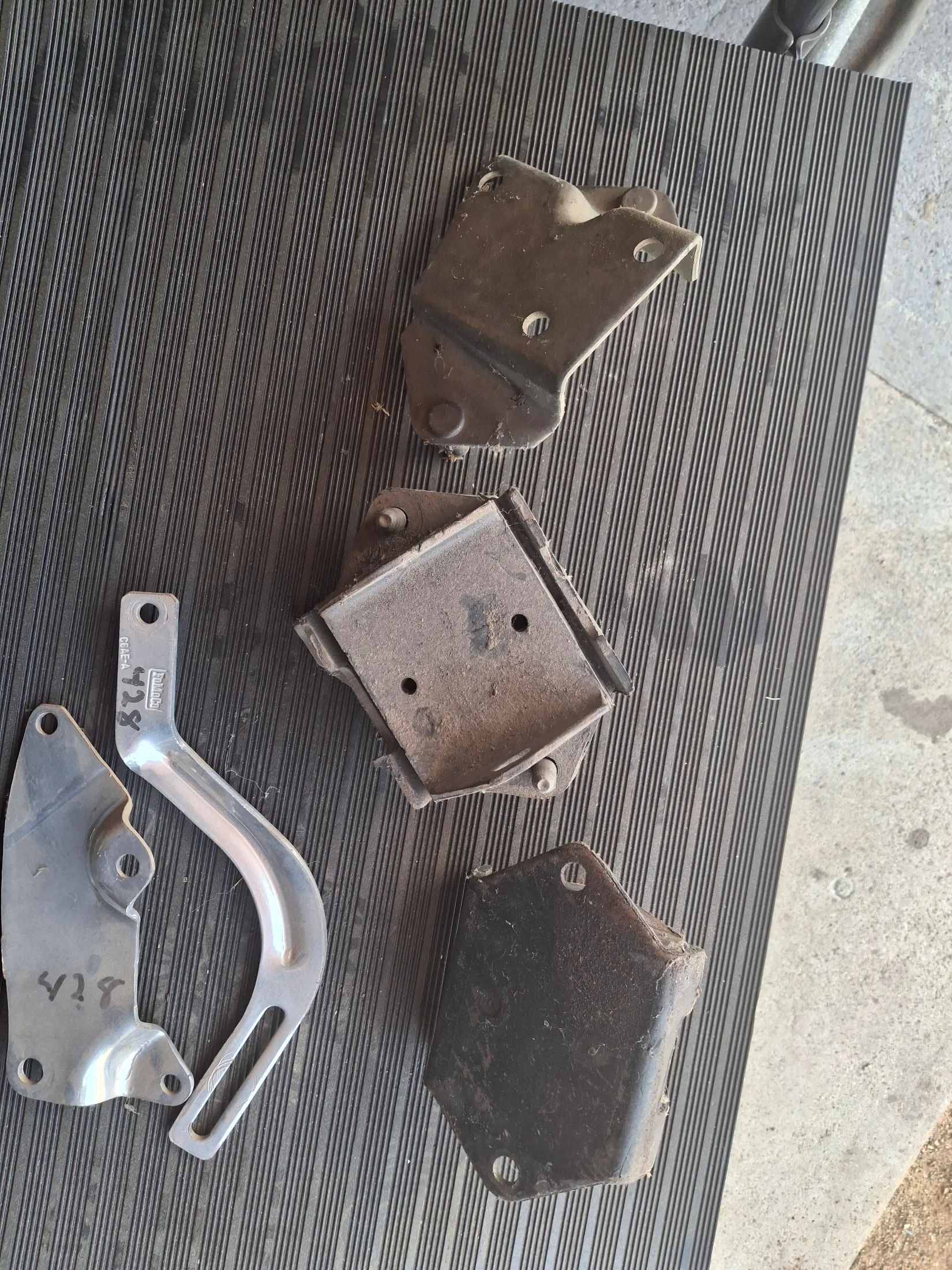

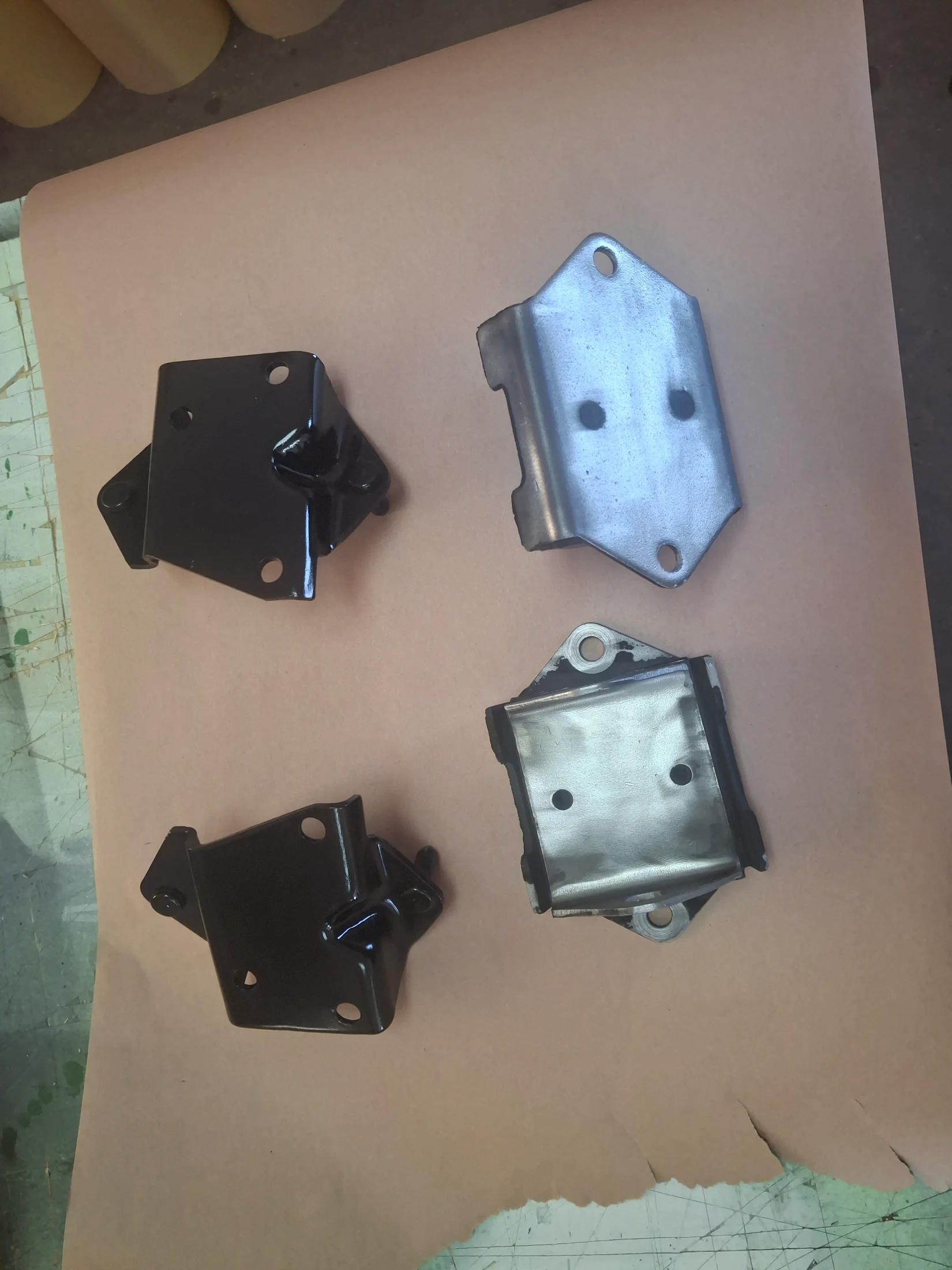

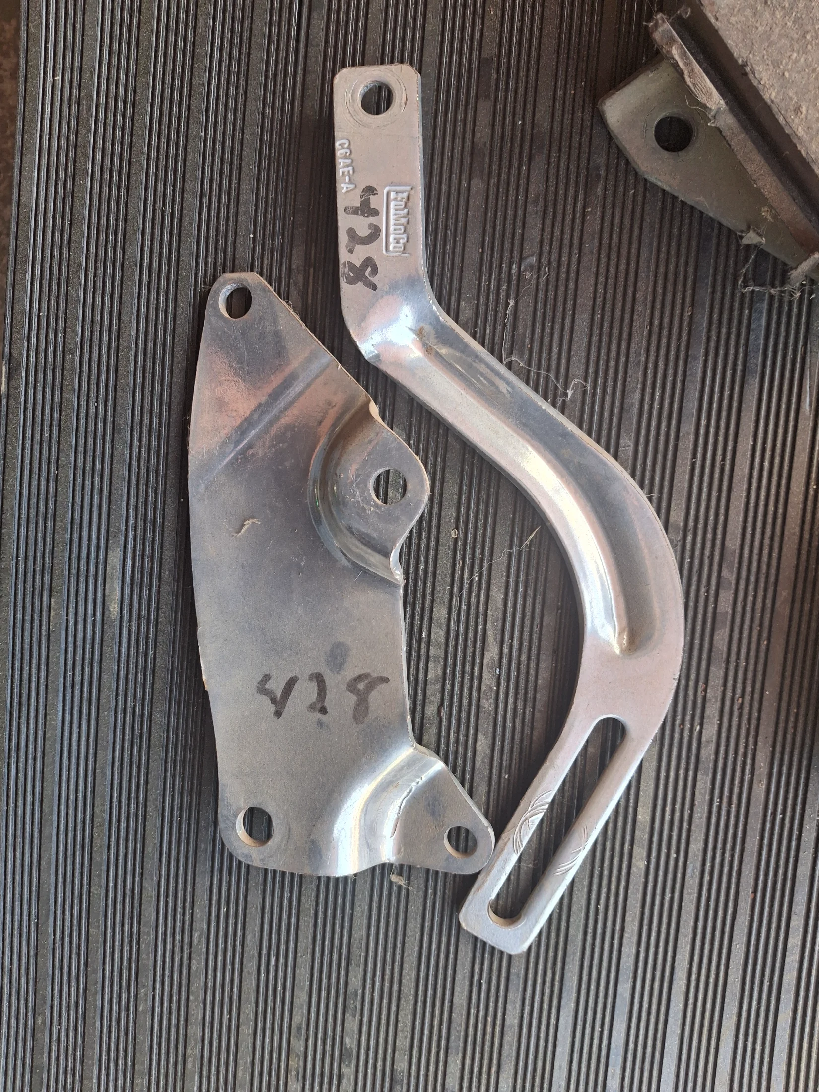

I was just digging through my parts stash and came across the alternator brackets for a 69 CJ and although the are dirty ,a set of new old stock complete 428 motor mounts ,I had the ford box but it crumbled a long time ago .
Somewhere around here I have the pullie set and a CJ fan ,I just have to look for it!

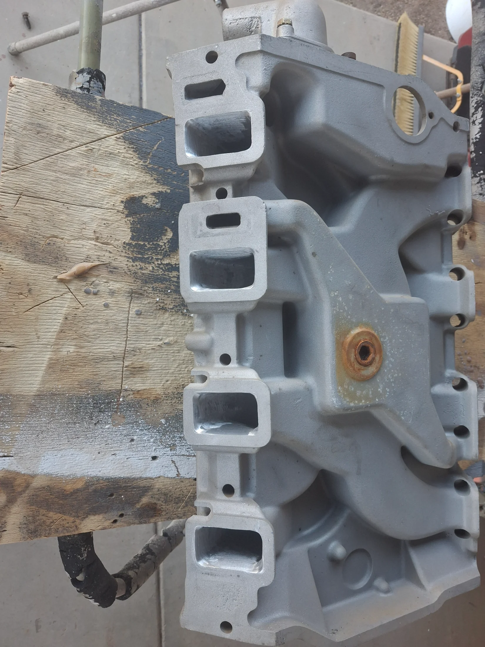

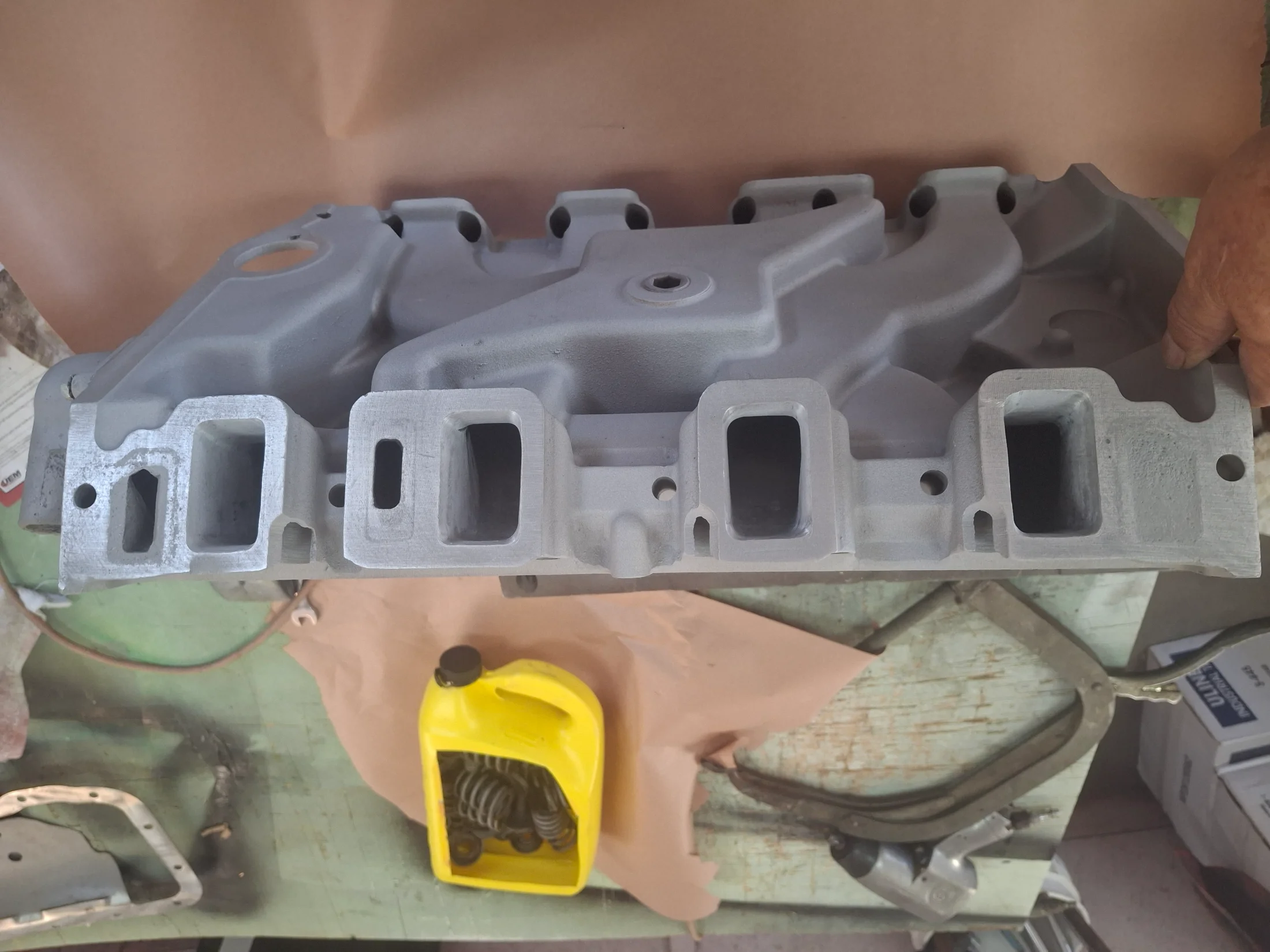

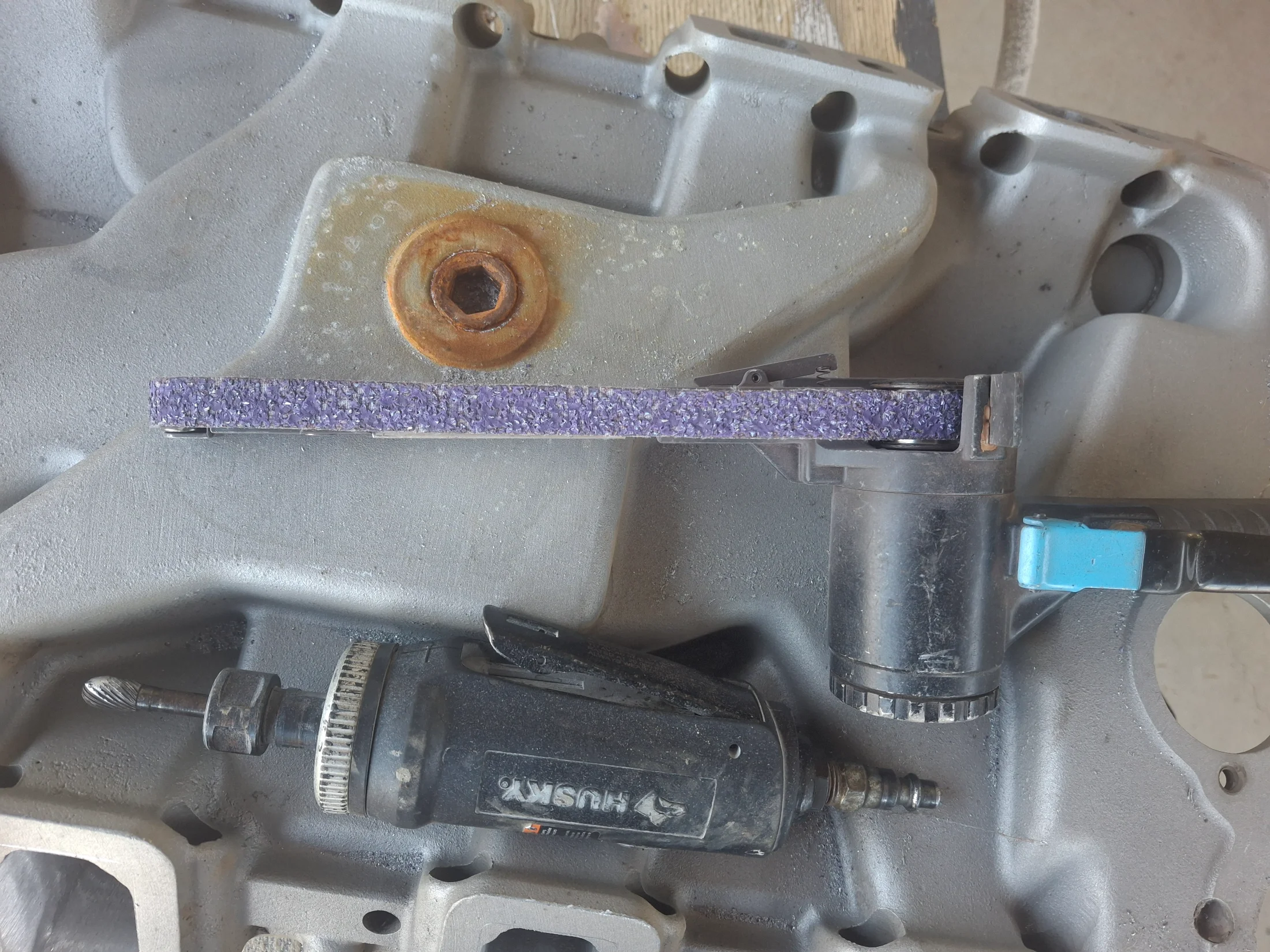

You want to see somthing stupid that actually looks like it will work ,and work good!

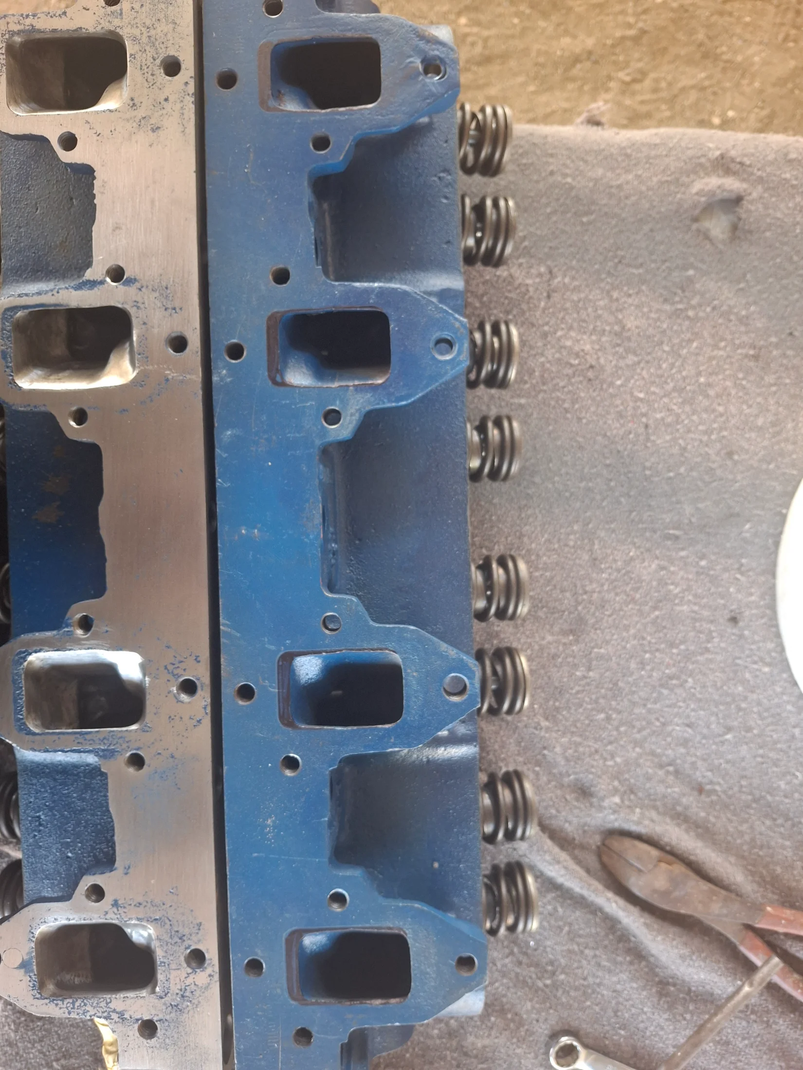

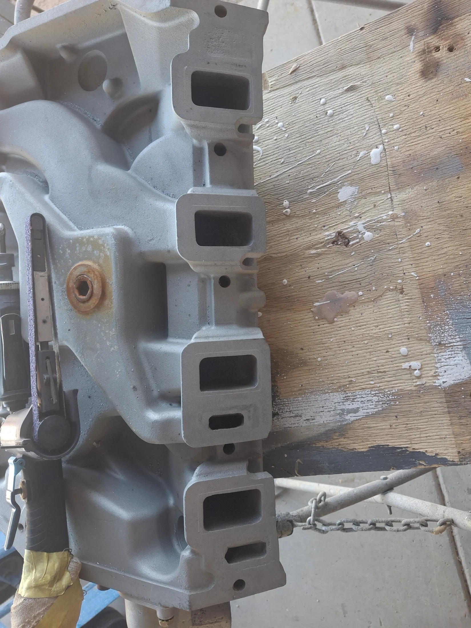

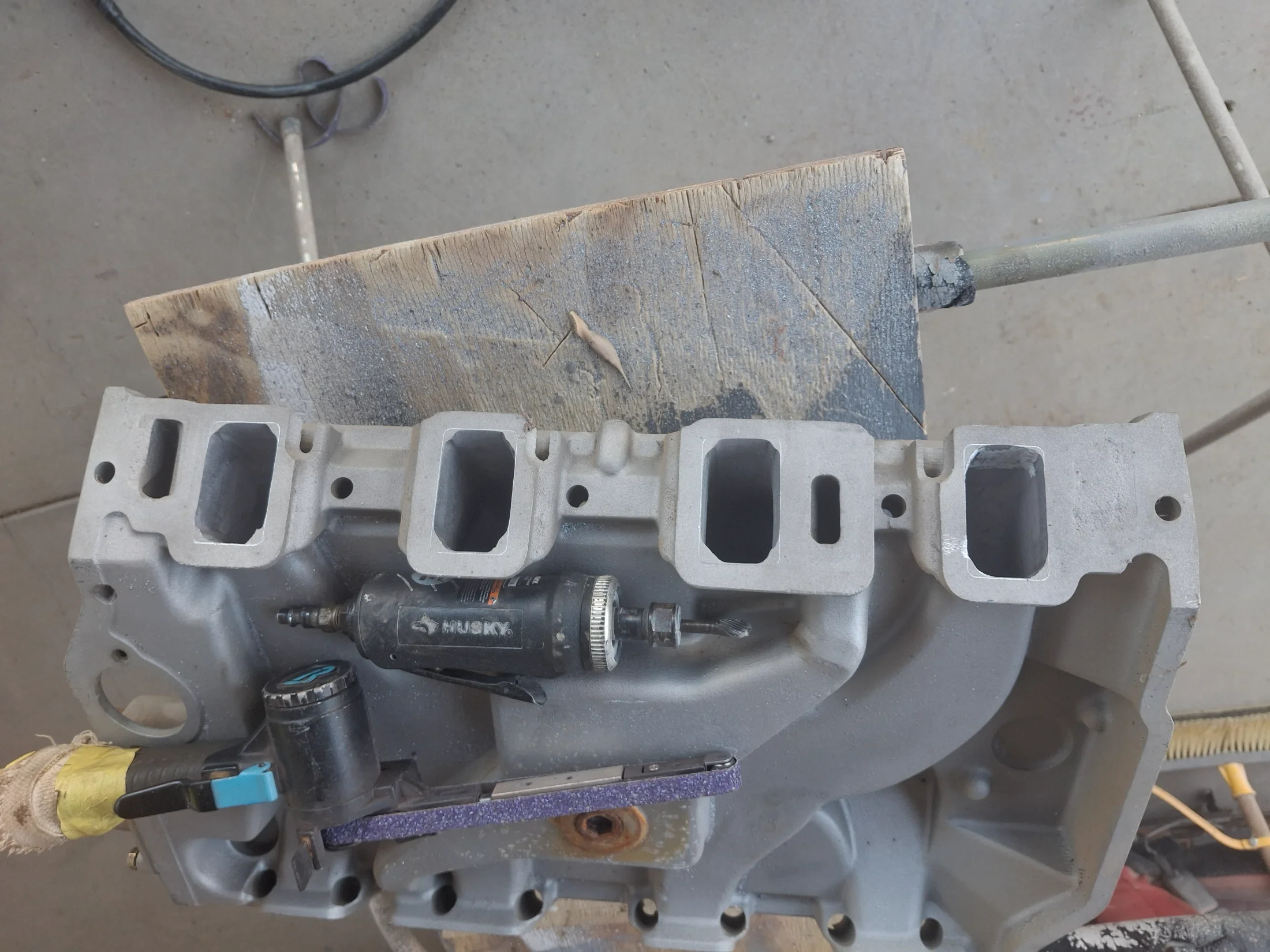

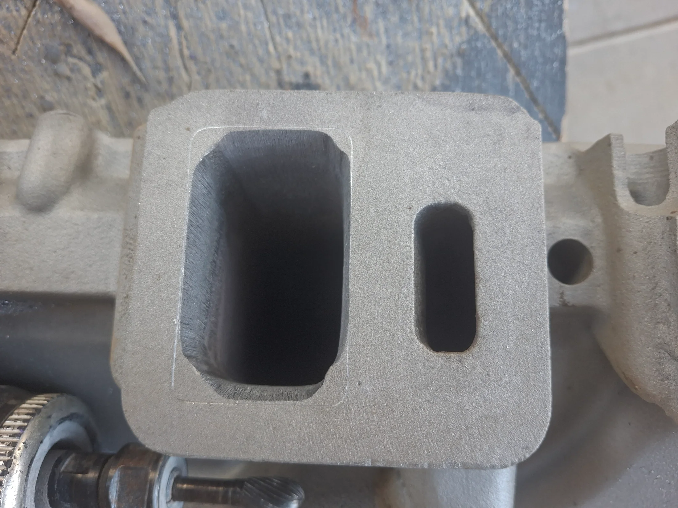

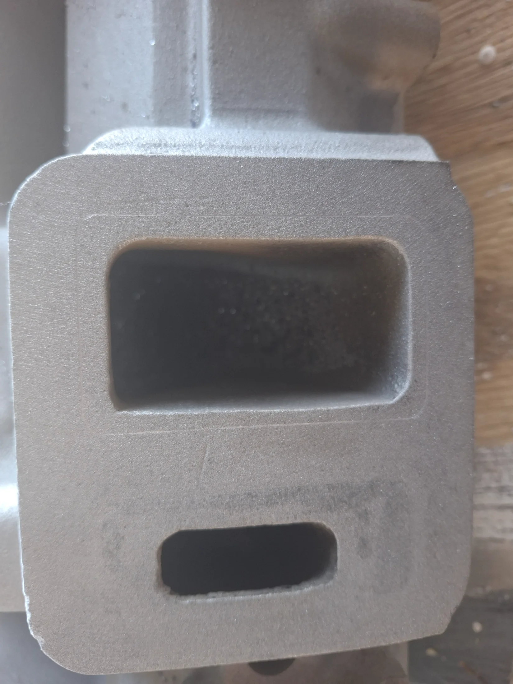

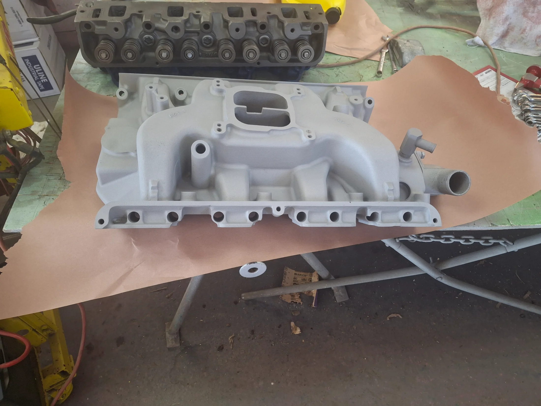

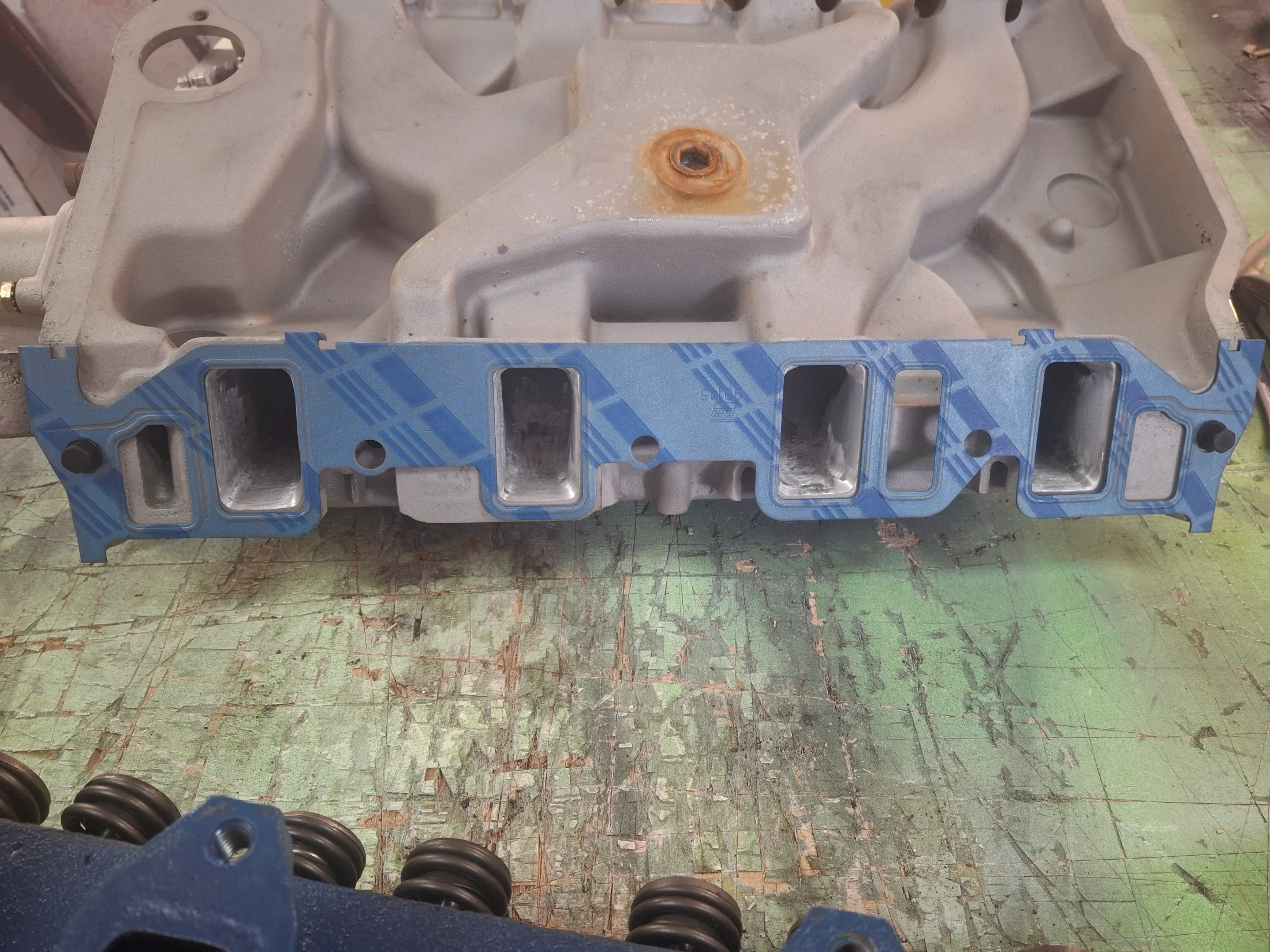

I needed to remove a lot of metal on my intake to gasket match it with the heads. Now you know those burs work but they are a pain in the butt! I got to thinking ,I wonder if one of those mini belt sanders would do o it ? Answer is yes ,and in a fraction of the time that bur bit would take ! It reaches way down in there and it blends the port as you go!
I still have to finish all the corners but the hard part is done and nice and blended !
Interesting fact...NASCAR ran the factory shafts and rockers up to 9000rpm.

Nice work! The floors of the ports aren't so important. Airflow through the ports is at the roof and sides. Be careful when bell mouthing the port exits. You don't want to slow down port velocity. Then again, these suggestions are for all out performance.

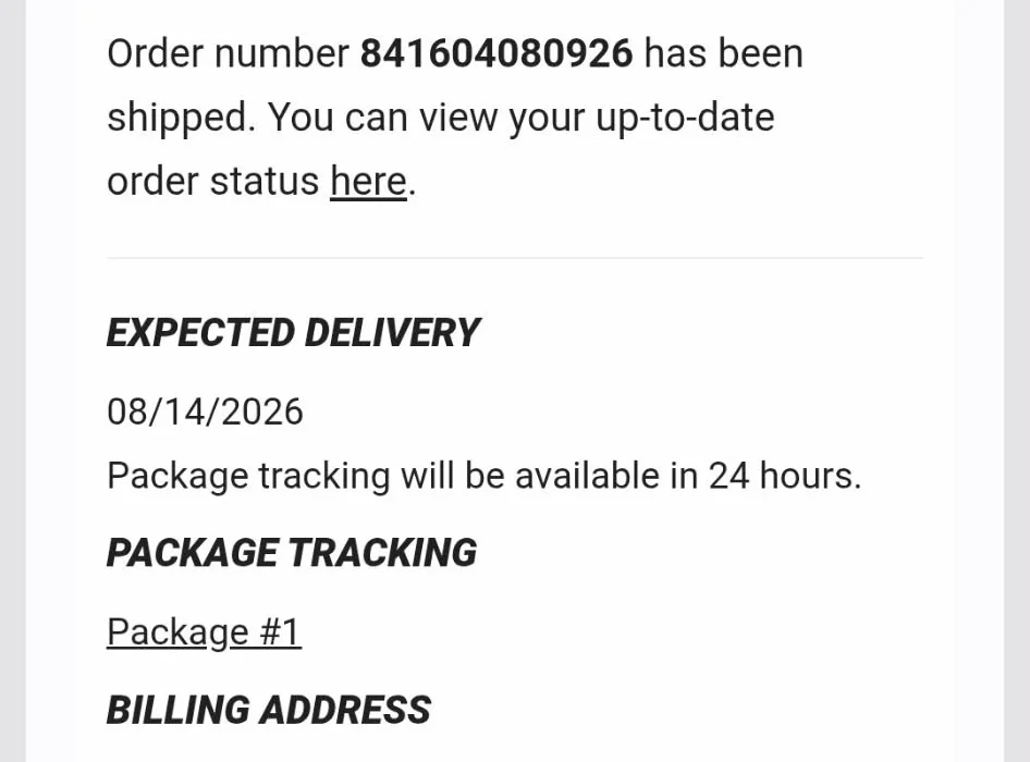

This is friggen nuts ,why would someone cut open the box ,take a ring set but not the cam and lifters or the gear set ,then reseal it with clear packing tape ? You can see the tan tape was cut so someone wanted in the box for some reason ! It had to be done by fedex !
Good news is Jegs is sending another set of rings ,he agreed the box had been cut open .
