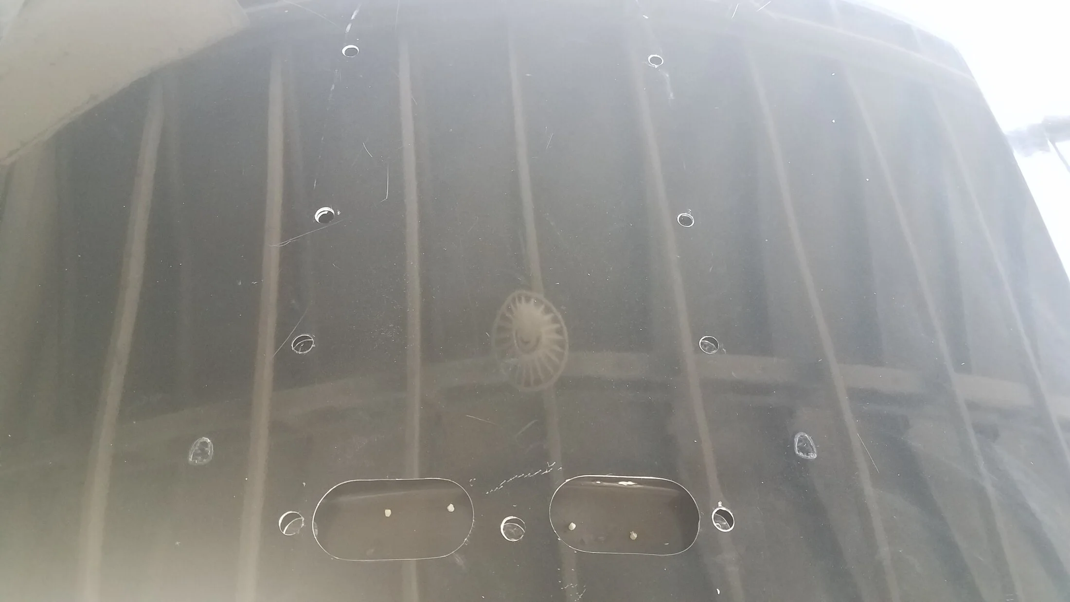

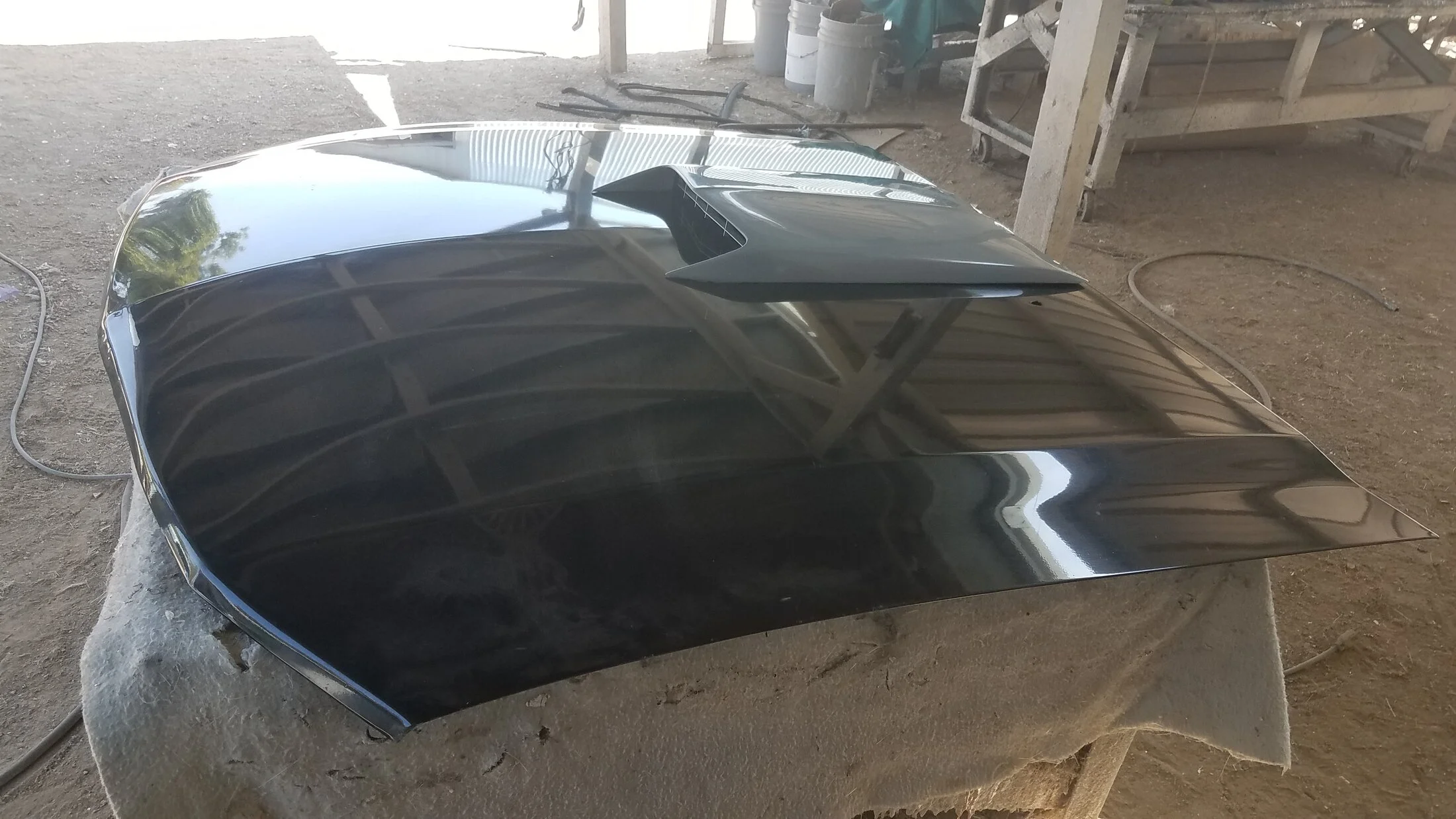

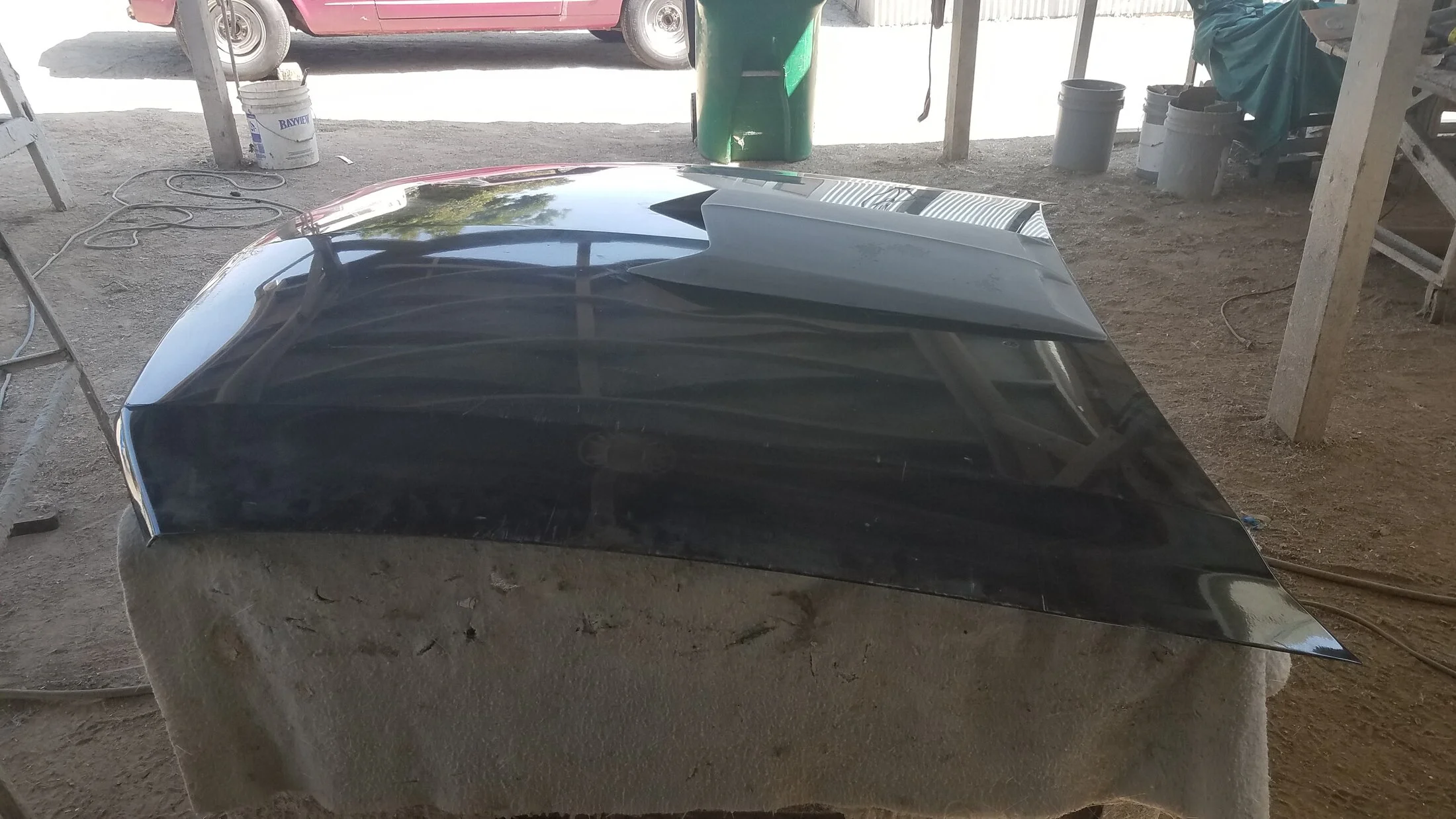

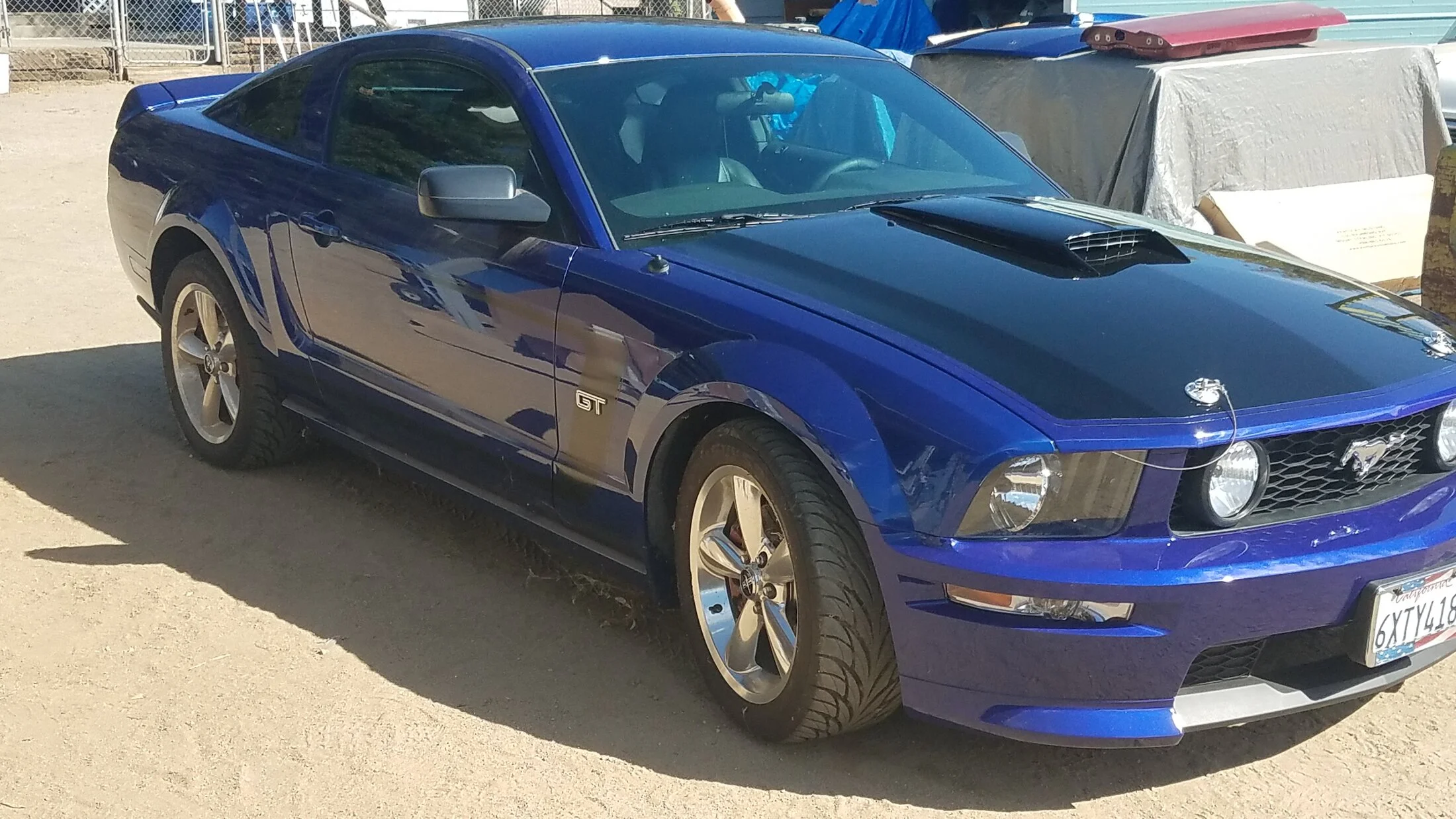

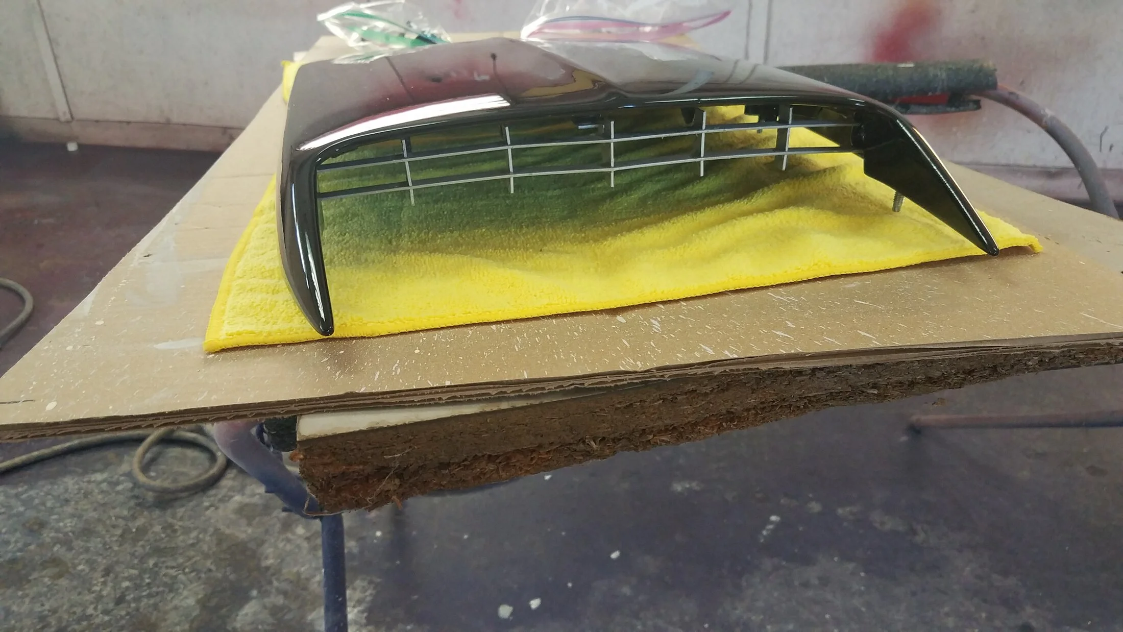

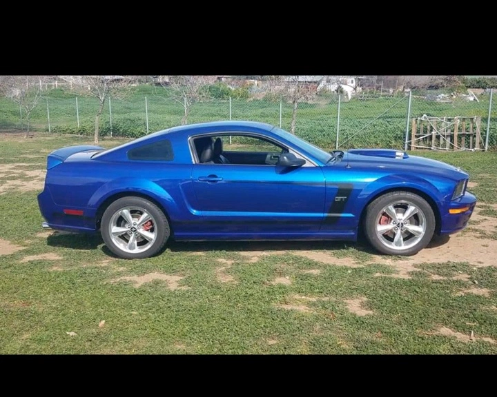

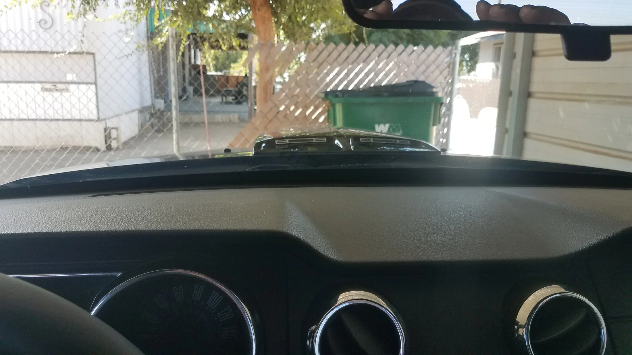

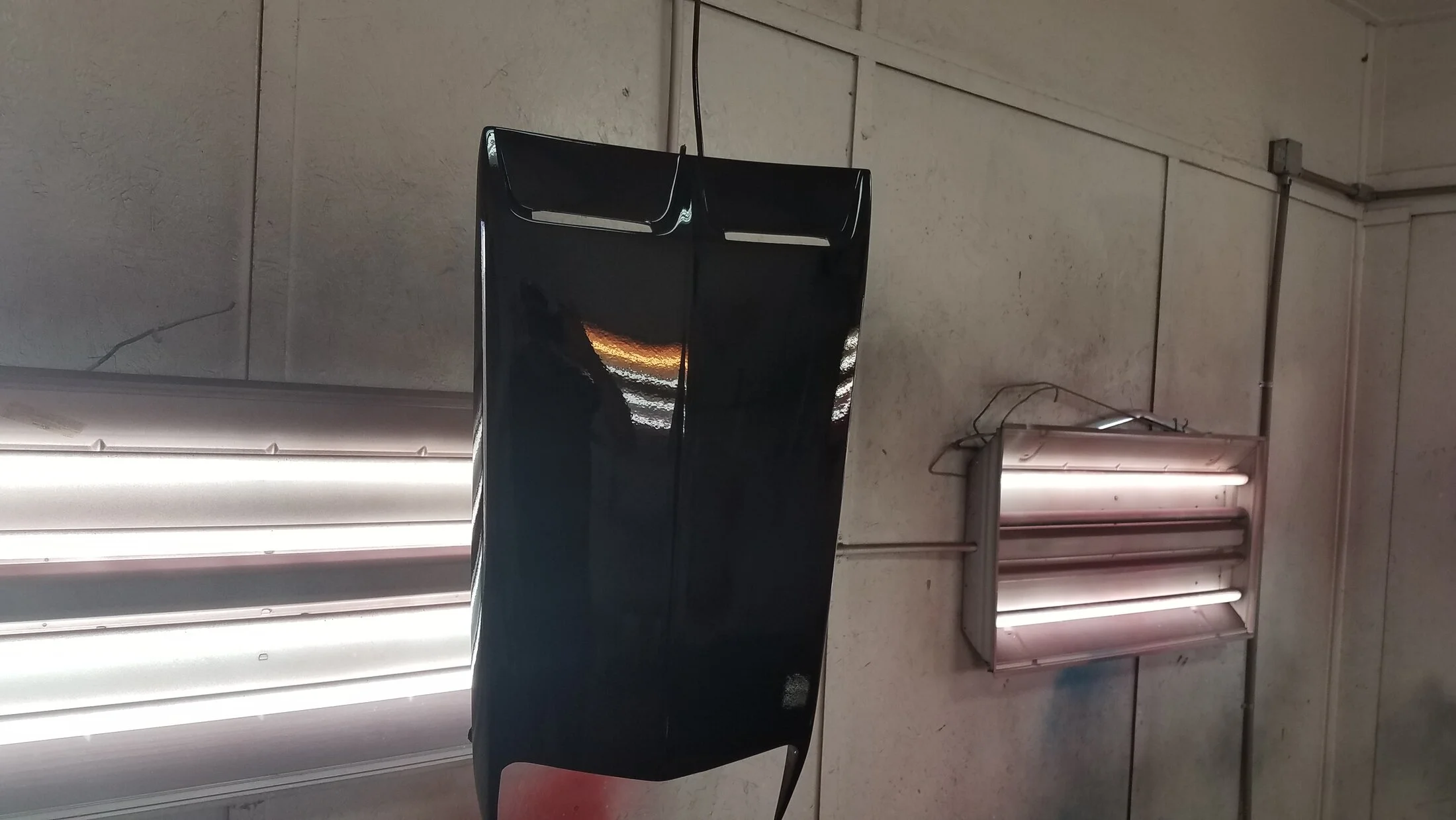

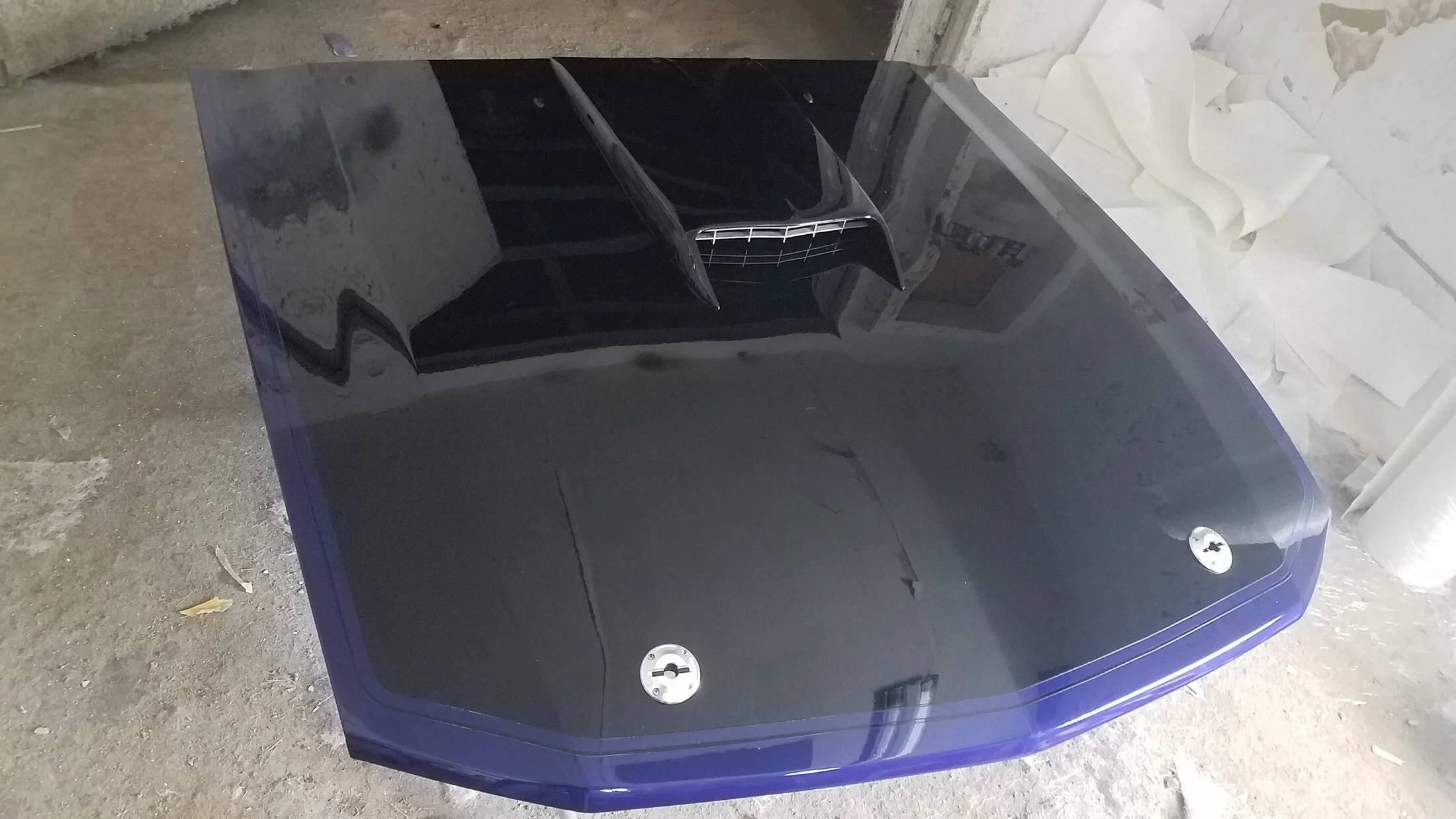

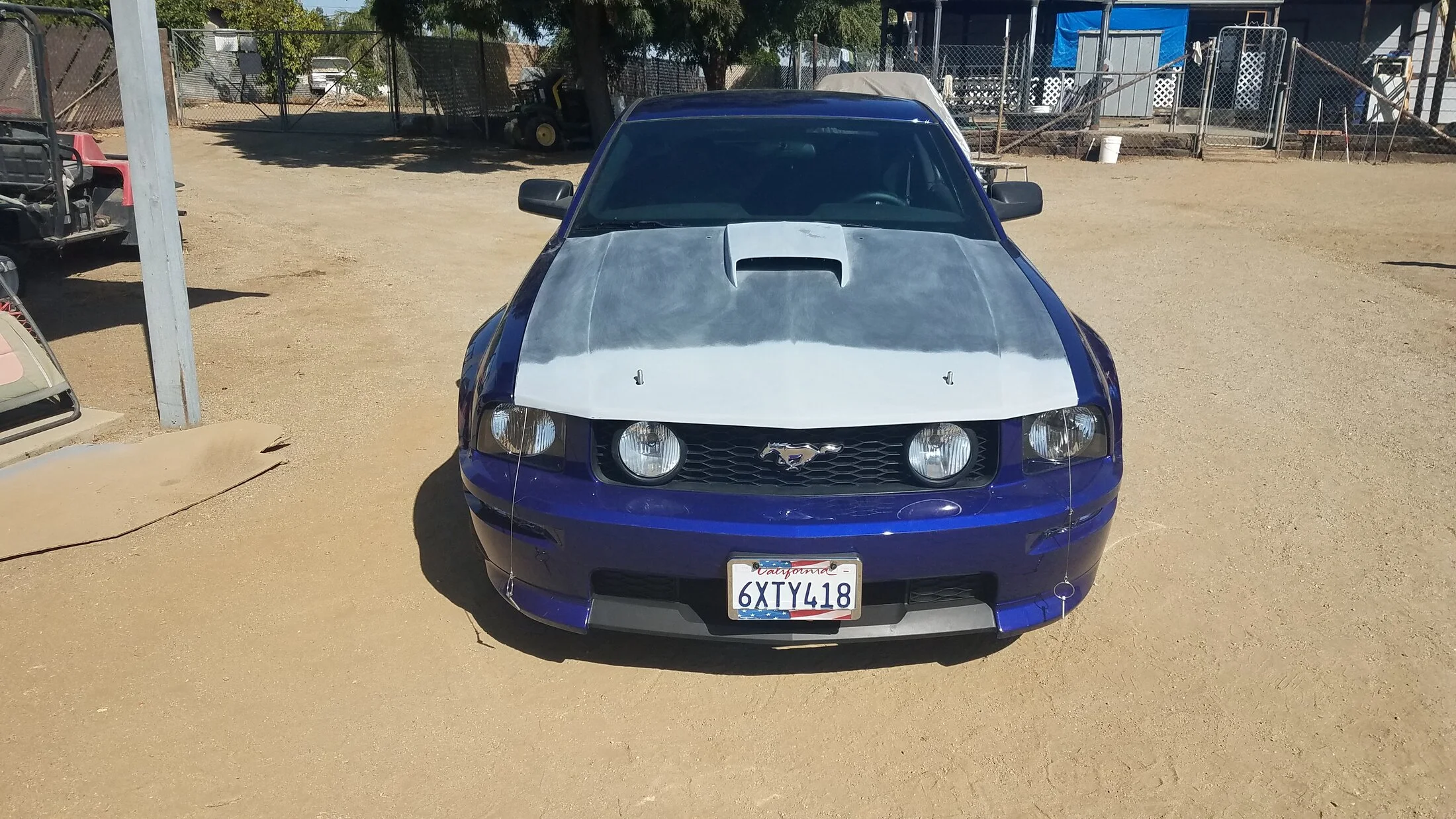

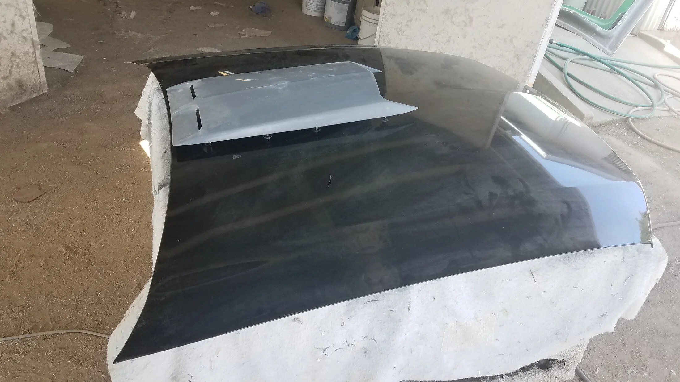

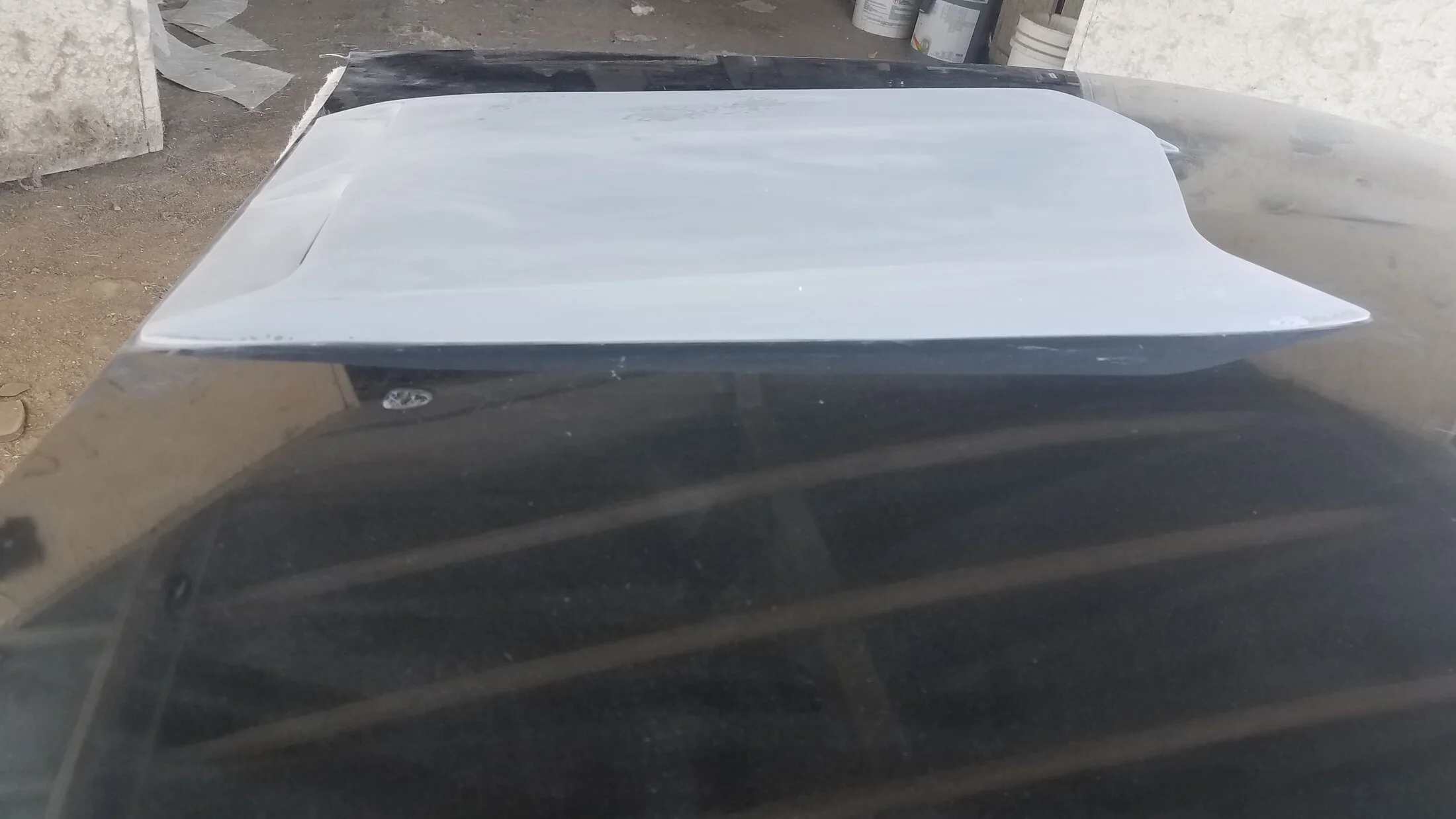

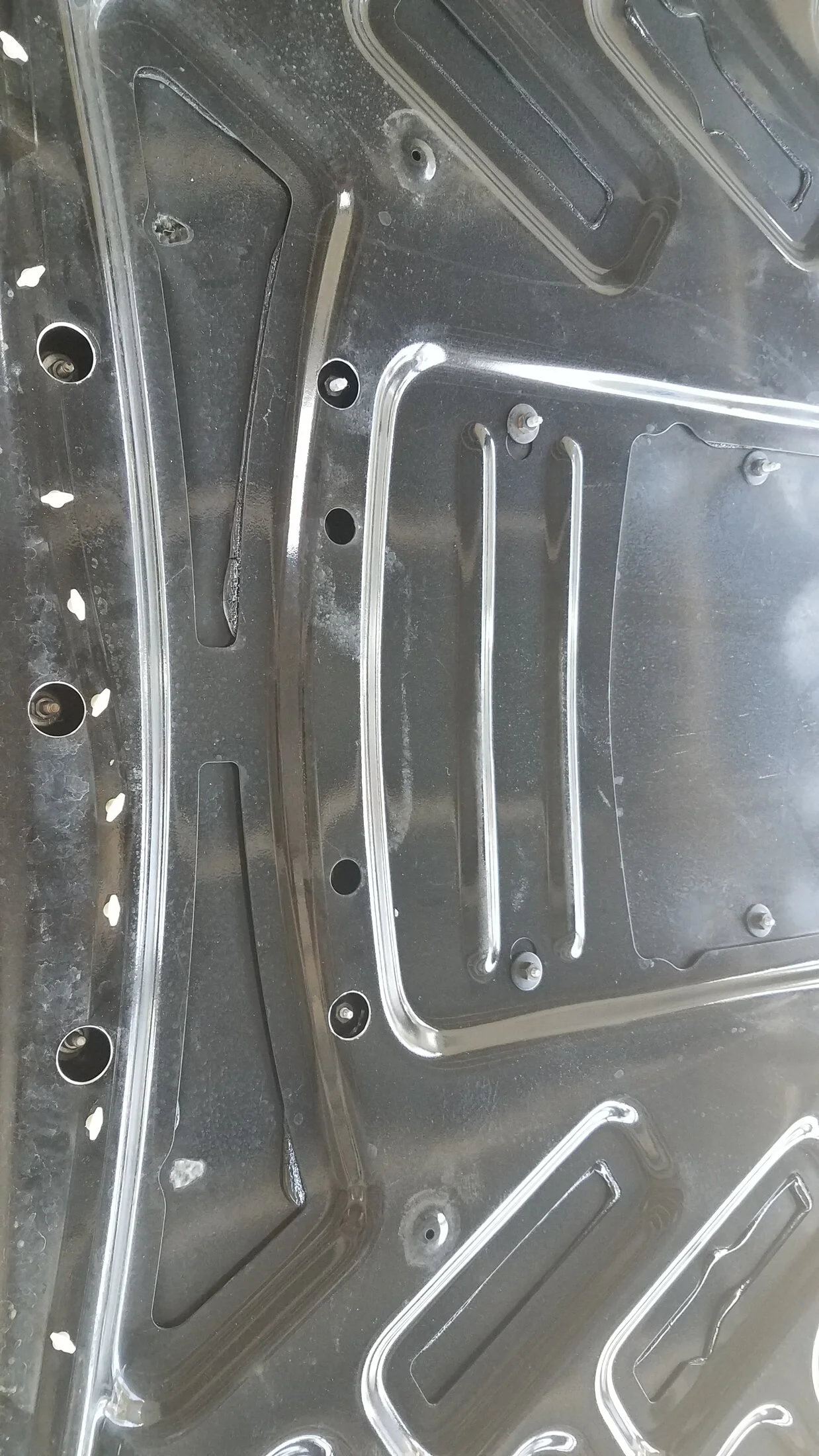

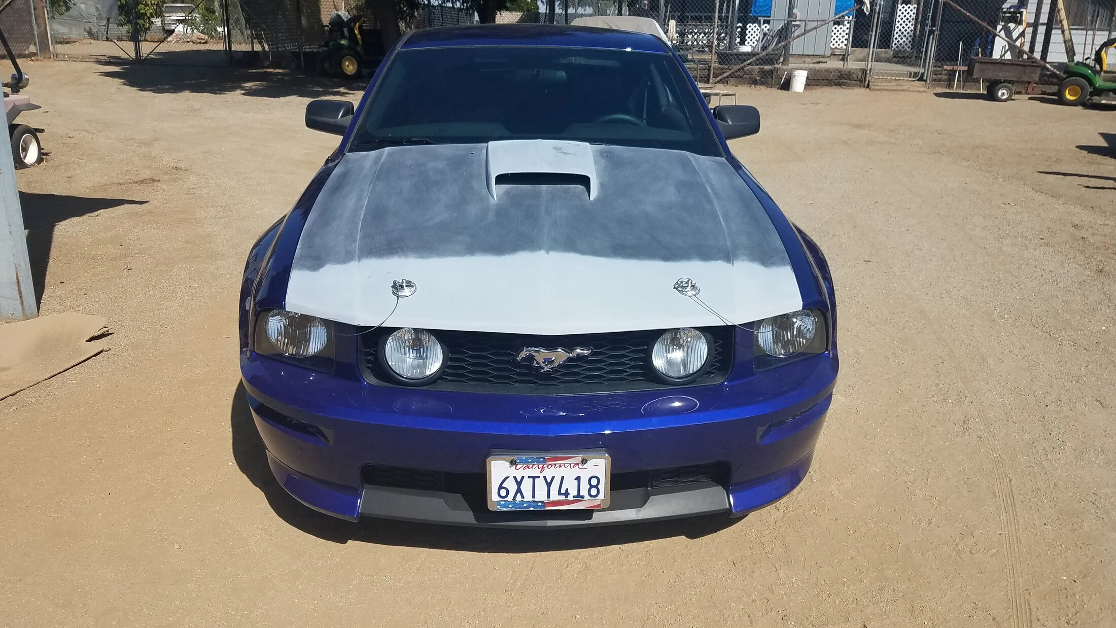

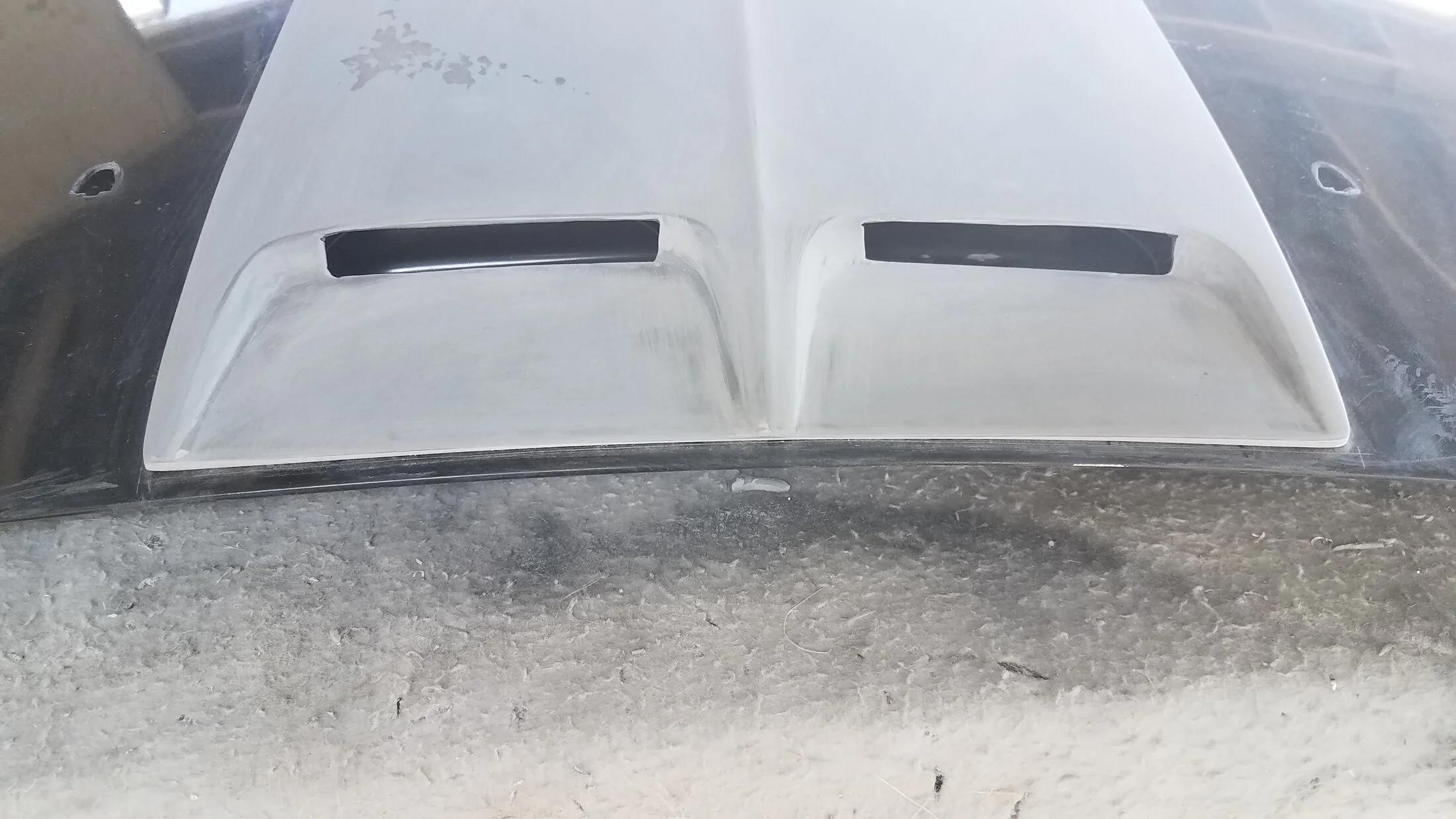

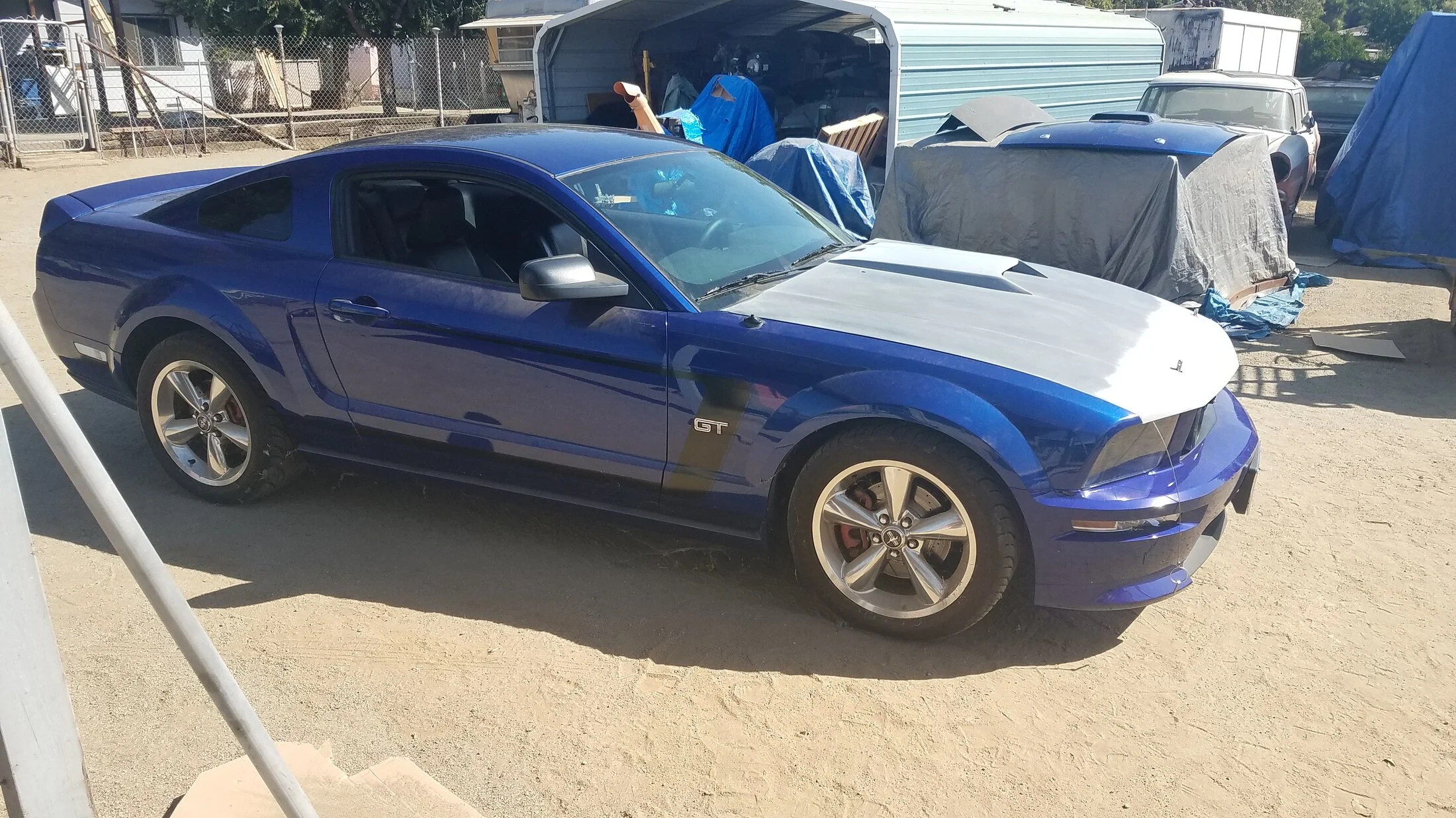

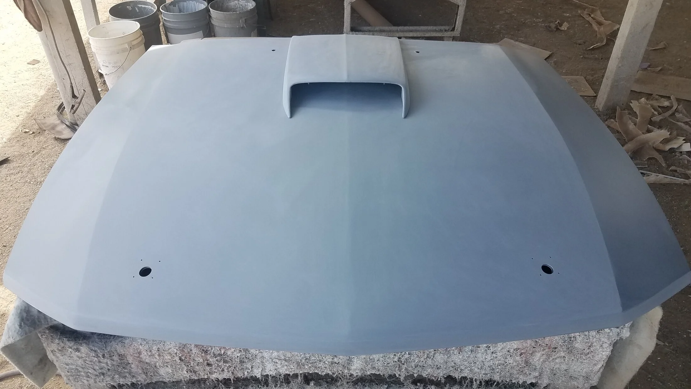

So my brother wants a 69 mach 1 scoop on his 2005 GT ,along with a black out hood just like the 69 with a blue boarder . I took an old junk hood and fit a 69 scoop to it ,i still need to grind the arch just a bit to fit up to the 2005 hood but looks like it will fit very nice . The turn signals will also be hooked up in the mach 1 scoop .

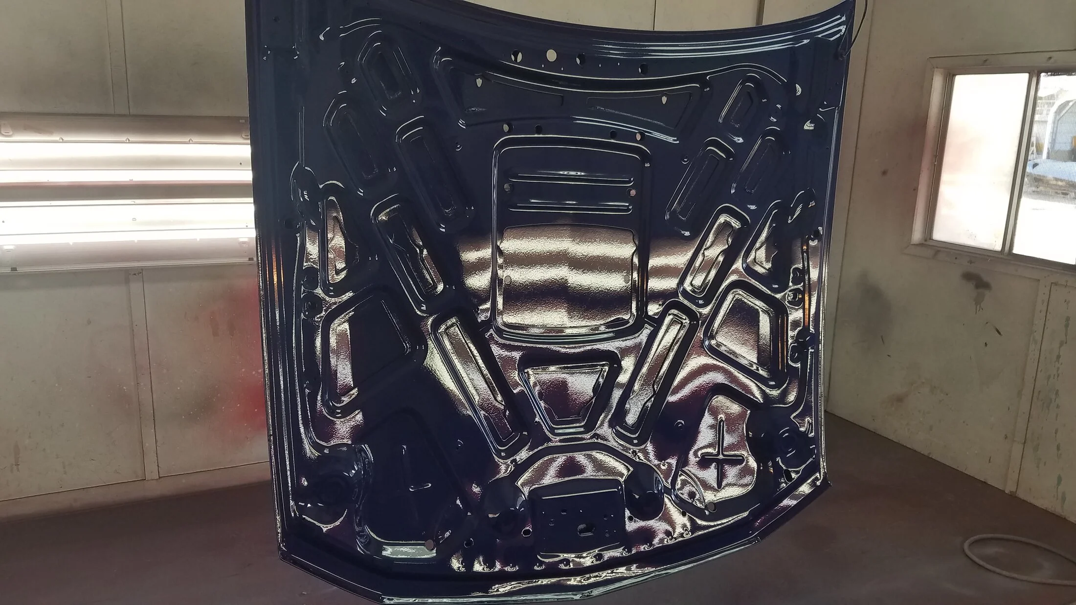

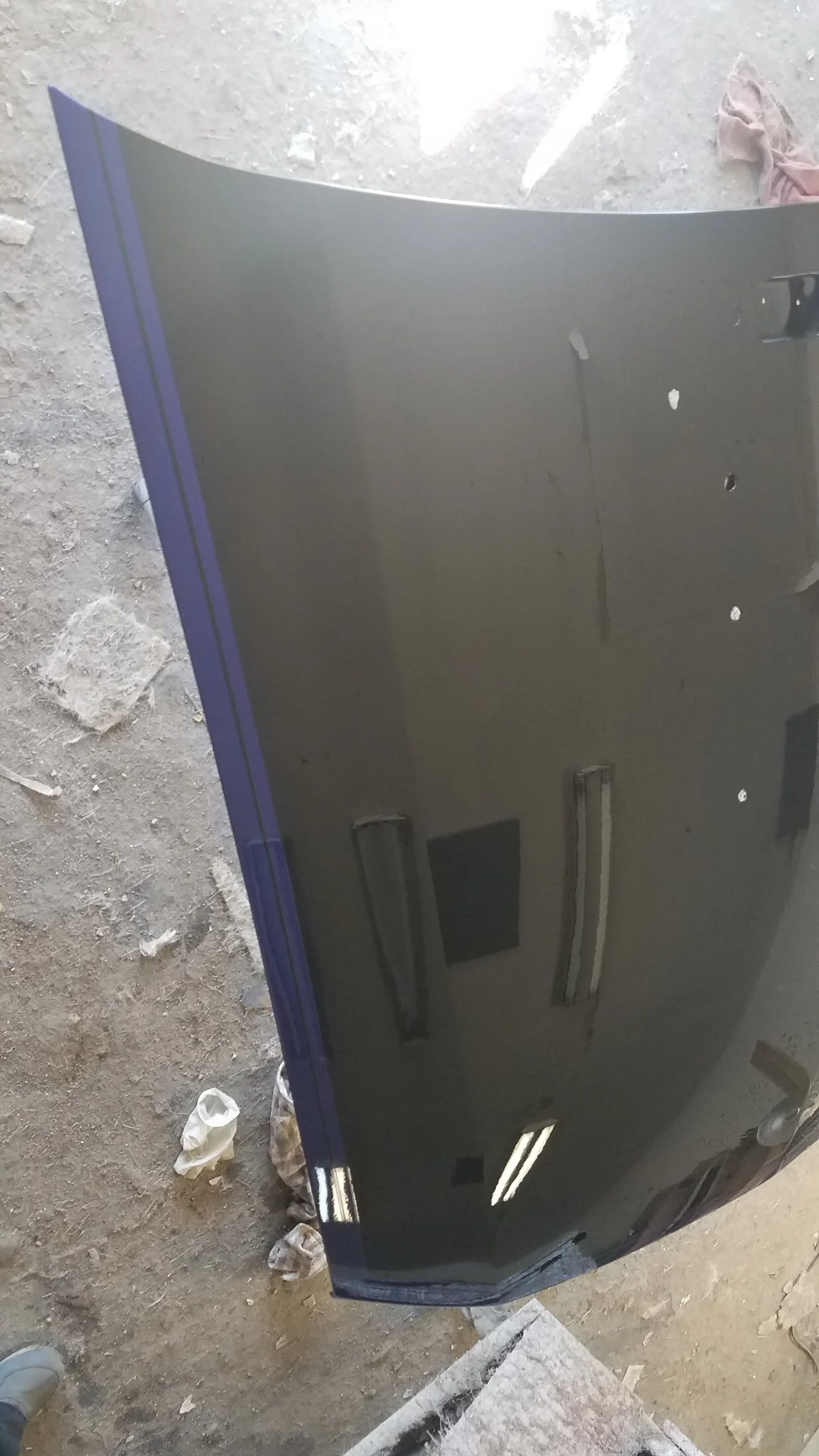

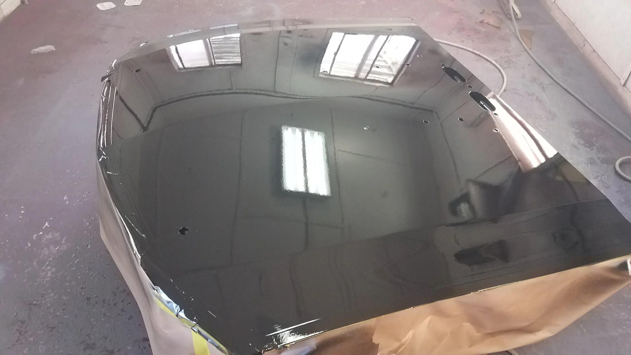

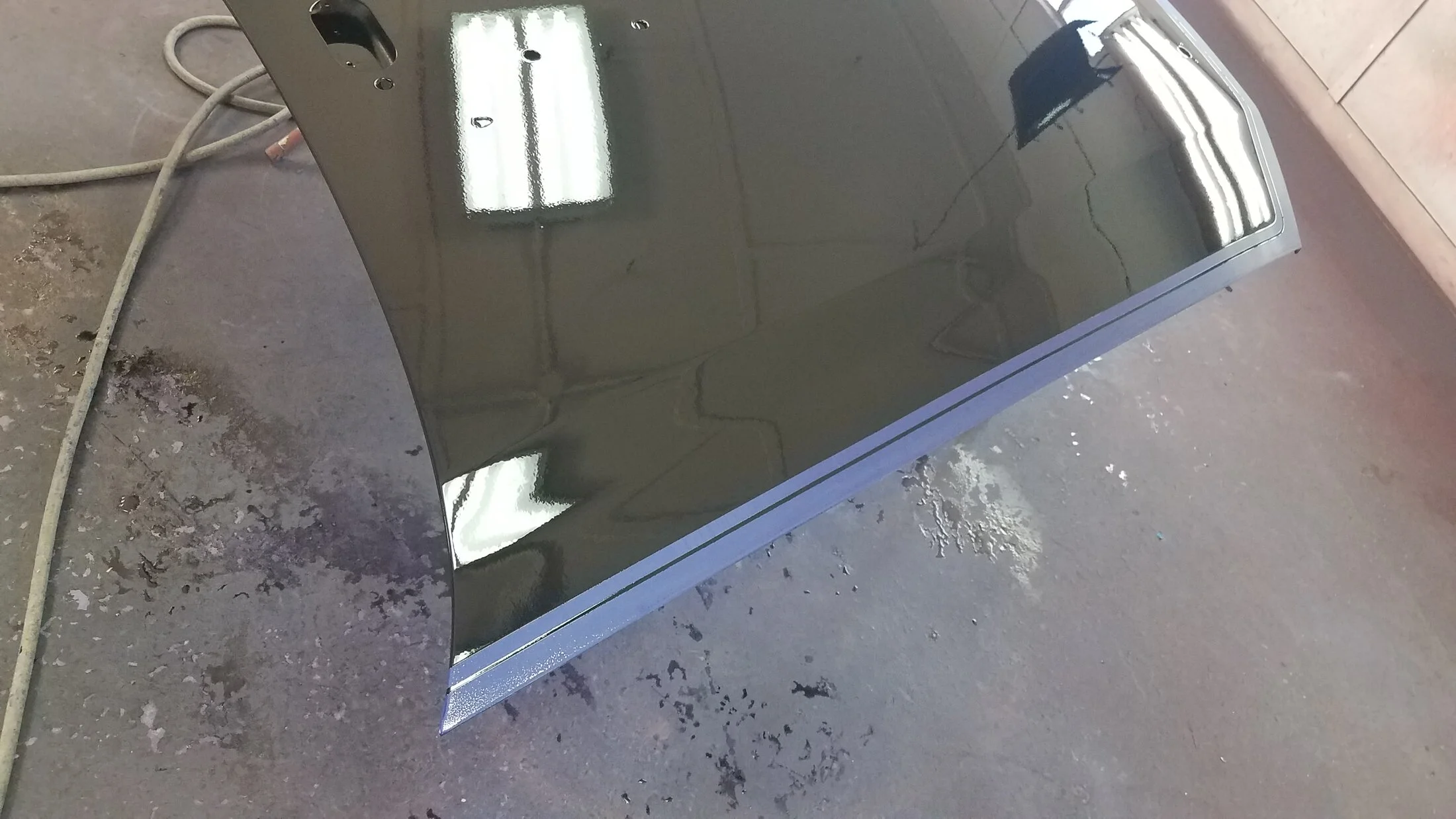

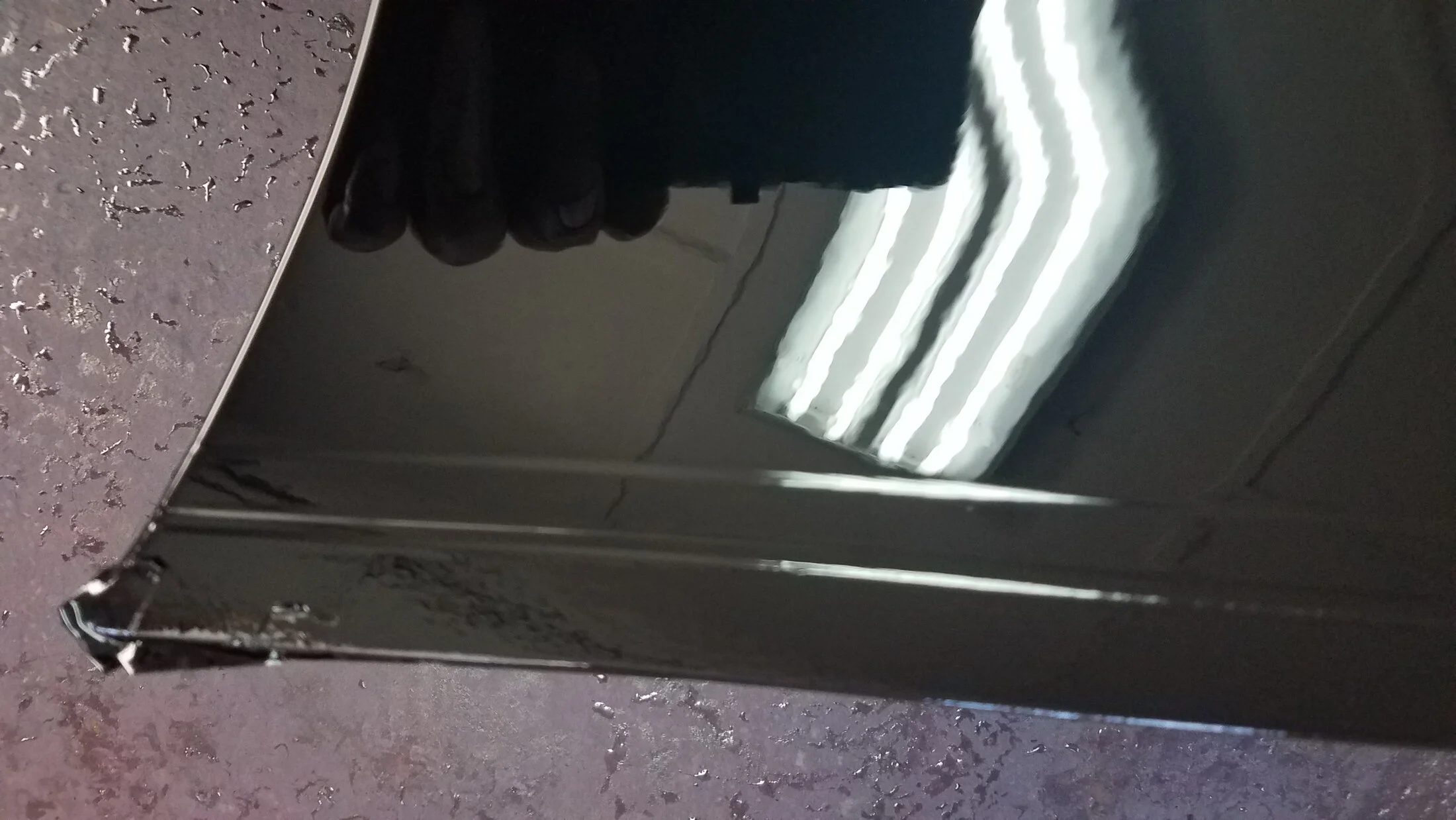

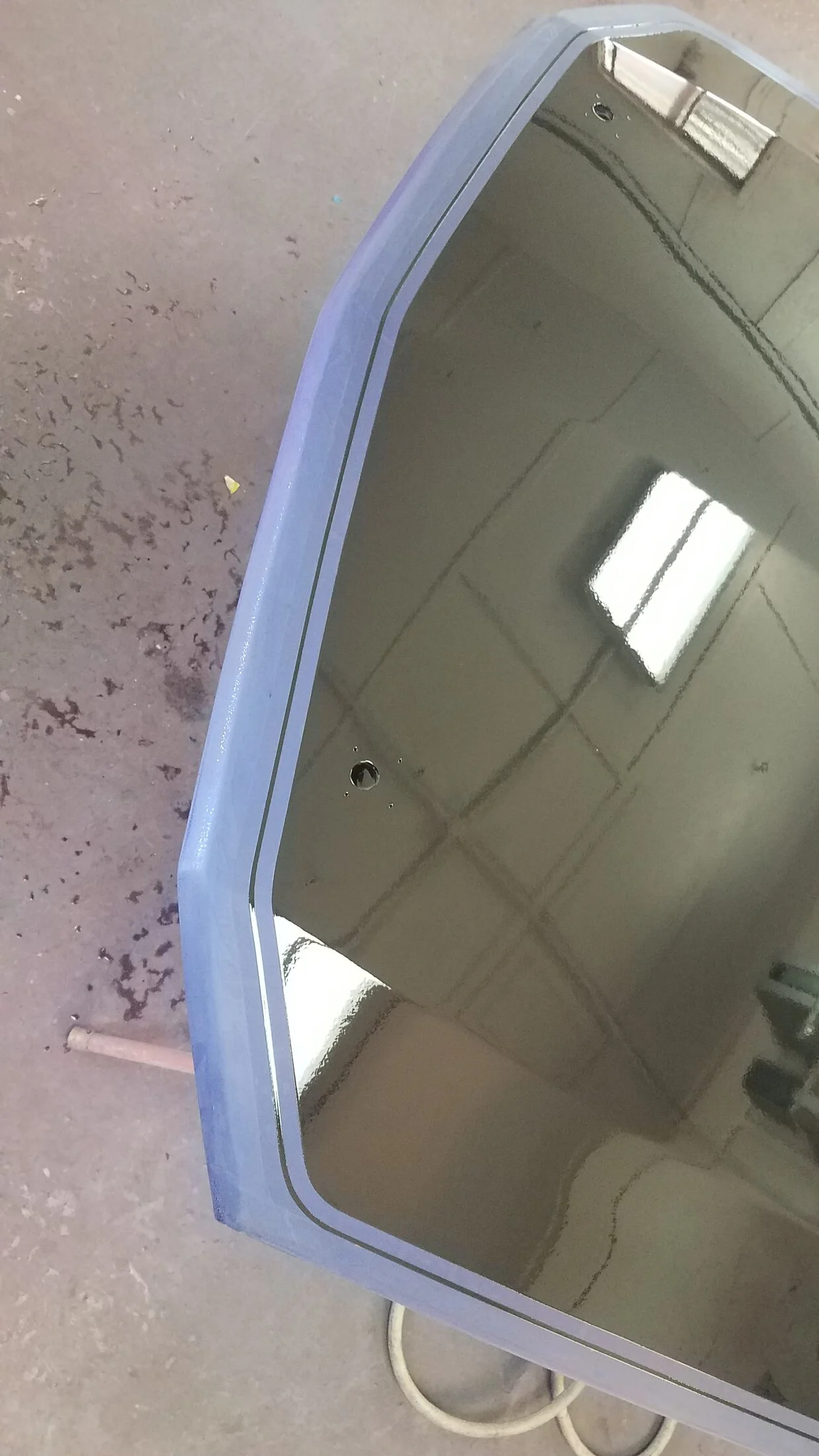

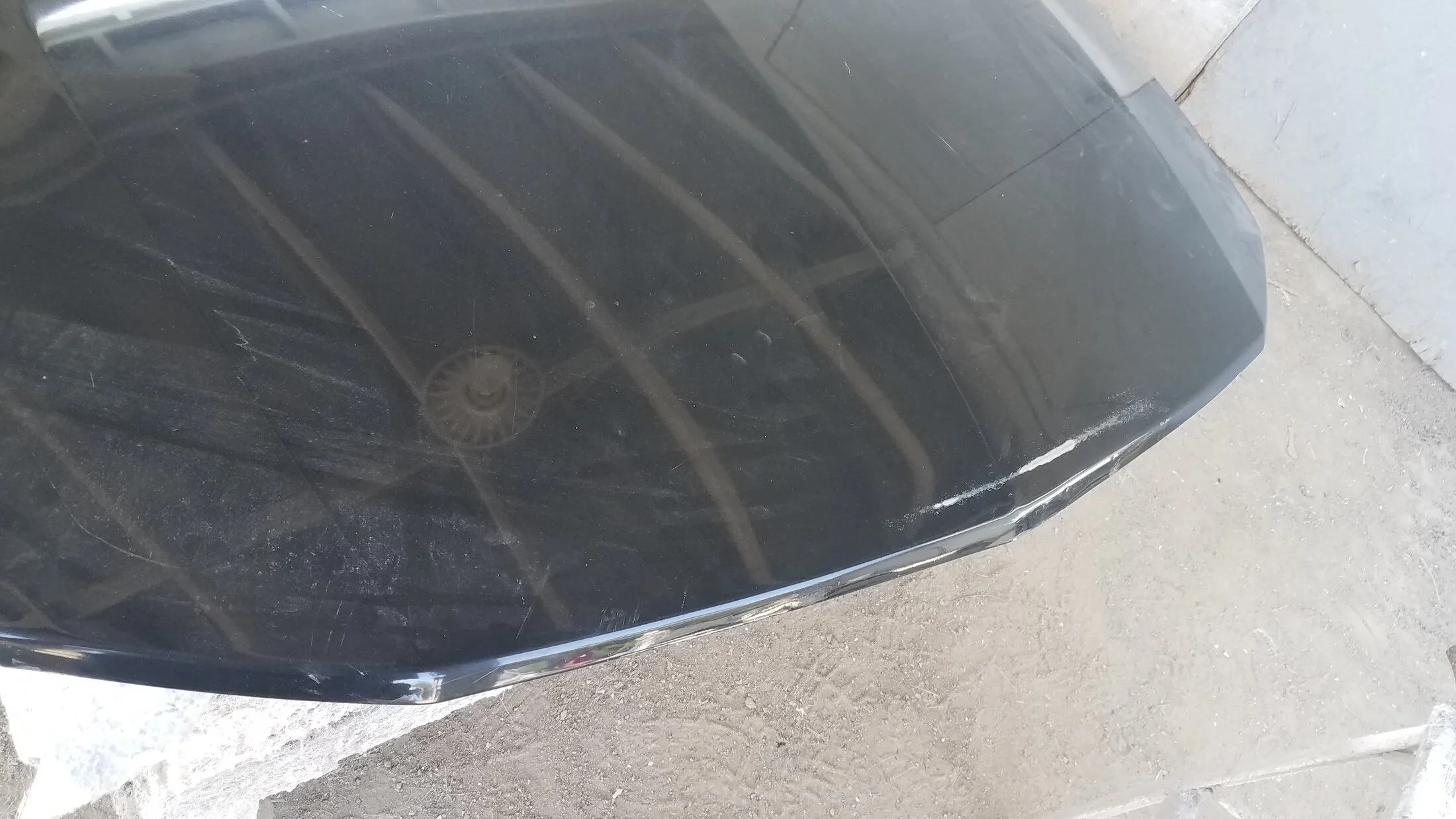

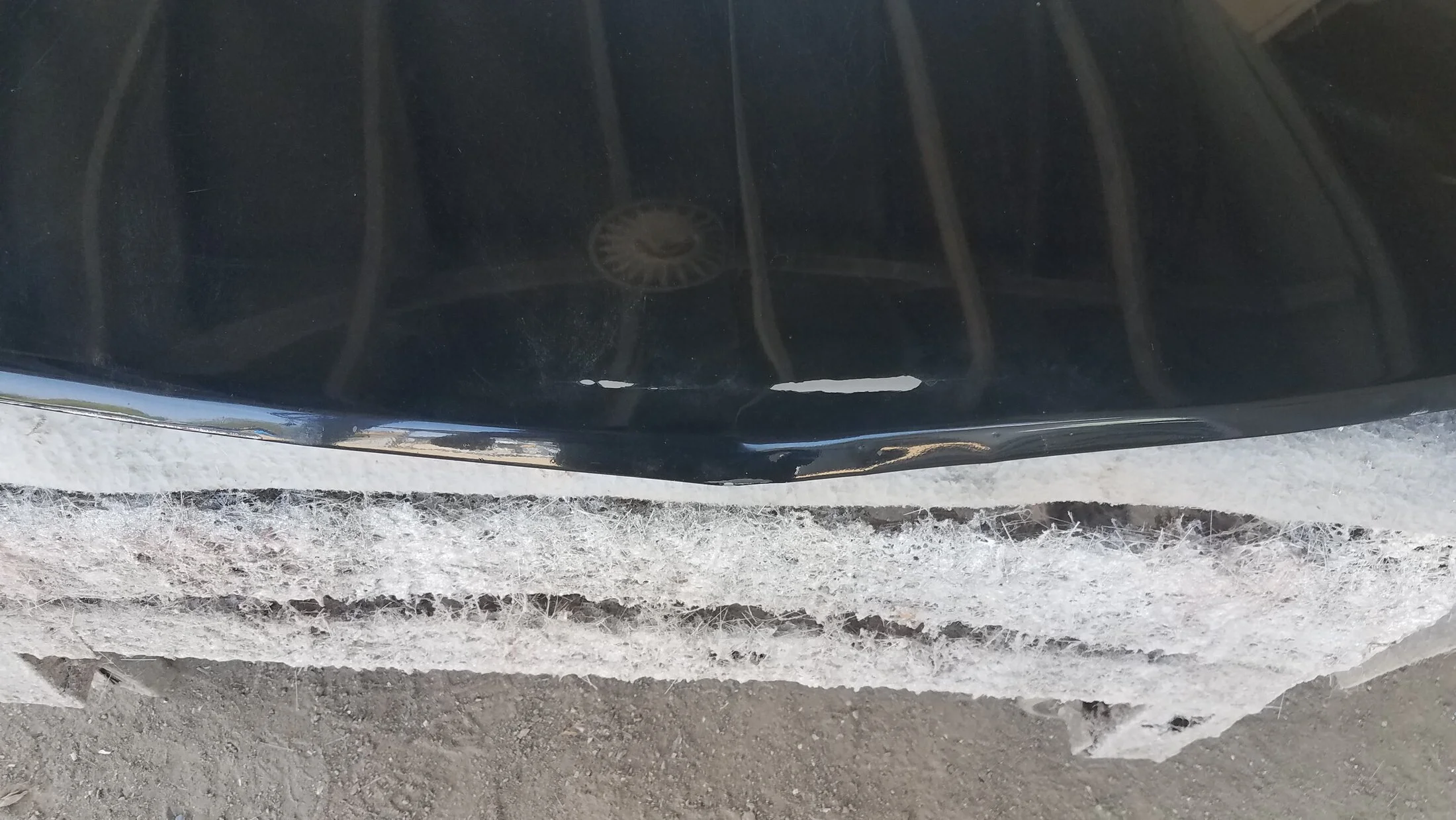

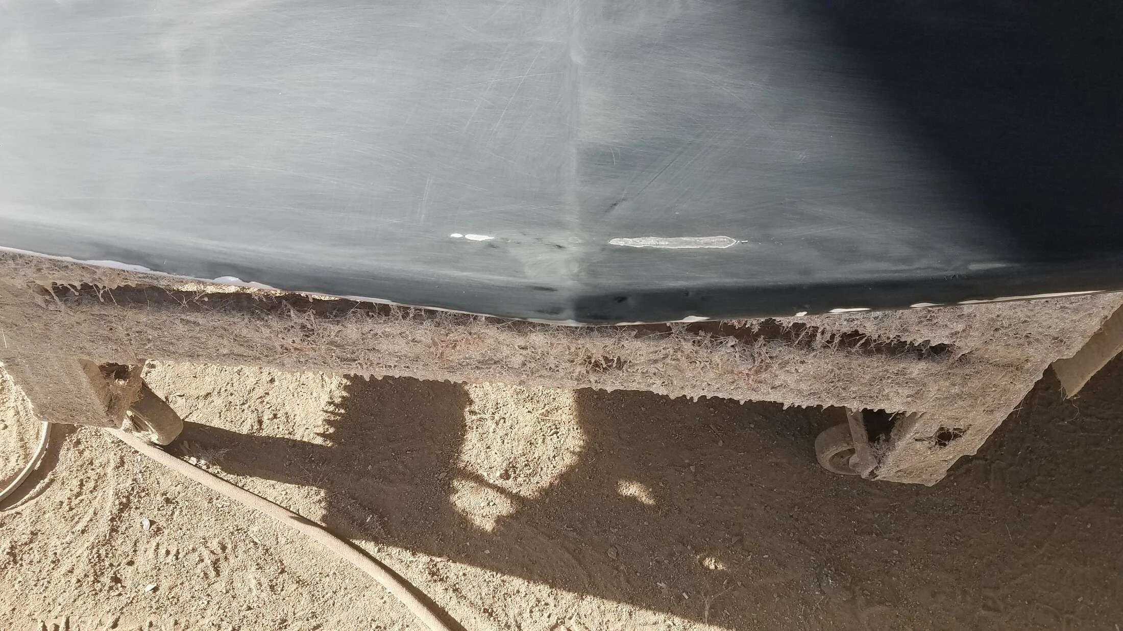

I transferred the pattern to a black hood i have here with a bit of damage at the peak . I am pretty sure i can straighten this hood so he can save his original hood .

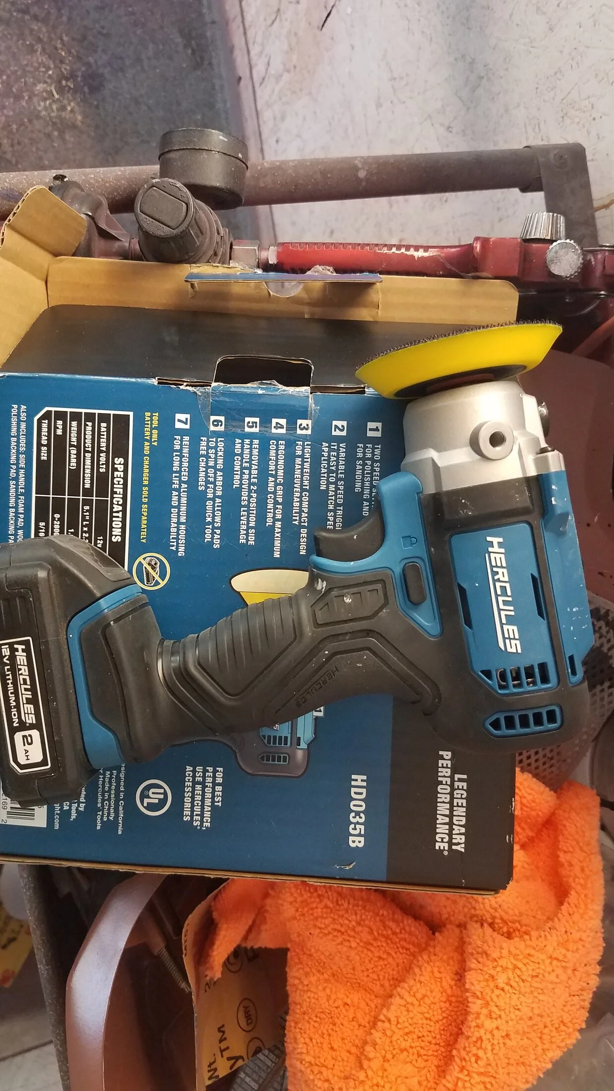

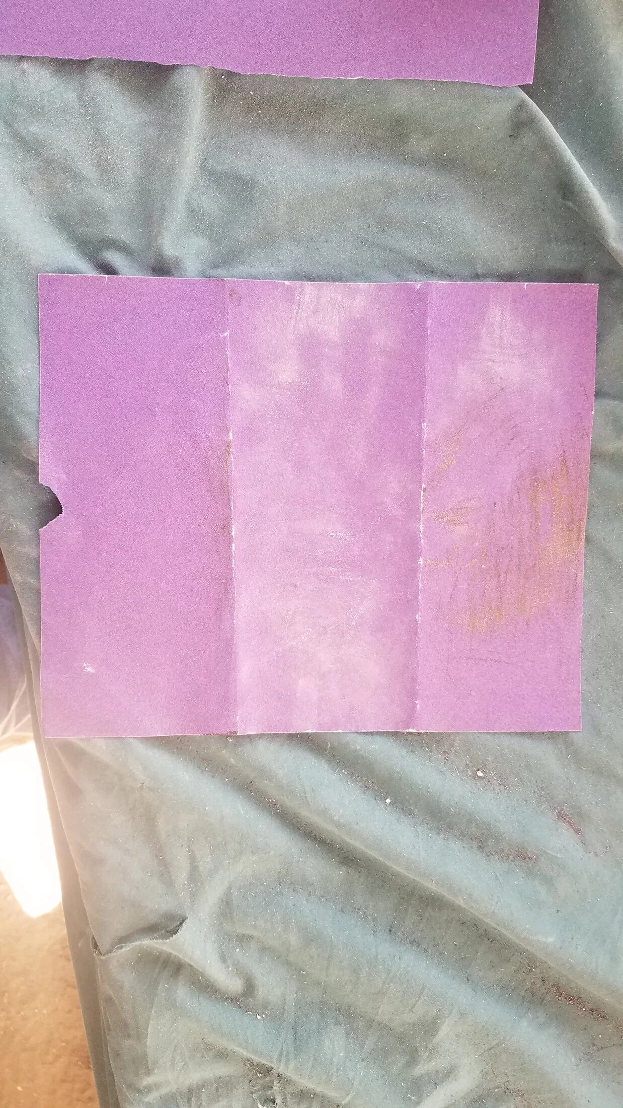

I bought a couple of sleeves of sand paper last week ,80 grit and 150 grit , i took out the first sheet of 80 and used it up and went for another sheet , what the hell! It was used ! I didnt think much about it and went on with 150 grit ,first sheet used up i got another one ...you guessed it ,it was used also ! Some jack ass used 1 sheet out of both sleeves ,put it back and must have returned the paper haha ! There is some real tight wads out there !

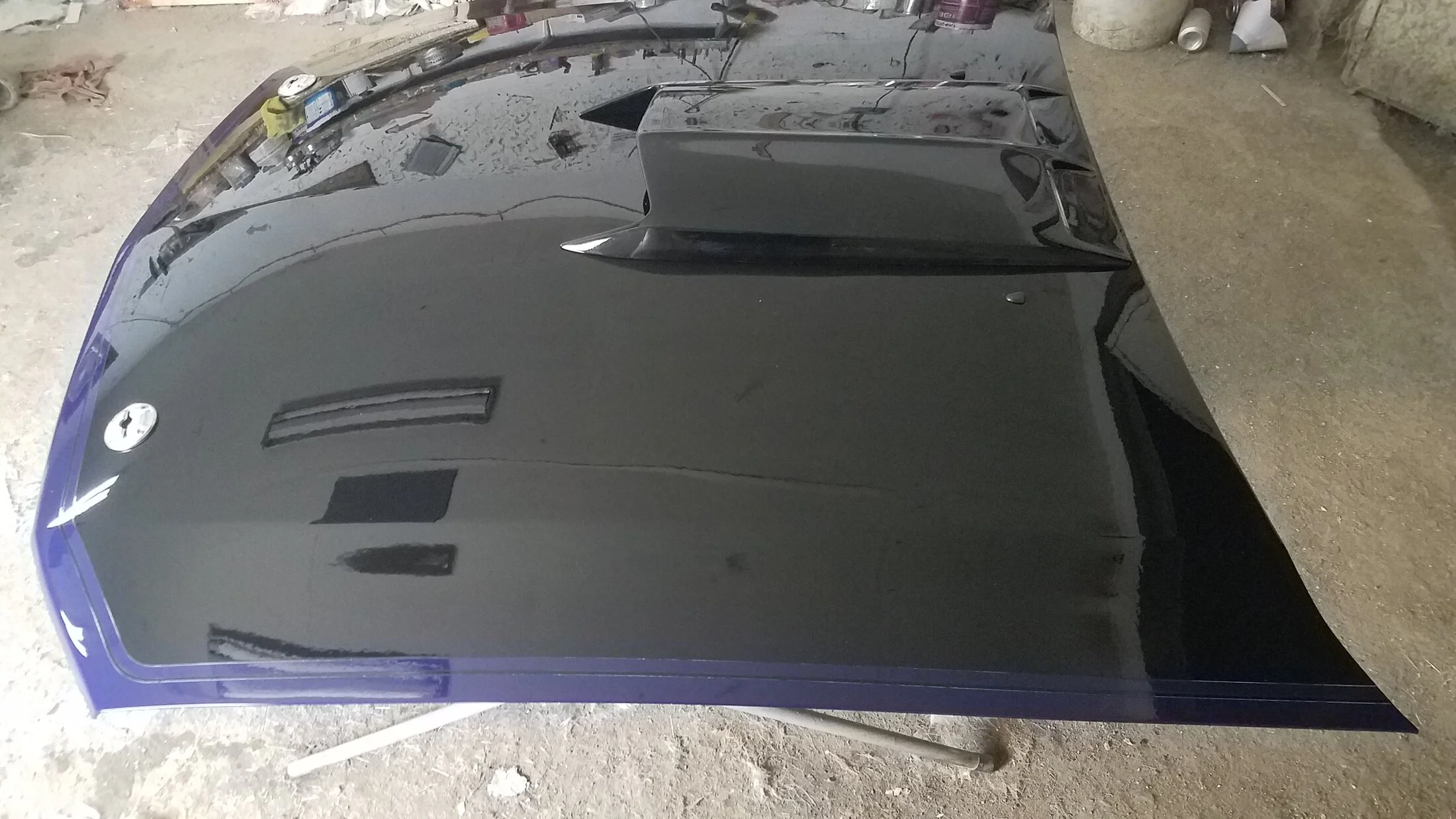

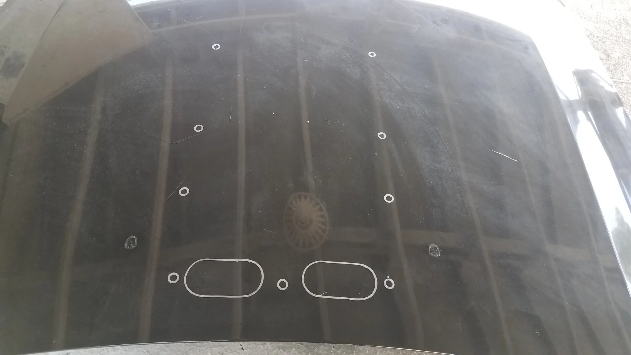

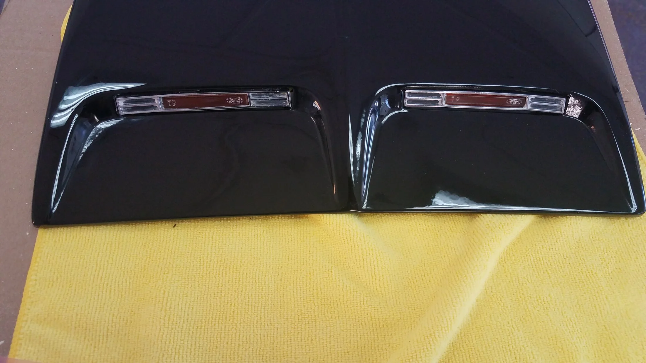

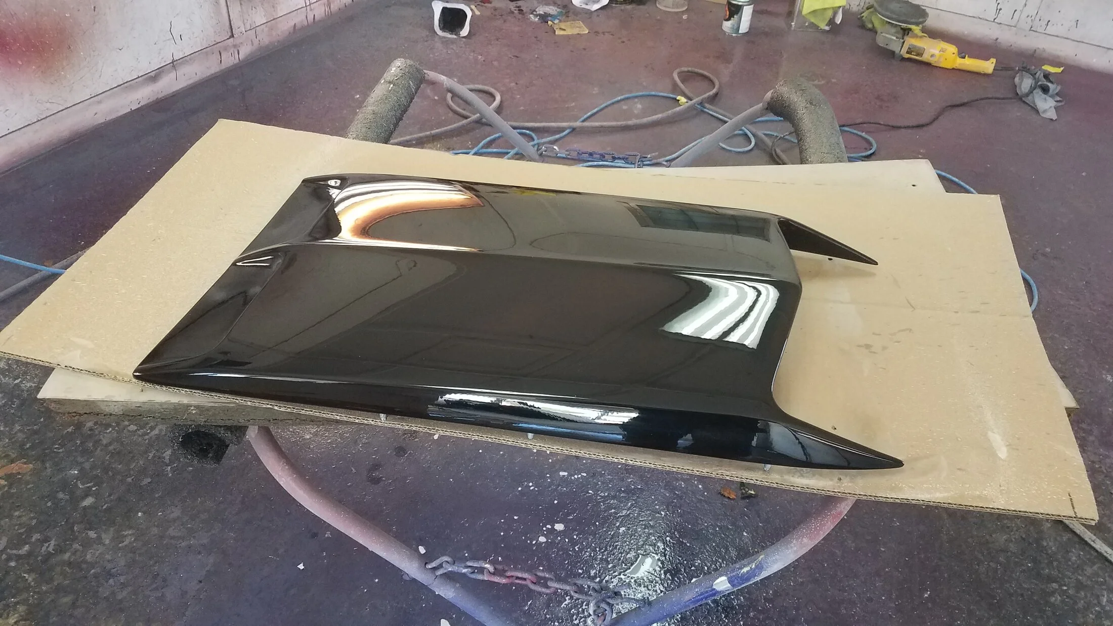

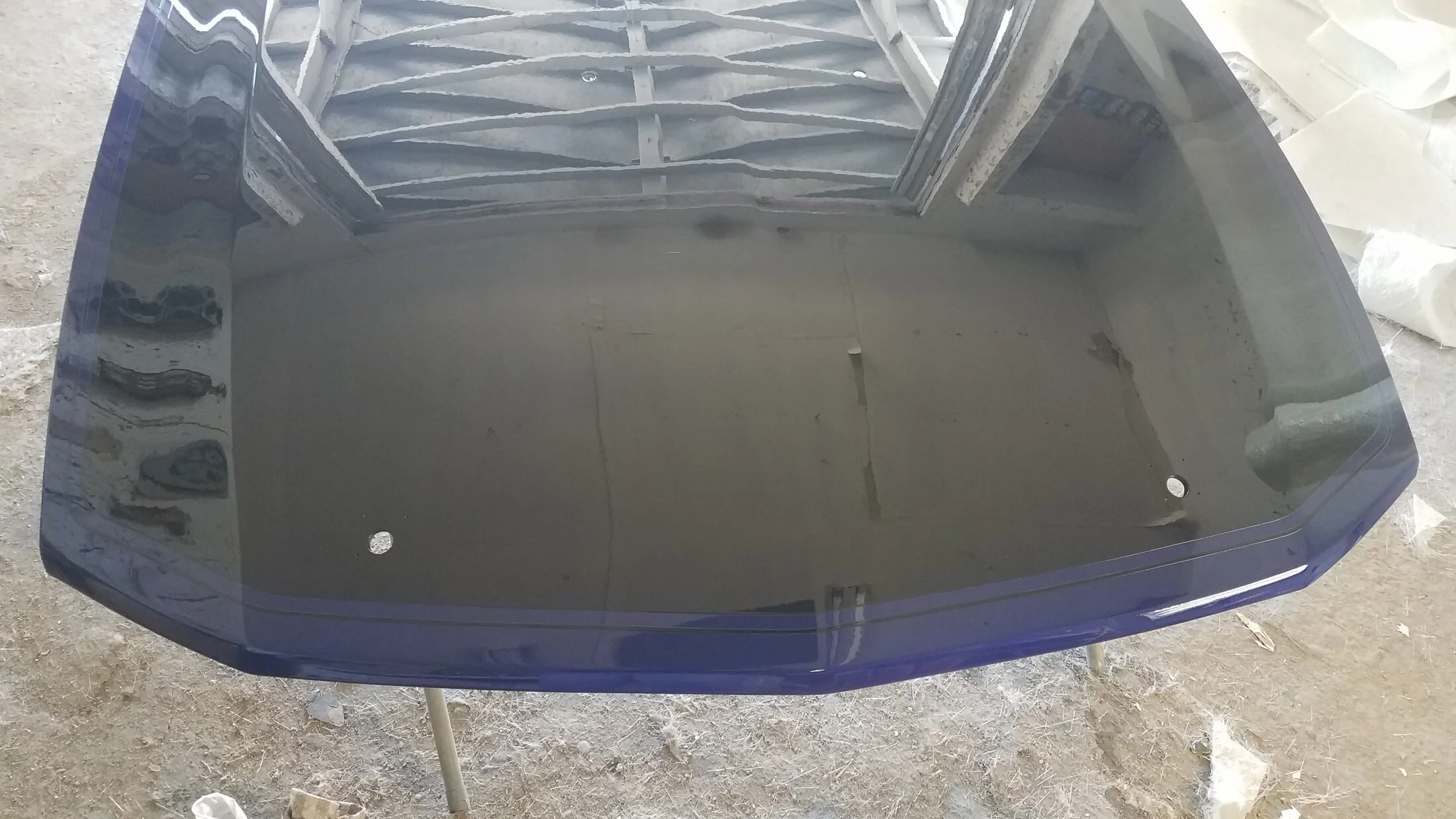

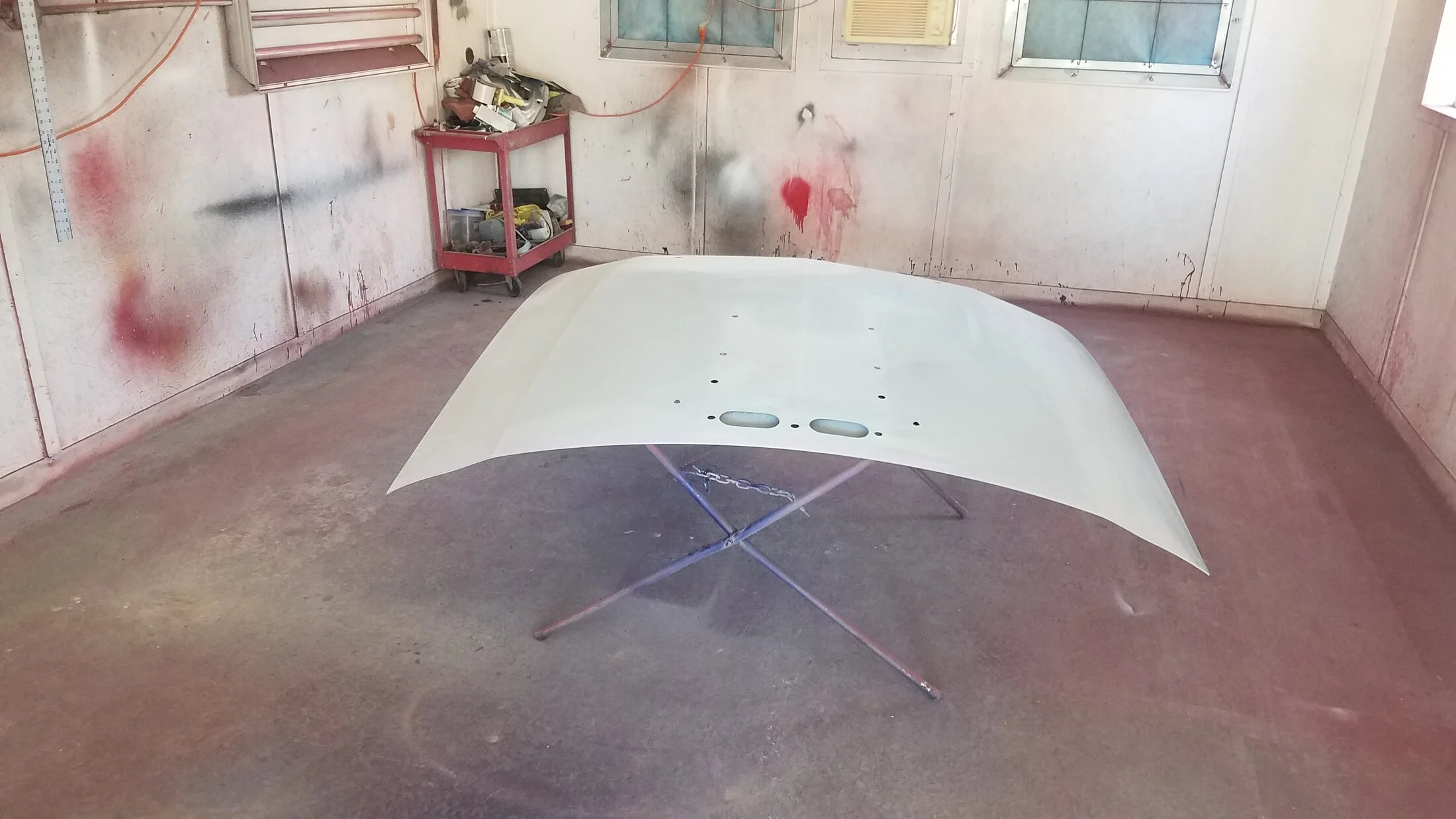

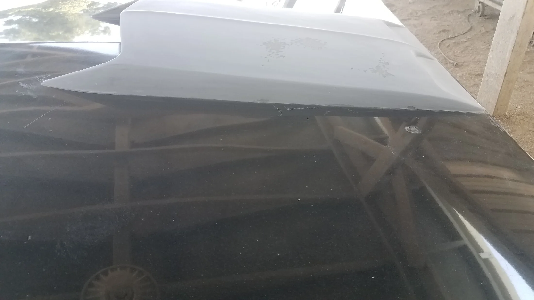

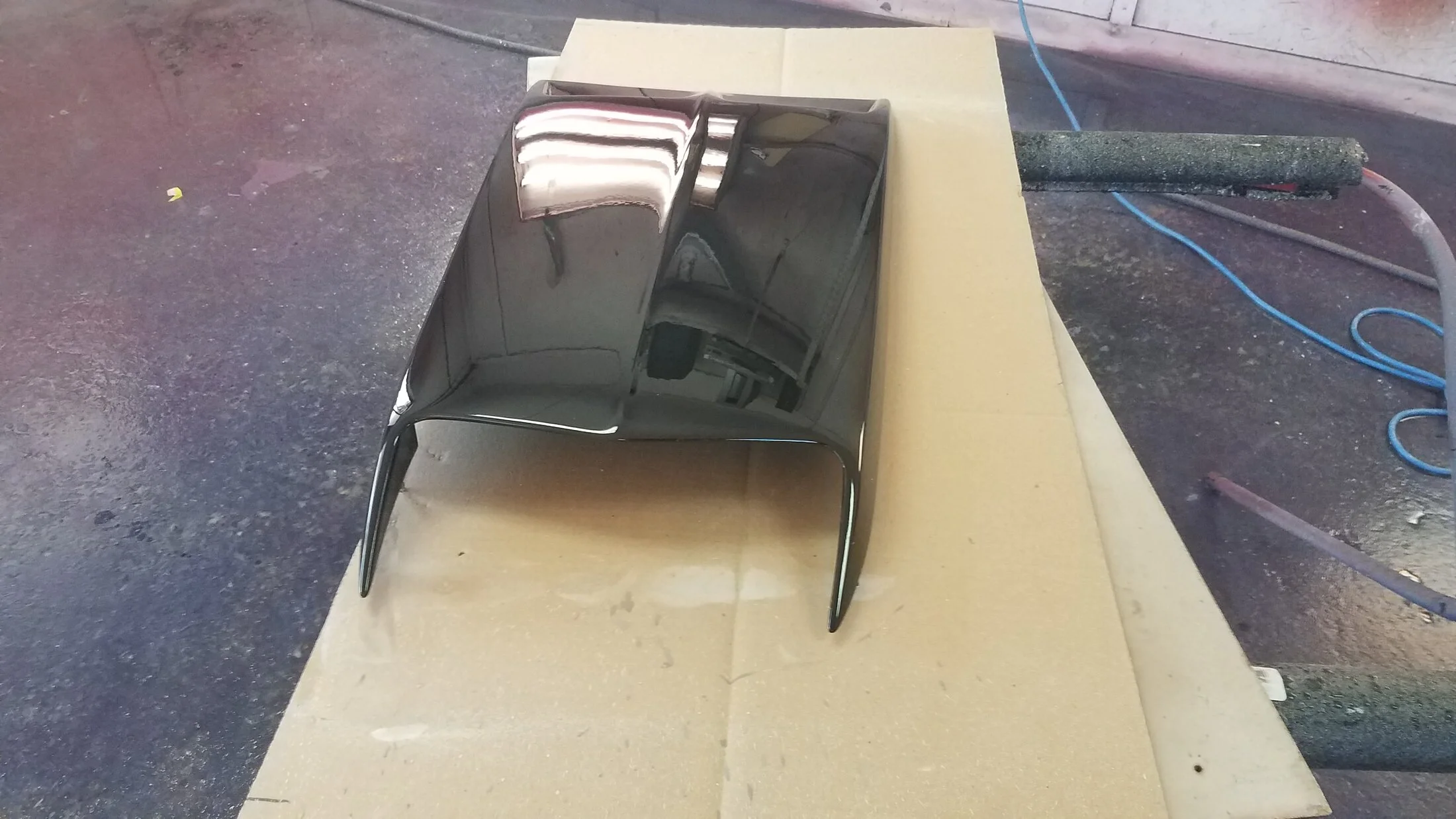

The turn signal lights are mounted in the scoop ,they will be functional . Also mounted the scoop grill.

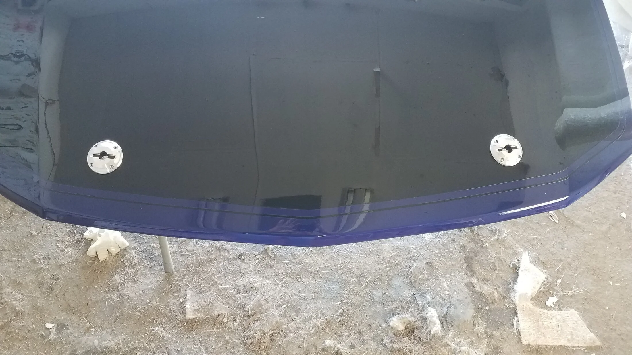

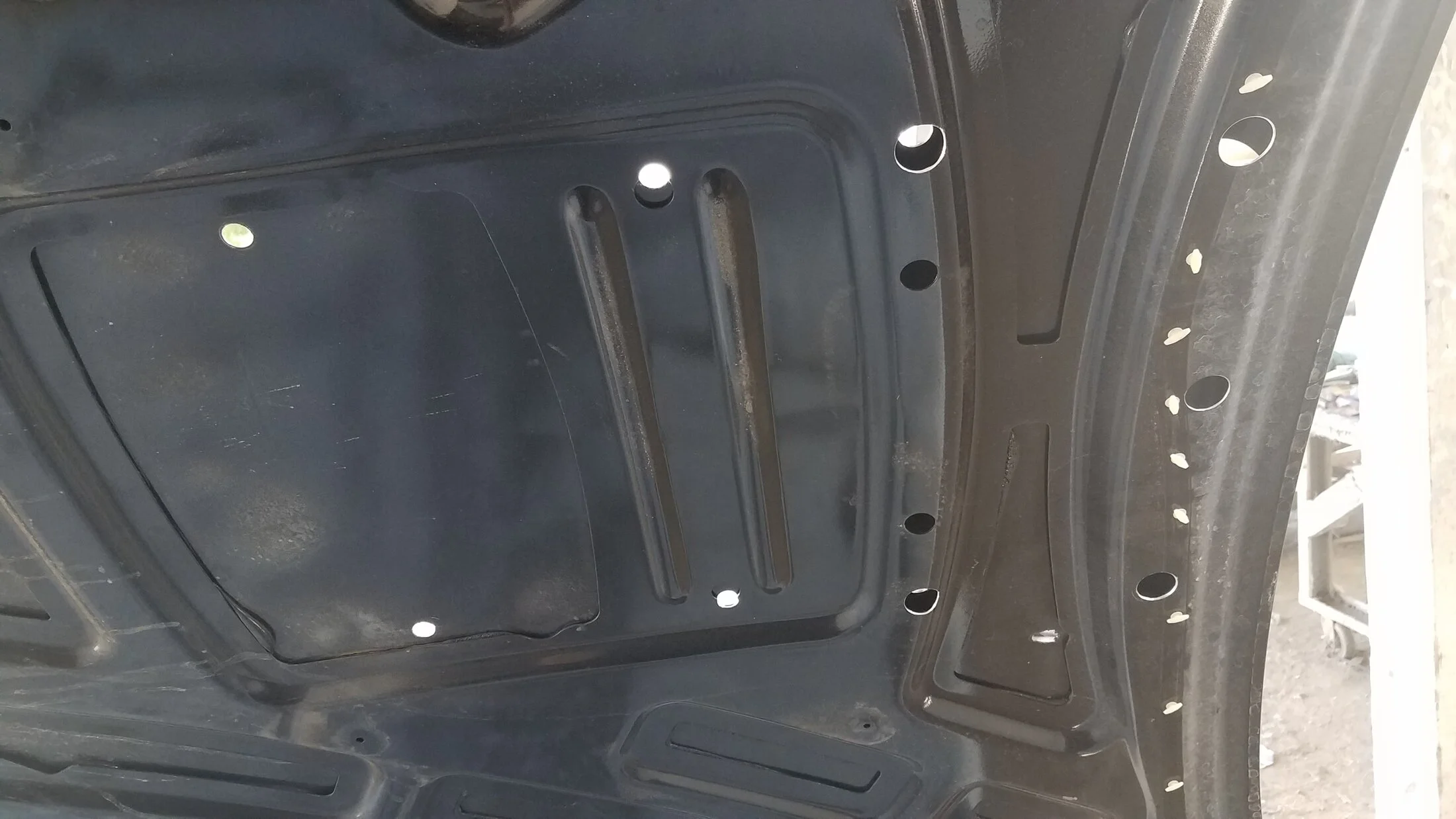

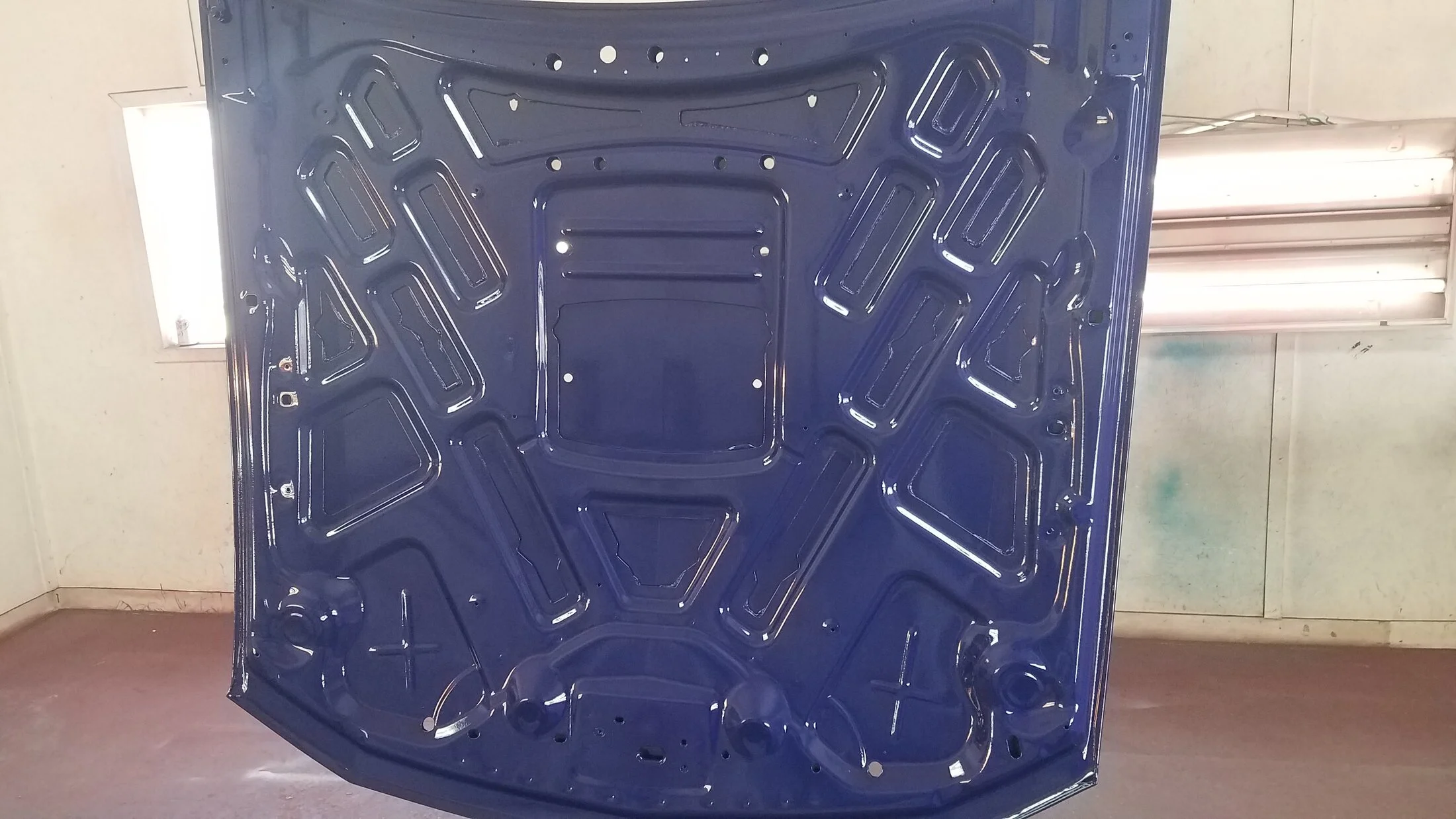

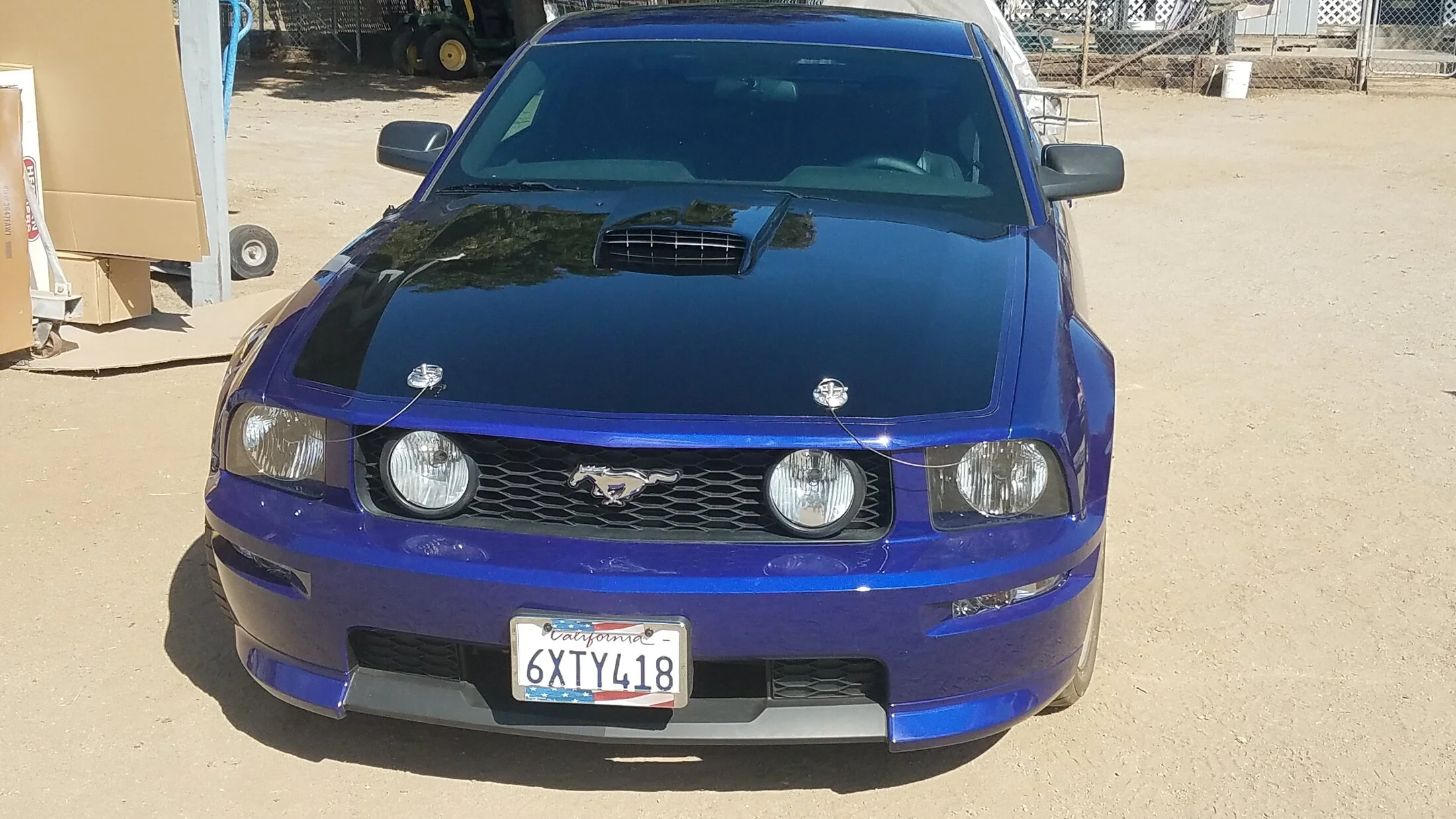

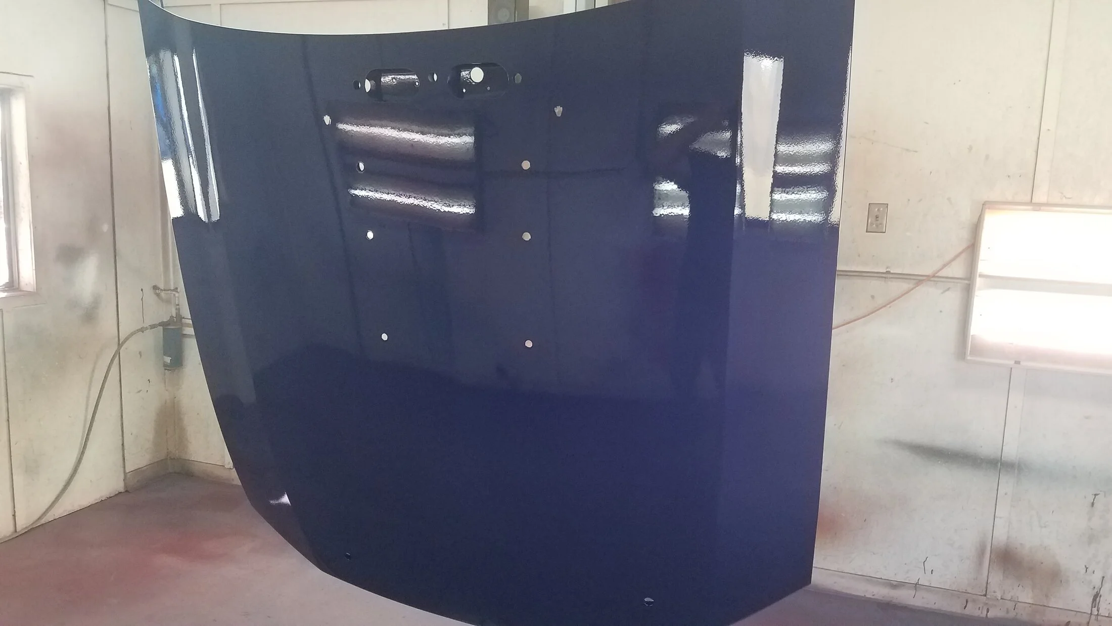

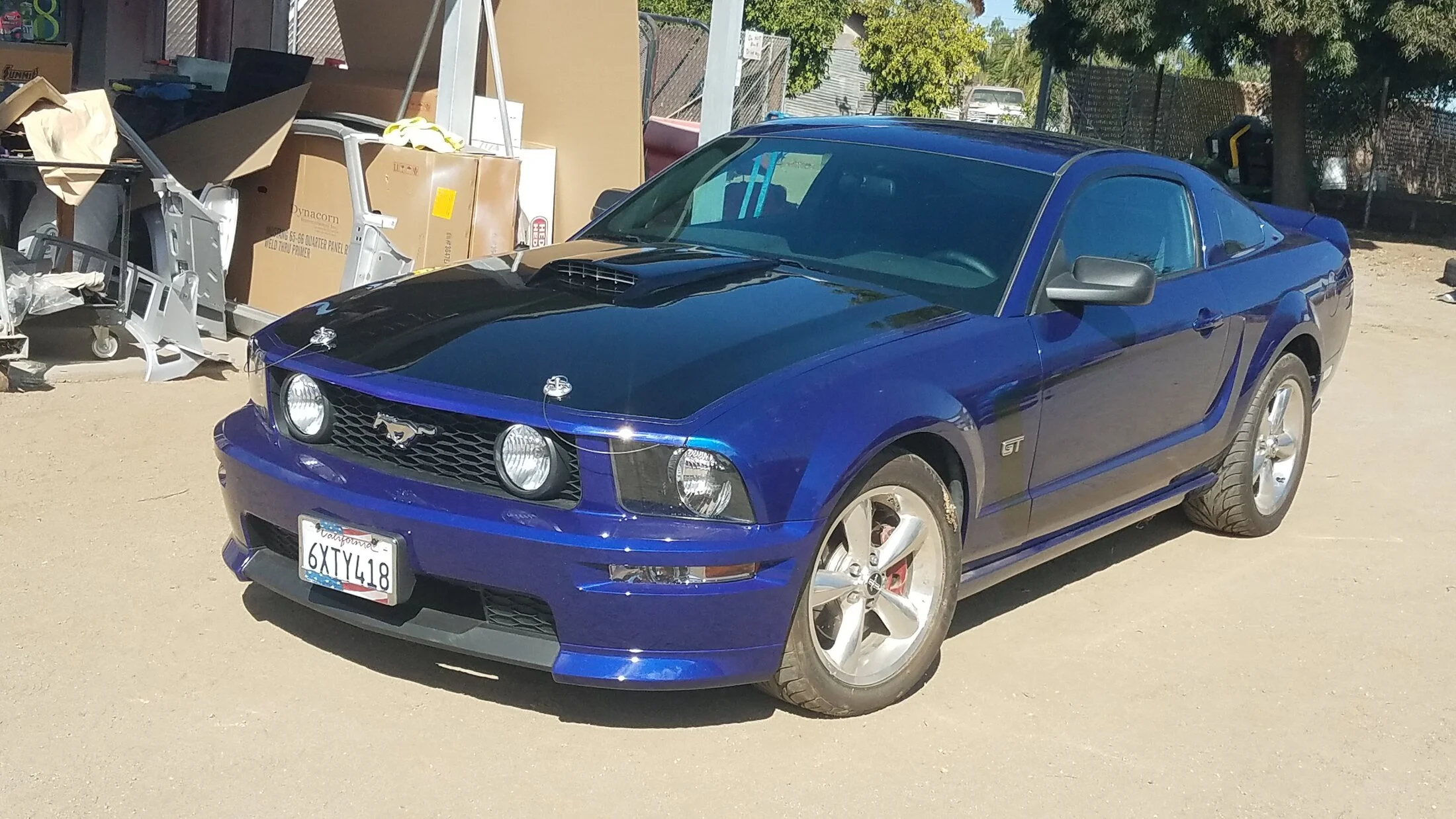

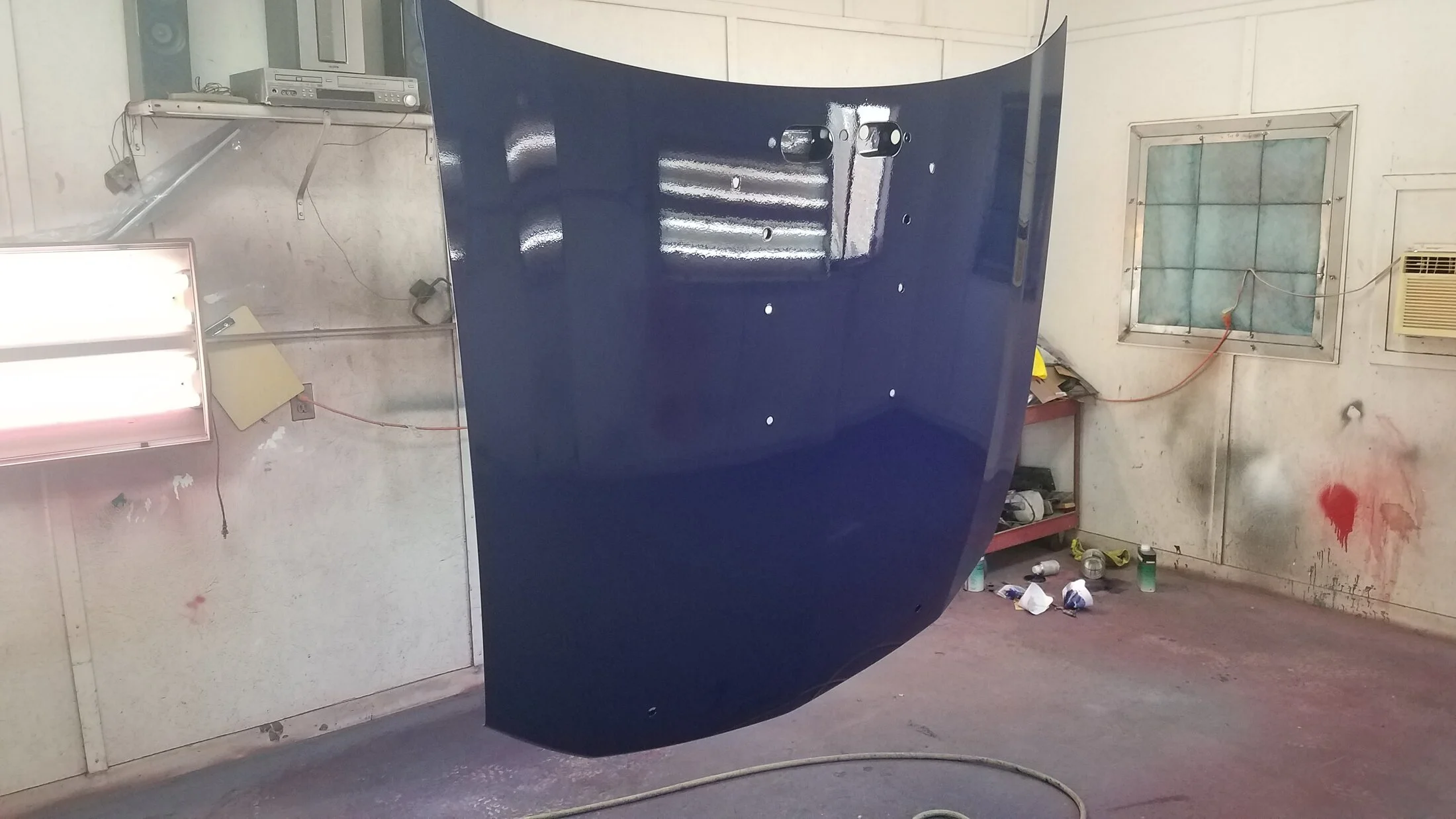

The wires for the scoop is mounted in the hood along with the windshield washer squirters and the hood pin plates on the front of the hood ,the scoop can be mounted tomorrow and the hood bolted on the car ,this is going to look cool !
