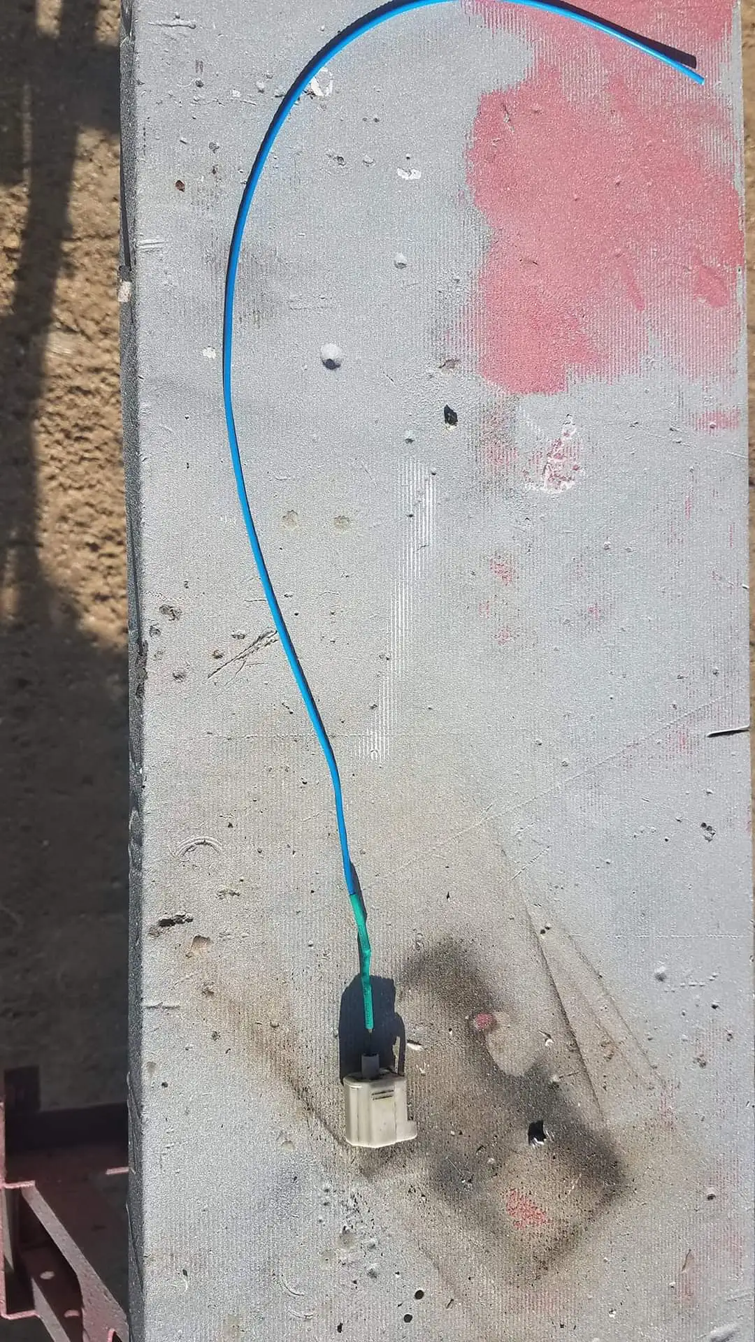

Damn cotton tails got under the hood and ate the oil sender wire off ! Started it this morning and no oil pressure . They did the exact same thing to my red 05 a couple of months ago ,that wire must taste good or something! Spliced it ,soldered the ends and re wrapped it and oil pressure once again . Time to start cooking some rabbit stew !
