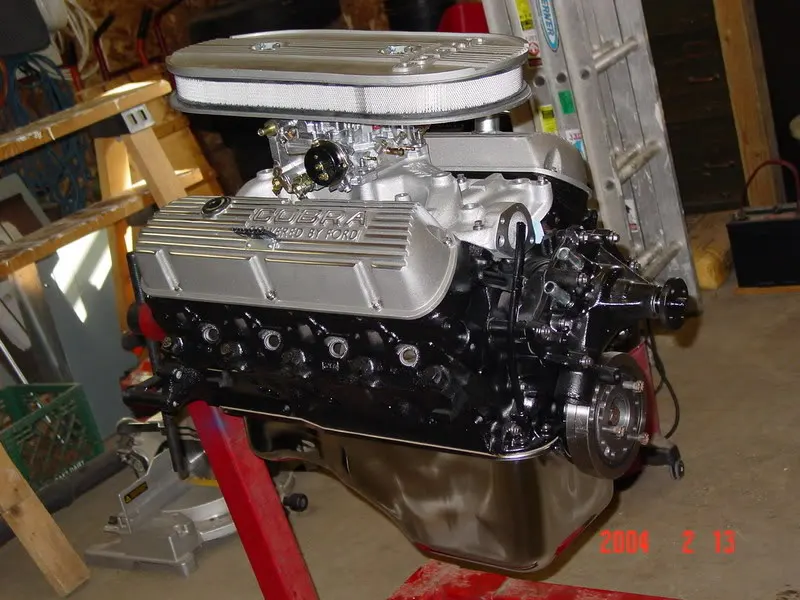

Here's an example of a 289/302 with a nice-looking, yet inexpensive, Edelbrock Performer package and Cobra dress-up kit. I built this for my dad's '65 Coupe, and will be installing this in my Fastback until my dad's Coupe is ready for it or I build my new engine, whatever comes first.

im not lookin for how much this car is gonna be worth its not for sale nor will it ever be she just wants to be able to drive the car and i already own the lincoln towncar so this way i would not have to buy a drivetrain and i would install it myself i dont want to waste the money in building up a motor all the car needs to do is be dependable and look "pretty" all i was wanting to know is if anyone has done this before ive seen them installed in fox bodies but never in anything older if it were my own car i would never put this motor in it for my own likings but shes not worried about whats under the hood
