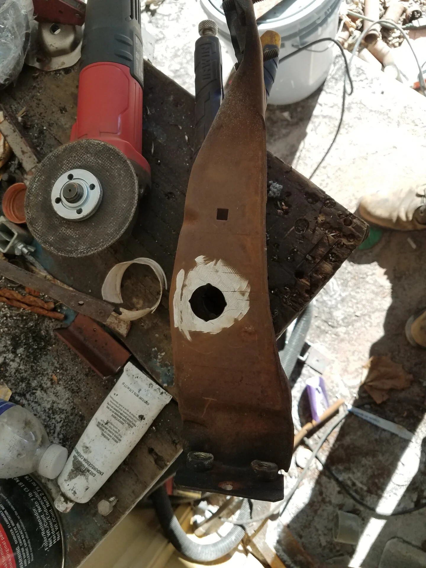

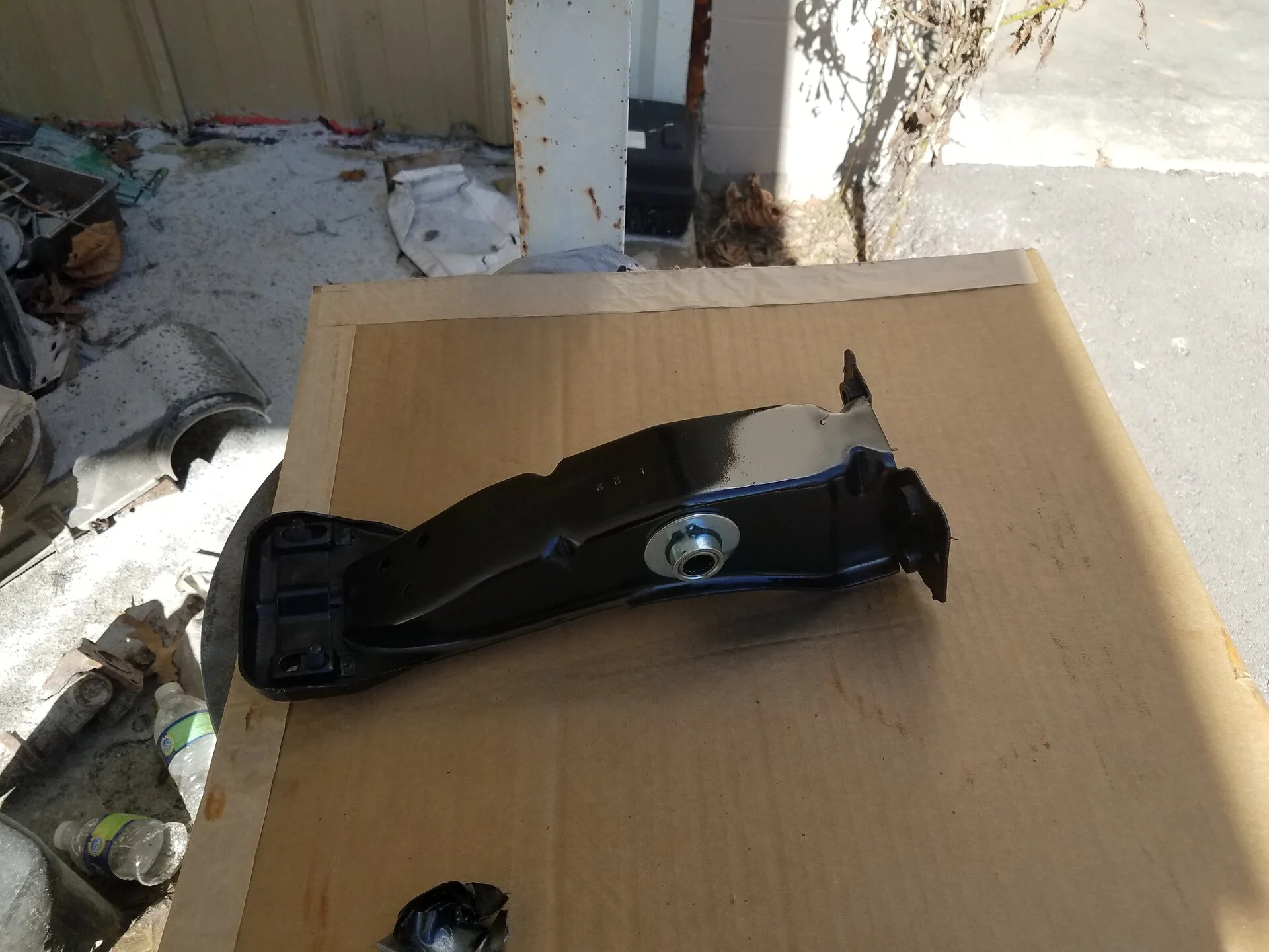

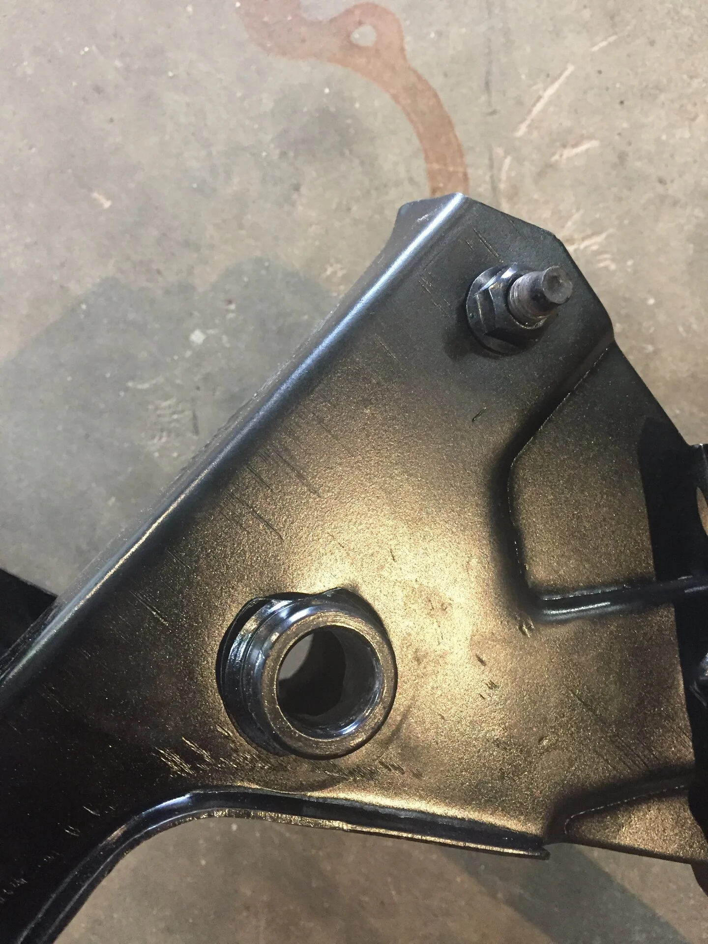

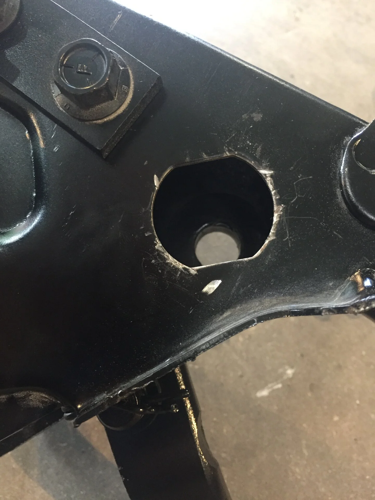

Need help finding the right pedal bushing for my 1970 mustang my pedal assembly as a oval hole with flats spots on each side of the bushing and is not round like all the bushing kits can anyone help??

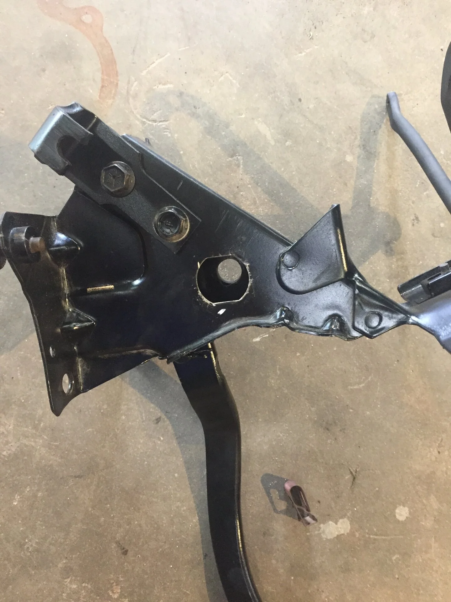

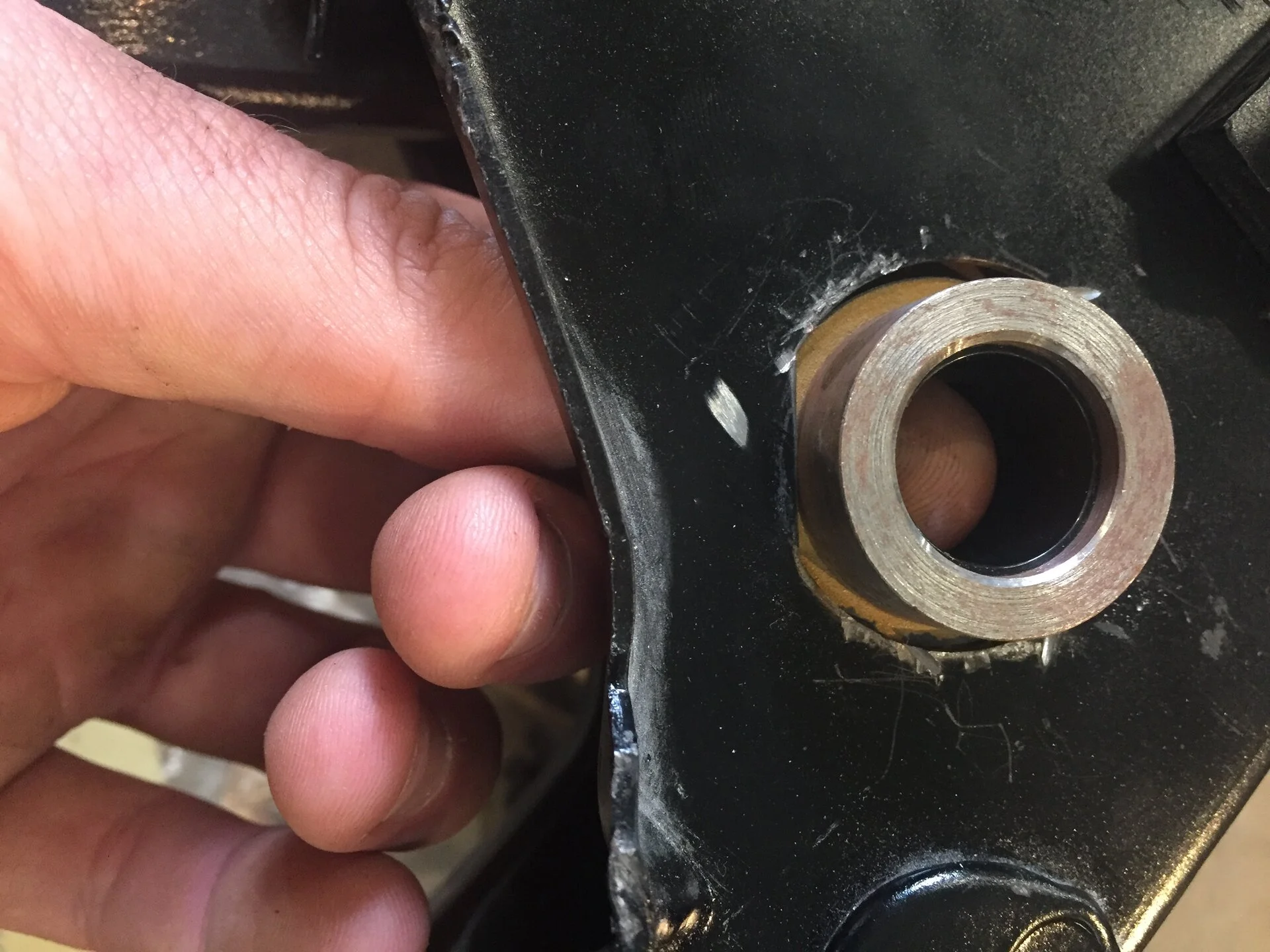

Since you have the assembly out...I suggest converting to a roller bearing system:
In makes for a much smoother pedal, I did it myself, you essentially weld washers on to center the shaft in your case since your pedal hole is oblong.
