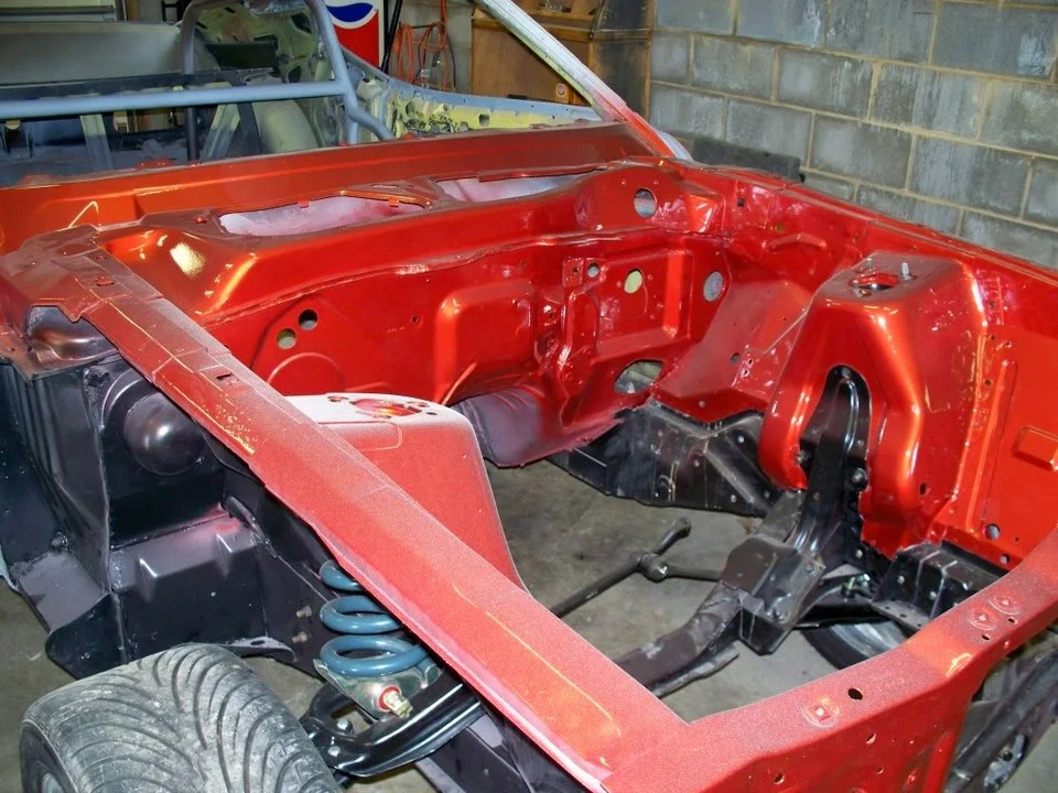

Hi all I’m Steve. I’m new to this site. I was looking up pics of 71 -73 mustangs and found a pic on here of a fastback mustang with a full vinyl roof, I was amazed! I am currently restomodding a 71 mach1 and when I had it blasted I found that it was a full top car itself. I’ve only seen a few pictures of this option and loved it. I had no idea I had one. Any info, advice or anything would be greatly appreciated. I sometimes think I’m the only person in the world that loves these mustangs. Every time I meet another mustang fan, I always hear the same thing……Why didn’t you do a 69, 68, 67? Don’t get me wrong I love them and all, it’s just the 71 is my favorite.
Here are a few pics of my car. I have been working on it for years now. It should be done by now but the economy sucks.

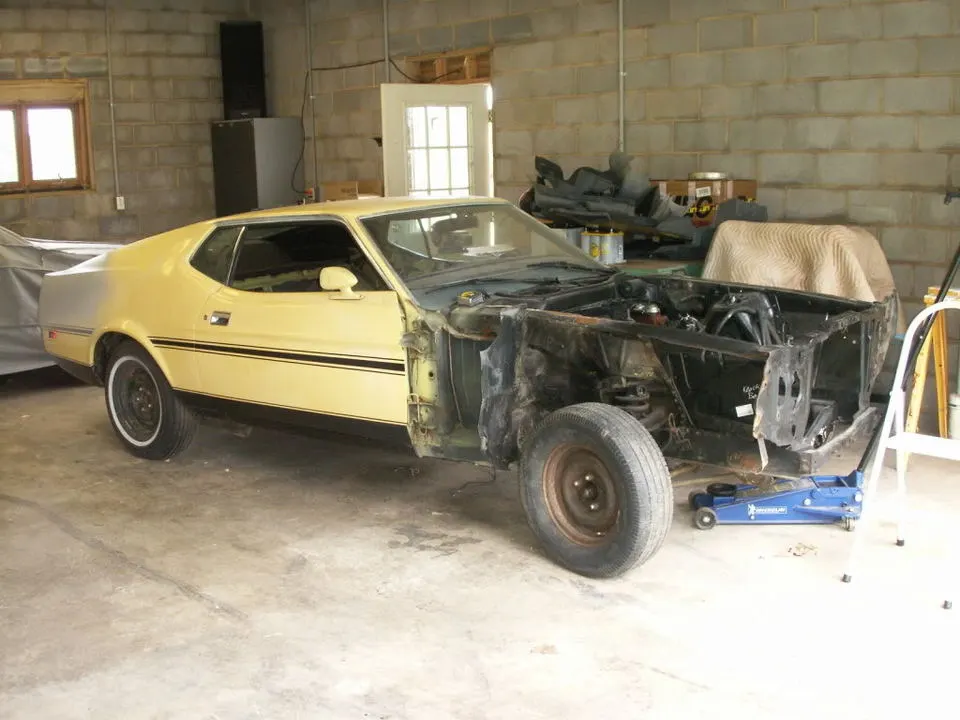

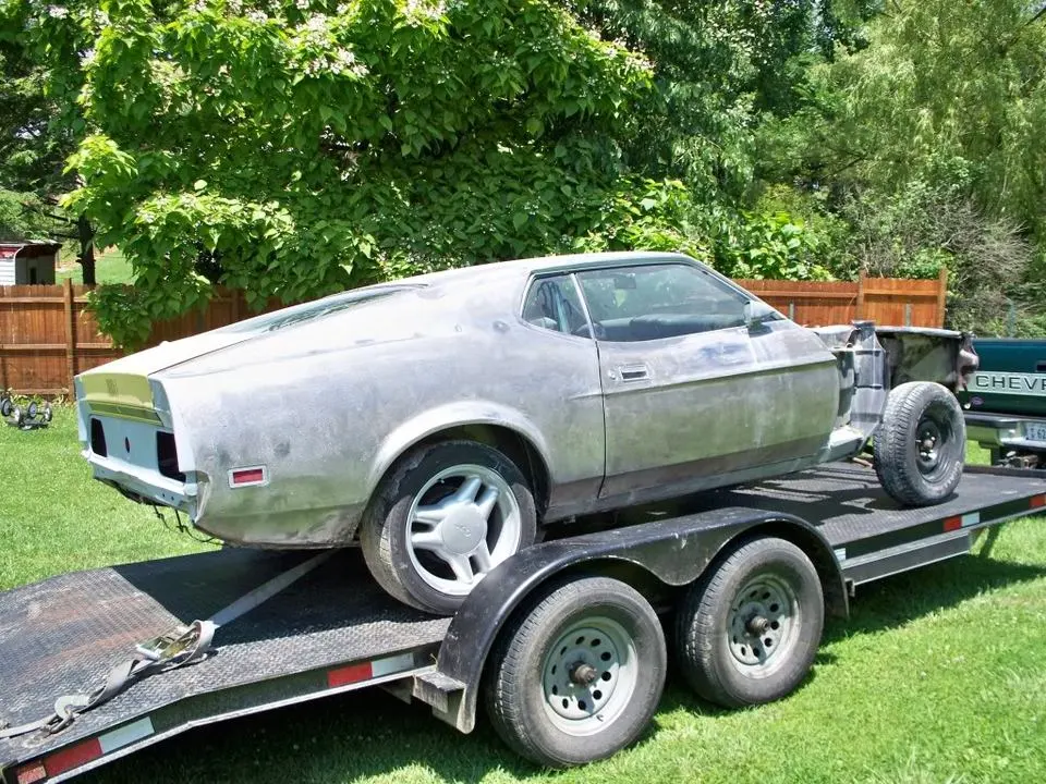

This is when I first got the car. (The pic looks alot better than what the car actually looked like)

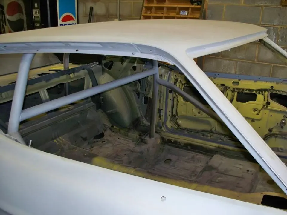

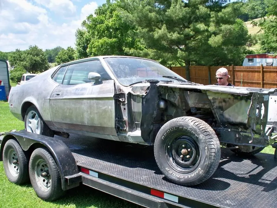

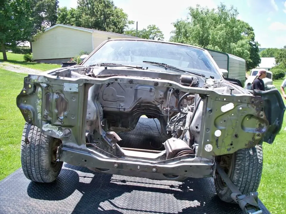

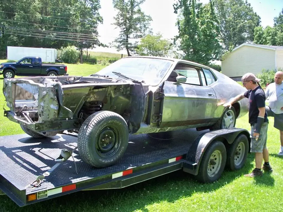

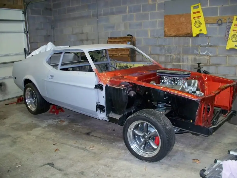

Tear down before soda blasting

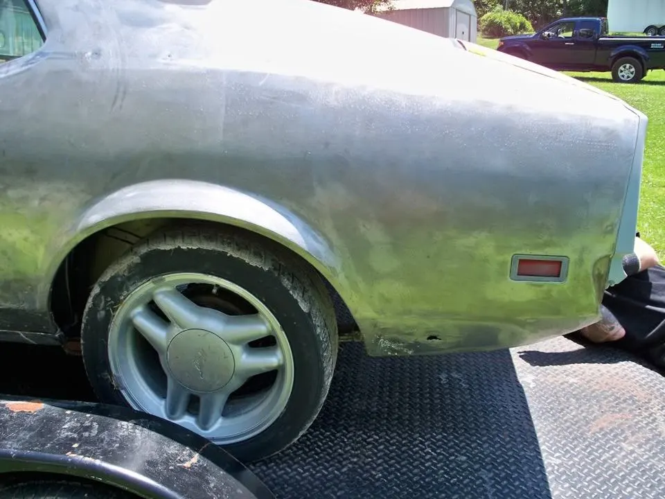

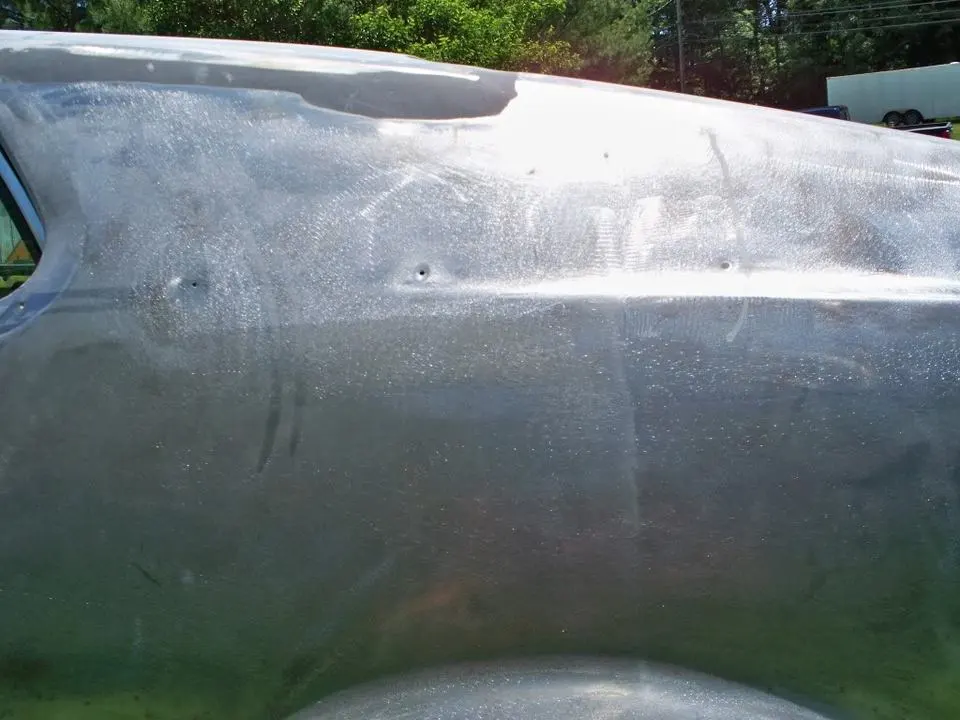

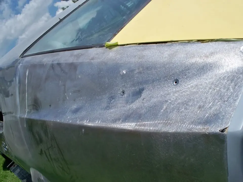

After blasting I found holes where it was an original vinyl top car

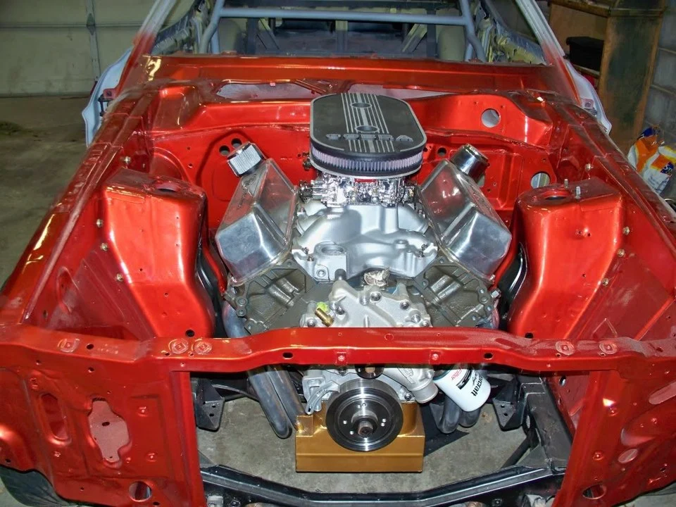

Tremec TKO 600 Lakewood Belhousing

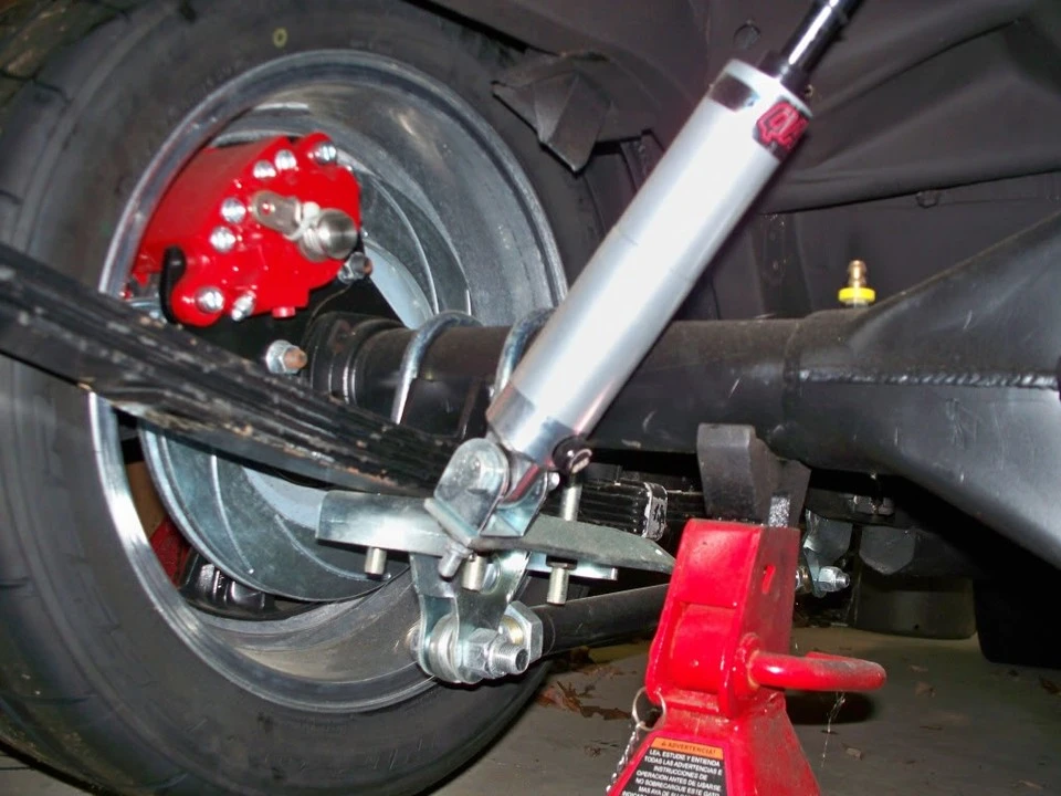

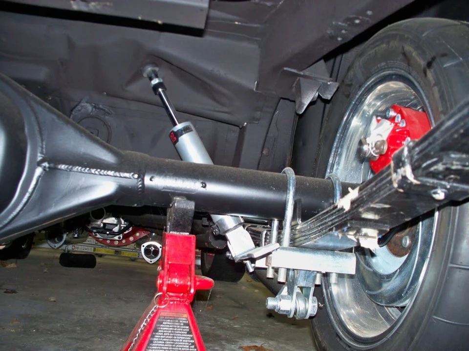

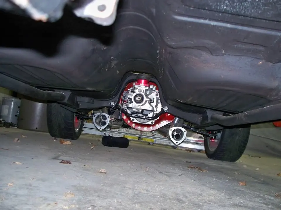

13 1/2" slotted rotors on all four corners. QA1 adjustable shocks and Comp Engineering slide-a-link traction bars. (By using these each has 2 mounts so you can retain your staggard shocks.)
Currie crate rearend narrowed 2" on both sides

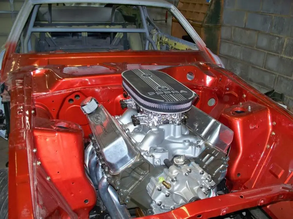

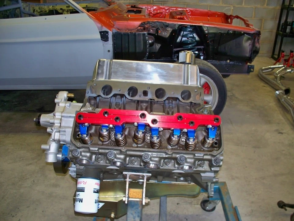

460 stroked to 521. All roller 429 cobra jet heads.

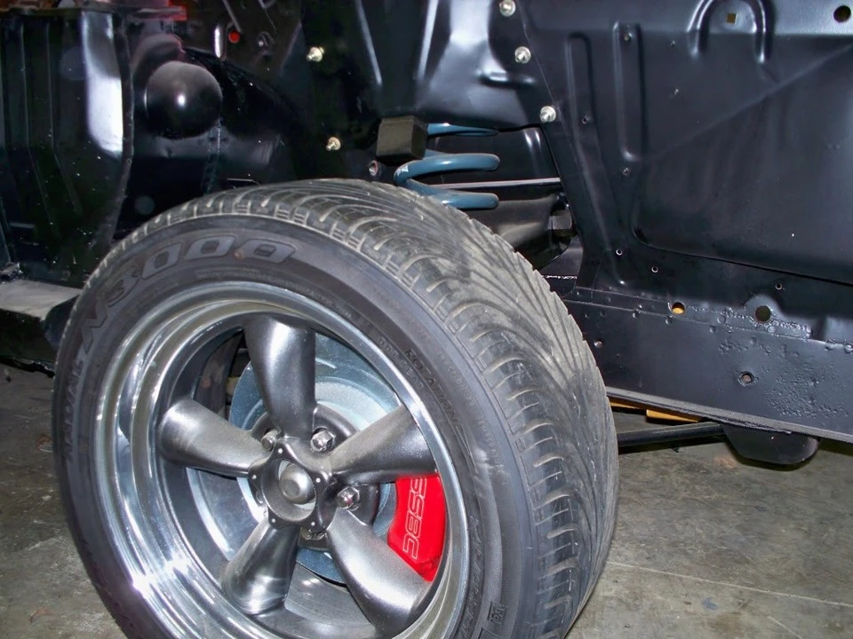

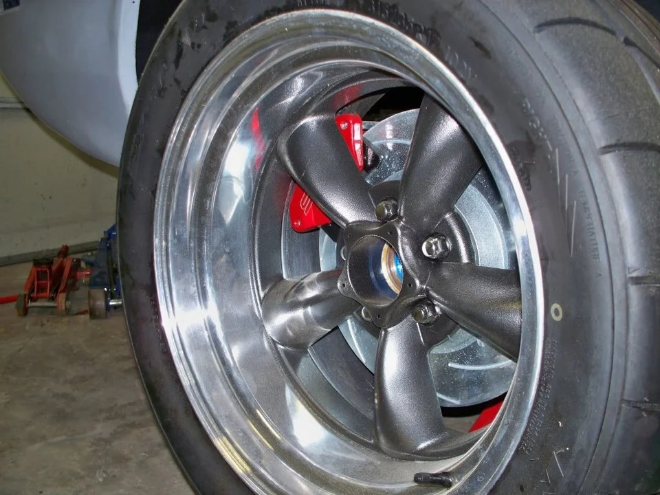

17x8 Vintage Wheel works, all grab a track front suspension 1" drop. Wheels have been powdered coated a dark gray in the middle.
17x9 1/2 Custom offset with a 315-35-17 when the vehicle sits on the ground the wheel tucks nicely in the wheel well. I am also running grab a track 1" drop leaf springs in the back.
Thank you, I probably would if I could find the trim. I’ve never seen one in person so Im not sure if it would look good? It’s so hard to find parts for these cars I usually pick up stuff here and there when I find it but I have never seen any full vinyl cars. I did score the trim off of a half vinyl top 73 fastback. It’s perfect but im not going to put it on.

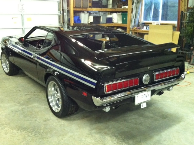

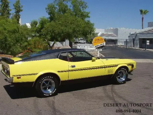

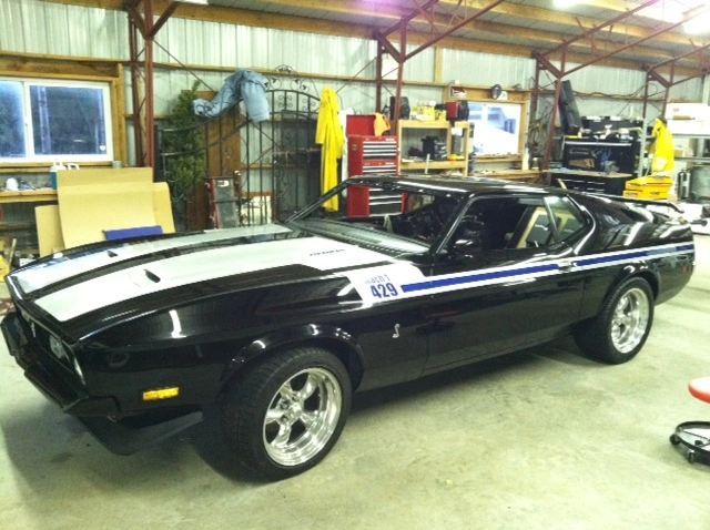

I'm new to the forum. I would like to say aloha to all and how nice it is to see the 71-73 models getting the attention they deserve. Nice rides. Mine is a 71 Mach 1 with a 351C stroked to 429, 5 speed tremec to name a few. Ive posted a couple pictures of mine. It's a work in progress nearing completion.
ptafiredawg
Hi Nice to meet you, love the car! The taillight swap looks great. Looks like you have a bit of a system going on there as well. I agree these cars don’t get the respect they deserve.
71 Mach 1
I was trying for something a bit different but not stray to far from the original. The only part of this model I wanted to change were the tail lights. I hope it wan't to much. As for the stripes my thought was for something that could have been from that error. I just wanted mine to look a bit different from the herd.
Now you know what one looks like with the Vinyl top. Thats pretty cool. You might not be able to find original moldings, but if you go to an unholstry shop that does a lot of Vinyl tops and Convertables, they might have a suitable universal molding. I know a guy with a 67' GTO who had a top put on and they had to improvise the moldings. It looks factory enough to pass the inspection of someone who isn't a concours judge. Its like an extruded aluminum strip that rivets to the body then has a black rubber inlay that covers up the rivets.
