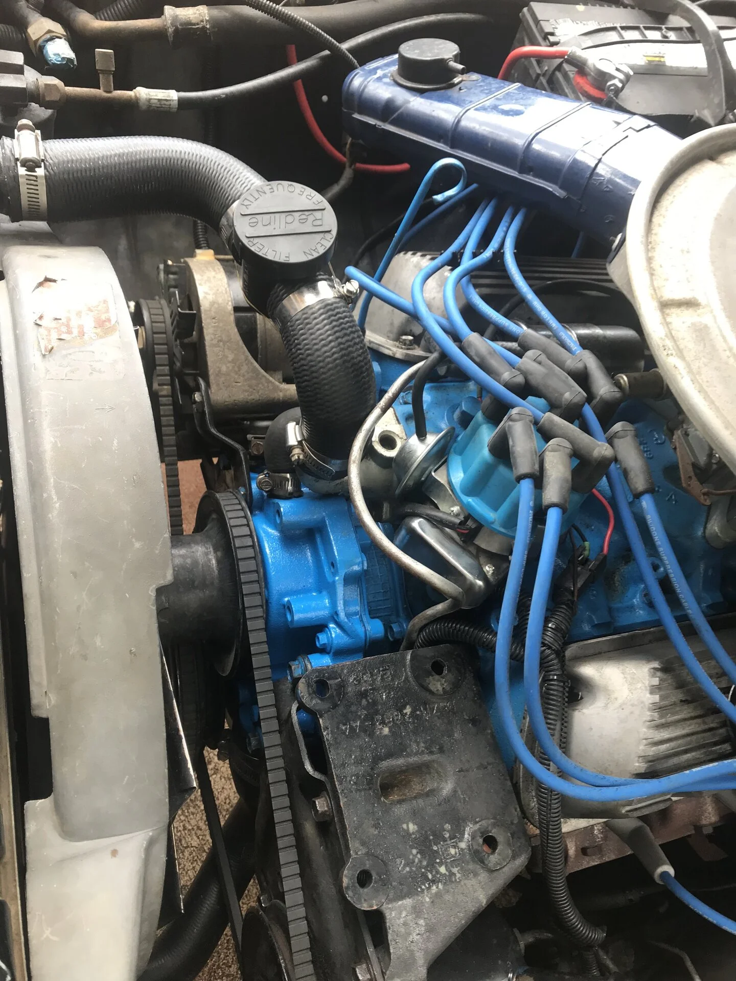

After determining the GM style HEI won't fit with the stock air cleaner. I got an small cap HEI, in blue.
130$ plus 15$ shipping so it was the right price for sure.

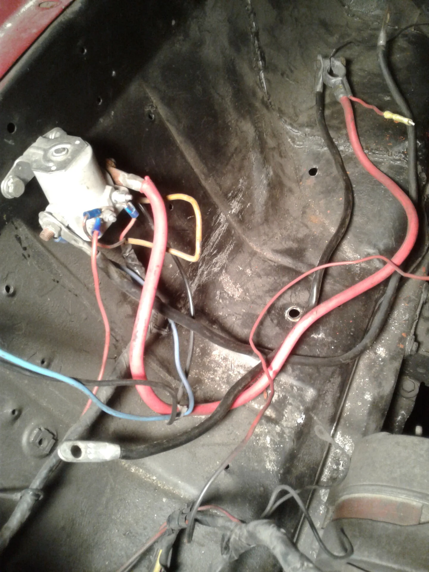

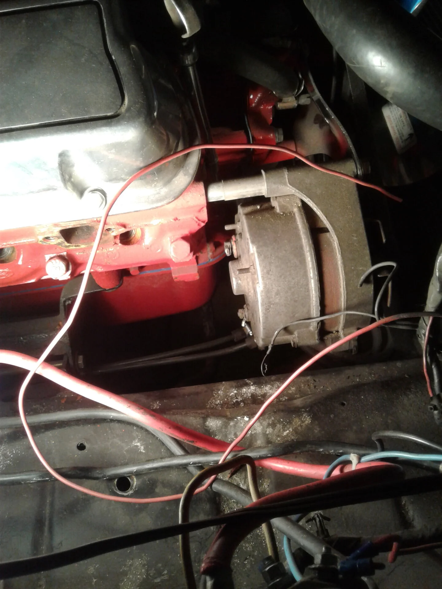

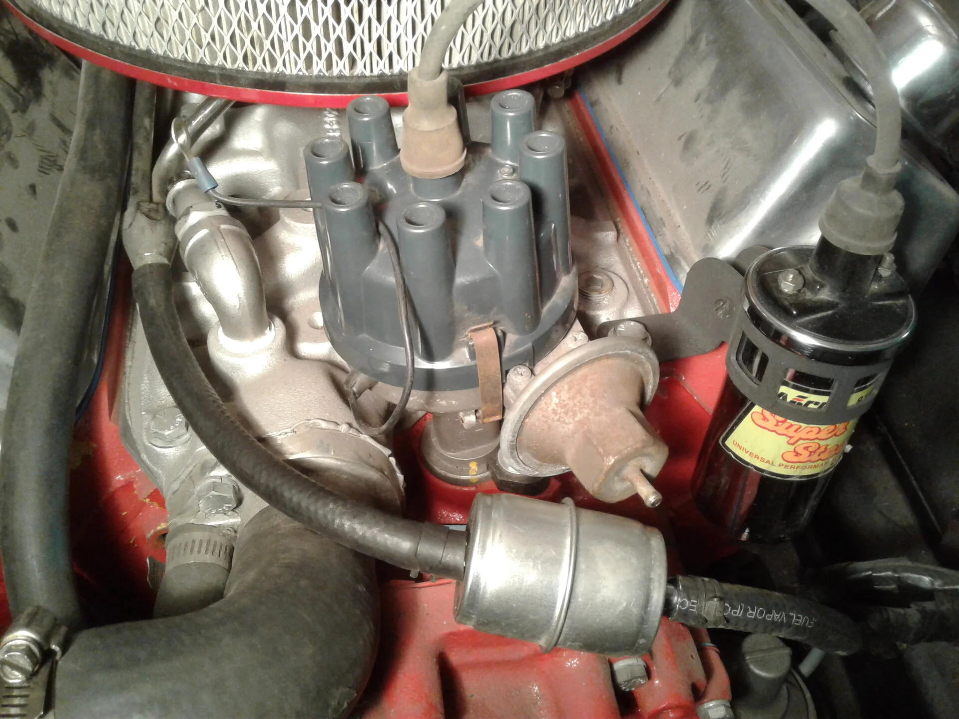

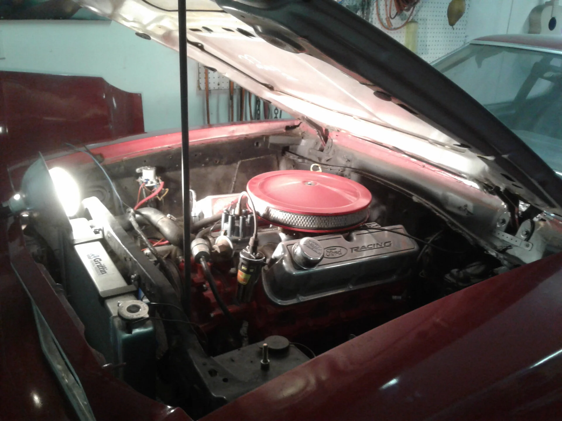

Thanks for the fast responses. Here's images of the car and some wiring, as requested. I think I will check into the pro-comp distributor first. Seems pretty sweet and the cap is red. 74stang, are you serious about the 350 chevy?

The distributor is just a copy of a Chevy HEI distributor made to fit a Ford. Just run 1975+ Ford 302 plug wires, the correct spark plugs for your engine, and should you need to replace the tune-up parts on that pro-comp distributor, tell the parts guy at the counter it's for a 1975 Chevy C10 with a 350.
Like I said though, @extra_stout isn't wrong in his opinion that you should upgrade your existing distributor. Now that I see that you already have an upgraded coil, and have all that air cleaner clearance (sometimes an issue with an HEI style distributor, but not often) it's something to consider.
