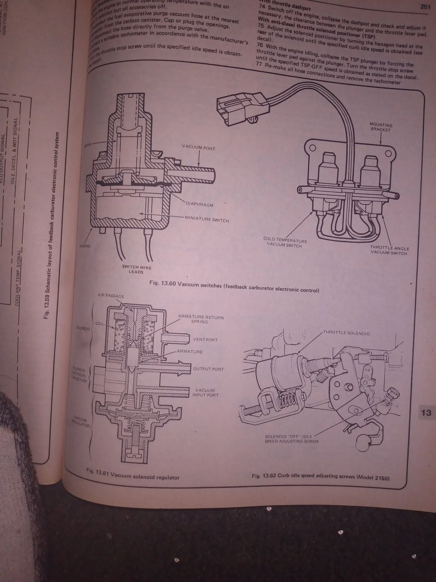

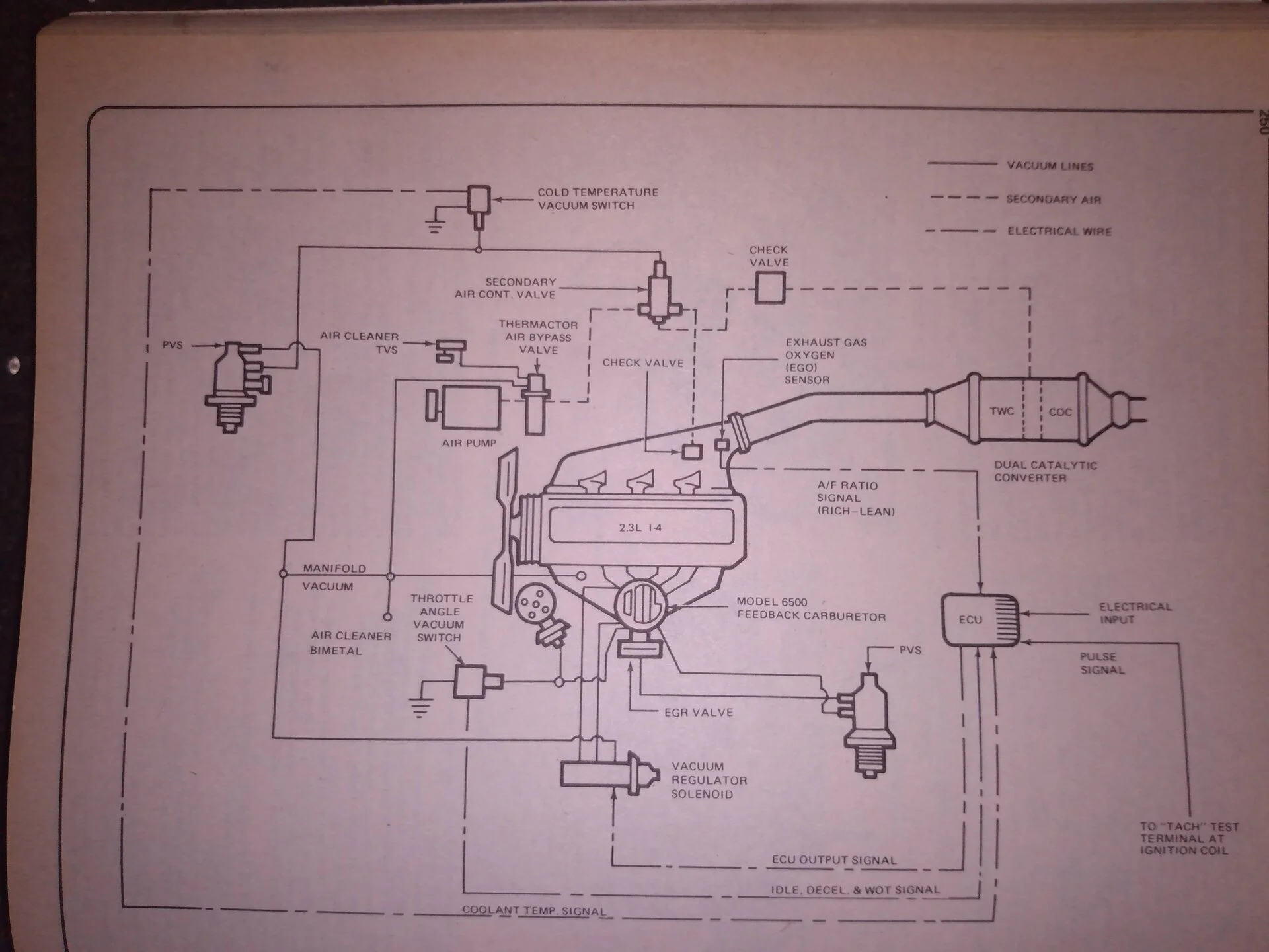

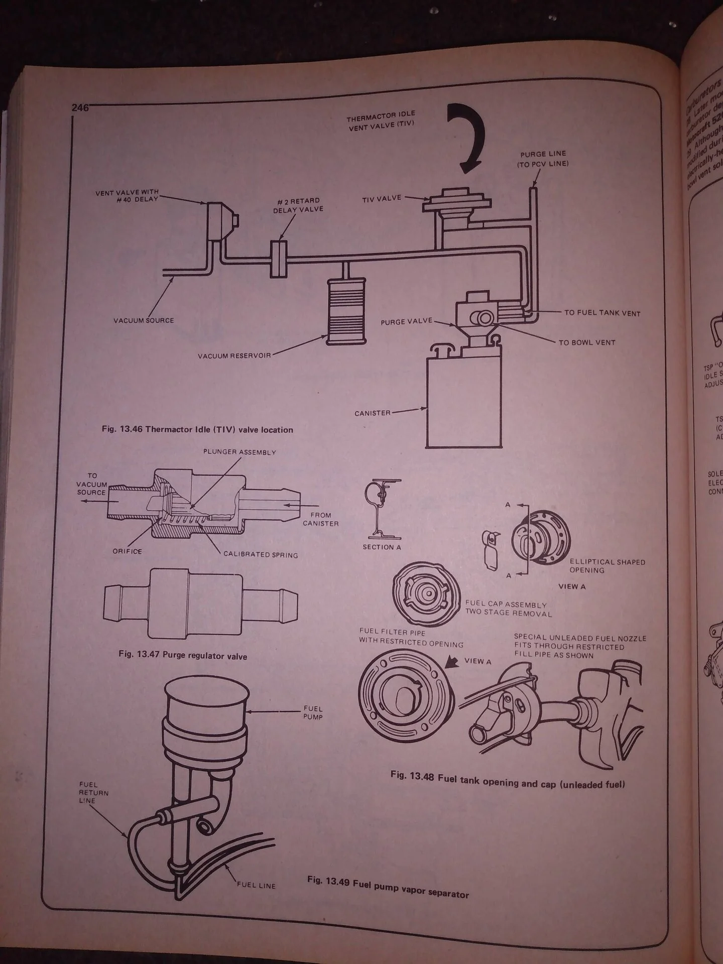

I IICrew Mustang Master Mar 29, 2020 488 631 113 USA May 11, 2020 #5 May 11, 2020 #5 Here is was the haynes manual has. Reactions: 2Blue2
Mystang66 Member Jul 23, 2011 76 16 19 Minneapolis, MN May 14, 2020 #6 May 14, 2020 #6 IICrew said: Here is was the haynes manual has. Click to expand... Thank you!
