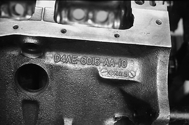

As far as I know, the best you can do is the date code from the casting numbers and compare them with the date your car was assembled. The casting numbers on the block are located above the starter as looking from under the car. This is a random internet pic for reference:

hey guys so I found a stamp that tells m it isnt the stock engine. the first 4 digits of the casting is D1OE. If im correct that means it is a 1971 302 out of a Fairlane or Torino. Kinda bummed that it isnt stock but also kinda happy that it is a pre-emissions motor. i found the stamp on the passenger side of the car right below cyl 3 and 4 near the oil pan

Ford has been stamping a VIN on the engine and transmission for decades. The VIN on the 302 engine block from a vehicle assembled at DAP is on a flat pad behind the lifter valley.
Engineering numbers on parts don't change every year and they are not different for every model. Those numbers are what the part was originally engineered for, but the part is used on as many different model lines and for as many years as is possible, without a major redesign which would neccesitate an engineering number change. A D1OE block could have very well been used OEM in 1977.
