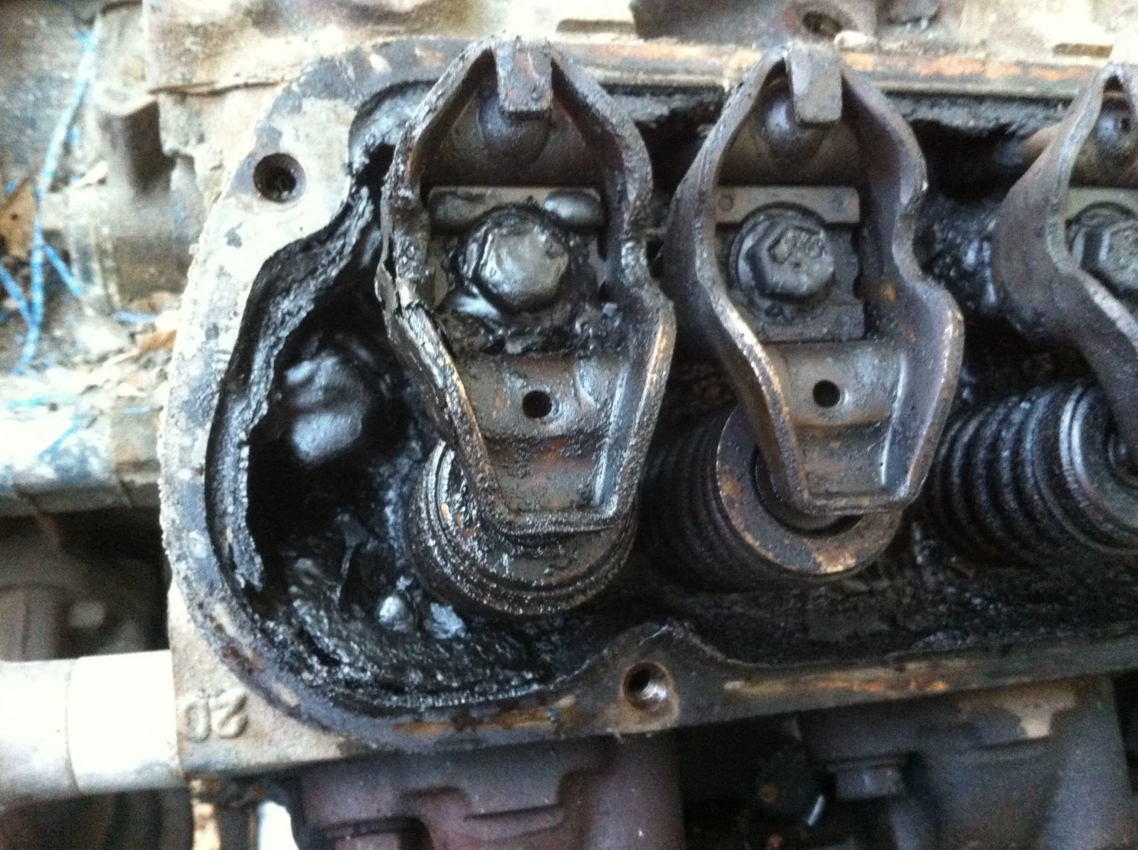

I tried the tranny fluid and thinner mix trick but after a week it still didn't budge so I decided to tear the 302 down. As soon as I pulled the valve covers I found the worst sludge build up I have ever encountered. Stripped down to the short block, I unbolted the rods and knocked out the pistons with not too much issue; hopefully the rust rings can be bored out. When I dropped the parts off at the machine shop they considered charging me an extra cleaning fee. I guess I can't blame them.

Well it was worth the try, but the outcome is as I suspected. I think in the long run you will be happy you did it right(in my opinion of course).

Yeah, I thought how good the engine looked externally, i.e. no modifications, and all the smog equipment still intact, that the engine internally would be sound and could be revived. At least limp by for now while I worked on other parts of the KC, but that wasn't the case. Now I have to start a new thread on building a souped up 302.
