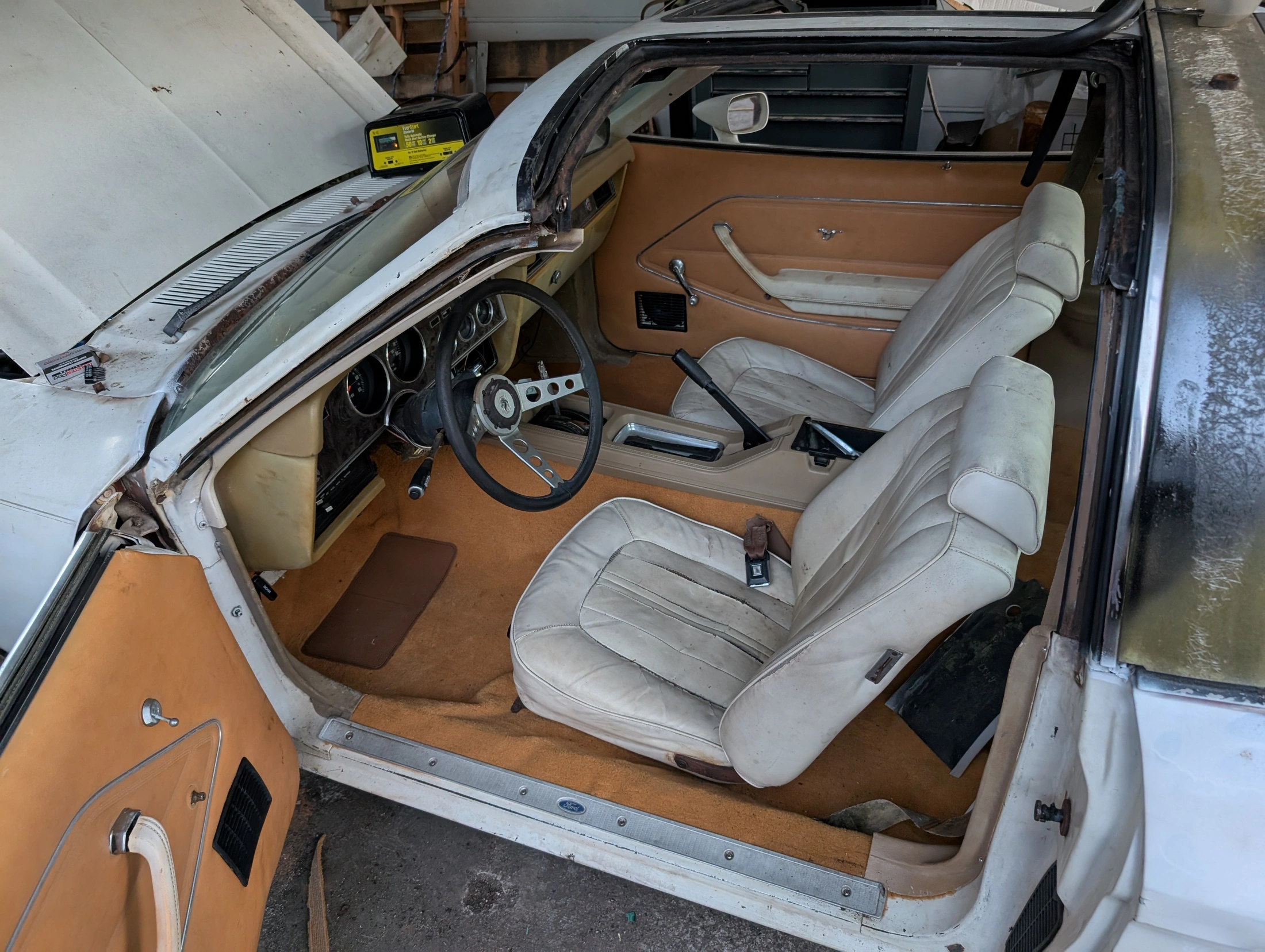

I decided to change tack (no pun intended) and finished up welding and seam sealing the floor pans. No more rust holes!
Floors are painted and sound deadener is going in today. Carpet kit for the passenger compartment is unfolded and waiting, gotta get with CAR and see what they want me to do with the second passenger carpet they sent me when I ordered the trunk area carpet.
Beyond that, I did weld up a "for now" exhaust. Cheapo ebay muffler welded to the flange where the cat used to live and then dumped out right before the passenger wheel.
So... She's got an interior now. Everything works in the dash besides the ammeter and tach. Oddly, the lights for my HVAC work, but nothing when I move levers and switches. That's a problem for future me.
The current question is why is there a huge gap between my door panel and my window cranks?
Reactions: MXGerry and LILCBRA
How big are the gaps you're referring to? I know that there was a plastic "washer" between the handle and the door panel to help alleviate the issue with the crank wearing into the vinyl.... that may have covered a small-ish gap. :shrug:
