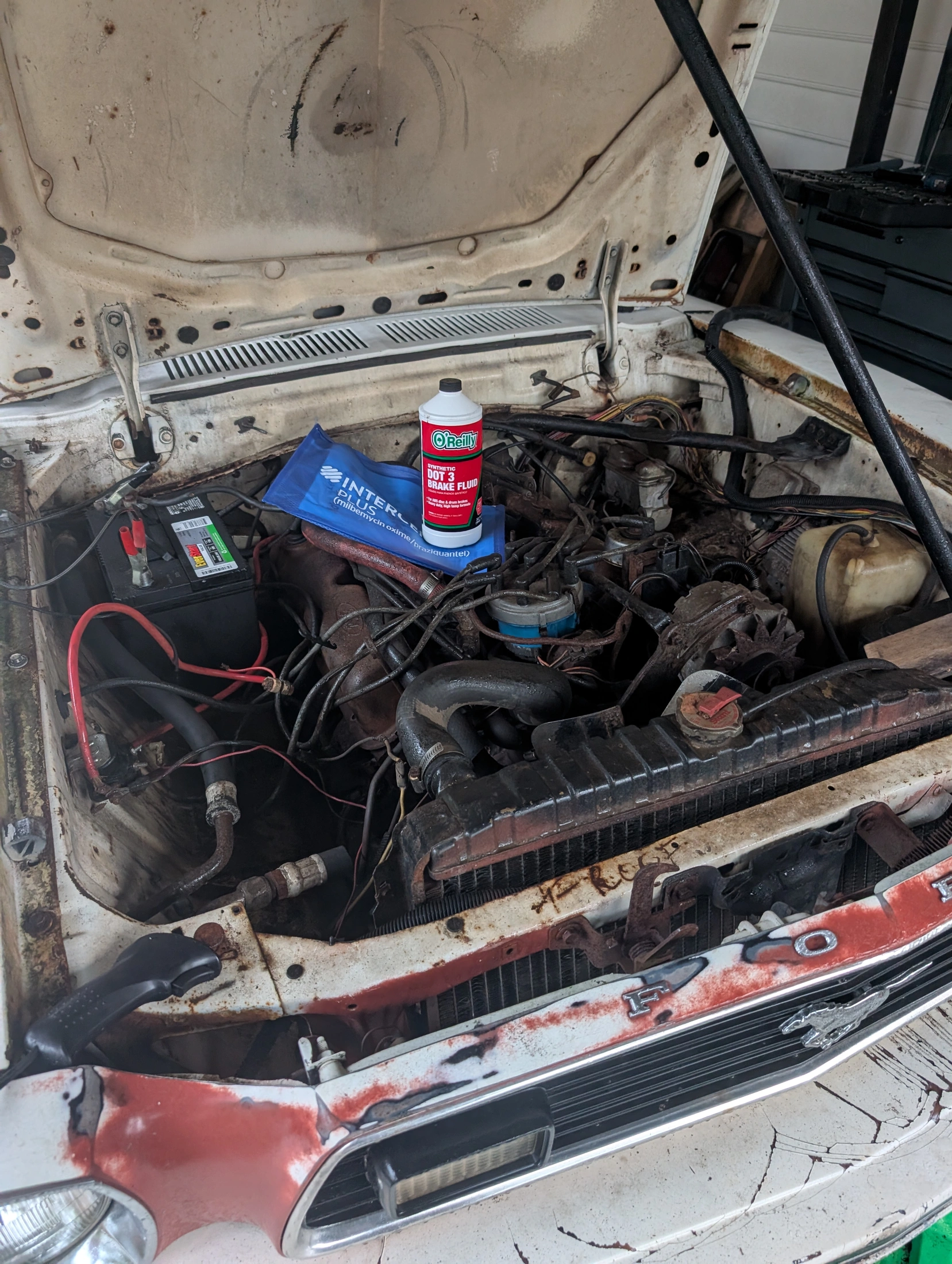

So, got the white one to the house yesterday. Motor is free, plugs were blacker than midnight inside a cow, and the carb looks like it came off something on the titanic. I have an amazon 2100 that might be a better idea to get her at least firing til I do a rebuild on the 2150. Currently about to dive into the abyss that is wiring on this thing. Wish me luck.

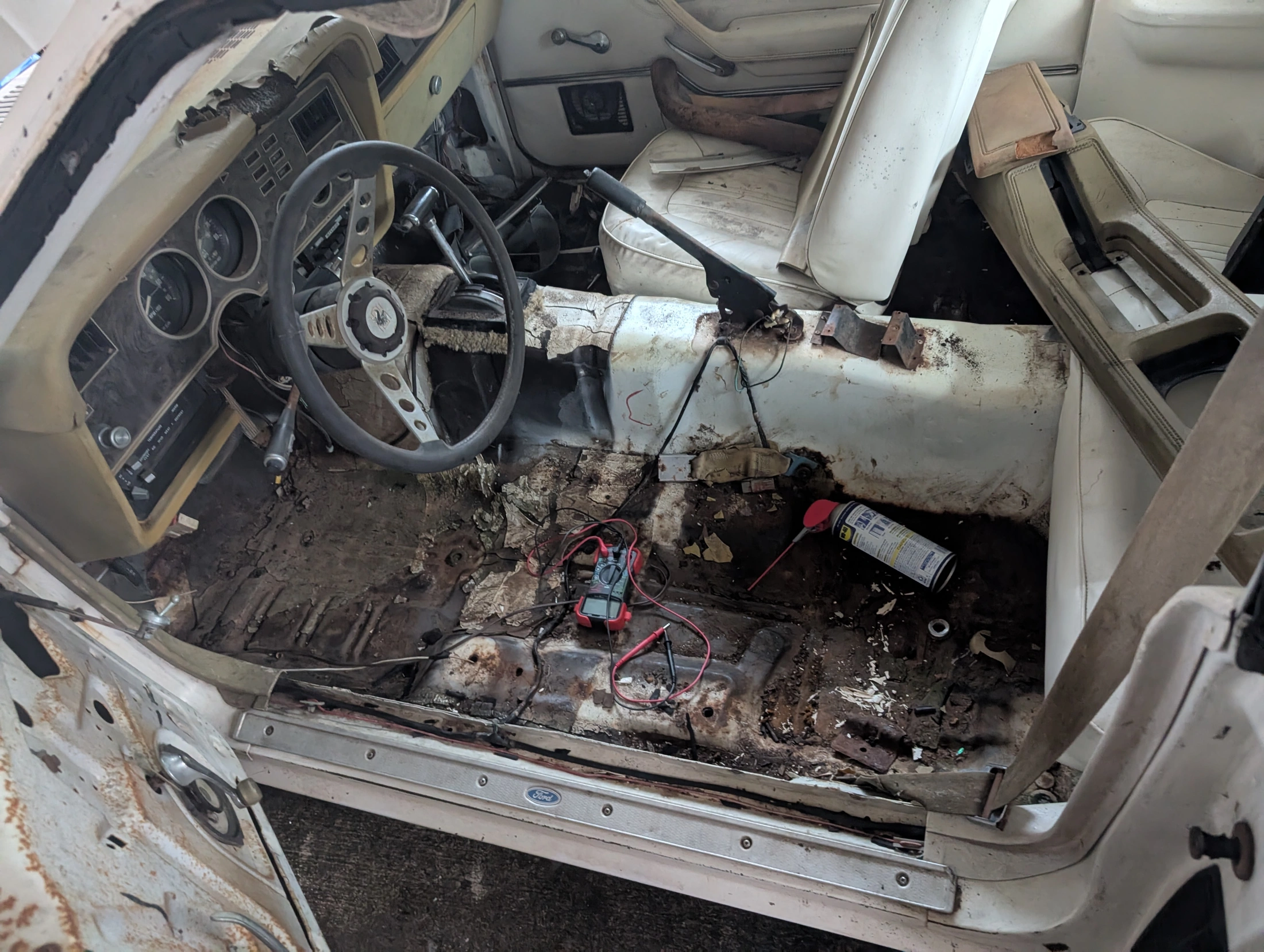

Current state of affairs is that I get absolutely nothing when I try and jump the solenoid, so I'm hoping its just a bad connection on the starter. I've verified 13V on both sides of the solenoid when it's jumped and that the battery to block ground is good.

Absolute facts @2Blue2! I'm thinking I've got a blown fuseable link somewhere. The question is do I replace the link or put an inline fuse? I'm leaning towards a more modern fuse. Also thinking about eventually replacing the old school fuse box with one that uses the blade fuses at some point. I'm headed to FL to see family, but will be back friday. Then I'll jump in with ye old Multi-meter and a fist full of inline fuse holders of the appropriate size.
Reactions: 2Blue2
Given the location of the fuse box, it sounds like it would end up being an almost complete rewire to swap out to a blade style fuse box. I mean if you're going to go so far as to do that I'd suggest installing it underhood instead of under the dash to simplify changing fuses if the need arises. The stock location is less than desirable - to put it lightly....
And I agree with the fusible link thought. I'd definitely consider using an inline fuse instead. Or you could use an automotive breaker.

So, the original starter did wind up being on its last legs and died. I swapped it out, replaced the ground cable, and she runs! So now I have to fix the fuel system, dial in the carb and timing. Then its on to brakes!
