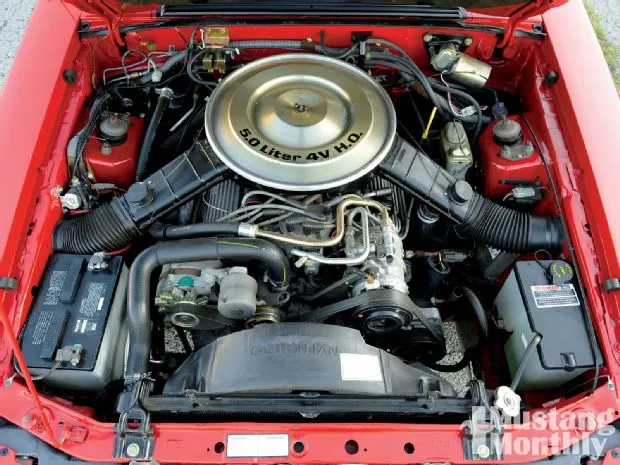

Car is factory. Sorry I don't know what cfi is. It looks like this but no a/c .
If it's a 5-spd it's a carb. If it's automatic, it's CFI. Really need to know what we dealing with first. Pictures help

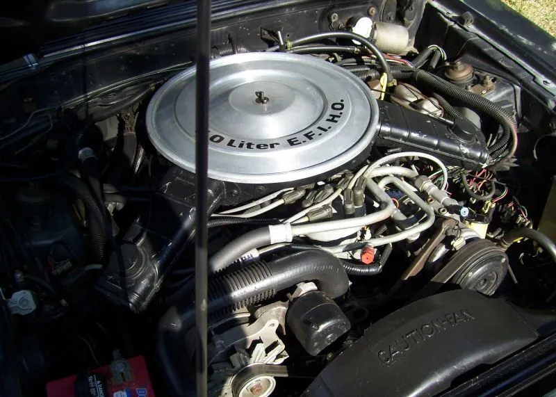

CFI will say EFI on the valve cleaner. Carb will say 4V like the pic above
Looked at it today. It says EFI like the above pic. it is an automatic.
Owner informed me the catalytic converter was removed years ago. It also has had 2 brains swapped out trying to fix the issue.
So it's CFI.
Which means it's eec-4 and you can pull codes. Locate the test plug which might be on the drivers rear of the engine bay near the wiper motor.
