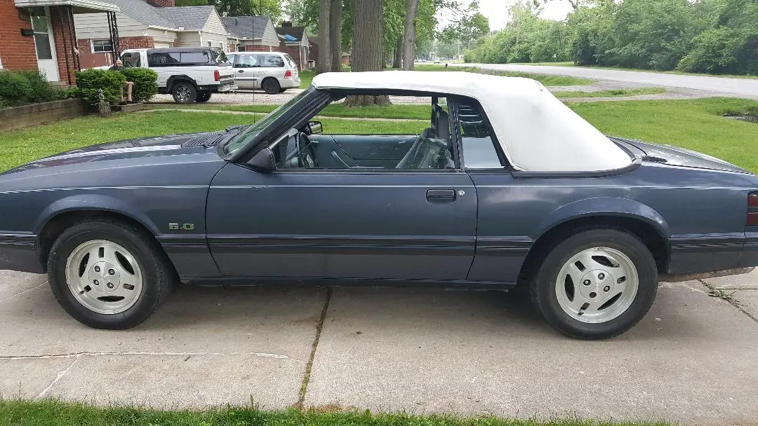

Jonathan, here is a pic bought it out of indiana 2 yrs ago 135,000 miles well kept. small surface rust on deck lid and 2 spot in the floor pan area about the size of 1/2 dollar.

I like that car man !!! My car also came from Indiana. One of my favorite cars was an 84 i owned a few years ago.
Nice whip. Two questions -
1) are the wheels original or did u get the standard sized ones from LMR or where did u fine the metric sizes tires? Coker?
2) how did you end up hanging the muffler on the passener side? What hangers did you go with? Go pics? This is my current headache.
Thx
The wheels were already on the car when I bought it. It does need new rubber they are showing signs of dry rot. And for the exhaust I bought the exhaust hanger and clamp kit from american musle worked out well with a couple of modification to the hangers had to bend and twick a little. I had to relacate the fuel pump to get it up nice and tight on passenger side and worked out great. I will post some pics when I get it back up in the air.
If those are original TRXs, you’ll save money by buying the set on LMRs site.
I mean the wheels and tires from LMR, those stupid tires for the originals are stupid expensive......STUPID EXPENSIVE!
I do like the look of them though.
