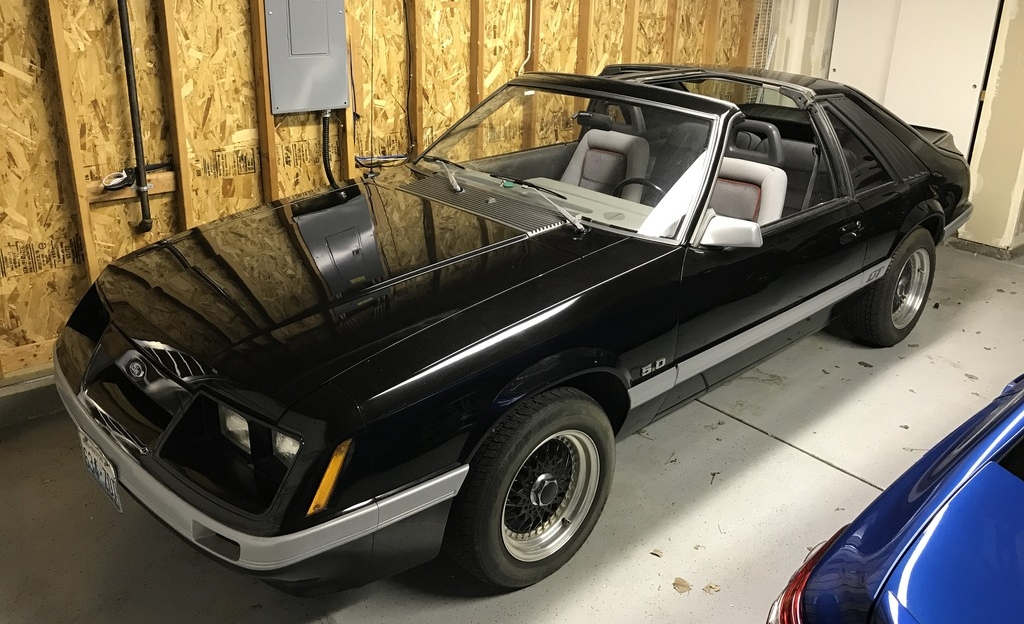

So thanks to @FoxMustangLvr ( not sure if its tanks or damn you! ) I was FORCED to buy this 85 GT T top car. The car is clean, very stock and has been repainted.

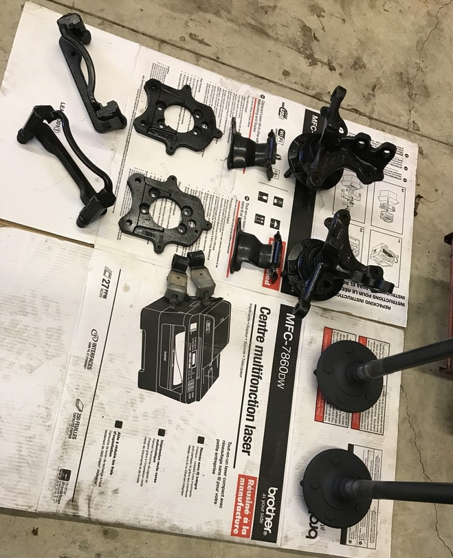

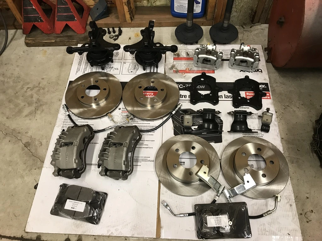

5 lug upgrades are a must for any Fox I own.

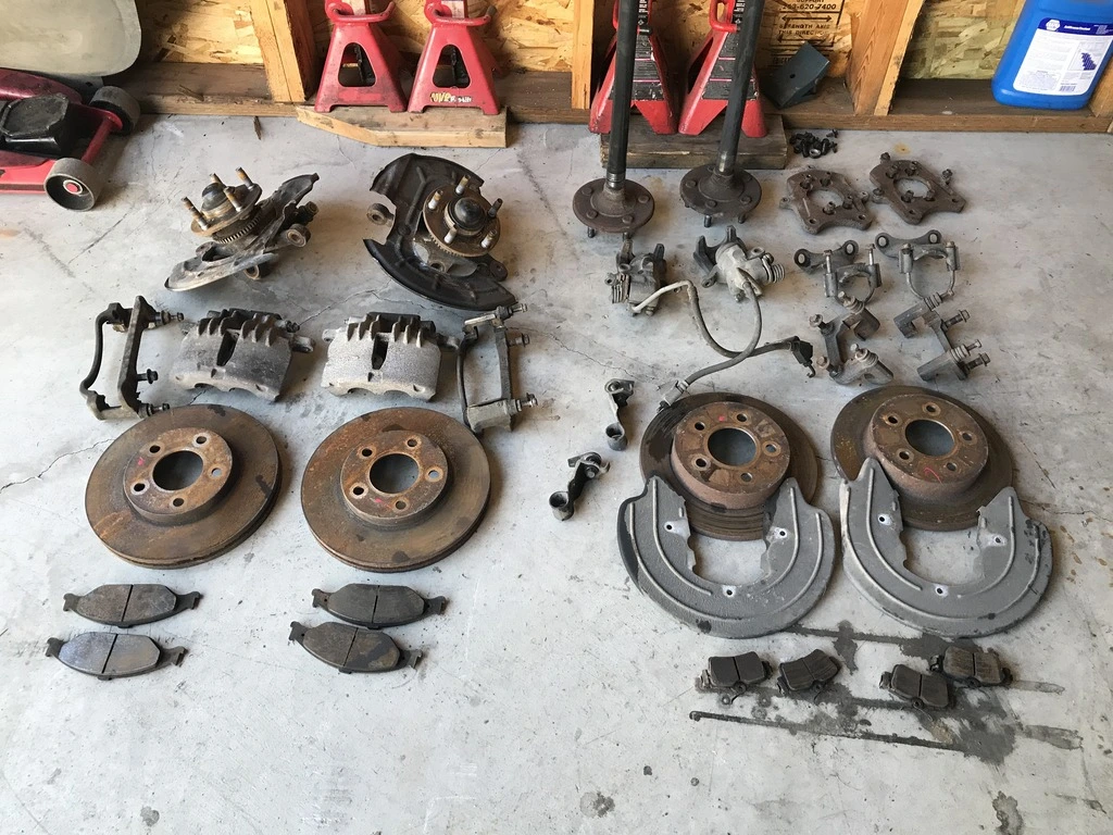

Junkyard score
Slightly less junky

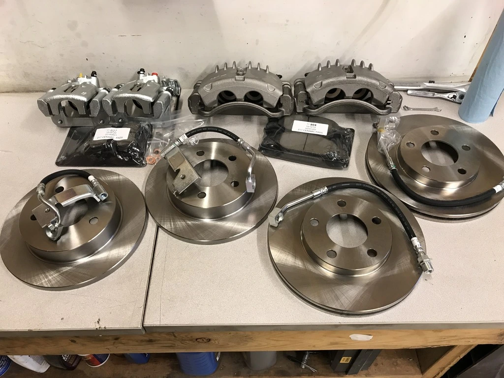

Junkyard parts can be a gamble and well I kind of lost on the calipers, I had a fused rear caliper pin, torn boots which led to scored pistons. So looking into options from rebuilding the calipers, to replacing them I found what I think is a deal at rockauto . For slightly more than just buying reman'd calipers I got a full kit with calipers, pads and rotors. http://www.rockauto.com/en/moreinfo.php?pk=7484584&cc=1354744&jsn=11
Shipping sucked at $57 bucks but after returning cores I should be under $375 for it.
Prior to really inspecting the junkyard parts during cleaning and such I decided I would spend some money on the suspension, since I was gonna be in there ....

In case anyone wants to see more
http://s631.photobucket.com/user/groverd/library/1985 GT T-Top?sort=3&page=1
Junkyard score
Slightly less junky
