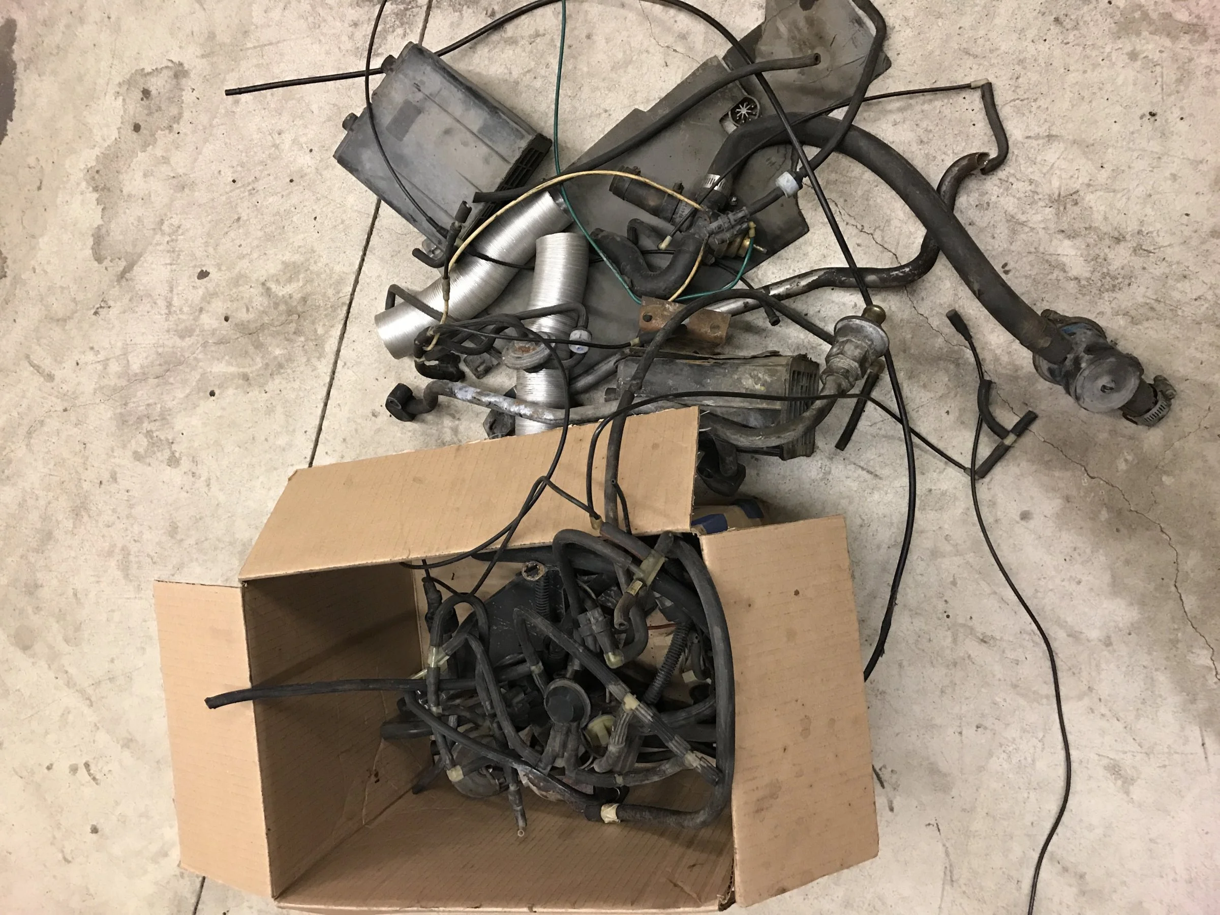

so many broken and unhooked vacuum lines led me to this.
Smog delete.
Smog delete.
Looks like weight reduction to me. Racecar.

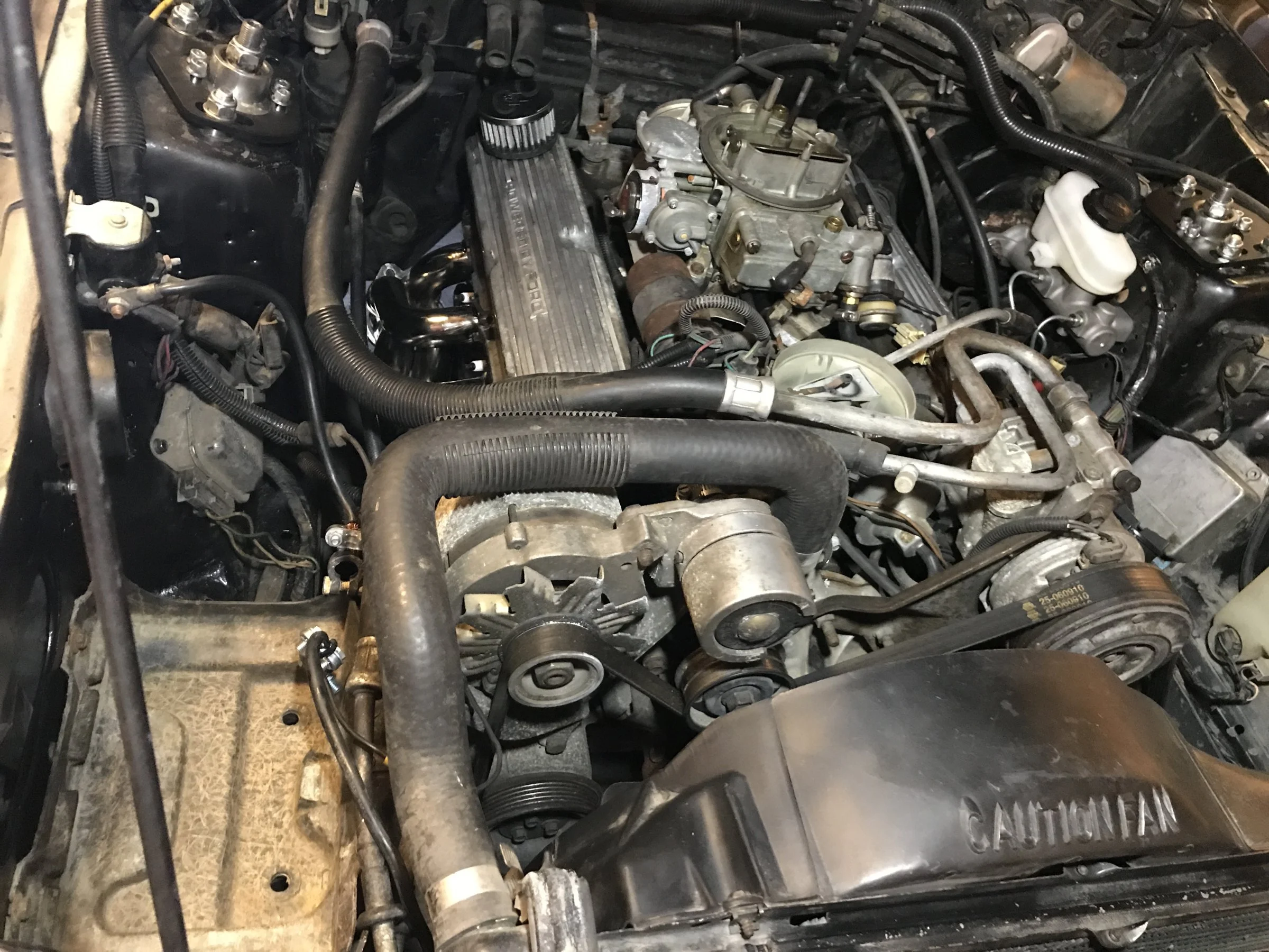

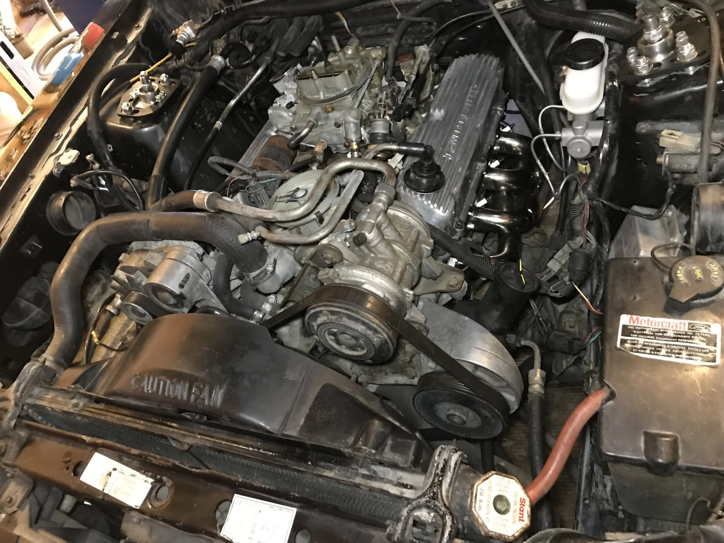

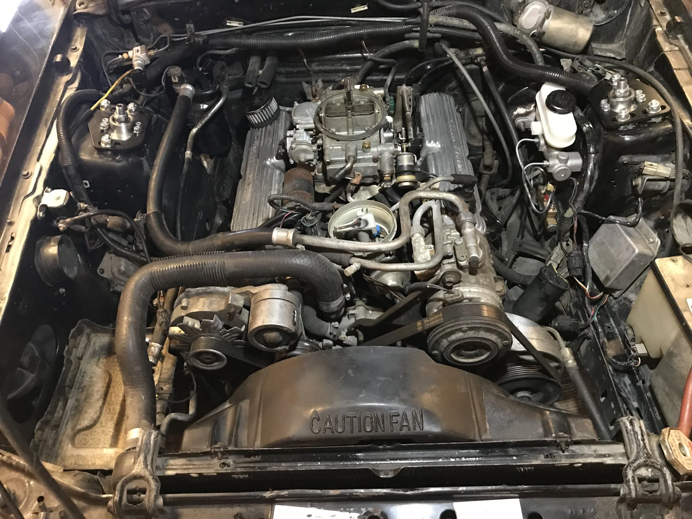

I am struggling with the underhood, it is a mess. The pictures make it look better than it is.
Got the BBK headers mocked up and and looks like no steering shaft interference so that is good. I found some surface rust under the battery box, no surprise there so I did a quick wire wheel and rust reformer.
Who can tell me what the semi shiny metal boxes on each side?

The box on the driver side should be the ignition control module (duraspark), the one on the passenger side should be the voltage regulator.
Reactions: stangboy, Davedacarpainter and General karthief

Thanks! that confirms what I found online.

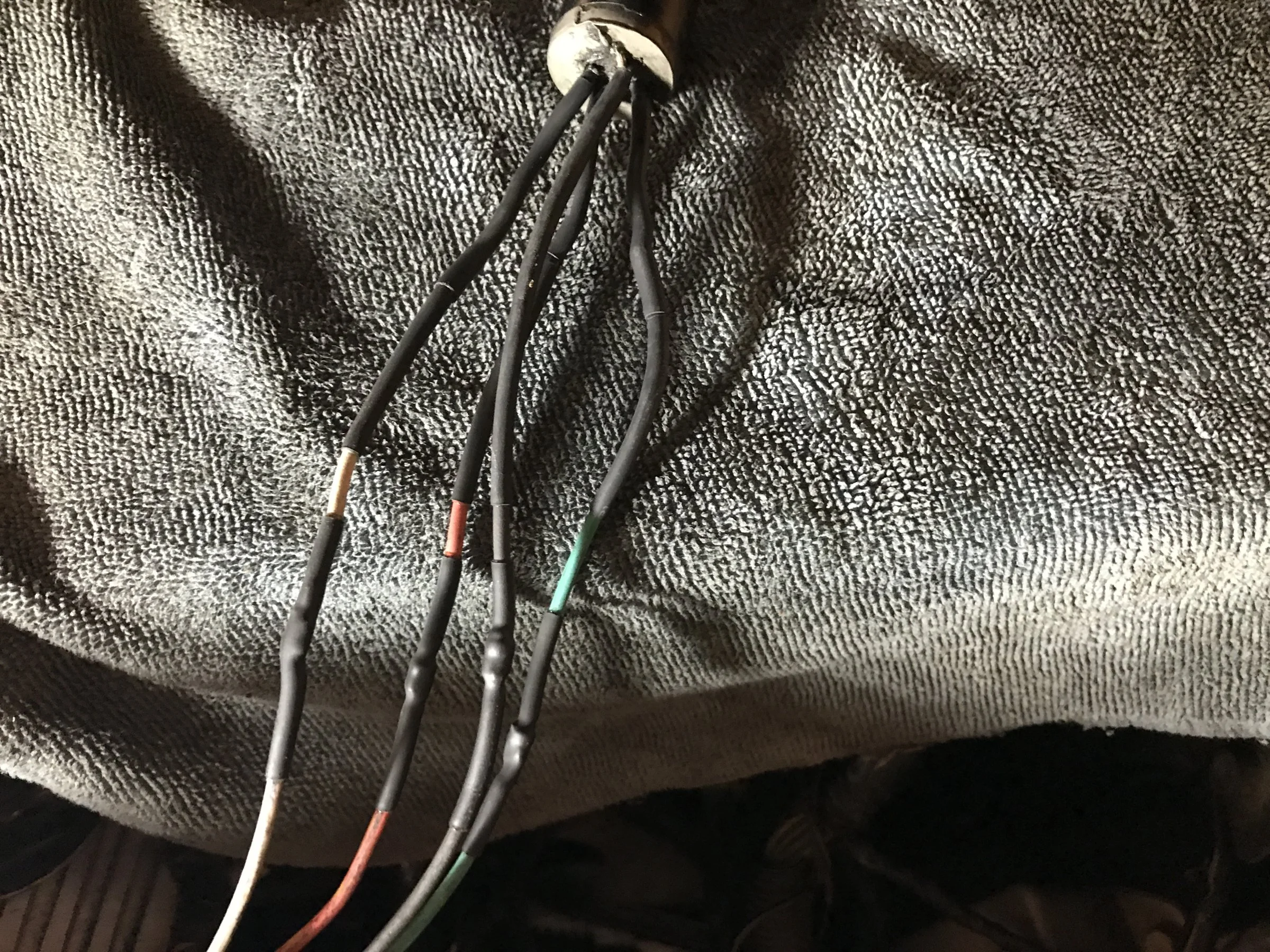

brittle wiring fix, ugh. I cut off this plug shrink wrapped each wire then covered with a loom.
The wiring is all there still it is just the casing of the wires are so brittle they crumble when you touch them
