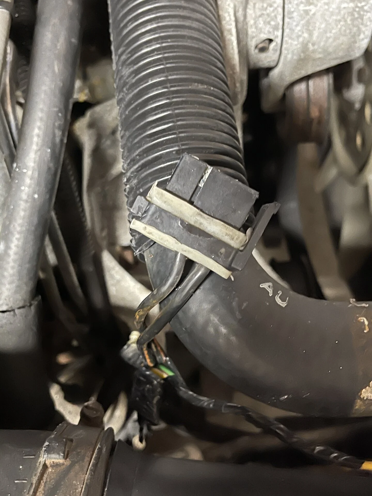

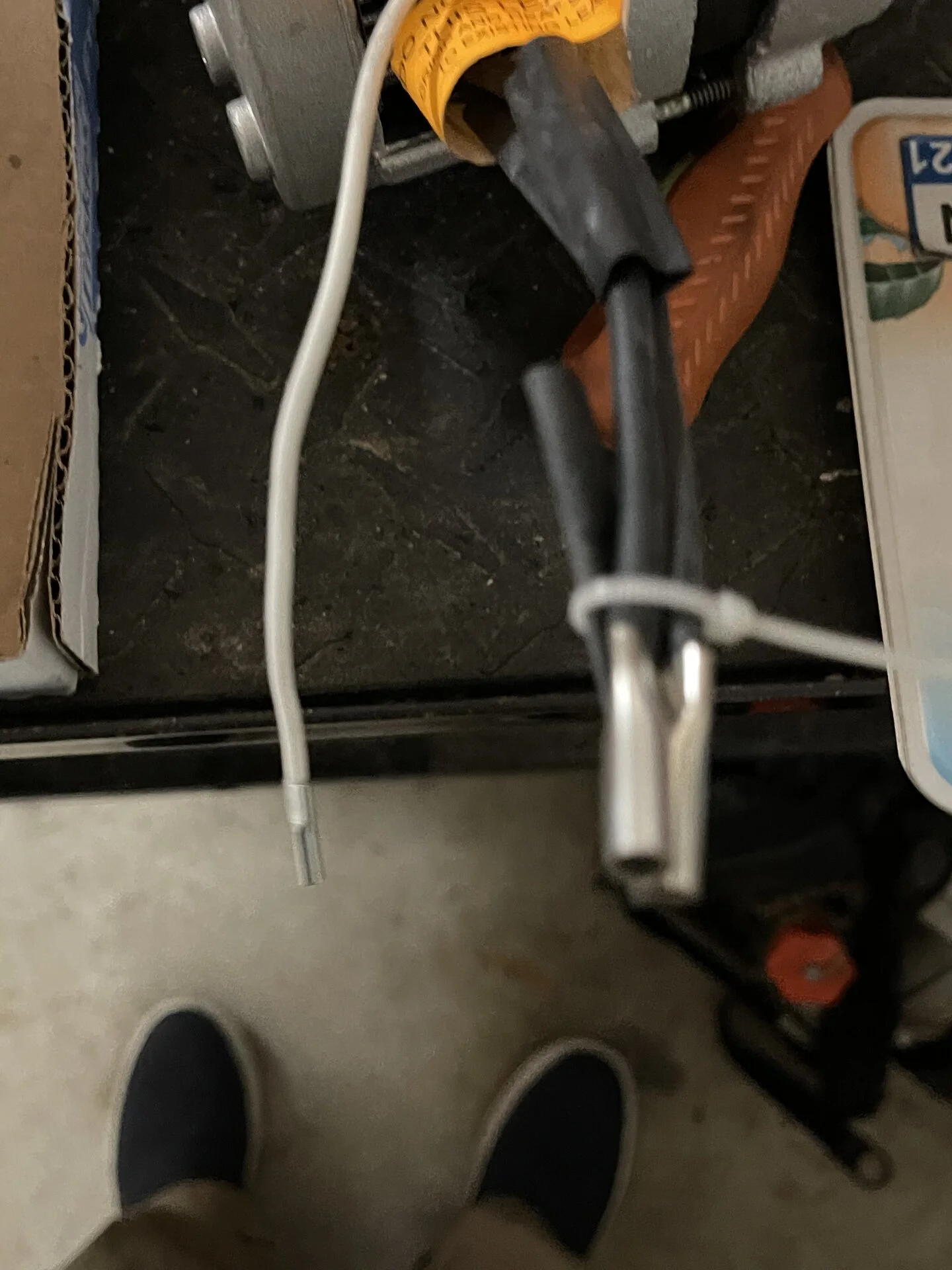

B Bsold1 New Member Feb 7, 2021 1 0 1 Ga Feb 7, 2021 #1 Feb 7, 2021 #1 Old plug has 2 wires ,new alternator has built in plug with extra white wire.Where do that white wire go or can I just leave it ? Attachments A5FDDA03-E5A2-4068-B7F7-41F8A41D591B.webp 218.8 KB · Views: 215 9208EAE6-98B4-4A83-AD9A-1E2515FA893B.webp 166 KB · Views: 220
mikestang63 SN Certified Technician Aug 27, 2012 11,606 8,859 214 In the garage Feb 8, 2021 #2 Feb 8, 2021 #2 here you go,, PA Performance Mustang 2G to 3G Conversion Wire (1986) 5.0 462802A Trying to upgrade to a 3G alternator? This harness converts your 2G wiring to accept a 3G alternator and makes it a plug in application! lmr.com Reactions: General karthief
