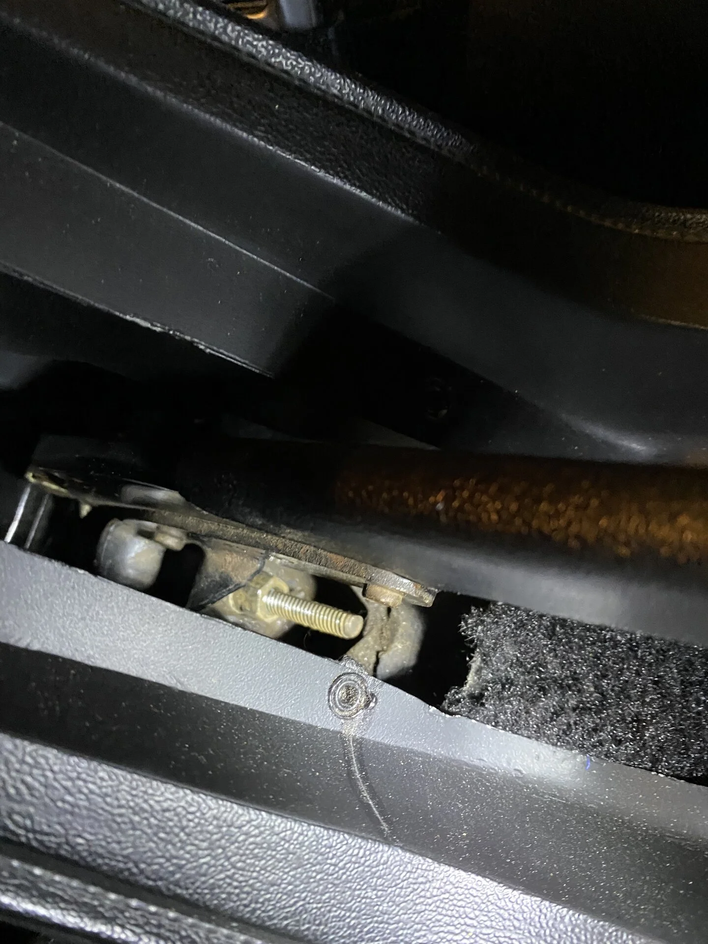

I recently went to 5 lug and switched to rear discs on my ‘86 (resgular ‘95 up rear calipers). I bought the cables from LMR that are made for this swap and they went on fine and seemed to fit good.
But even with the adjustment tightened all the way up, it will not hold my car on my driveway.
I see it pulling the spring and tightening the pads, bud obviously not enough.
I even tightened the adjustment nut so much it was beginning to hinder the handle from coming up, so had to back it off a tad..... which actually gave me more pad movement, but still not enough.
Short of adding a ferrel or spacer to shorten the cable, I’m stumped. Any suggestions?

This threaded rod is attached to a hook that goes into a bracket that the two cables attach to. As you tighten the nut, it tightens both cables. Can’t really get a pic under the car right now.

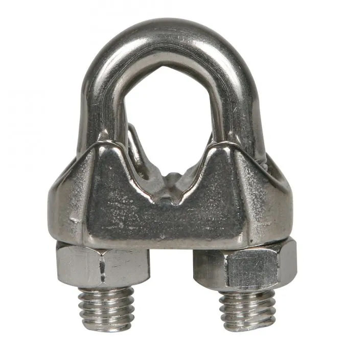

I had that issue when I did mine, I should have got the threaded ,adjustable cable but instead I used a cable clamp to shorten it up and it has worked fine for over two years.
Hope you get it to work.
