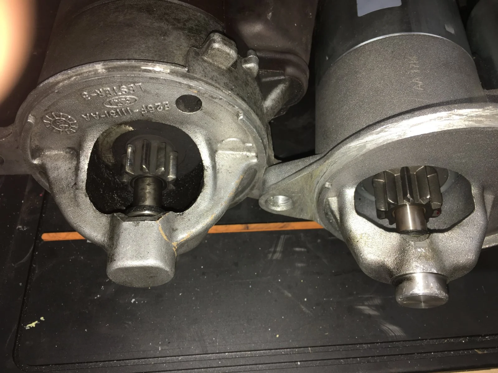

Update: I pulled the starter out and the diameter of this starter gear is about 1/8” bigger than the original. I think they sent me the wrong starter. Hopefully you can see from the picture. Before I go replace it again, just wanted to get some input.
Thanks guys!
New AC Delco high torque starter.... fit like a glove, starts up every time!!
Best part is, I got return authorization from Amazon on the old one!!
