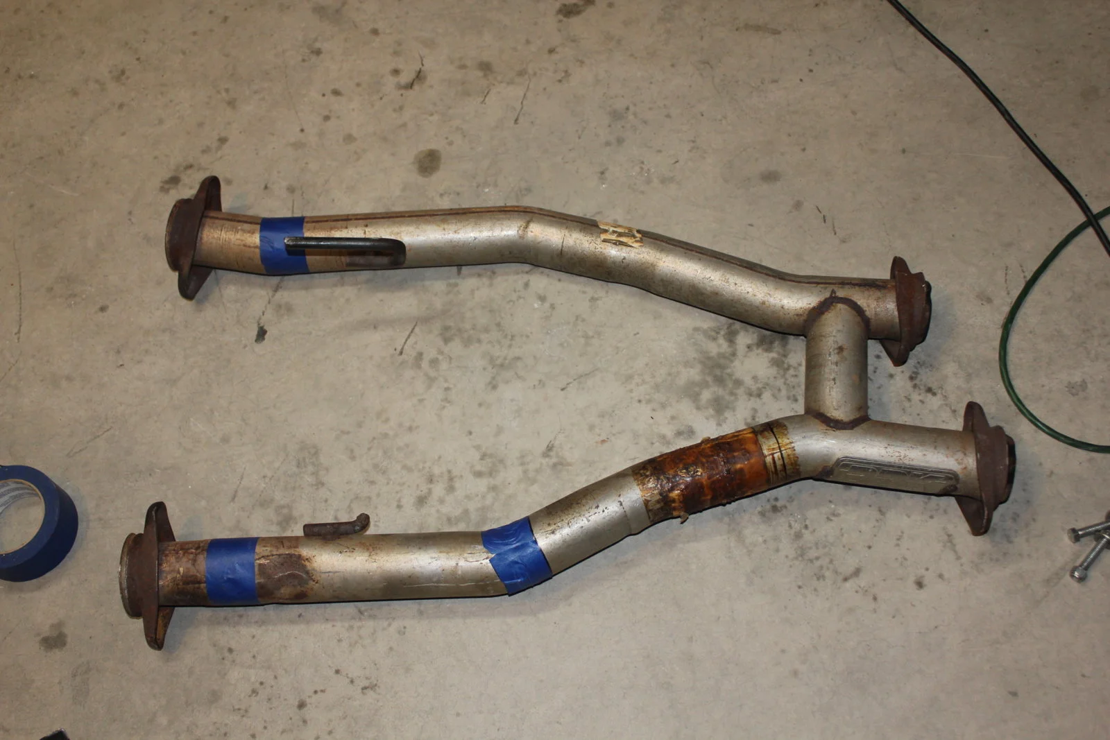

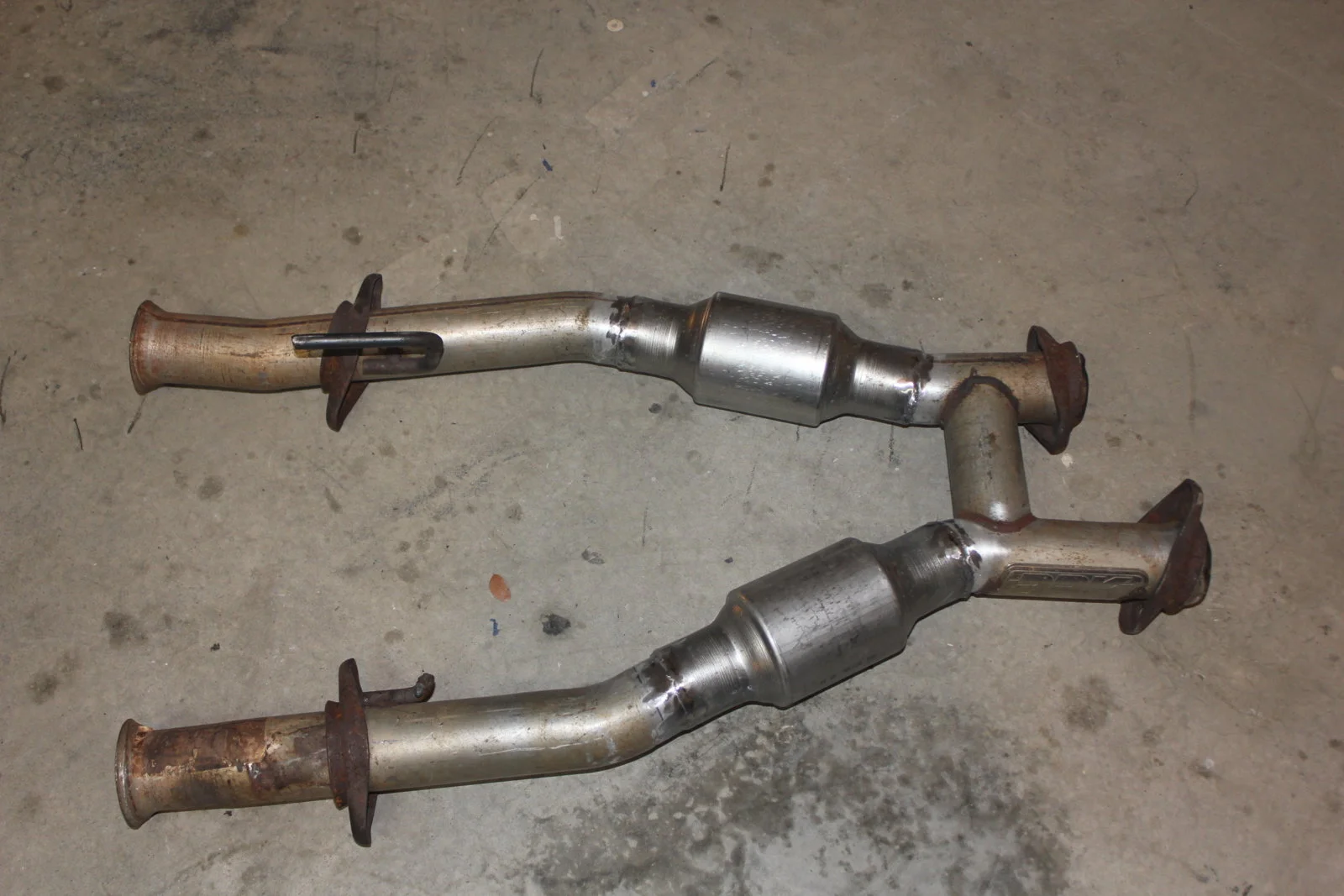

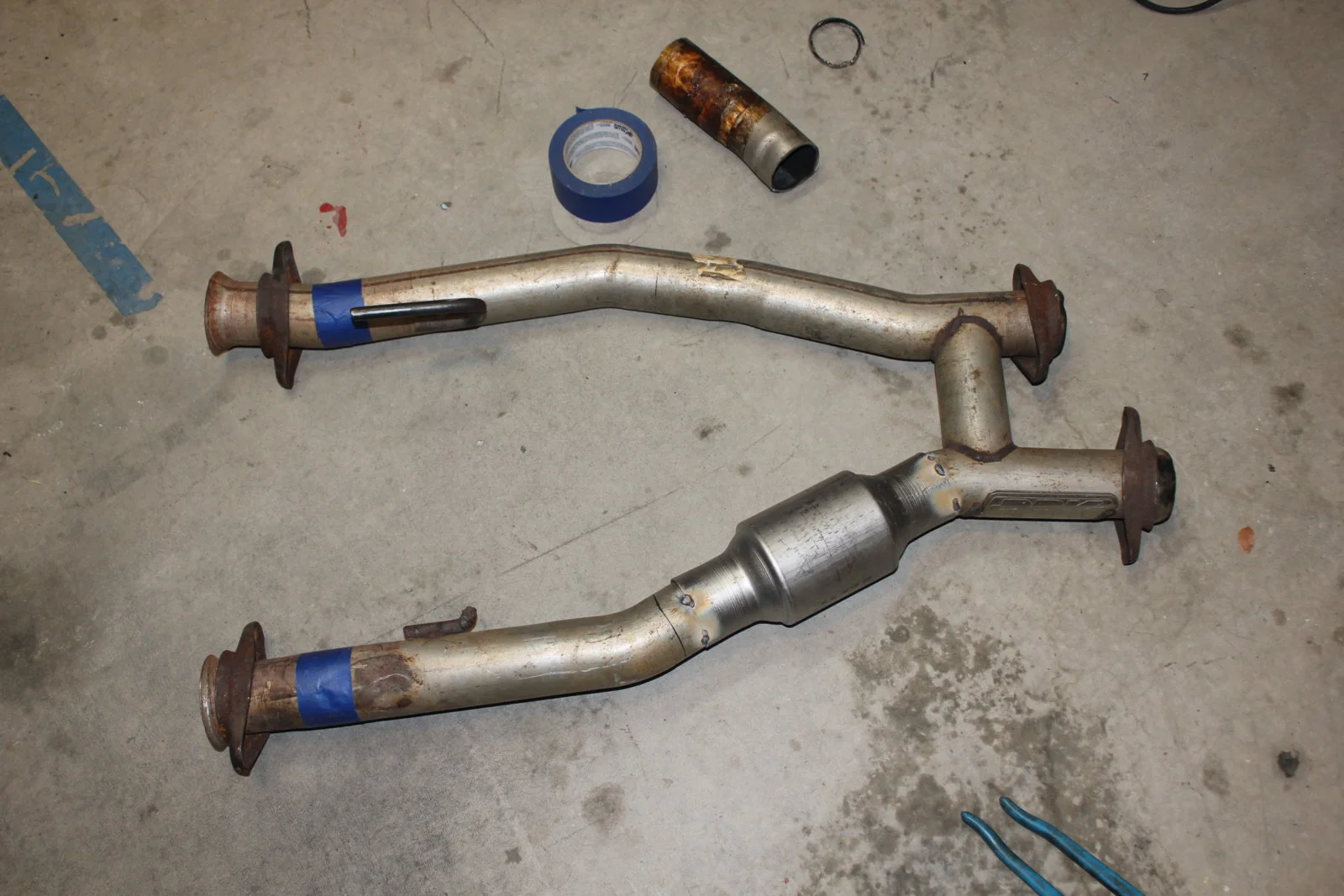

I welded the Flowmaster cats into my BBK O/R H Pipe a few years ago...
