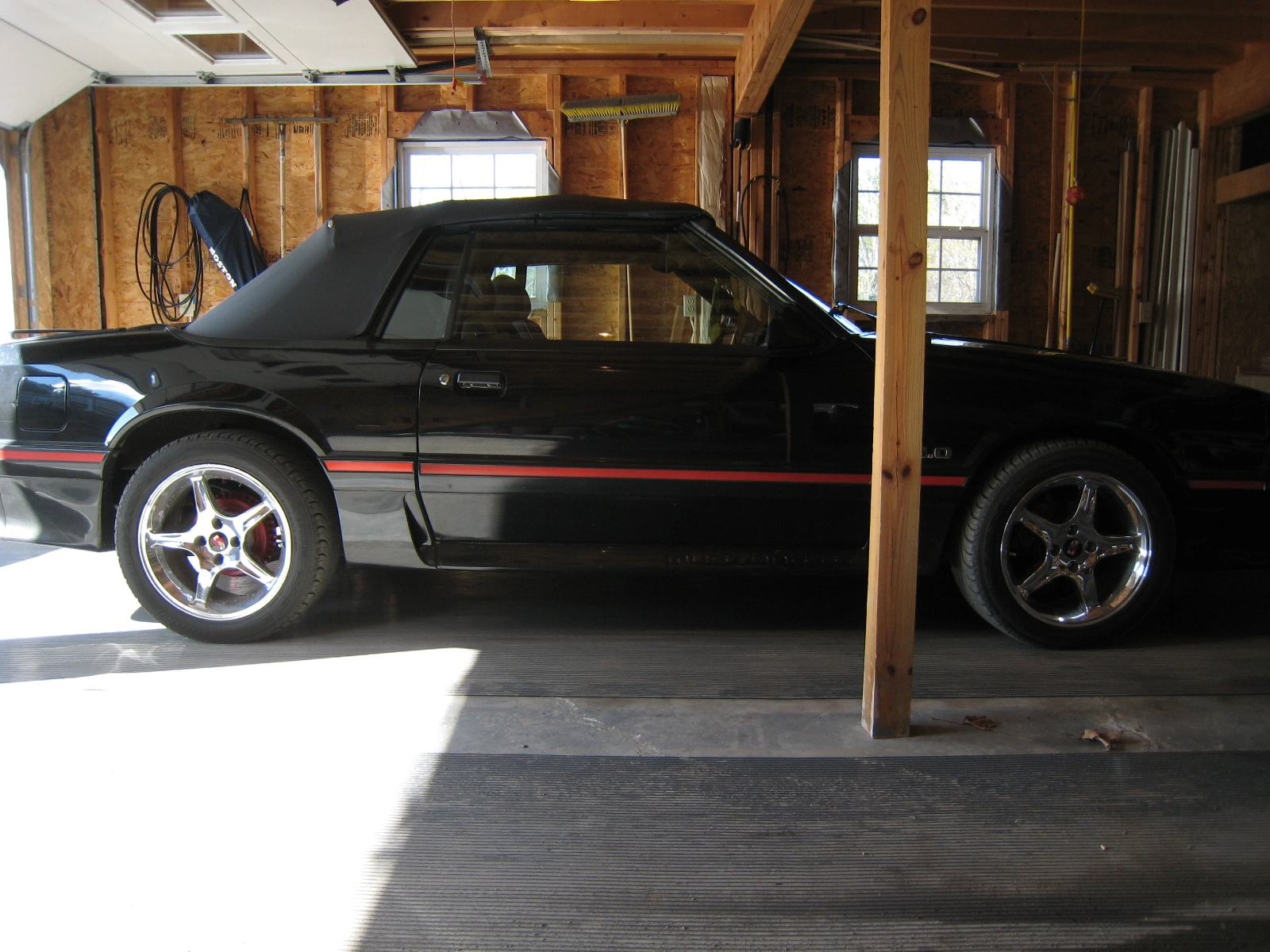

I appreciate everybody taking the time to educate me on the various options etc..
Sharad, now you are telling me what I want to hear I don't know what the offset of my Cobra R wheel is but I did take an unscientific measurement with a tape and the wheel appears to measure 10" wide overall. How do I determine offset? Remember, all I have done since purchasing the car is add cat back Borla and a timing advance.
I've got it in my head to buy the Tokico kit (for $437 versus $340 for just the shocks/struts) which lowers the car approximately 1" to 1.25" according to Tokico. No offense to 2birds, but my mind tells me fresh shocks/struts AND springs would be better than just shocks/struts.
I'm not opposed to replacing the wheels to make this happen (one has some nasty chrome bubbling going on anyway) if I can keep the same 17" diameter wheel (with different offset?) and 245/45R17 tires with the lowering kit.
My Gt is the same as yours regarding rub, at full lock only, it is tolerable.
Sorry my pic didn't come out as good as yours but you get the idea. I tried to upload two more pics but it says the "files are too large".
