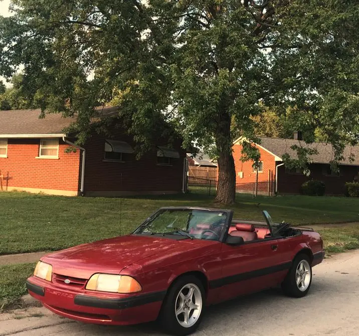

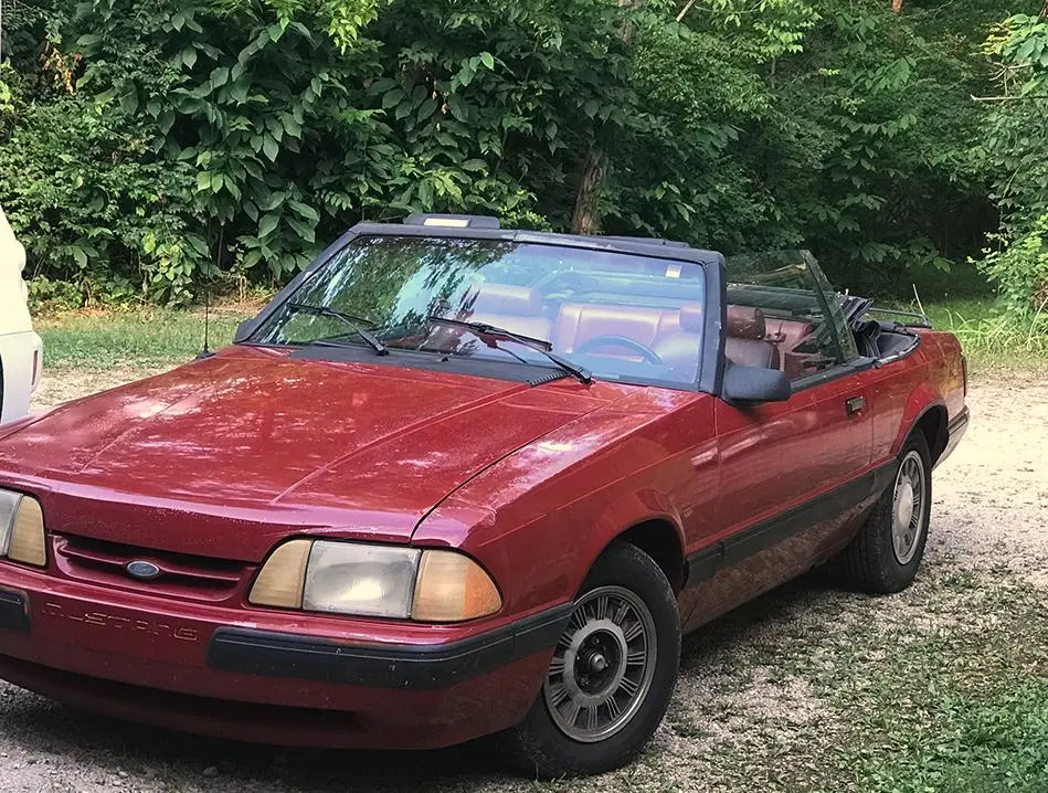

Old Wheels:
New Wheels:
It has some pretty gnarly storm damage, and the brakes are mostly seized up but I drove it to OH from AL so with the help of some friendly folk there.. haha.
That's how the front hub caps are blown off on the original wheels from the heat I suppose.. they were there when I bought it

It was quite the experience picking it up. I think it is indeed pretty much stock, supposedly it belonged to a school teacher before the guy I got it off of, who had been holding onto it and got sick I believe or something it was sitting for 6 months or so before a tornado hit his car port and fell on it. Although some of you may believe it was raced and crashed or something (highly doubt with 70hp 4cyl auto ._. lol.)
