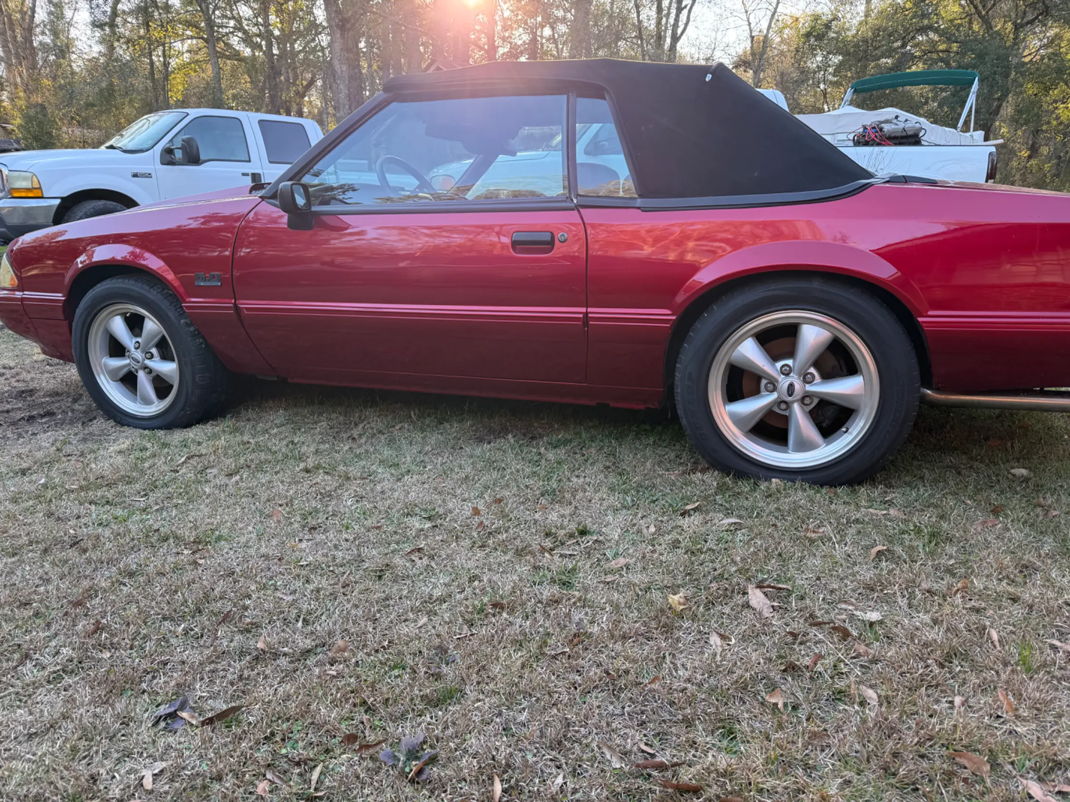

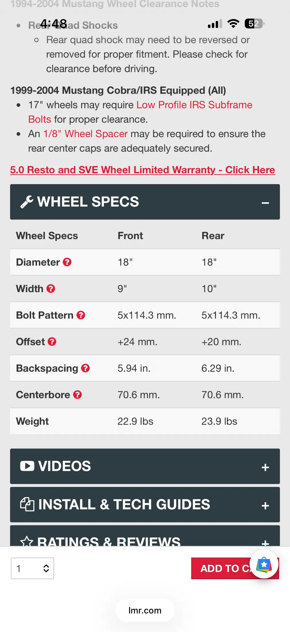

I just picked this car up couple weeks ago and trying to figure it out..the rims I’m trying to run are Sve Nyx 18x9 front 235-35-18and backs are 18x10 and 265-35-18 it is a package deal from LMR, but I have disc brakes on the back too.
This is a pic of my car. It looks a little lowered, especially in the back end.

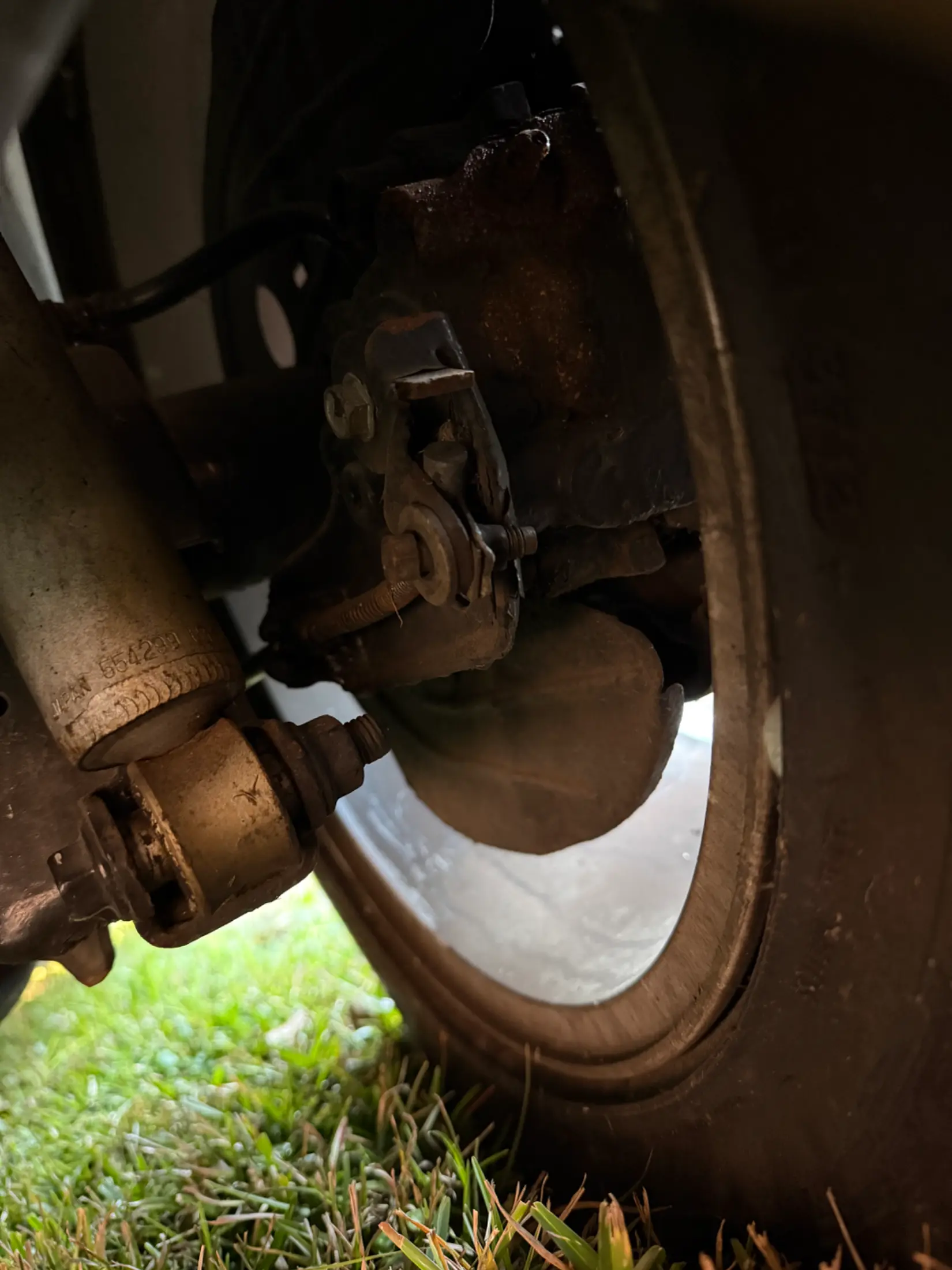

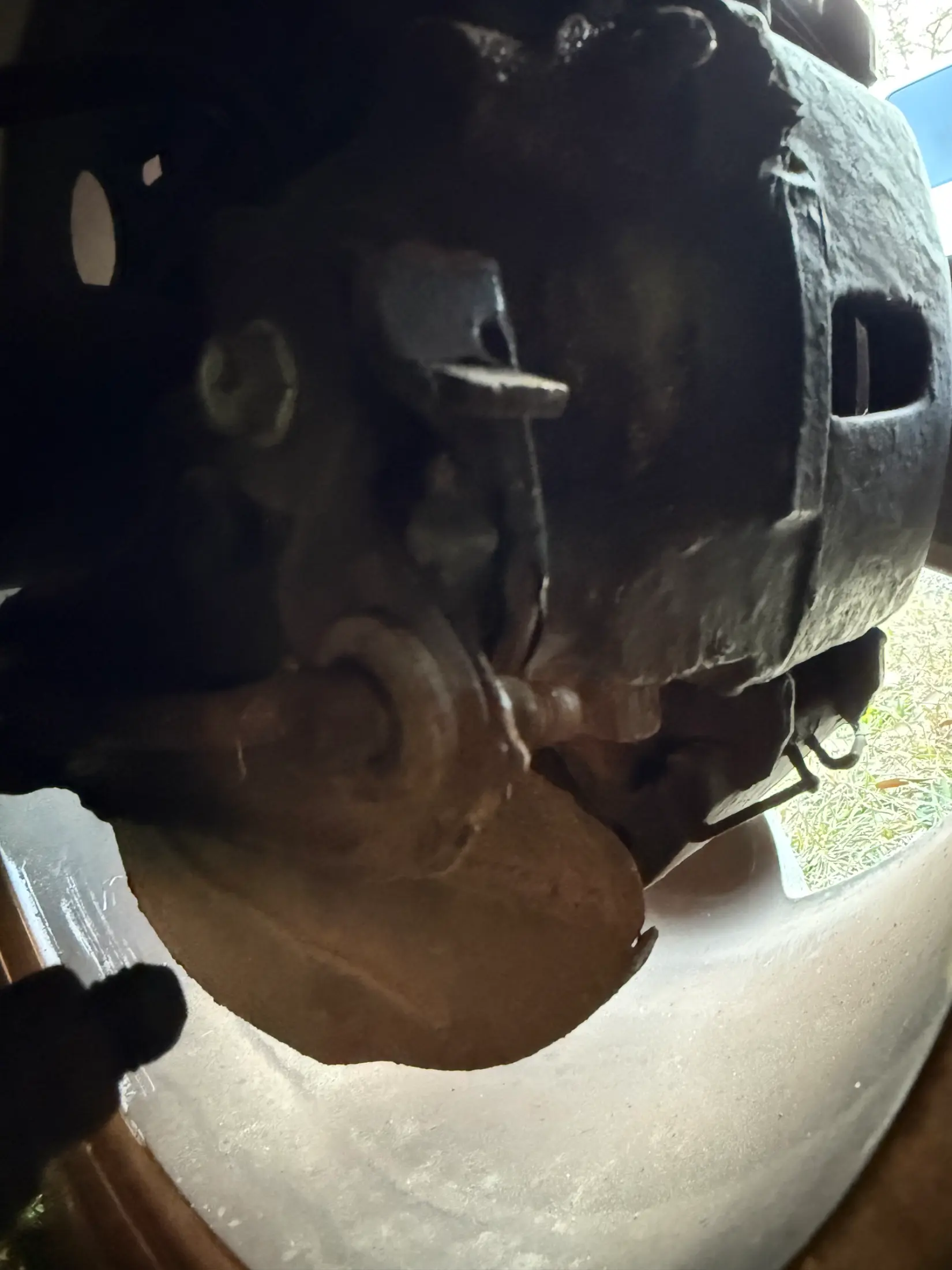

Sorry I got tire size off a lil bit..front are 265-35 and backs are 285-35..I sent a pic of backspacing..Thx in advance
Looks decently lowered. Wonder if you have sn95 or Fox length axles.

Hang on guys. Looks like those are SVO/Lincoln rear disks, which add about 1.25" each side. Those are wider than Sn95 disks.
The wheels you have now are S197 wheels with a +45 offset. They are deep which is why they fit well.

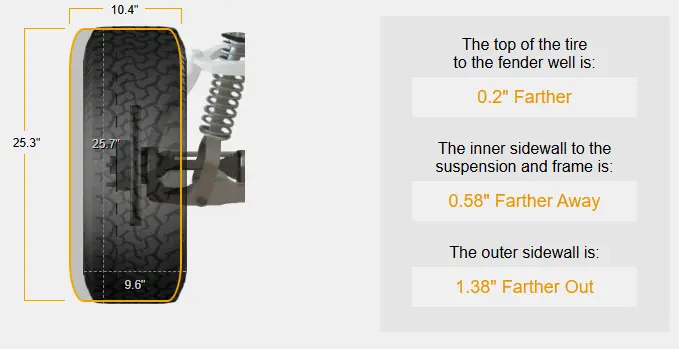

If you use this tool, you can figue out where your new wheels will sit relative to current setup.
Current wheels are 17x8 +45 offset. So if you stick a +20 offset rear 10" wheel on the back, it;s going to stick out 1.38" more than where it currently sits
need a few more pics of the rear brakes to confirm, but you likely need to be looking at rear wheels in the +50 range if you want to run anything larger than a 8" wide rim....or change the brakes
