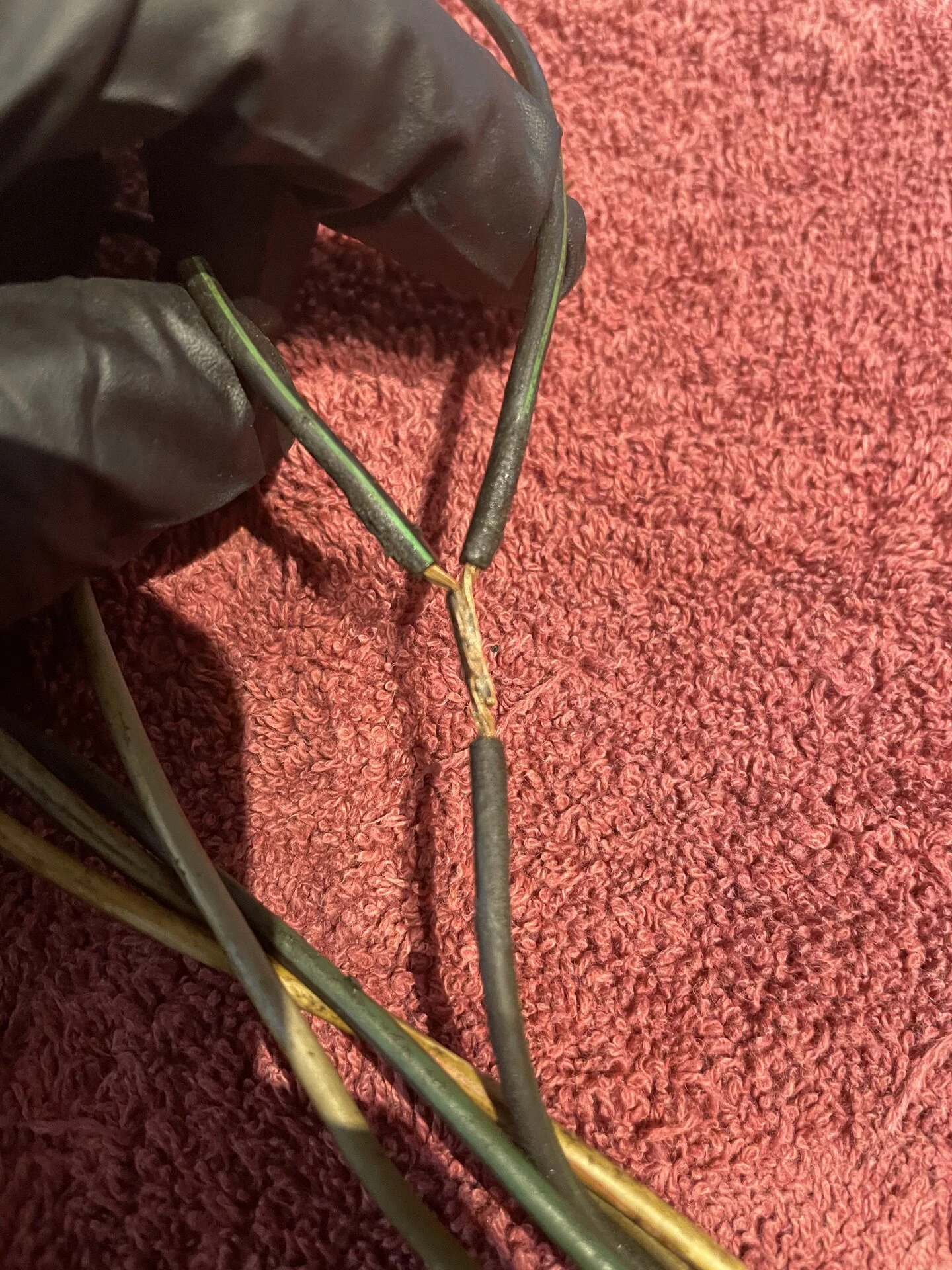

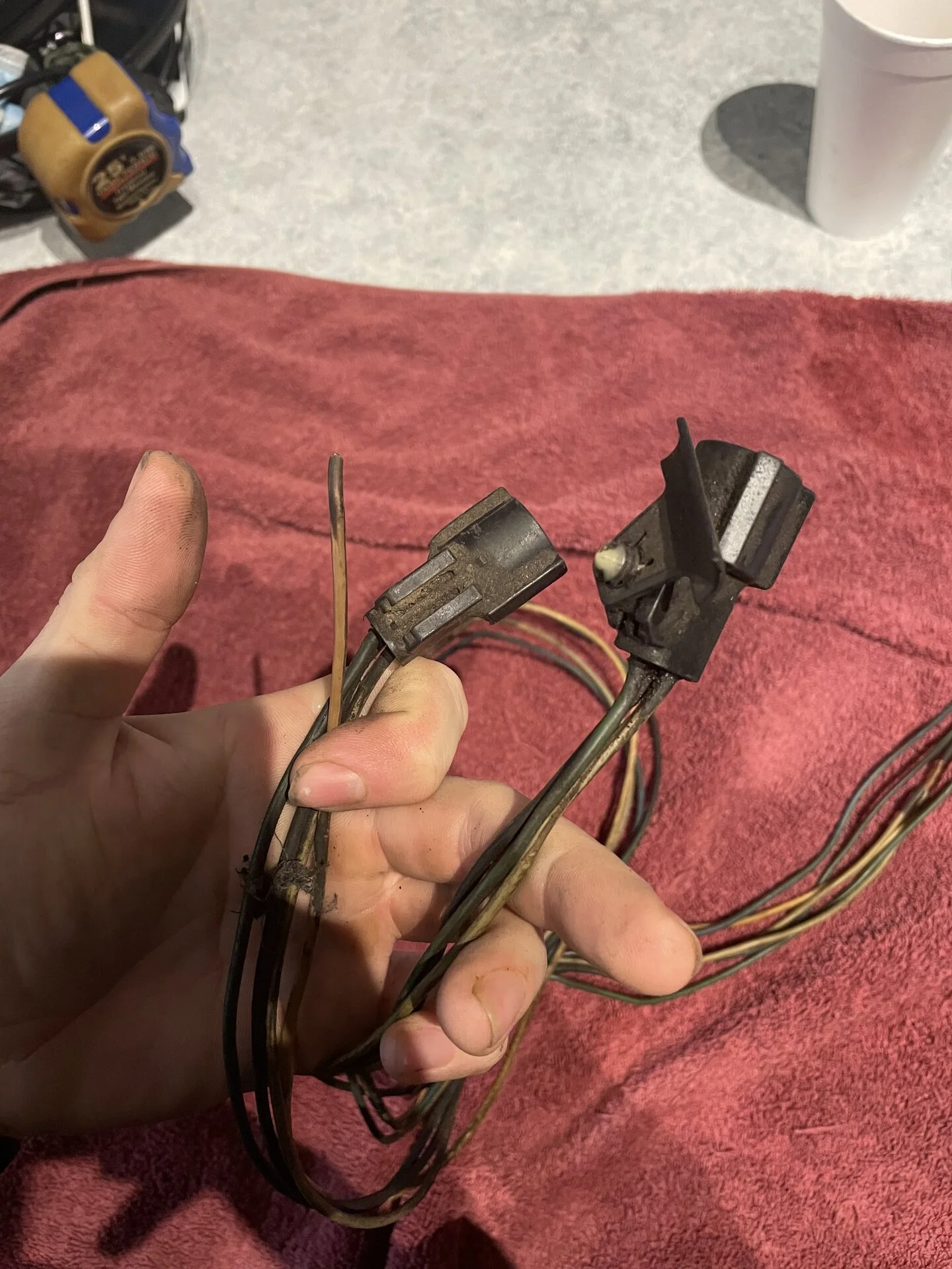

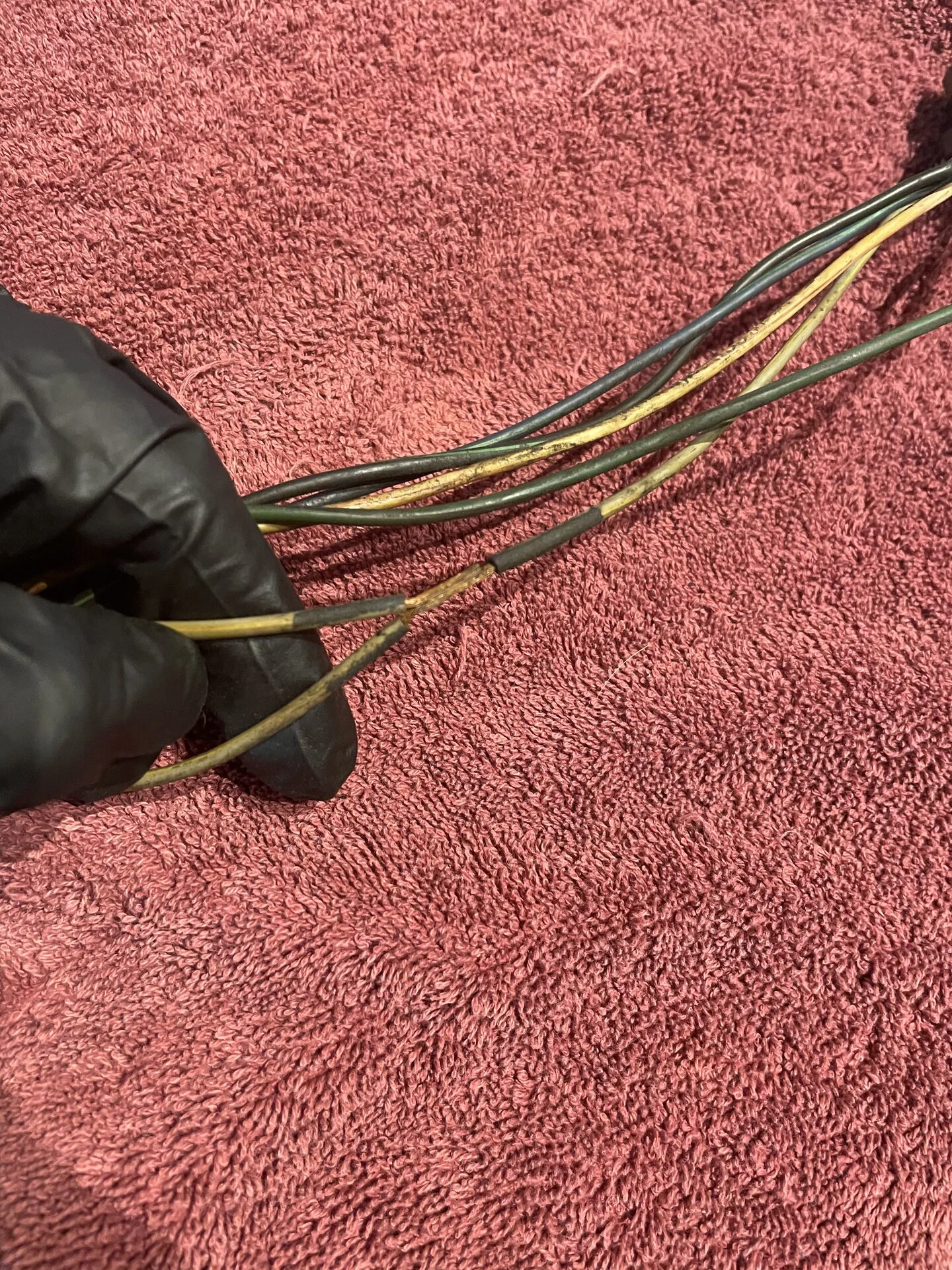

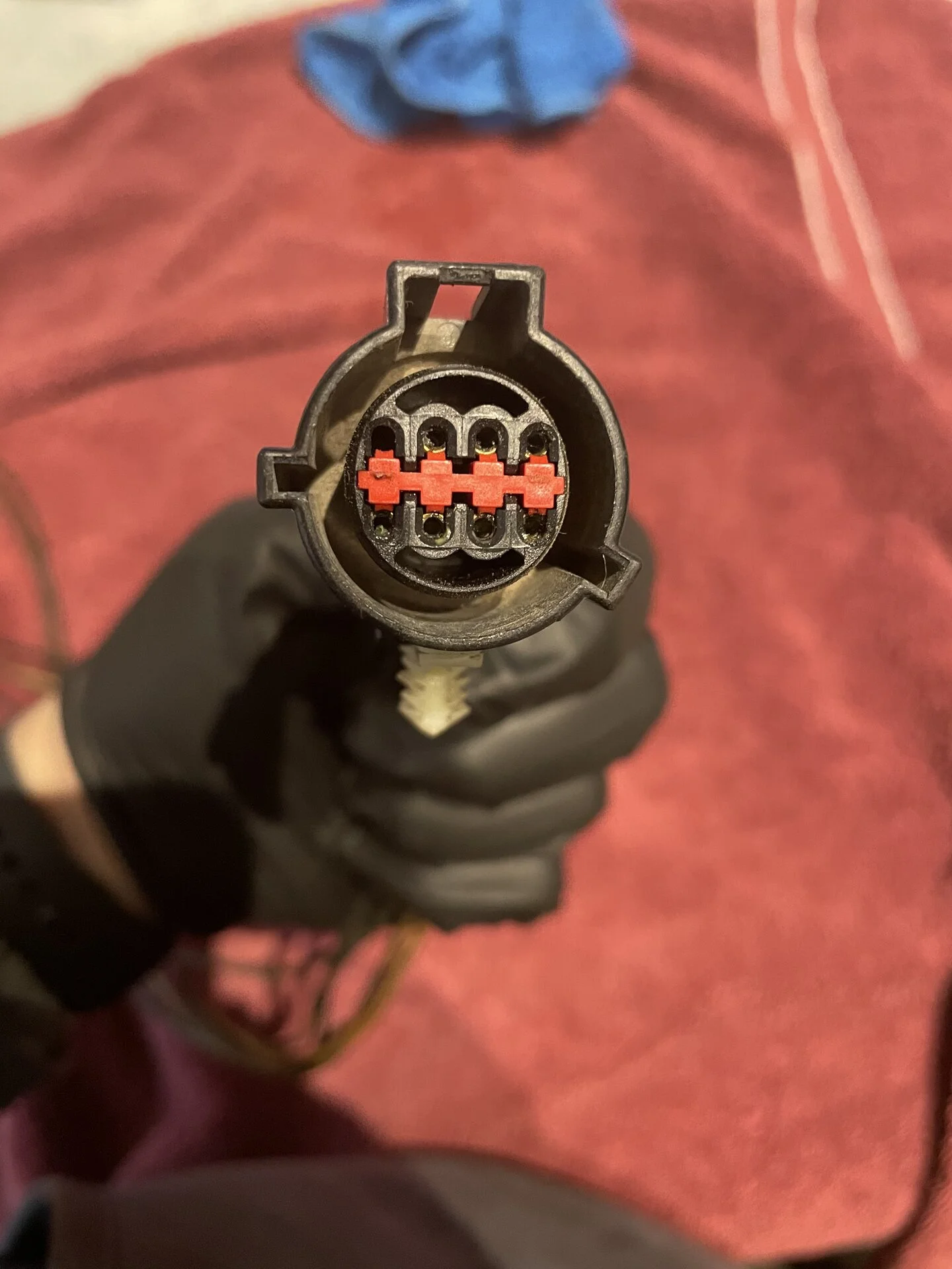

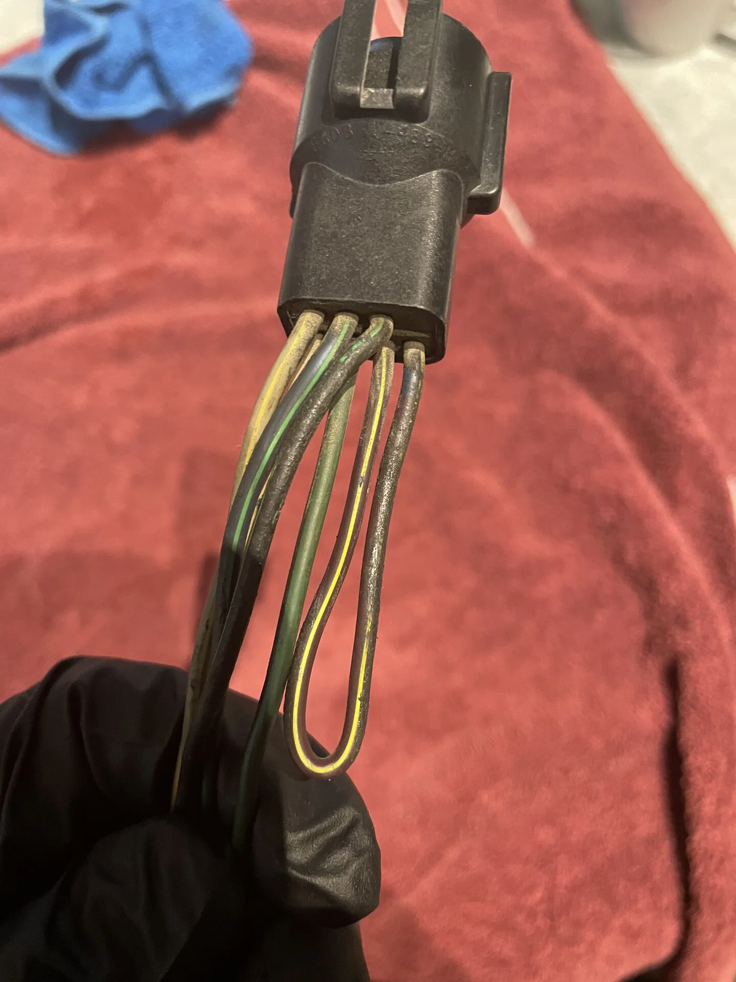

Going through the harness now and double checking for any knicks and fixing accordingly before installing. At the O2 harness and have a question. Gentleman I purchased the harness from stated it was from a 89 5.0 t-5. Plug says different occurring to the P/Y jumper. I’ve also located 2 other Y splices and not sure if these are that way from the factory. Also on the passenger side lead for the sensor, the W/P wire from the plug is not connected to anything and curious what is for or is this thing jacked up? Want to make sure all my ducks are in a row before getting the harness in, hooked up when motors done and fire it up I’m not going to fry the A9L.
Pics attached and Appreciate any insight. Thanks.
