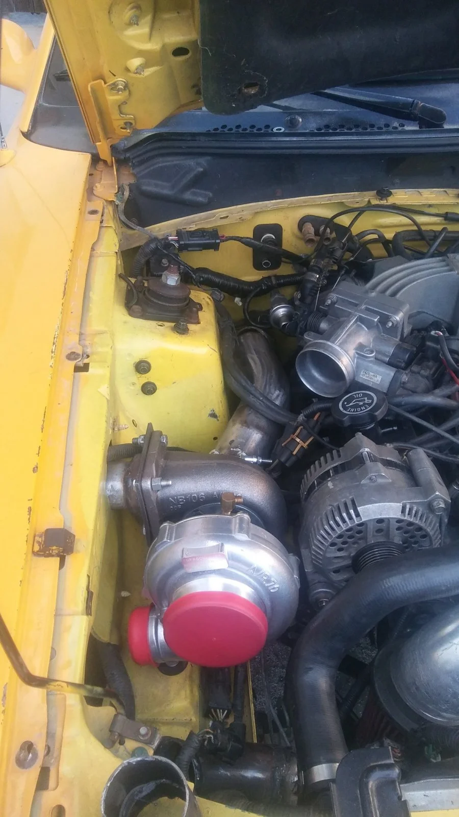

Hey guys I need a little help. I am building my first roller motor with a x303 cam and 1.6 rocker arms. I am confused with how to get the right pushrod length. I have watched the YouTube videos and it still comes up 5.970 in in length. Does anyone have the same setup?
Think trickflow sells a kit with an adjustable pushrod. And you have to use a solid lifter to check ptv clearance as hydraulic lifter wont give accurate measurement.
