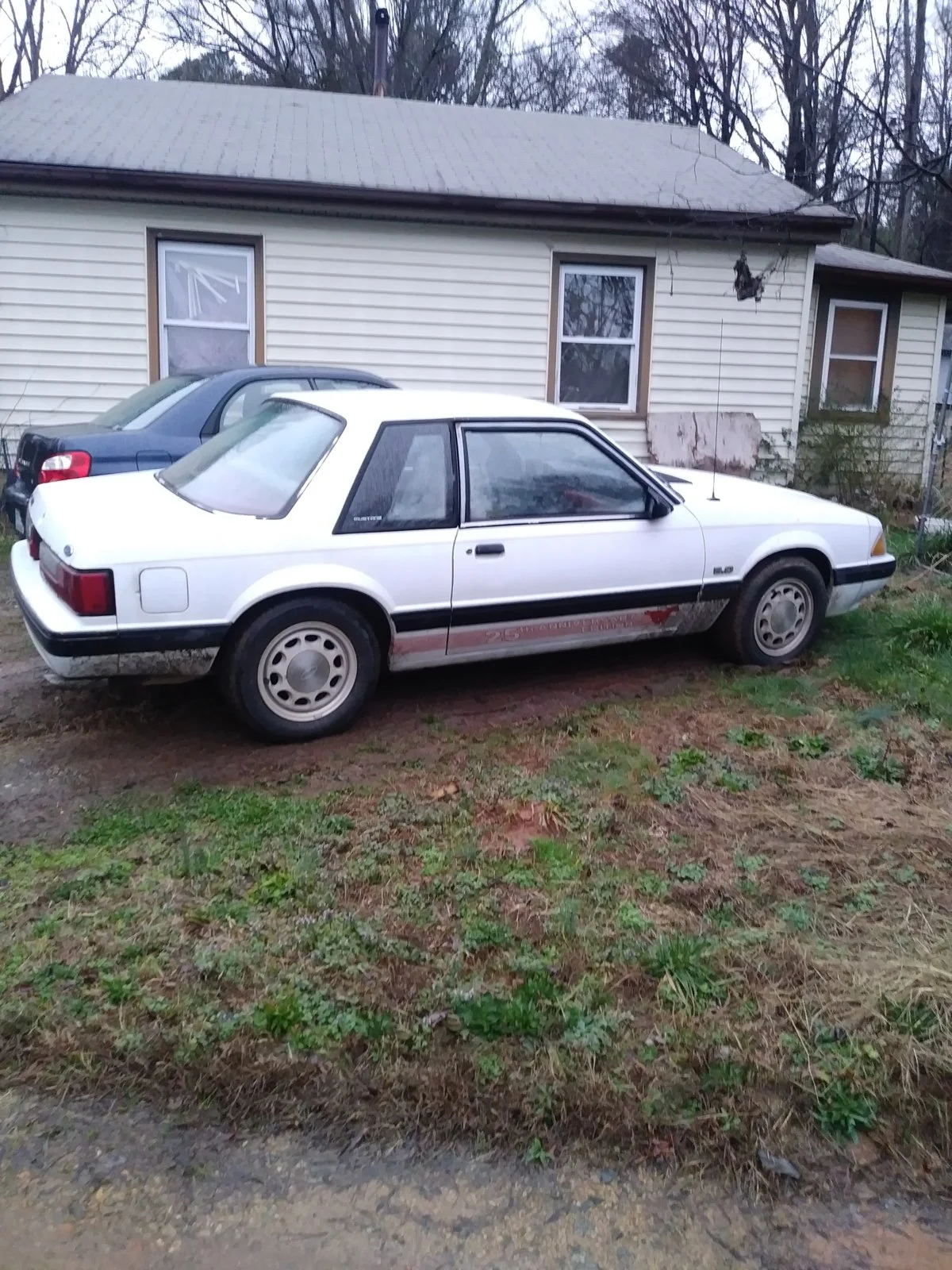

Ill try to dump codes, i should be able to if it isnt raining today. CFD are carolina ford dealer special edition. They come in oxford white, with red interior 25th anniverssary running on the side special floor mats, a special key chain, and a special piece of paper everyone throws away lol. Carolina ford dealers ordered them due to their high sales.appreciate your. Suggestions

a little muddy, its been raining alot this winter
