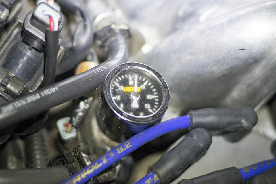

• Fuel Pressure
Runs at 32 psi
When i shut it off, it immediately drops some, then raises and holds at 34psi.
After it sits warm, and I put the key in run (not starting), the puel pump whines. I get out and check, and its at 34psi.
Starting while hot, it goes to 32 psi.

What we know for certain is you need air, fuel and spark so the problem will be one of these or a combination. Fuel pressure is on the low side so that may be suspect. It should be closer to 40 psi KOEO. Have you checked for fuel in the vacuum line at the FPR? Do you know for certain that the fuel pressure hasn't dropped below 32 psi? For air issues have you cleaned/replaced/tested the MAF, AIT and TP sensor(s)? As noted by others reman distributors are know to have bad PIPs.
This AFPR isn't doing anything on my car. I dialed it back to stock a long time ago and never took it off as it wasnt a problem. Interesting about KOEO and it being a little low on pressure. Thanks for pointing it out.
