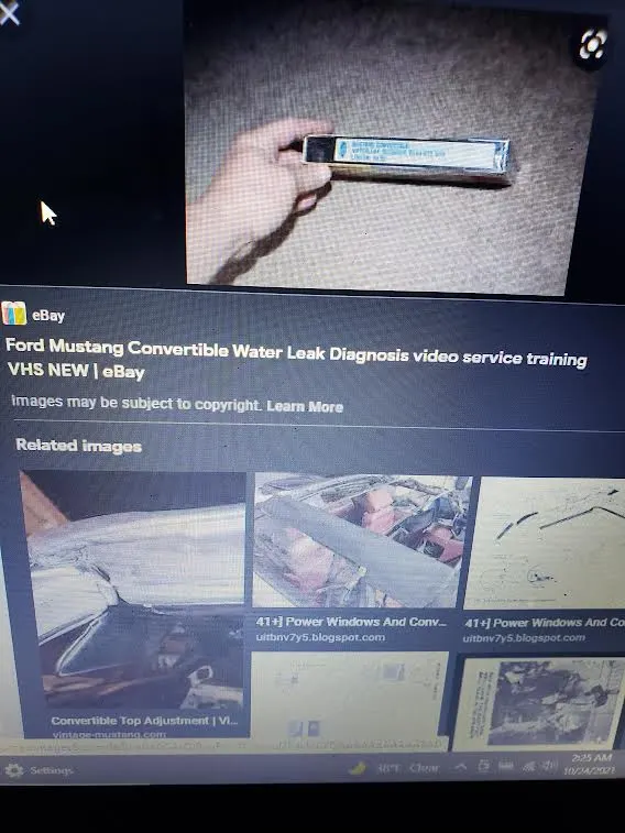

There is a video some of us ford masters had to watch and learn
It is Convertible Top Water Leak Diagnosis
VHS is hard to watch these days but if you have trouble this is where to start
It goes thru every adjustment , windows and top
Tough work
Be proud of yourself if you ever have to fix one
