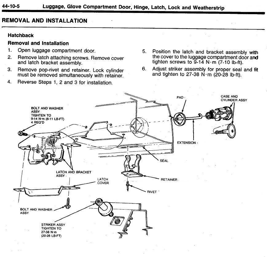

Hey guys I bought a new lock for the trunk on my 89 foxbody but I have no idea how to install it.. when I bought the car it had no lock in the back so I didn’t have to take it apart. I’m confused on the lock extension and where it goes on the lock itself. Any one have an idea how to fix this? I’ve looked on YouTube and there are no videos on this part. Thanks for the help
