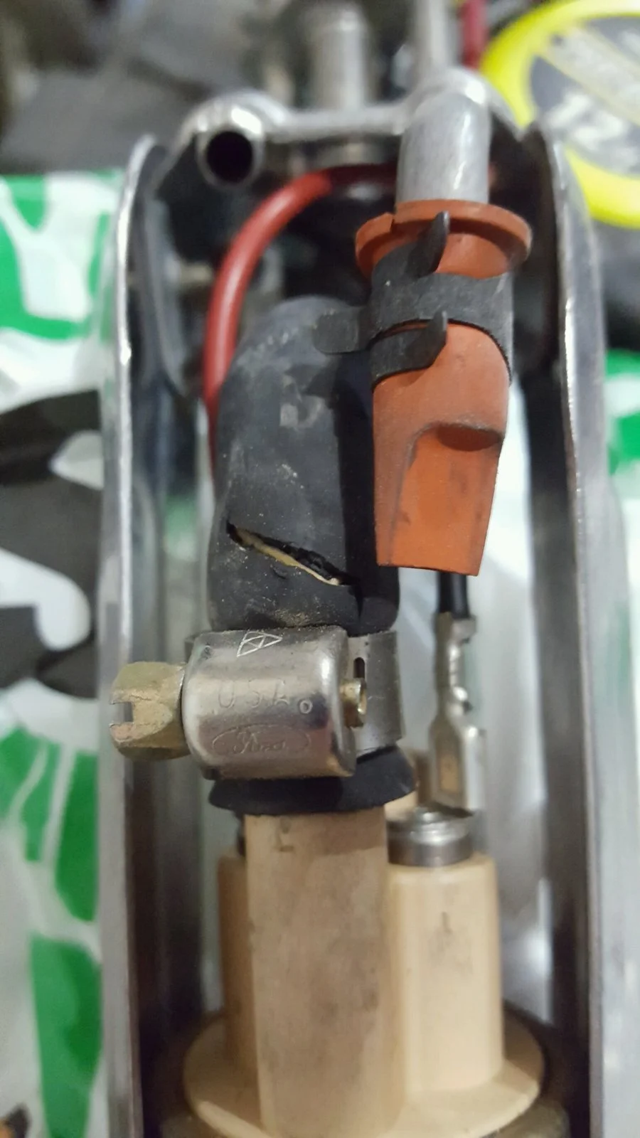

I checked the pressure on the rail and only achieved about 10-12 psi and would drop back to 0 when turned off. I then checked at the filter and saw the same but could hear some "leakage" inside my tank so I dropped my tank, pulled my pump and found the rubber hose coming off the pump supply was cracked. I decided to order a new pump and components while I had the tank off and I'm pretty sure this is the problem.
