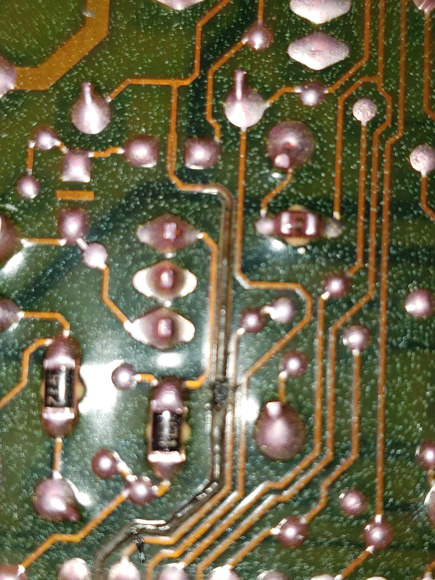

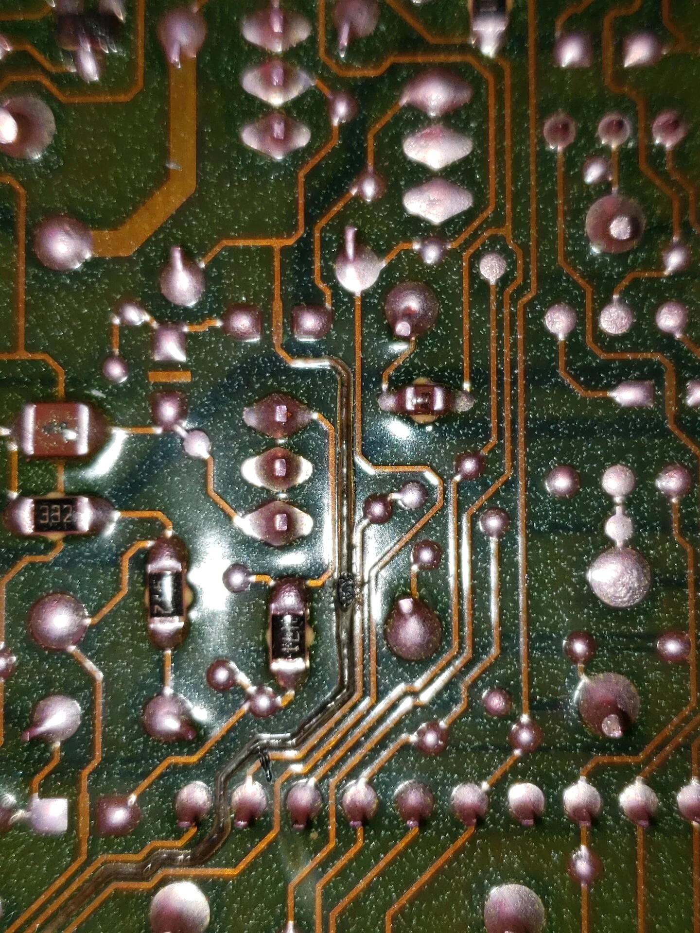

Yes, that is a good indicator of an ECU issue. You’ll want to open the case up and look for leaking capacitors and/or a burned pin 46 trace.
Test for continuity between pin 40/60 and 46. You should have it

I haven't messed with the car in some time but I did pull out the eec and its a cw3 computer for an auto transmission and found the circuit board burnt. Would this be the reason why its not wanting to pulse
