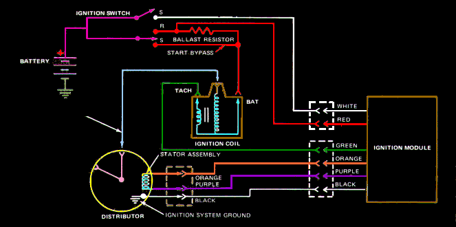

I have a note that the DuraSpark ignition had a resistance wire built into the harness on some models of the car. Other models may have used an external ballast resistor. Its' purpose was to limit the current to the coil and points them keep them from burning up. I haven't helped many of the old to new conversions, so that didn't come to my mind.
Duraspark II ignition diagram:
Diagram courtesy of /www.billwrigley.com
See http://webpages.charter.net/1bad6t/duraspark.html for more help.
Note the ballast resistor shown in the diagram: you’ll need that too
If you use a coil from a 78 or later Mustang, you don't need the ballast resistor. The stock 89 Ford/Mustang ignition coil does not need a ballast resistor
