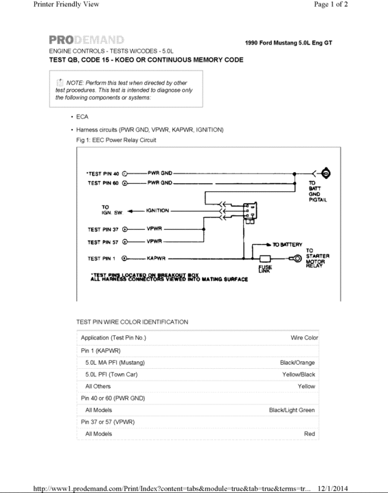

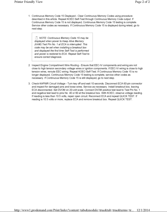

The only codes I can get are:
15
85-CANP failure
96- fuel relay
Has anyone ever had these symptoms?? Am I missing any sensors that should have been transferred from the fox body? Any help would be greatly appreciated!
