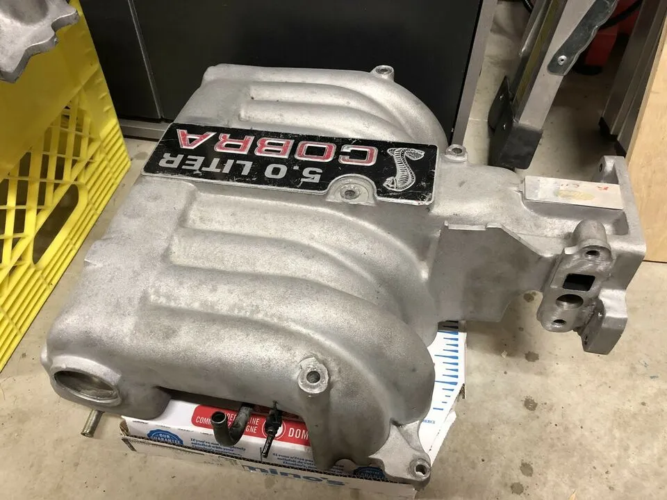

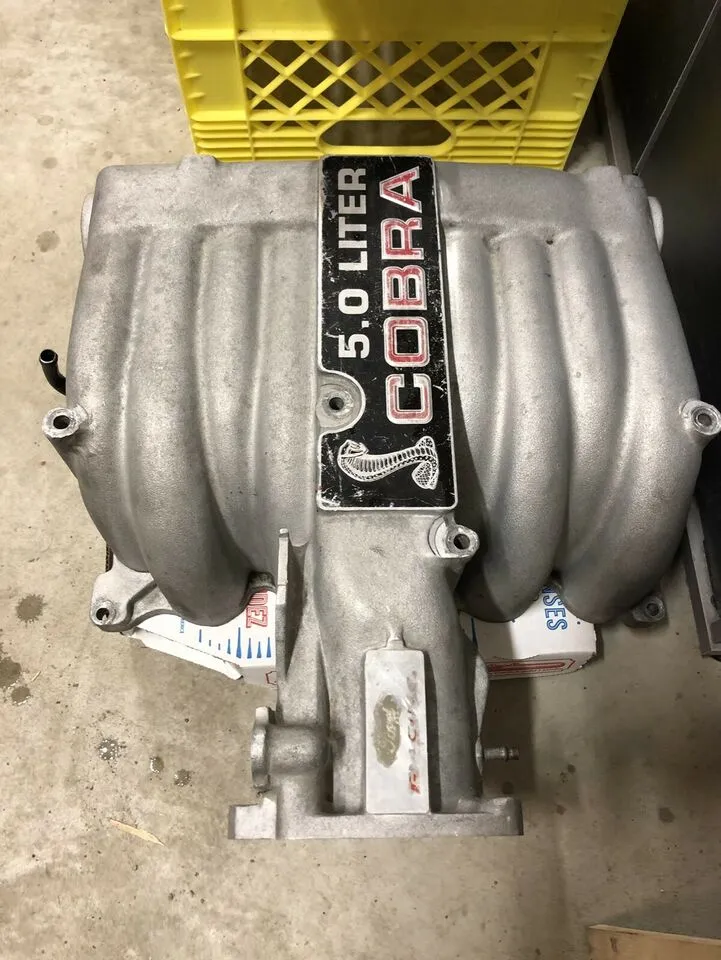

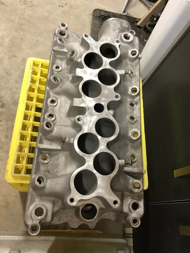

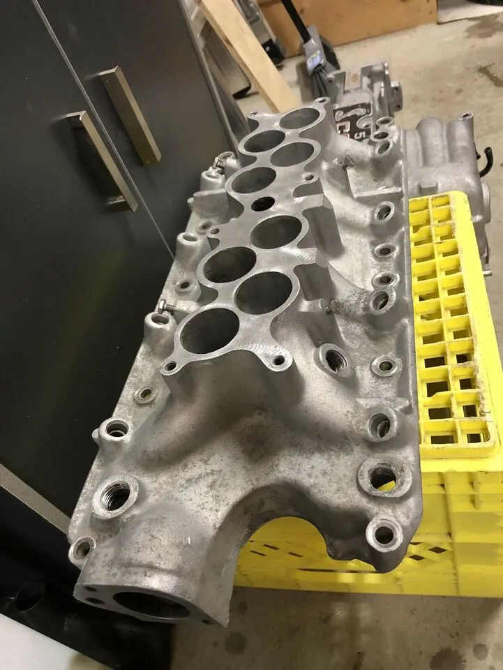

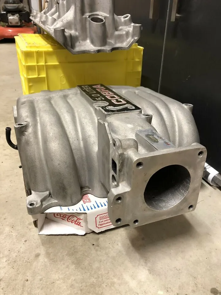

Hi guys,
Sorry to revive an old thread but figured it would be better than remaking the same one. As with the first post, what do you think of this intake? I believe this time it may be an actual Cobra setup, but again the ad seems to get the years wrong by saying 1979-1993. I just wanted to make sure it is one and if I were to get it and put in on the stock 1990 engine I wouldn't run into any issues where I have things with nowhere to connect them. I also think the price is high based on the ranges given earlier. He is asking about $300 USD and they are a bit of a drive to get them too.

That is a 1993 Cobra intake, but it's the china cast version that Ford sold from 2004ish to about 2014 or so. So while it is a Ford part, it's quality was never regarded as equal to the real intake some from 1993-2003.
$300 is about what it would sell for, with real Cobra intakes selling for almost $500 now.
It would bolt fine on your engine. I have a real 93 cobra intake on my '88.
A better deal however would be to buy an early 1996 explorer intake, which can be had for roughly $100
Thanks, that is about what the guy replied back with. I was just getting ready to post an update but you beat me to it. Maybe I will see if he is willing to sell it for less and see what happens.
