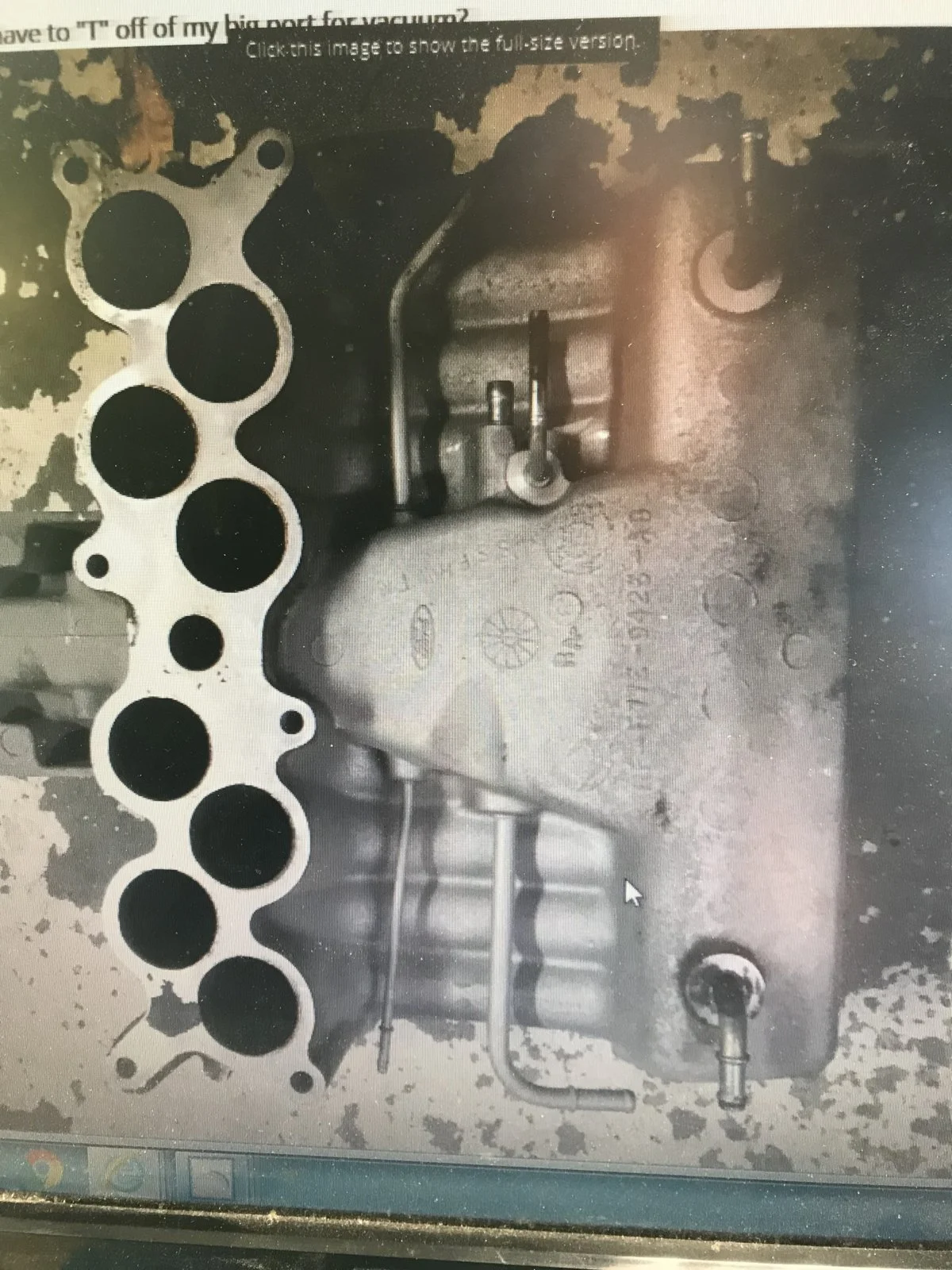

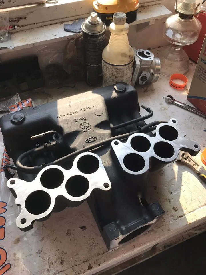

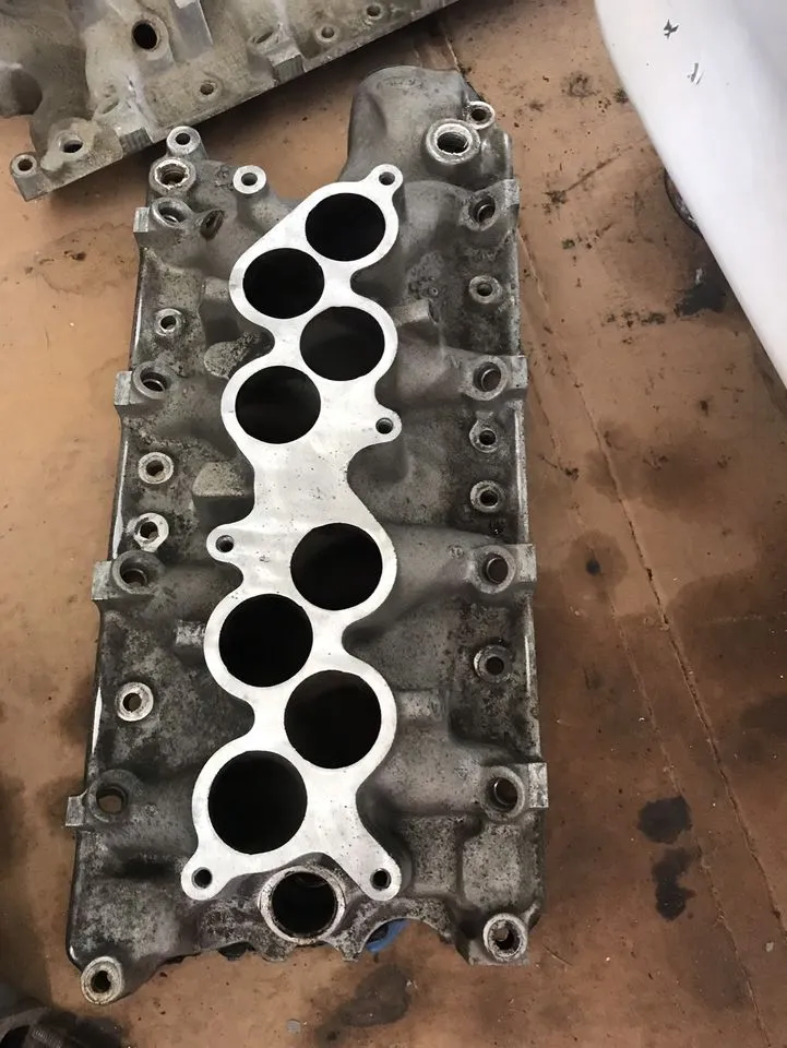

Hi,
Can anyone tell based on these pictures if these are legit Cobra intake parts? It says they are off a 1992, but I thought they didn't come on these until 1993. That isn't to say that they were swapped onto a 1992 and that was the last car they were on...
Also interested in some opinions on if these would be worth while on my basically bone stock 1990 GT. It does have an aftermarket exhaust so maybe something to help the engine breath better would be good. I was also wondering if I were to put these on, should the throttle body be upgraded to a larger one too, and if so what size would be good for an otherwise stock engine. Would any of these changes require any work to prevent engine lights and trouble codes or is this a pretty straight forward thing to do?

“Cobra like” is right. That thing came off a late 90’s Explorer or Mountaineer. No egr, it would have a hole in the center.
Thanks for the help guys. I asked if these are real Cobra parts or off an Explorer (knowing the answer) and he did say they were from an Explorer. Not to say they are not decent parts, just not worth the money he is asking in my mind (about $200) and not what I am looking for. Should probably take the Cobra reference out of the ad and just leave it at GT40...
Non-EGR Explorer intake. Pass. It's not a Cobra intake, and not even a GT-40 intake.
Going rate for EGR equipped Explorer intakes is around $75-125 and you can usually get them with the 65mm TB (the early ones can be converted) and the better flowing 19# injectors.
